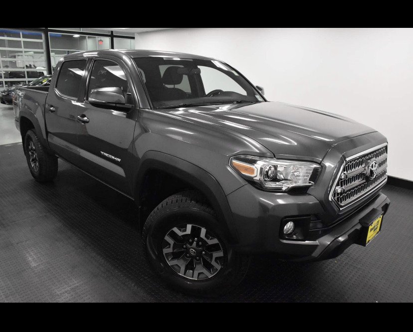

    New Tacoma Owner here...
    The title says it all. I just purchased a 2017 TRD OffRoad Manual with 27k miles. As I am exploring potential mods to increase engine performance, I'm wondering what other owners recommend.
    For intake, I was looking at the K&N Blackhawk.
    For exhaust, I saw a lot about the borla and MBRP (however I am not really sold on either). I don't want my truck to sound like a ricer car, rather just give it a little more rumble, acceleration, or what have you.
    I have a boat, so I will be towing and I don't want to do anything that would compromise the truck's reliability or ability to tow. It's a 21ft CC and weighs 3,500lbs (my truck has the tow package and is rated for 6,400lbs).
    That being said, is getting an exhaust even worth it? I've seen things about tunes, do some void the warranty while others don't, is a tune even worth it?
    My goal is really to give the truck a little kick, while not voiding any warranties or compromising my ability to tow.
    Thanks.
