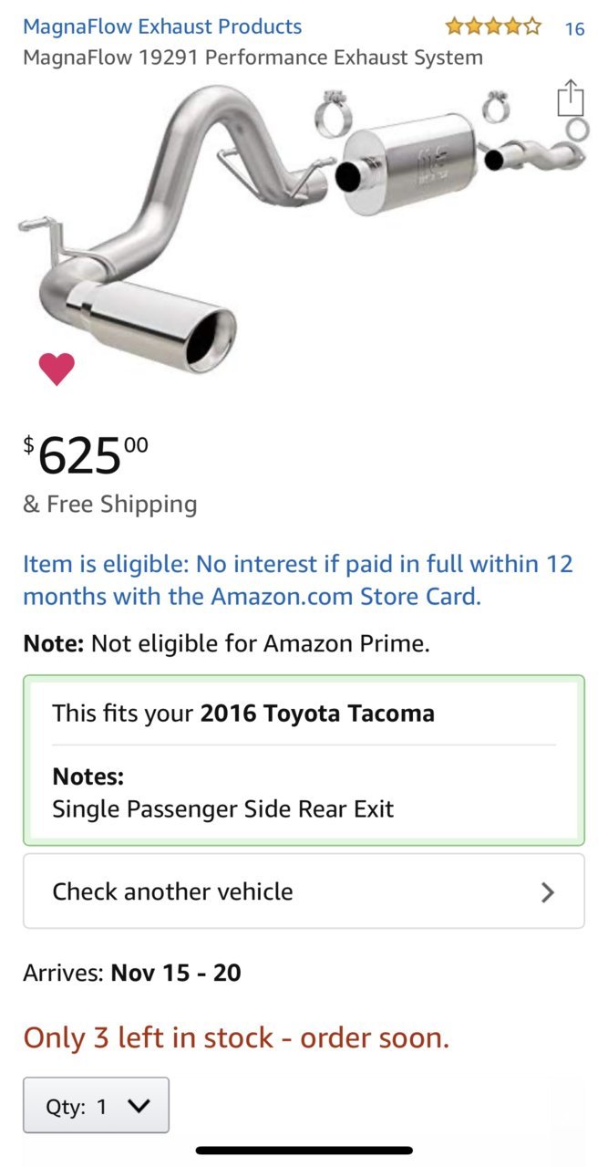

  17. Nov 10, 2019 at 3:36 PM

  18. Nov 10, 2019 at 3:50 PM

    M1Awolf
    M1Awolf Well-Known Member
    Jun 16, 2017
    #221701
    2,192
    Rob
    Montana
    2017 TRD Off Road DCSB M/T
    This is the system I have on mine downstream from all the other mods. Sounds very nice itself before additional mods. Again sound is all personal preference and I have yet to hear a internet sound clip that is true to real life. YMMV
