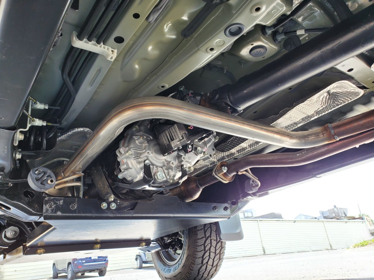

    The only thing you have to do is an exhaust reroute to go behind the tcase for the last rear skid. You'd probably have to do this with most any brand of skid for the rear one.
    The pic is after the reroute and before I put the last skid on.

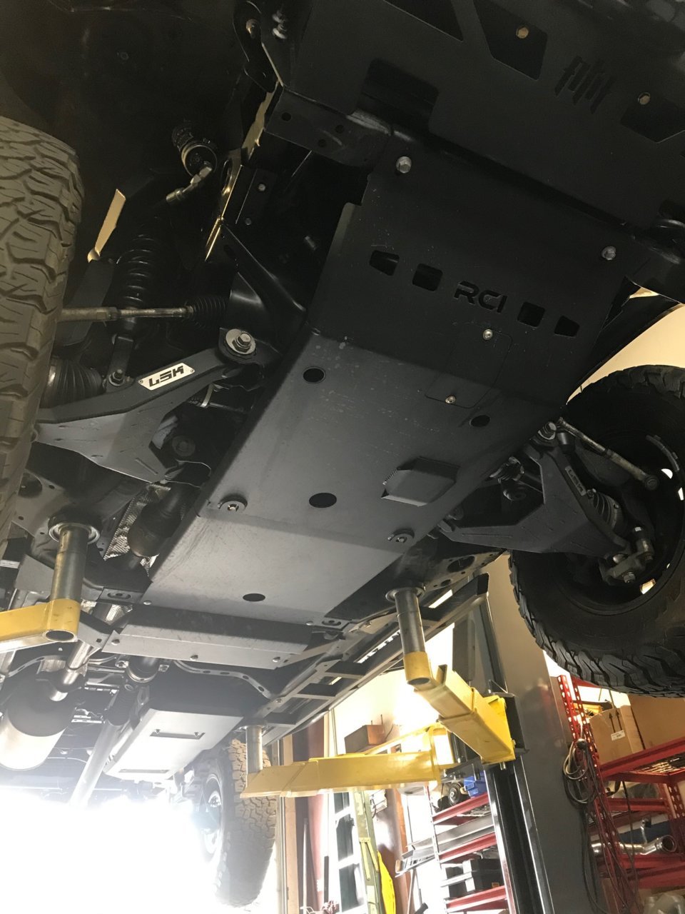

    Im running with RCI along with my TRD PRO skid plate

    Damn it. I just ordered the trilogy skid and forgot about this. U think prefabbed ones are a waste of money or should I just pay some homeboys in the hood 100$ for it?

    I'd just pay the $100 for the reroute, much easier.

    You can put the first two on and wait until the reroute for the 3rd
