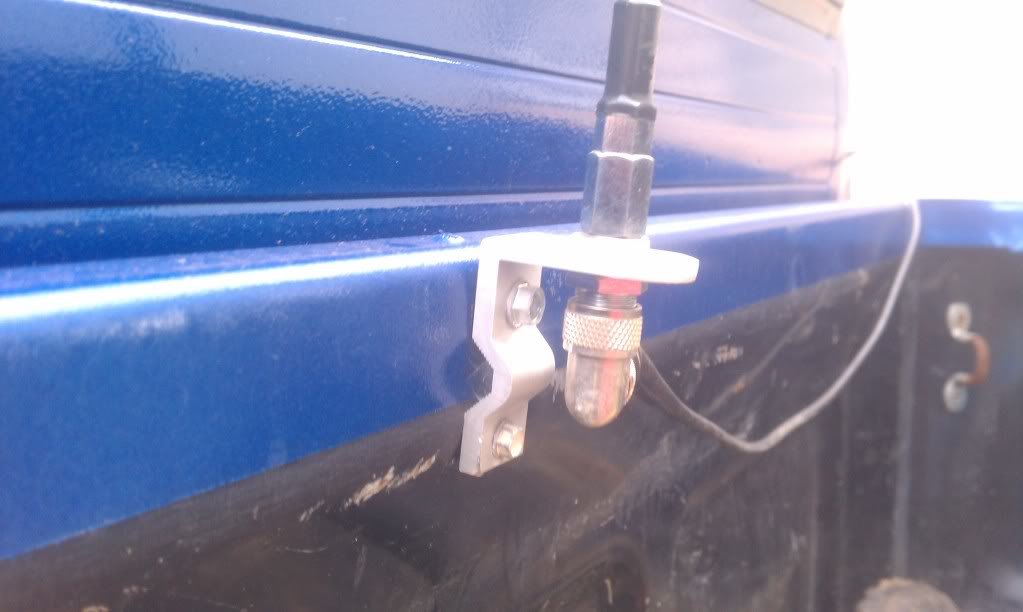

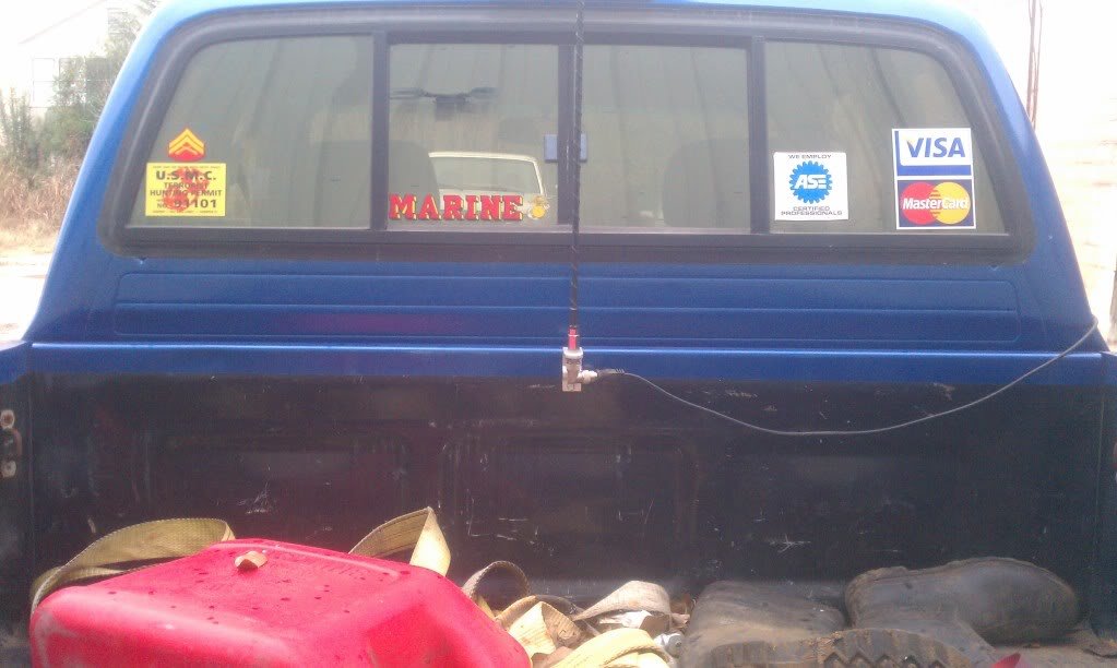

    This is my mount and location. I have so far had no problems receiving or transmitting. I have been able on the highway to secure around 4 miles without loss of signal. I figure I am doing pretty decent.
