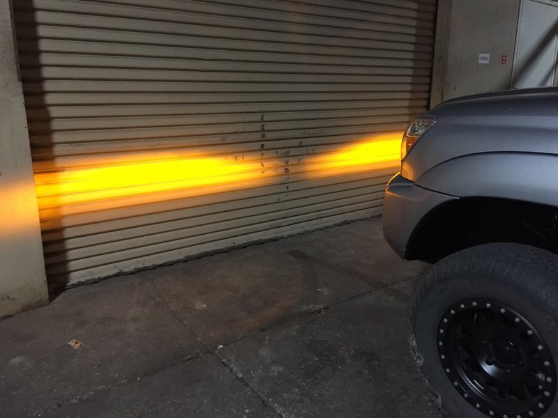

    The Morimotos are good. They certainly are a big improvement over stock. Still without question the Flosser 90W bulbs with the RallyLights harness is not only the brightest I have tried, and has the correct beam for the optics, but it's under $100 to be fully set up.

  12. May 20, 2017 at 6:22 PM

    Are they upside down?
  16. May 21, 2017 at 7:43 AM
    #16
    lpfe42
    lpfe42 Well-Known Member
    Jul 2, 2015
    #158633
    404
    Kenny
    Santa Barbara County
    20 DCSB CEMENT
    5100/887 Icon uca
    No, They only go back in one way..
    They work GREAT in the fog

    Mmmm its just weird that flat cutoff at the bottom.
