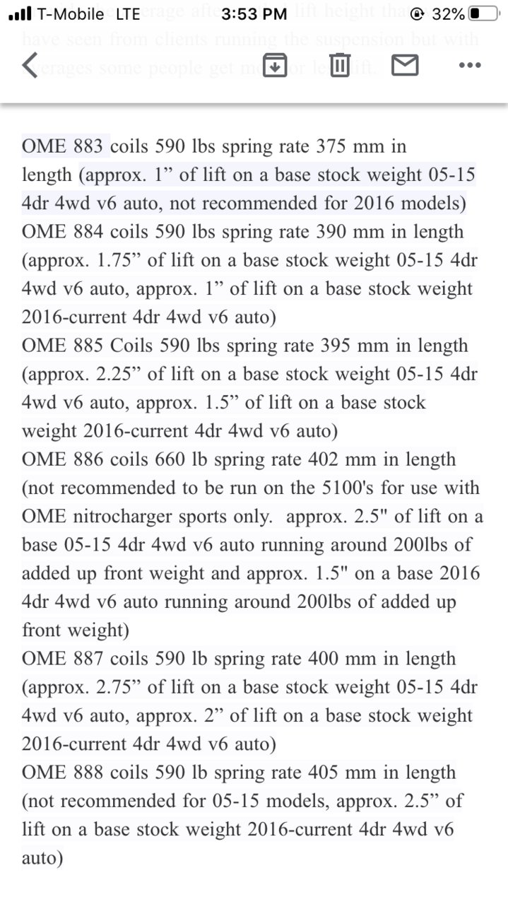

    This is the information I got in regards to putting ome coils on 5100s from Headstrong. I am currently installing eibach 2.5 coils on 5100s at the lowest notch with JBA upper control arms. Will finish the install today and let you know how mines came out!

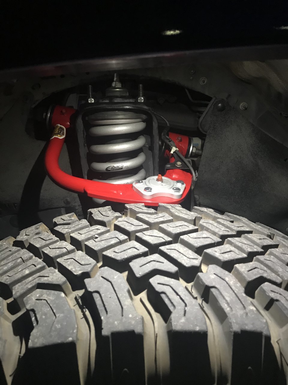

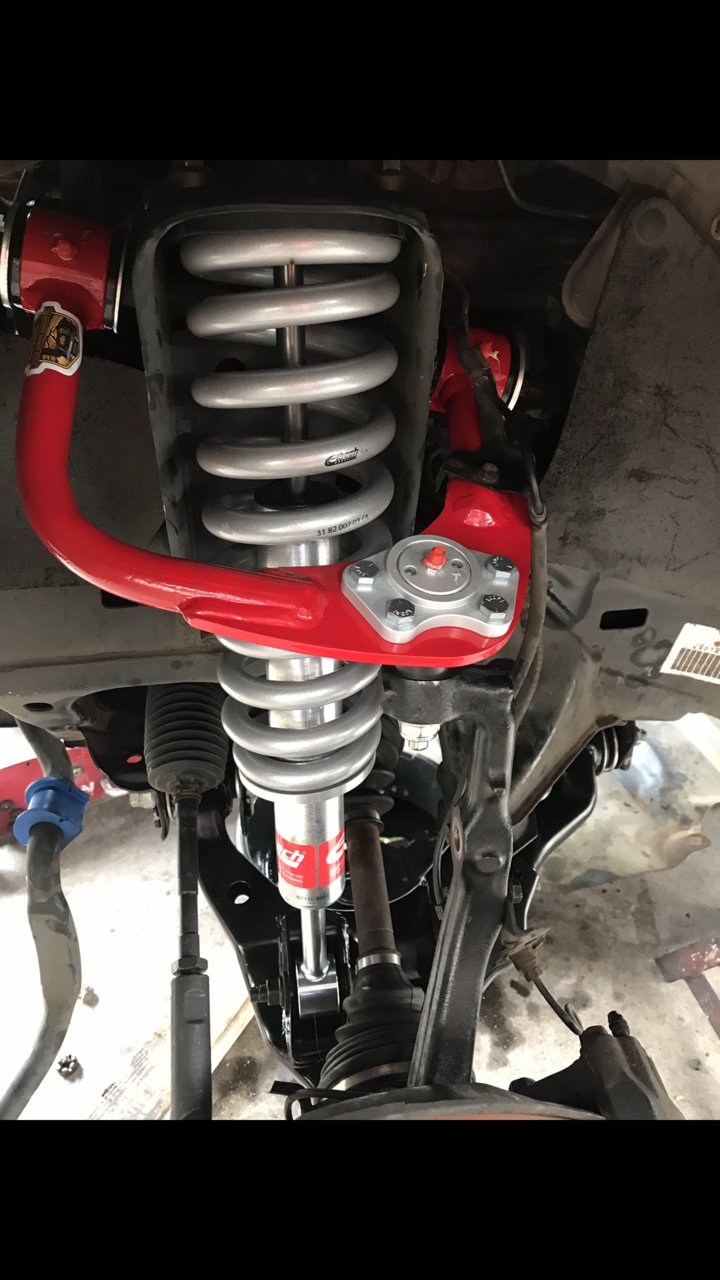

    JBA UCA, Eibach Springs, Bilstein 5100s, 2.5" AAL
    Just installed my JBA control arms with the Eibach 2.5 springs and it made a world of difference. Very happy with how it rides!
