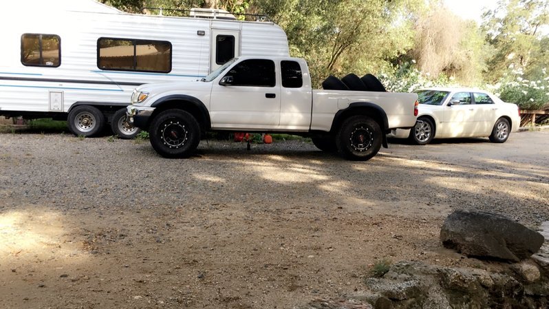

    Hey guys
    So I'm looking to buy a lift, I bought spacers not reading enough and learning about my truck :humble:
    Lol so I'm really looking for the best kit to make my truck have a lifted level height I got a 2001 Tacoma extra cab pre runner 2.7L, i almost bought a 3" bilstein lift and then read I shouldn't buy it because my trucks to light and it will raise it over 3" and give a really stiff ride...
    I'm not made of money what are your ideas? All are welcome !!
    :help:
    (My truck dosent sit even like the picture shows I had tires in the back)
