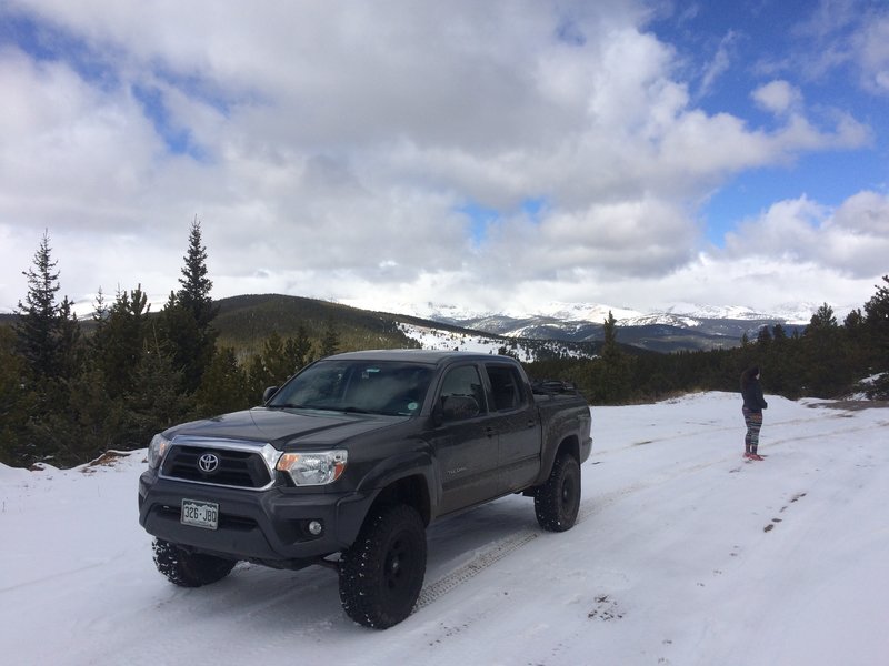

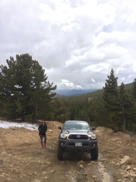

    Just got back from the mountains. The 6112/5160 combo worked out amazing! Between the tires and the suspension, I had way more confidence on the trail.
    Anyways, it does sound like you have a reason for a lift. If you're looking for a budget option, go for Bilstein 5100s. A colleague of mine who builds rock crawlers recommended the 5100s for me.. I decided to upgrade the recommendation. Make sure to keep installation costs in mind. I was blown away at the quotes. I attempted to install myself, but the front didn't cooperate with me. I got the rear installed myself... it was pretty easy. I had help. $780 to install the front with a proper "off-road rig" alignment.

    What a great looking truck! Love it! Thank you for the recommendation of Headstrong. I contacted them, wrote back right away. Think I have found what will work. I was wondering about the install myself. I have installed struts/coils on a my old car, Stock Honda Element. It wasn't too hard but when reading all about lifts, I have decided to let the pros tackle it. :) I am looking at adding 2.5" of lift. I am hoping that my new 285x70xr17 tires (less than 3 days on them) will work okay for that small lift? Once those tires wear out I will go bigger. I really like how your truck looks with that lift - really clean. It sounds like the back suspension isn't to bad, add a leaf, etc. The front is my concern as from what Headstrong said, it all depends on the factory wear and tear of the truck and it might sit lower than expected. That is my big concern, I certainly don't want the front higher or lower than the back. Headstrong also said than a 2" or even a 2.5" lift doesn't require new control arms but it certainly helps with alignment. I have decided that I will purchase those with the lift. Sounds like you had a great time in the mountains (Live in Lake Tahoe myself for 12 years, miss the mountains).
