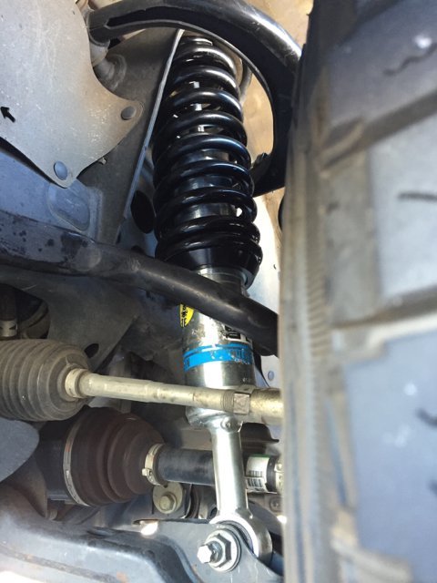

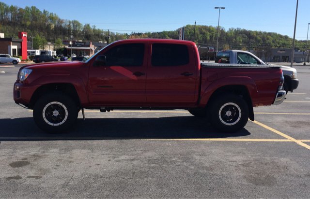

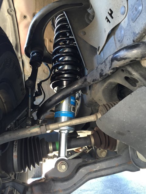

    Had these installed today. DCSB 4x4. Installed on 3rd notch. Right now both sides are at 2" over stock height at that location day one. I'm sure they will settle. 1/4 top plate on driver, it's still 1/4" lower on driver side (was stock too). I'll miss that on the adjustable style. 1st pic is driver, 2nd passenger. 11e248d0be4f7c8a9d246c1dc4d89b5f_059a778e303f49c6dc9ab18e40836d640641026f.jpg23665fdf1da1cec541f053a04118fe7e_36ff253a59168696241b1a972590cfae5037b59d.jpg1ead8360caa658845068d5dc4d52ffb8_3e9d35265dd8ecc4b2bb30f9a518e22da796bd25.jpg

    No lift. Standard 3+1 factory. Sits pretty level. Looks like it has some bro lean in that picture but I can't see it when I look at it in person.
