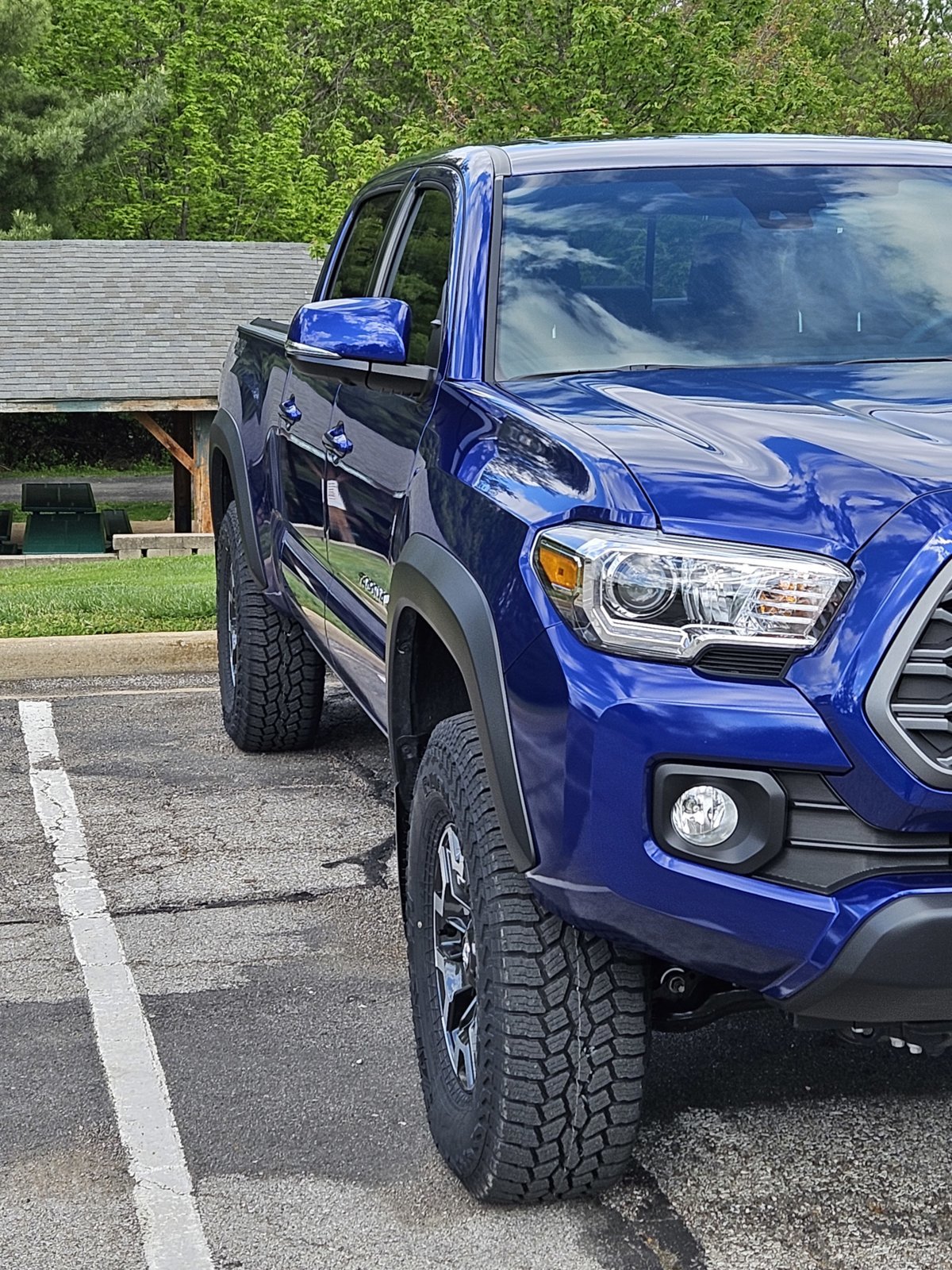

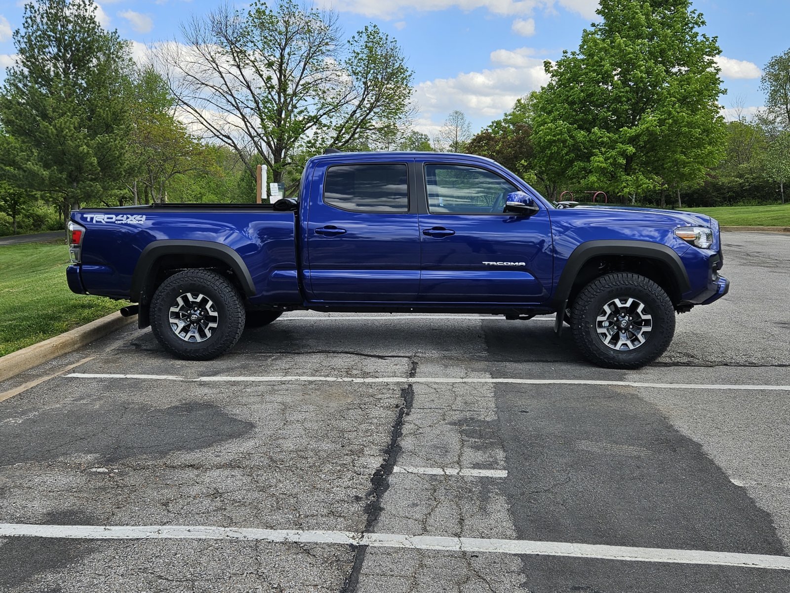

    Just did mine. 5100's. Clip in #3 for 1.1" in the front. Did a 1/2" Headstrong shim on the driver side rear leaf for taco lean. Back sits 3/8" higher than the front. Falken 265/75r16.
    Edit... if u often carry loads I would do a 1" block or aal in the rear... and then maybe front on clip position #4.

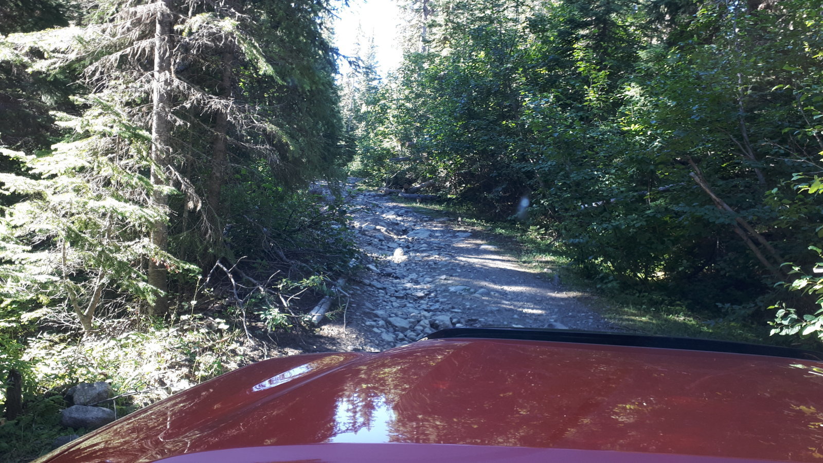

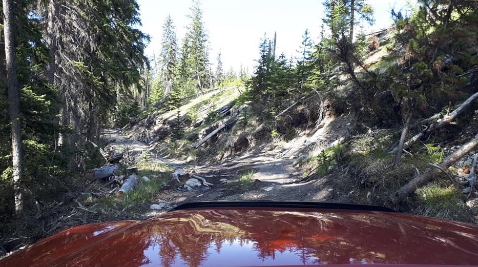

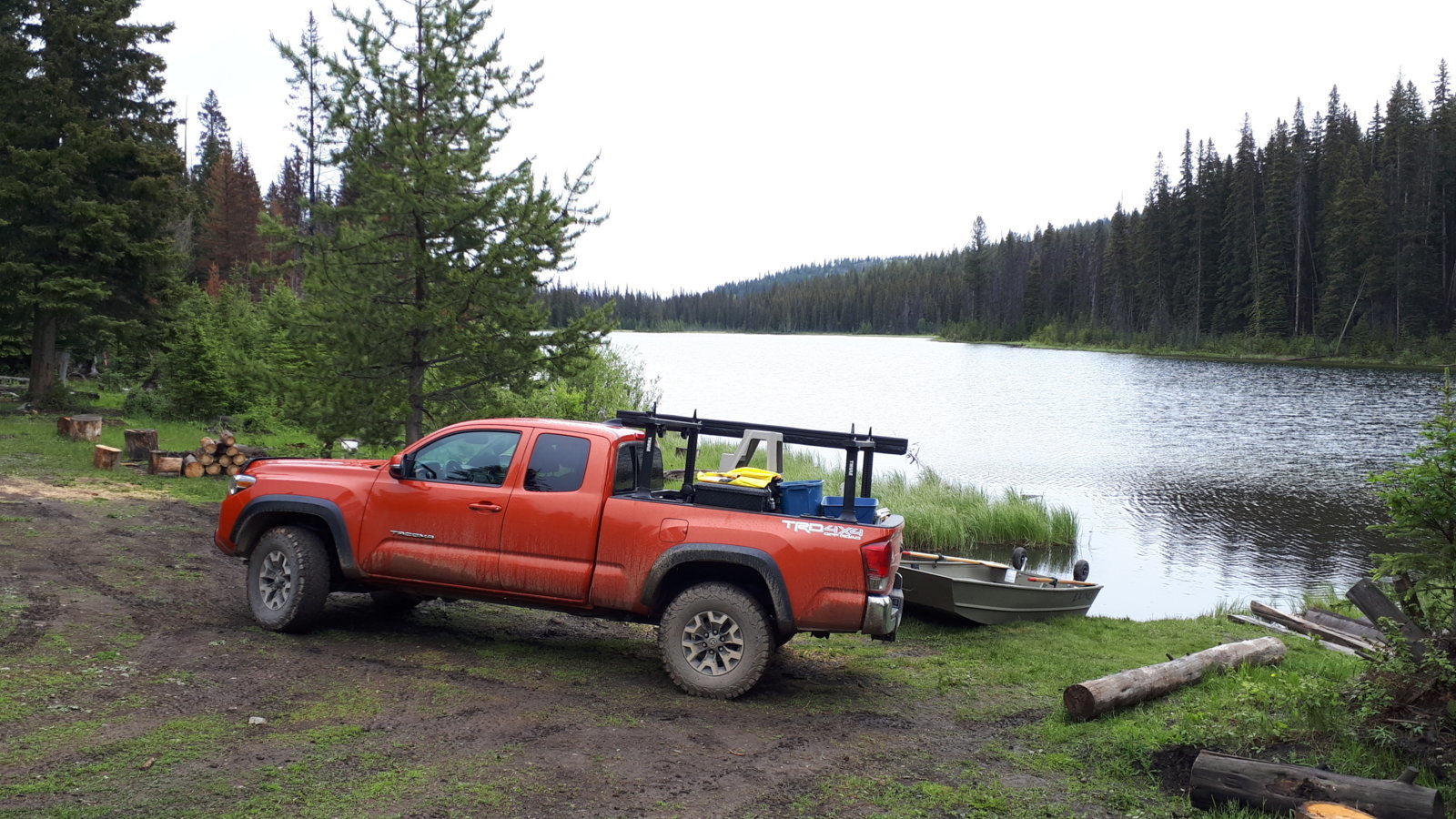

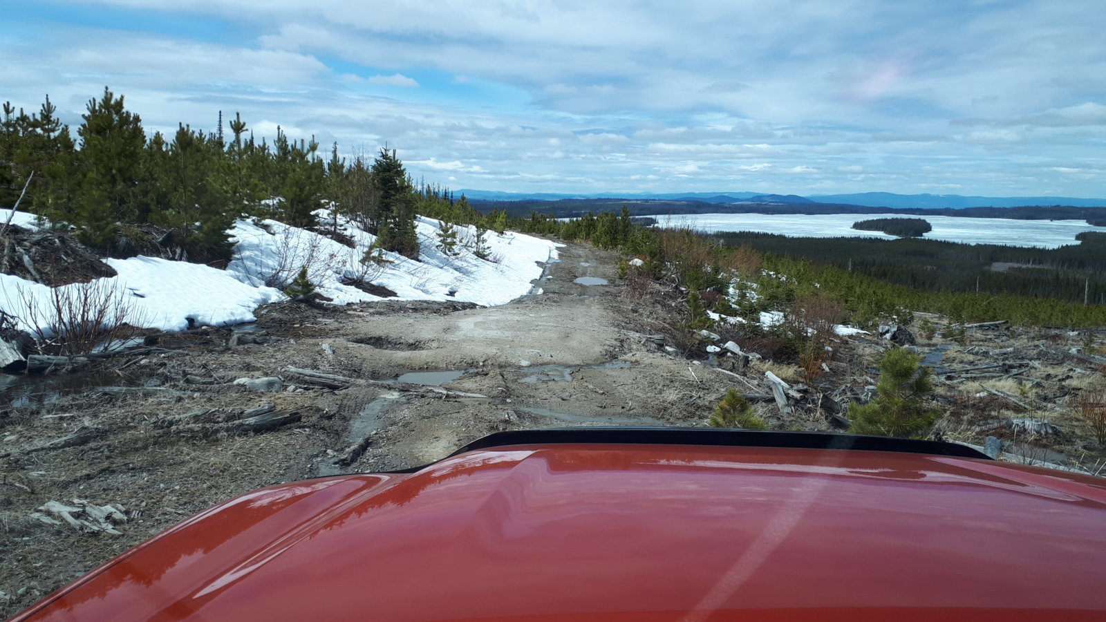

    Just added toolbox and roof-rack to haul my fishing boat 100's of miles into the backwoods every week. Goodrich K02s, Bilstein 5100 front and back, no lift.
    Hey I know lots of guys insist on a lift, for off roading or just appearance sake. Guys into serious rock crawling need it.
    My first Taco, but 4th 4x4 in the last 35 years. All used primarily for remote off road fishing trips in the southern half of BC.
    My 2016 Taco for the past 5 years is off road every week, and sometimes twice per week.
    No lift on any of my 4x4s and these are for the most part bad deactivated trails. Never broke any of the trucks, other than wear and tear replacing CV axles, inner bearings, etc.
    I have over 25,000km off road on my Taco now. Just replaced my ujoints, swaybar links and my third inner needle bearing. ECGS put in this time. CV axles changed too. Just stock replacement on those. Frequent off roading and that is to be expected.
    I do have Bilstein 5100, but no lift. Firestone air bags in the rear as I carry up to a thousand pounds in the back for my frequent remote fishing trips. I seldom see another person on my trips.
    Don’t underestimate what the trucks can do in mostly stock form. I really like the look of a lifted truck, but I personally don’t need it.
    These pics are typical of my offroad trips.

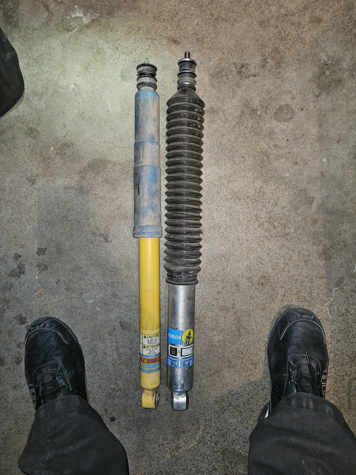

    The blue and yellow rear stock shocks on 3rd gen Offroad models are made by Bilstein. Rear 5100s are fatter but just a shade longer length as the stock Bilsteins.

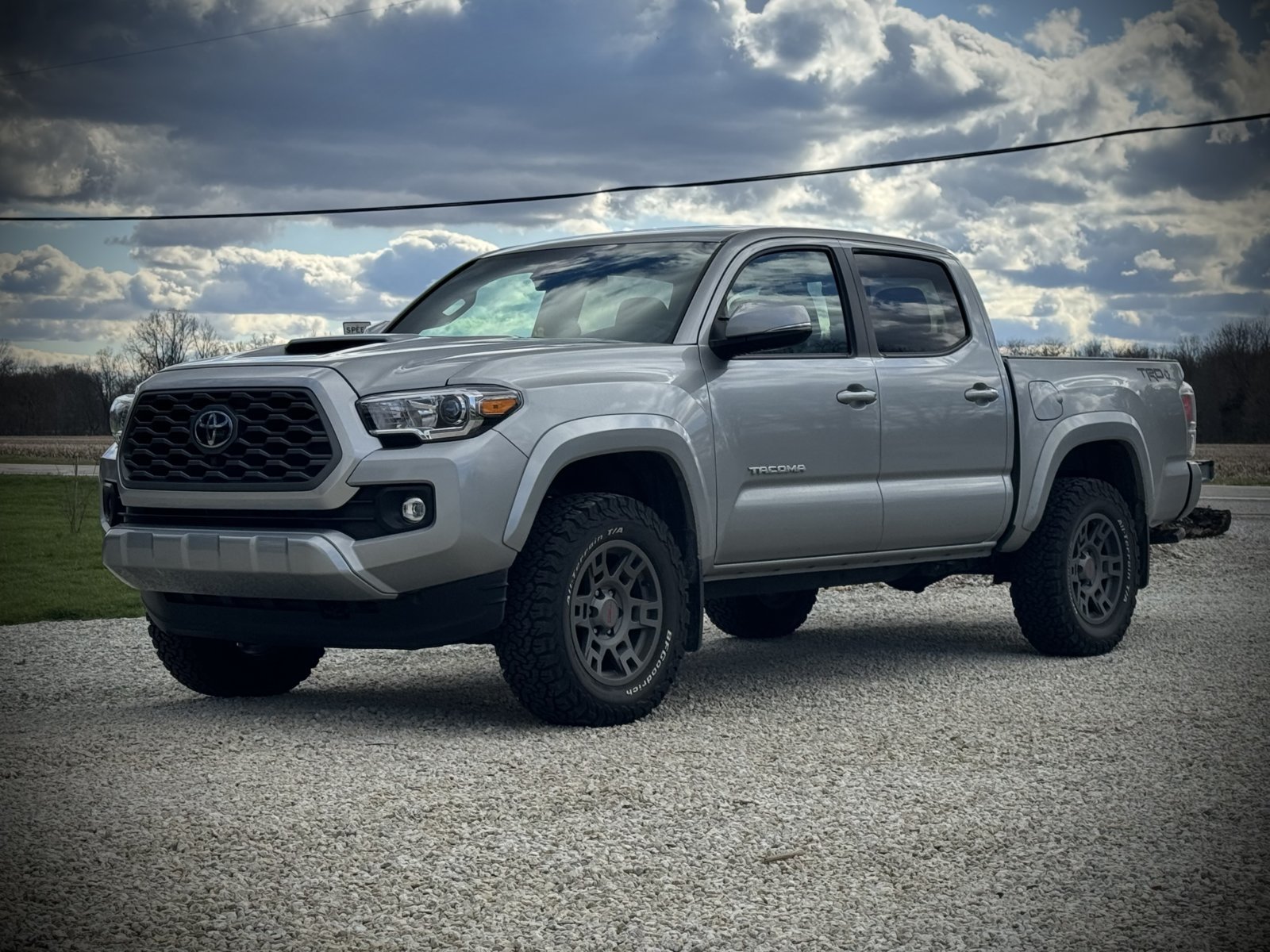

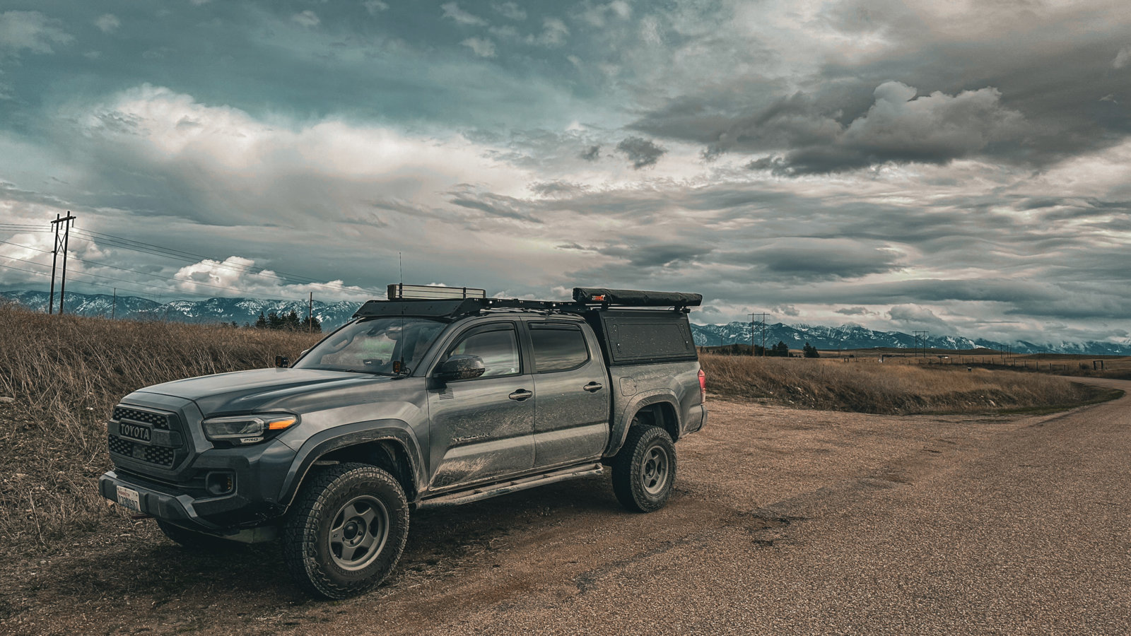

    OTT Tune Front 2" lift OME 888 coil Bilstein 5100 DuroBump extended front bump stops Archive Garage extended rear bump stops Rear 1.85" lift Icon RXT leaf pack Bilstein 5100 SPC UCA DX4 16x8 +10 wheels 285/75R16 KO2 viper cut CMC sway bar delete exhaust reroute exhaust cut just past the rear axle U-bolt flip LFD engine skid plate RCI transmission and x-fer case skid plates Spindle gussets
    I will throw my 2cent in: for a DD and not wanting/needing to much just throw on some 265/75R16 - they look good and fit with no issues and you can do some easy trails definitely rutted gravel roads and forest roads. This is my Taco on stock suspension just 264/75R16 - It's on a trail rated "Easy" but this set up was great as a DD.
    The next step for moderate trails and maybe some trails with some technical spots but nothing serious for sure and still be OK as a DD I went with Bilstein 5100 front and rear, these are entry level shocks for off roading and not too expensive - if you are going to get really serious about rock crawling then you will need something way more than 5100s. I got my lift 2" lift in the front with OME spings not with the 5100s and got just shy of 2" with Icon RXT leaf pack. I went with 285/75R16 on DX4 wheels. I also got an OTT tune. I wanted to make sure I did not have to deal with rubbing so had a viper cut an CMC done. For a DD this would be overkill but like I mentioned I want the best of both worlds - an Ok daily driver (although I sacrifice some MPG) I also want to be able to do some moderate trails.
