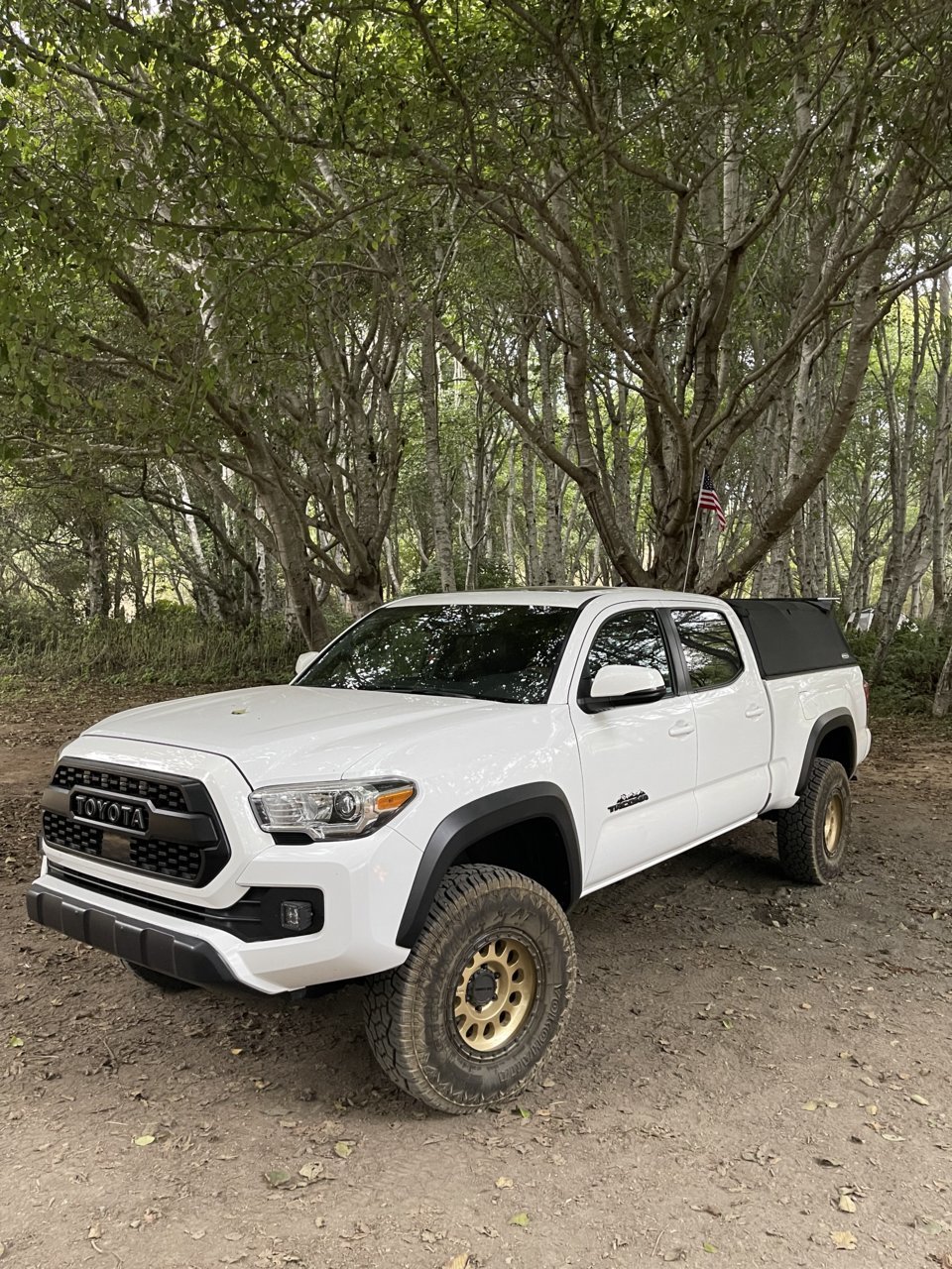

    265/75/16 though still look good IMO
    6112’s 6/5 setting 5160’s rear

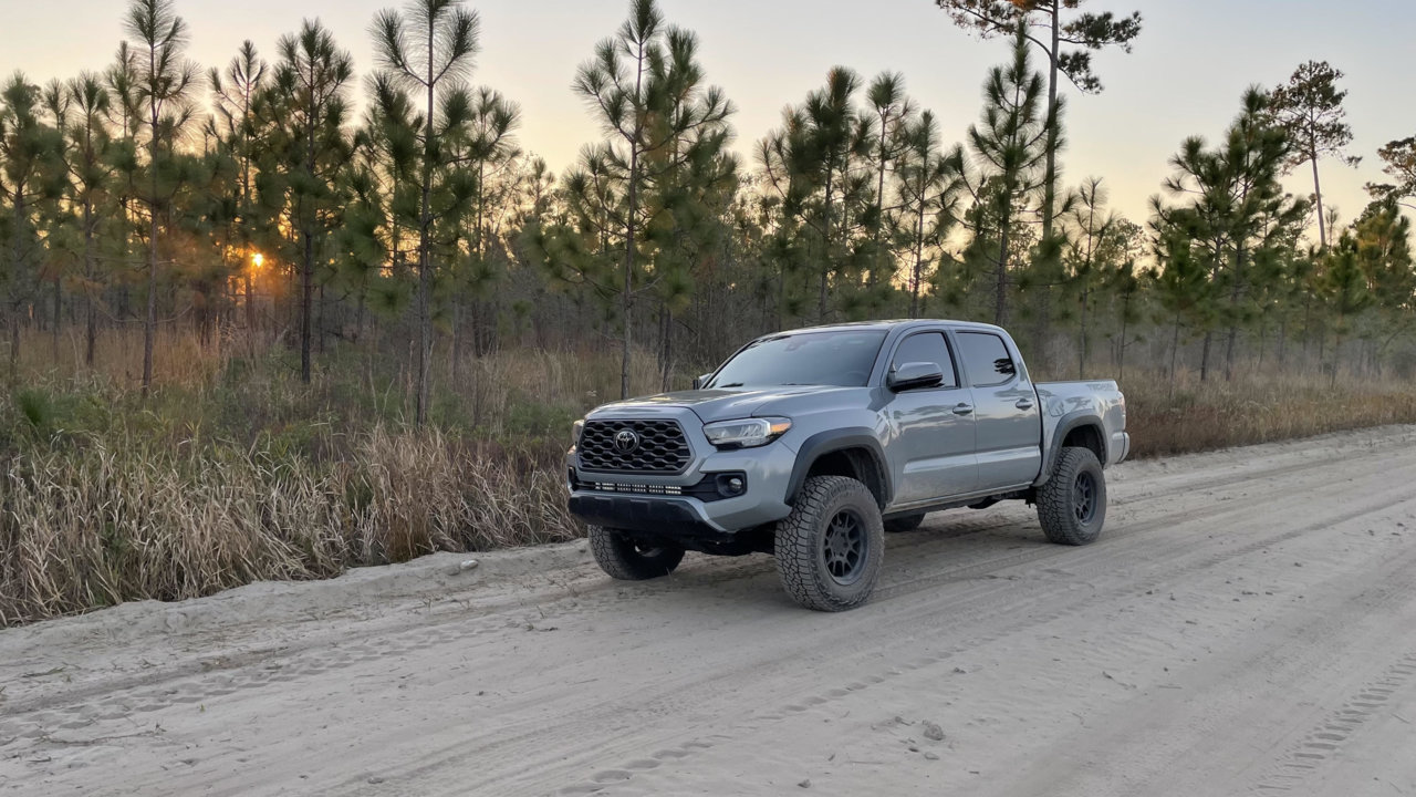

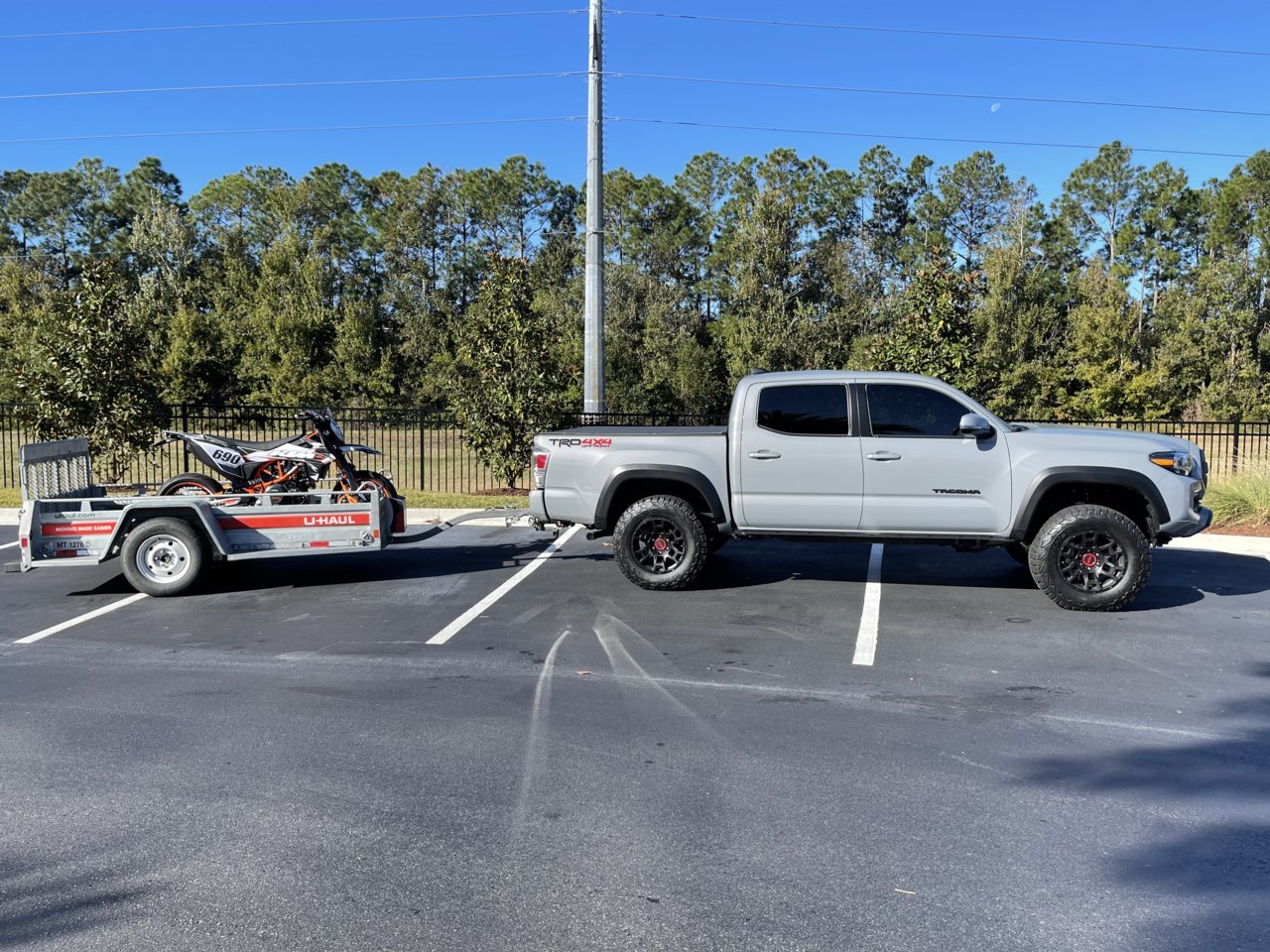

    I have the exact same set up that you’re planning to do 6112/5100. 5/4 up front for 1.5” lift and 1” rear block. 265/70/17 KO2

    I honestly couldn’t be happier with this set up and look. I definitely will not go bigger in tire size. That’s like opening up Pandora’s box. Not looking into trimming or doing a cmc on my baby. With this lift the tire size is perfect. Looks way more aggressive than stock.
    As far as power goes I haven’t really noticed any changes exact the gas mileage lol. Stock I was averaging around 22-23 mpg and now I’m at 17-18 mpg
    I’ll take some pictures here shortly

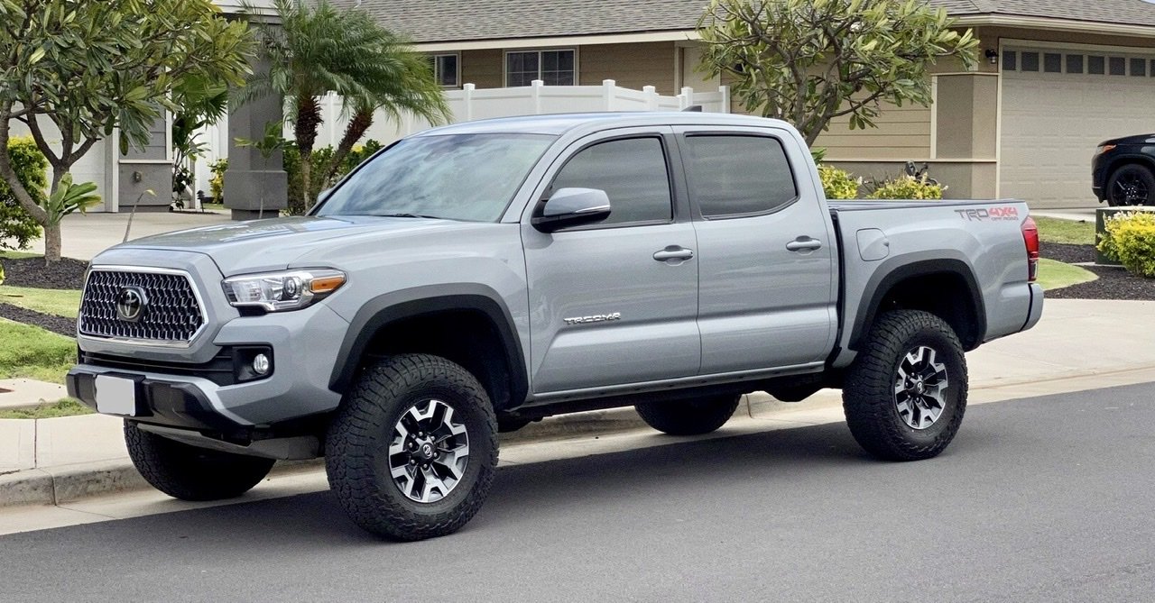

    265/75/16 Wildpeaks with 1.25” wheel spacers; Bilstein 5100s on 4th clip (1.55) and AAL on back. Other pics of the same tire and rim size seem to look better. I won’t go bigger but can’t figure out why my tires look smaller than other with same setup.

    Probably with the factory 16x7 wheels and no negative offset, imo a wider wheel with negative offset makes the tires look bigger

    They shouldn't if they are the same brand of tire.
    But the numerical tire size varies from manufacture to manufacture. Not all 265 are physically the same size.

    86429971-DDDC-4ED7-B3EE-1A12686B5A34.jpg 4BBFFAE3-E618-4F9A-87E2-95612A92D7D9.jpg

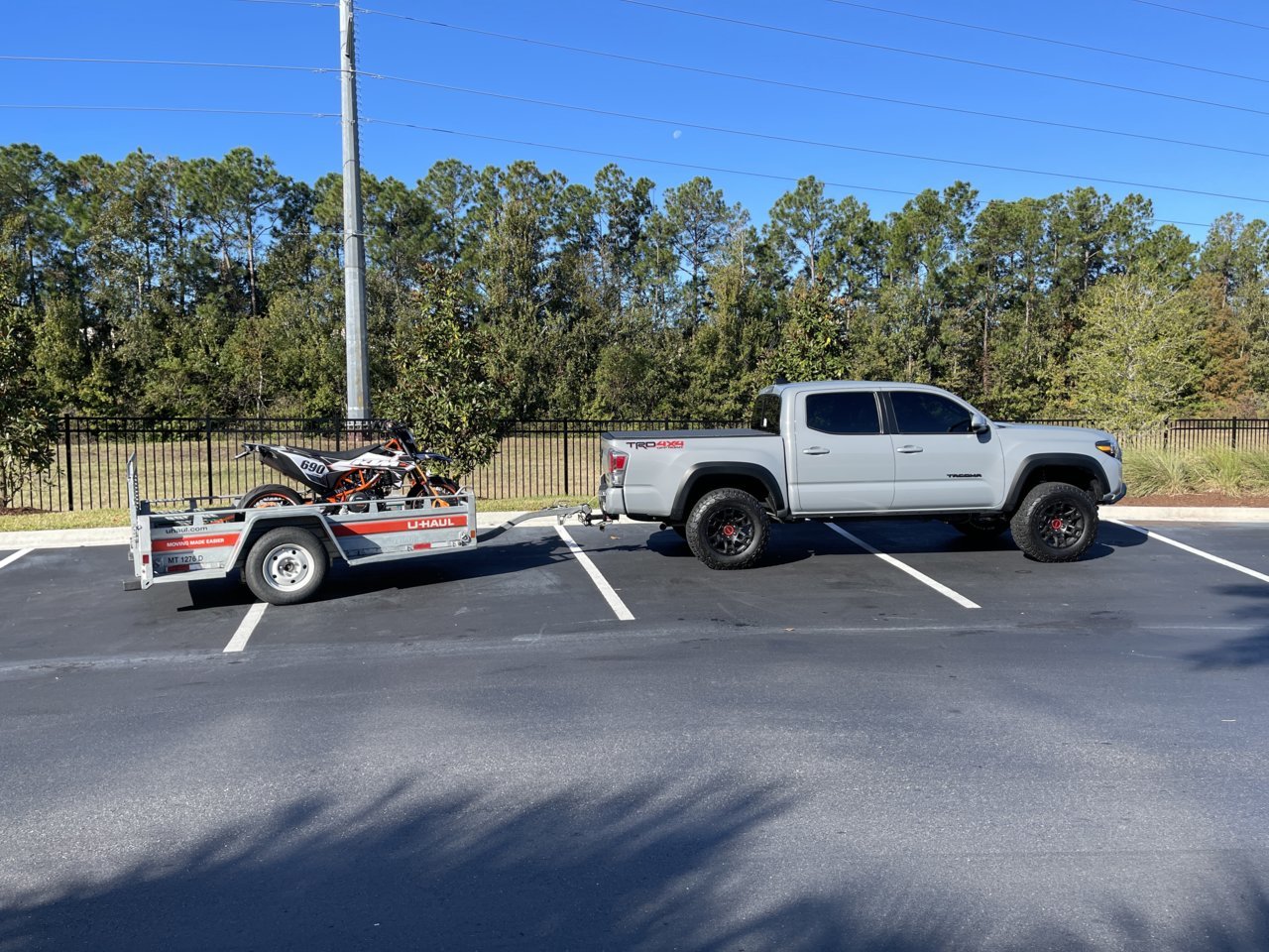

    Your picture is exactly why I bought my truck, except there will be Honda Goldwing in the UHaul trailer. Which size trailer is that?

    Yeah that's one of the reasons I got the truck also. The trailer is uhaul's motorcycle trailer 7'8" x 3'9.5". Your Goldwing should fit in there fine.

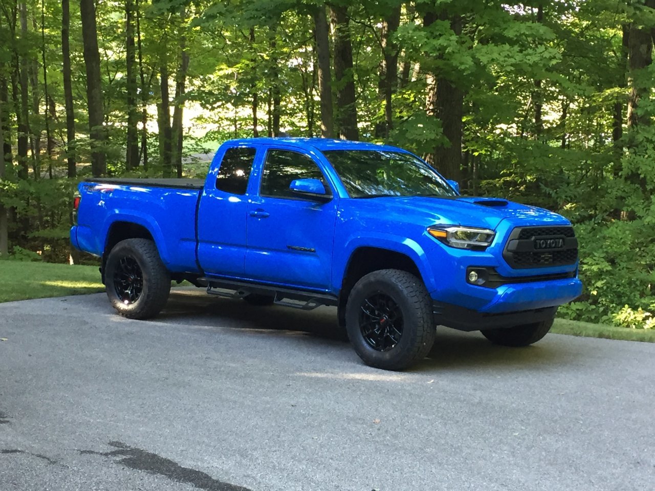

    Leveled with 5100s on 265/70/17s.

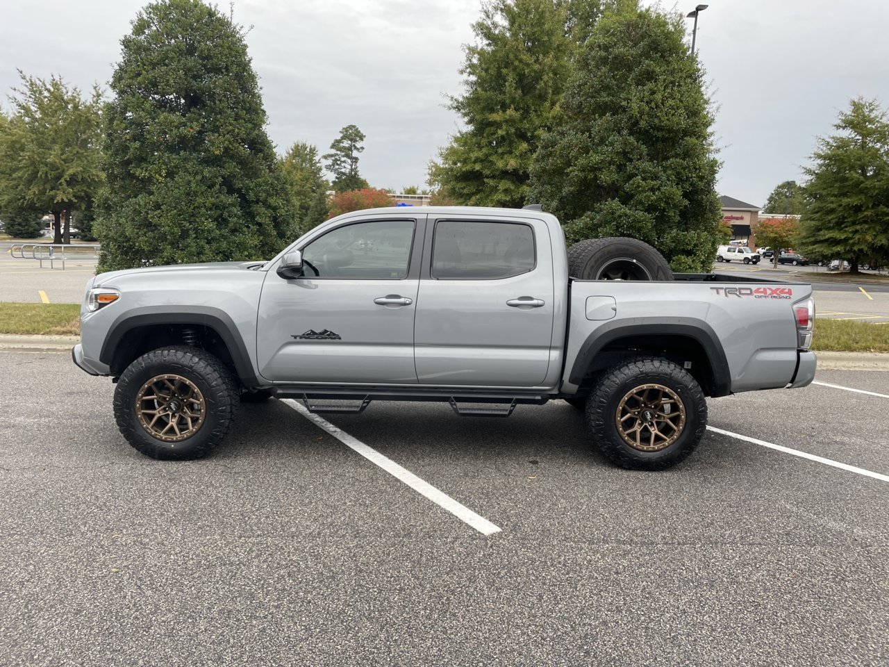

    Eibach stage 1 on first setting. 1" eibach block in back. 265/70r17
