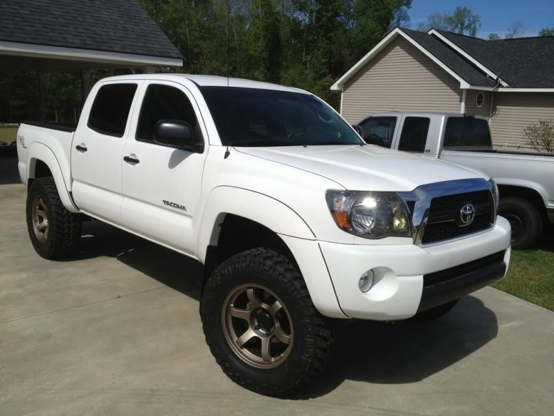

    I just installed the ome lift on my truck from toytec and I love it I'm running 285/65r18 and only had to trim a little bit of my fender liner. I'm very happy with the lift so far I do not off road my truck tho I have another truck for all that.
