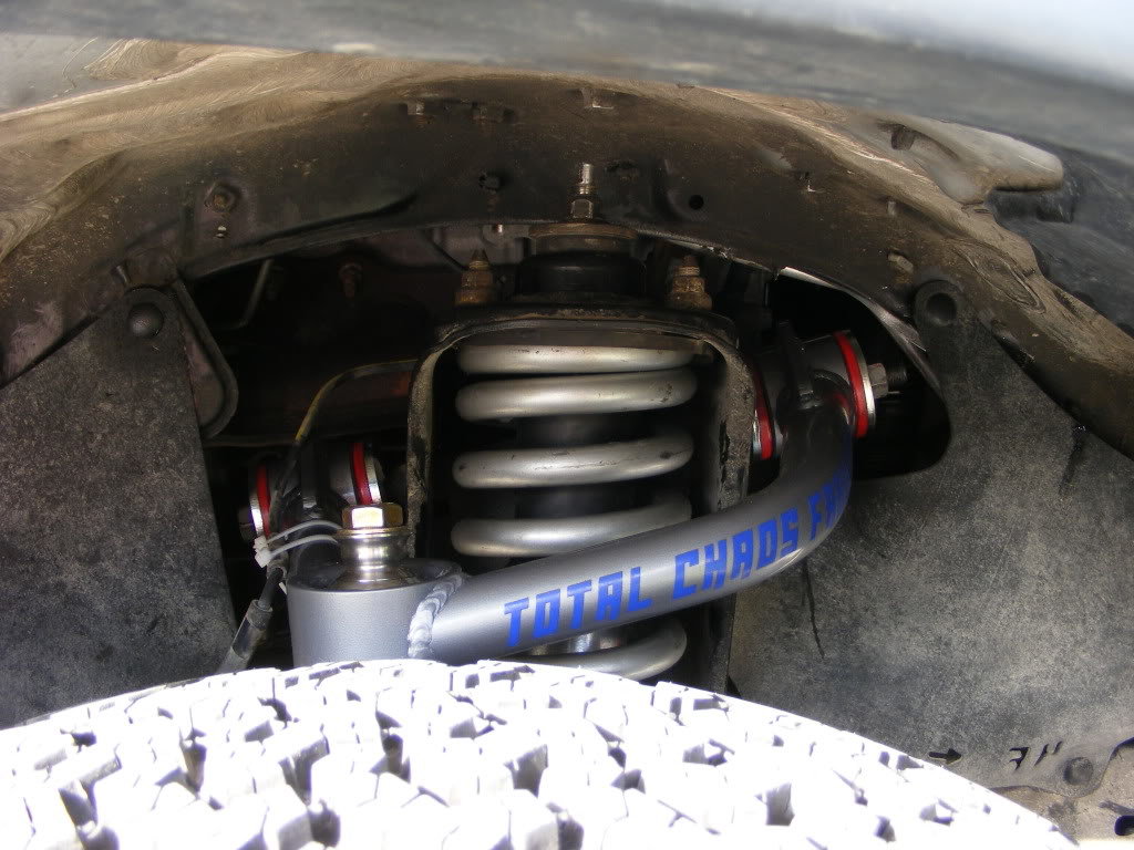

    I took a vacation day on Friday to work on my truck.

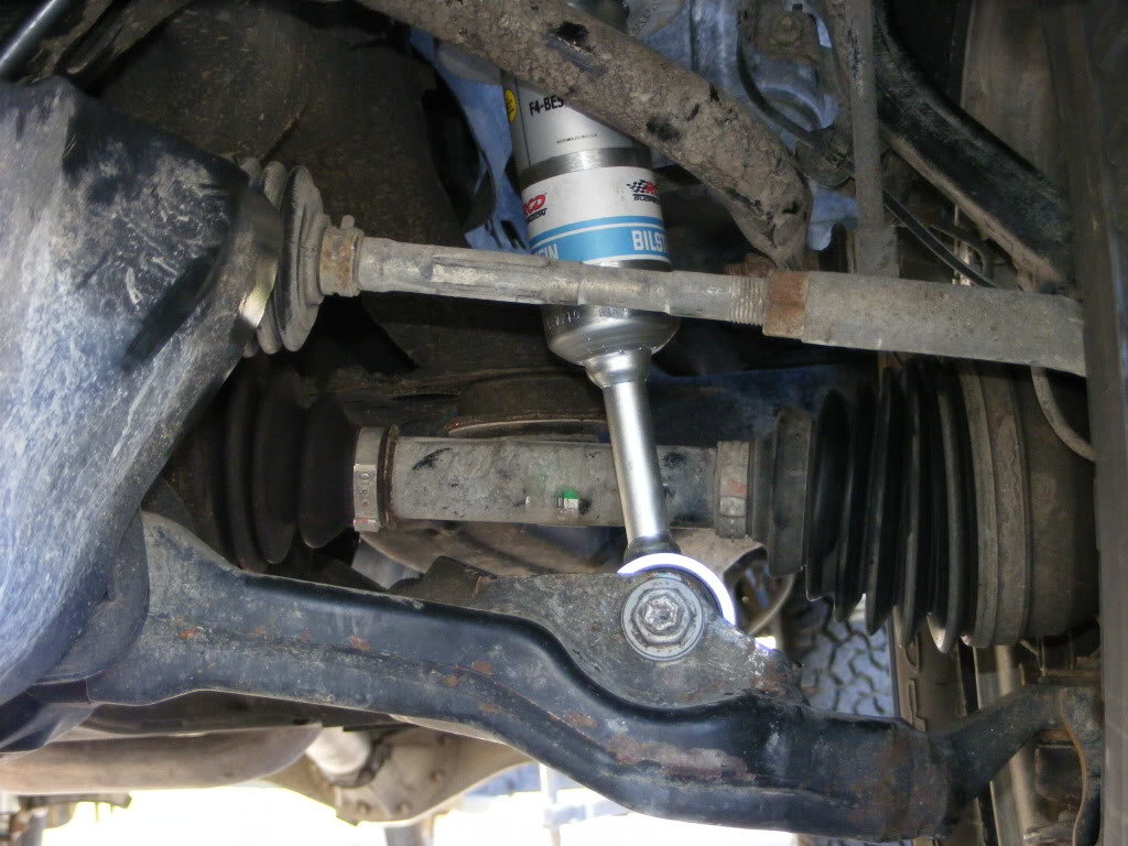

    Between my neighbour and I we set up in the driveway to install 5100's up front (set to 0.85") with Eibach 1.6" lift coils. We also changed out the stock UCAs for Total Chaos UCAs.

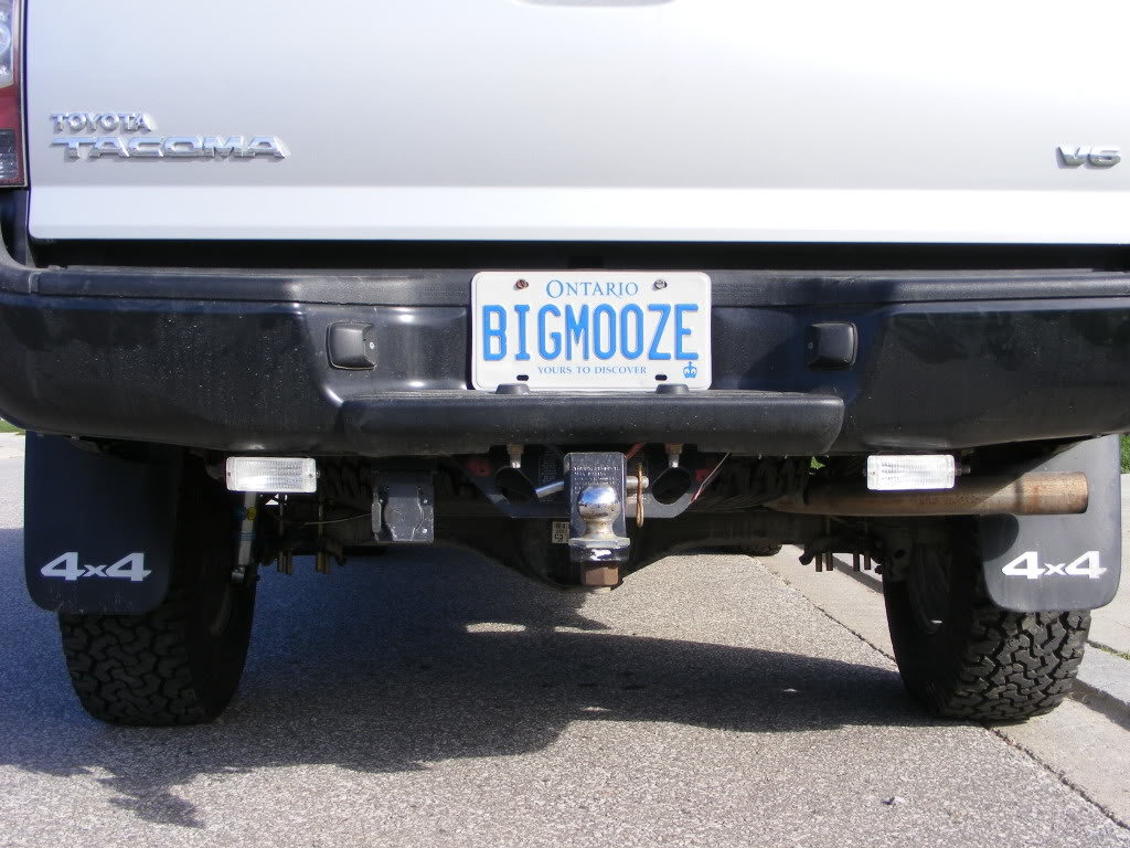

    The front complete (it took about 6.5 hours), we set up on Saturday to install a Toytes TSB AAL for 1.5" of lift at the back. Also changed out the stock Billies for 5100's. The back took only 3.5 hours.

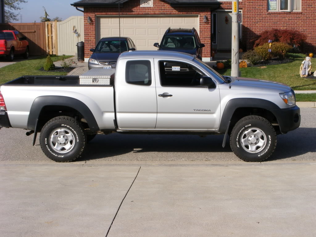

    Now I thought my truck looked cool before, especially with the new BFG 265/75/16's, but this new setup looks AWESOME in my opinion. The stance of the truck is so much better now. I'm so glad we did the work ourselves, I have a great sense of accomplishment.
    I ended up taking the new shocks/coils to a shop up the road because I could not remove the spring compressor from the coils when they were mounted. The coils were too close to wiggle the tool free. That was the only "outside help" we had. Changing out the UCAs took a bit of patience/bending of the fender walls, but all in all, the install was trouble free.
    Tomorrow I have to get the front end aligned, then it's drive drive drive.

    Did you install a Diff drop as well? Those angles dont look bad at all. I was planning on setting the billies at 0 with the eibachs but yours looks great.

    you might consider trimming those leaf bolts back if you ever plan on offroading

    Will do. I trimmed them back by a half inch already but I'll get them again tomorrow. Thanks.

    No diff drop. I was pleasantly surprised at the not-too-bad-ness of the new angles.

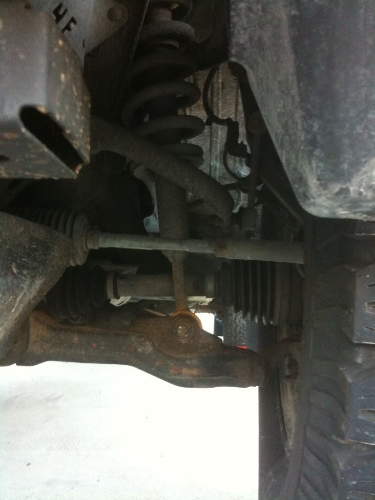

    Just curious about the rust in pic 2 and 4 ? On a '09 ? Curious George:confused:

    Yeah the rust sucks. I drive a lot and the road crews salt the roads a lot come winter. I have the truck oil sprayed (Krown) every year to try and minimize the salt damage as much as possible. Some parts still take a hammering.

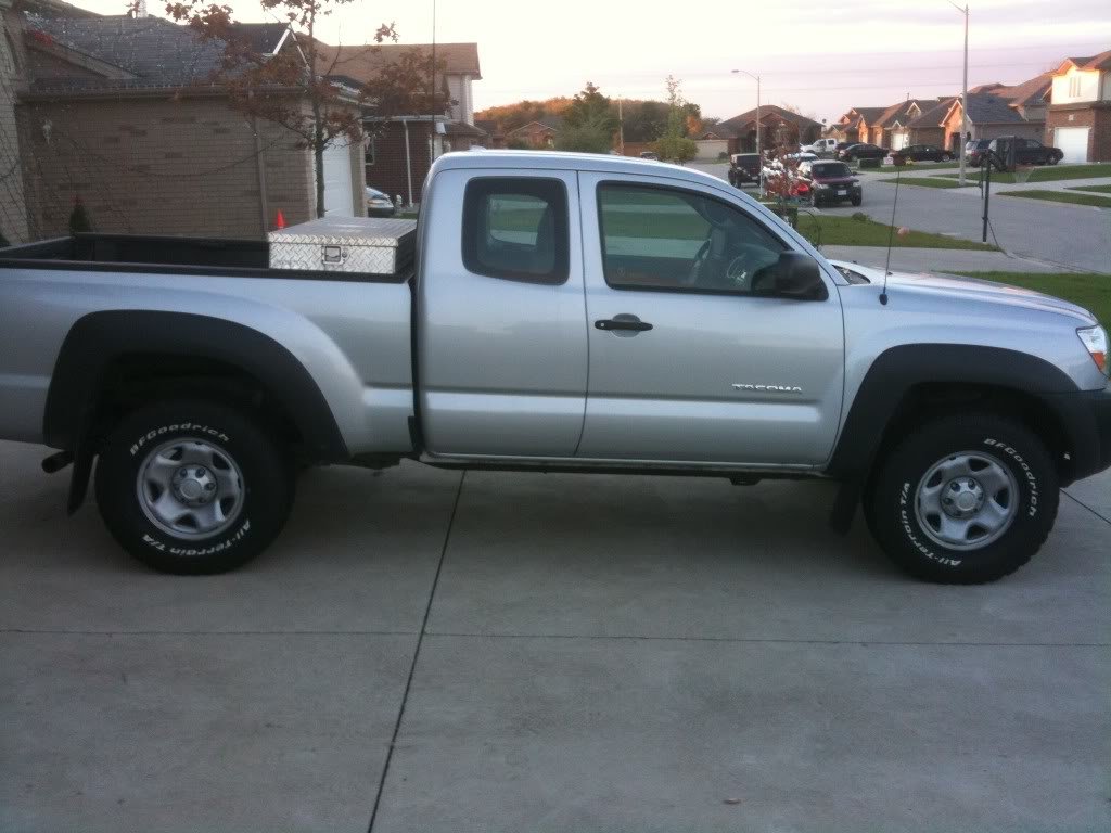

    Looking at picture #6 (rear end), do the U-bolt plates look "rotated" too much around the bottom of the axle? I wonder if they should be loosened and pushed forward.
    Each bolt is torqued to 73 ft-lbs.
