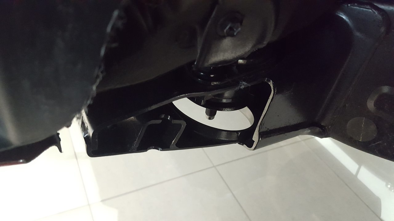

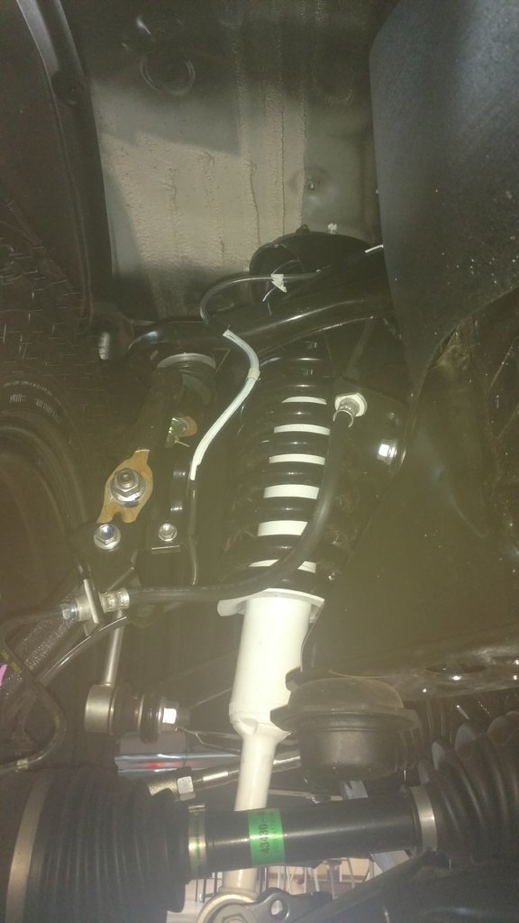

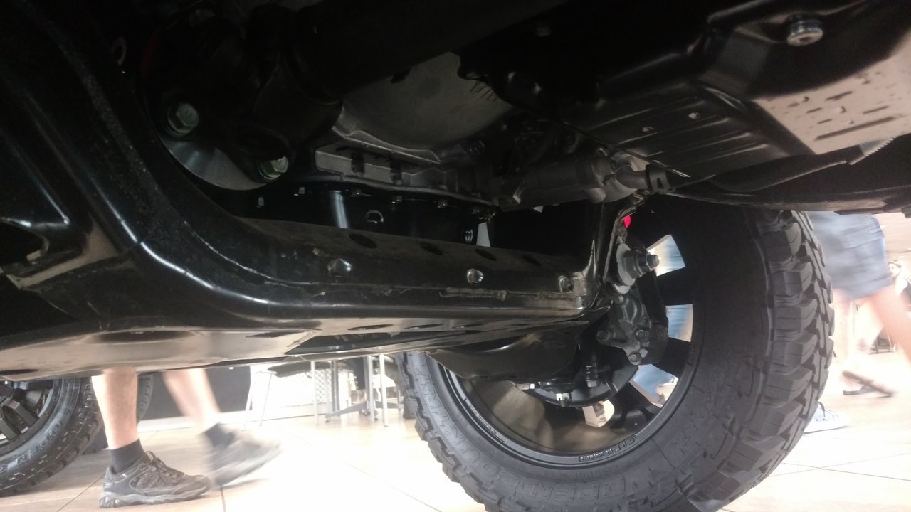

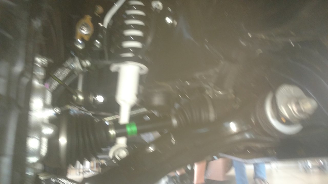

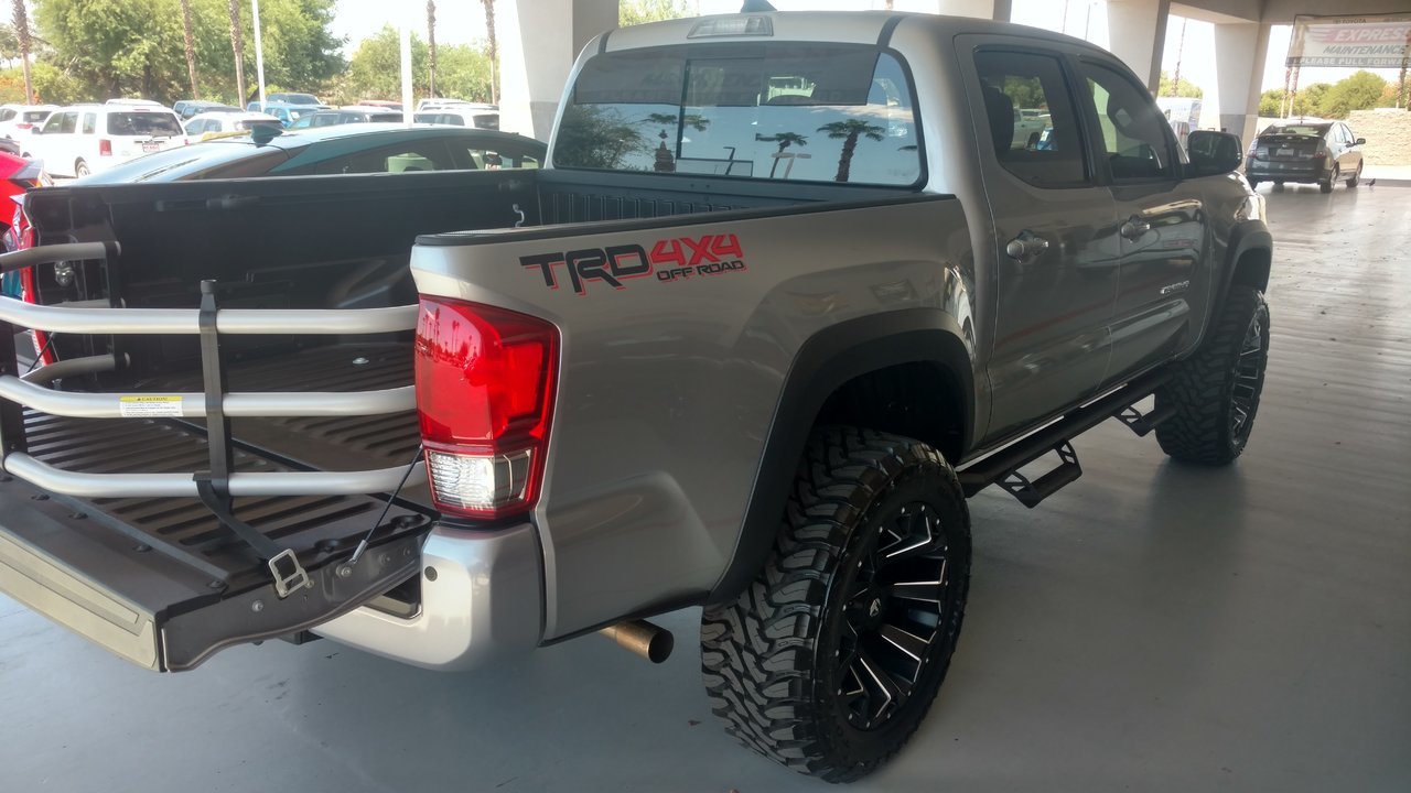

    most on this forum do not like pro comp kits or blocks.
    looks like they leveled it with 3 inches in the front and 2 in the rear. the front needs new upper control arms, i'm quite sure the alignment is way off.
    you can piece your own lift kit together for fairly cheap. bilstein 5100 w/ ome 888 springs in the front, new upper control arms SPC or JBA would be my preference, rear 3 leaf progressive AAL. Probably everything will run you about $2-2.5k

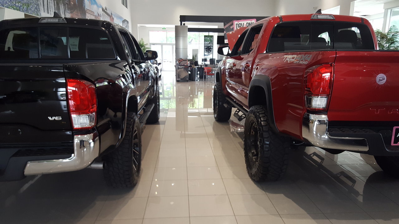

    AZN8TV
    AZN8TV [OP] Member
    Aug 29, 2017
    #228492
    7

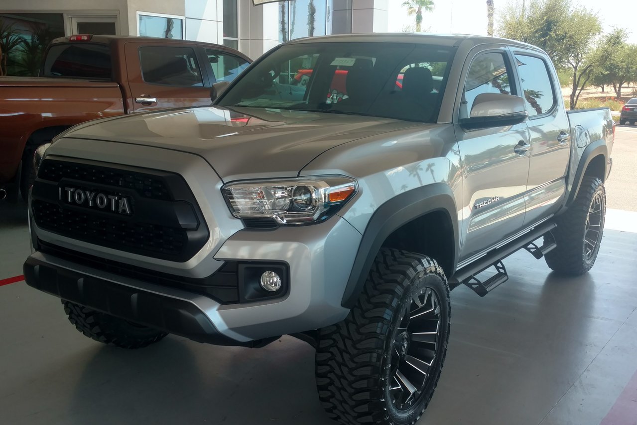

    So, again, this is supposedly a "Pro-Comp, coil over" top tier lift. I drove this 2017 TRD Off Road in silver sky metallic back to back vs 2017 Tacoma Trd Pro on city streets and on highway and ran them over some rough dips, potholes and fast cornering. The silver TRD rode noticably nicer than the TRD Pro which surprised me.
    I'm wondering how the dealer supplied "Pro Comp coil over" would compare to this kit:
    https://bilsteinlifts.com/shop/toyo...-suspension-lift-kit-2005-2015-toyota-tacoma/

    That king kit will shit all over that dealers lift and it's probably significantly cheaper than the dealers lift. I highly doubt the shitty procomp lift performed better than the fox shocks on the pro.
    Also it will not void the warranty putting suspension on it, it only voids the parts that you replace. For example if the aftermarket shock fails, they're not going to cover it.
    Honestly, it seems to me that you're trying to get mental reassurance by this forum to purchase the truck with the procomp lift.

    How it would compare is that Kings would walk all over a ProComp lift and it's not even close.
    I think bottom line is, regardless of how it rides, looks, etc. the dealership is charging far more than that lift is worth.
    If you want to buy something with no hassle then spend the extra $$ from the dealership, but you can get something much more quality if you source parts yourself.

    If you can afford the mark-up that this dumb dealer is charging for this box of hot diarrhea they have slapped onto where a perfectly capable OEM suspension was; then you can afford to do it right. Guaranteed that the OEM stuff with the stock wheel and tire combo is more capable off road than whatever garbage Pro comp lift that is. They didn't even bother to get the correct length U-bolts in the rear- there is at least 2 inches of naked thread hanging under there. This is what happens when douchey salespeople that don't understand anything about suspension order a package deal from 4WP. Please do not buy this. Also Pro-Comp does not make anything "top-tier", their race trucks are using suspension components and shocks made by other manufacturers.

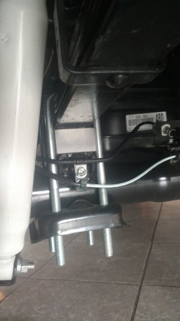

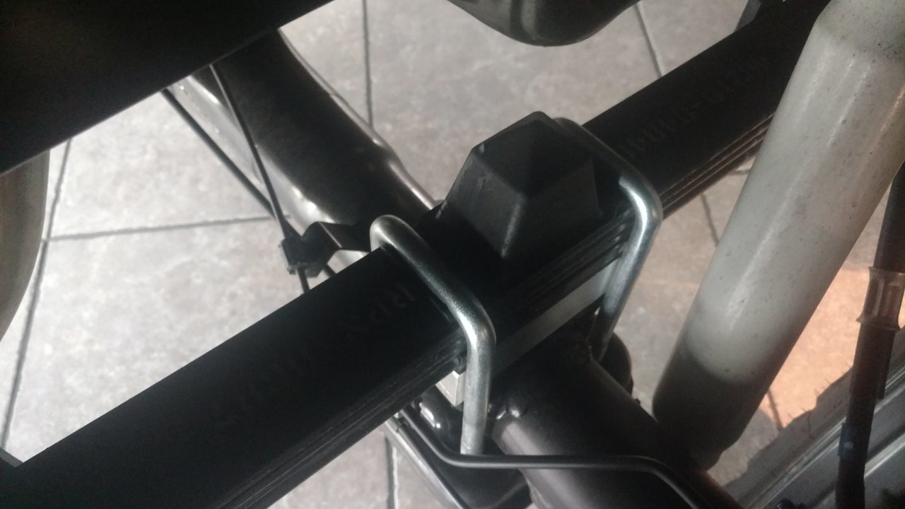

    That's junk. Crappy lift. Look at that shitty U-bolt install. Total crap. If you want SDHQ to install an Icon lift go buy the truck at riverview.

    stickers and sticker accessory's
    they seriously leave it like that?! from the dealer?
