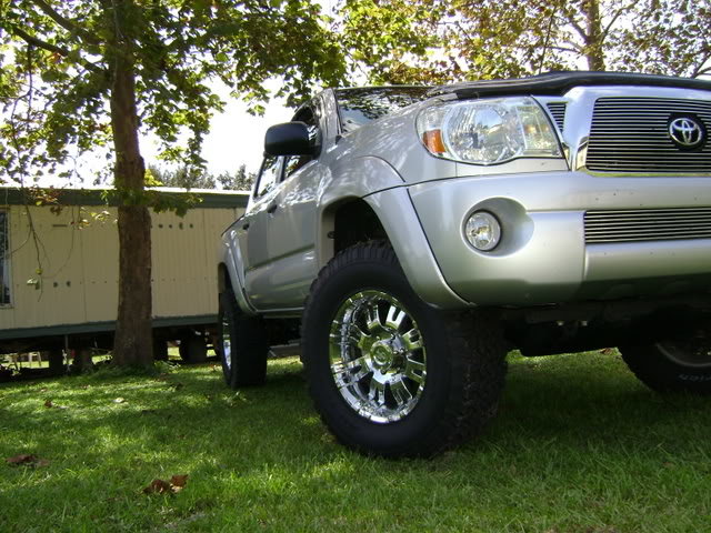

    6 on 5.5 4.5 backspace and 0 offset
    here are my rims procomp 6001

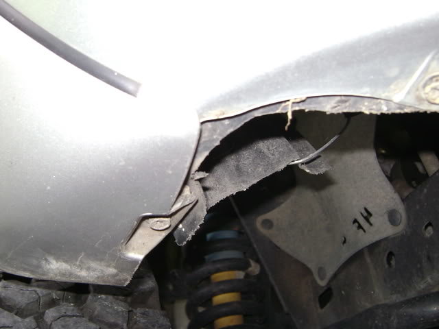

    Here are some pics of what I cut.
    Front plastic was cut so I zip tied it back to make sure it wouldn't rub. I cut with a razor knife.

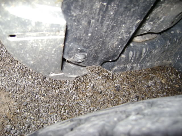

    Here is a shot of the square nubs in front of the tires, also cut with razor knife.

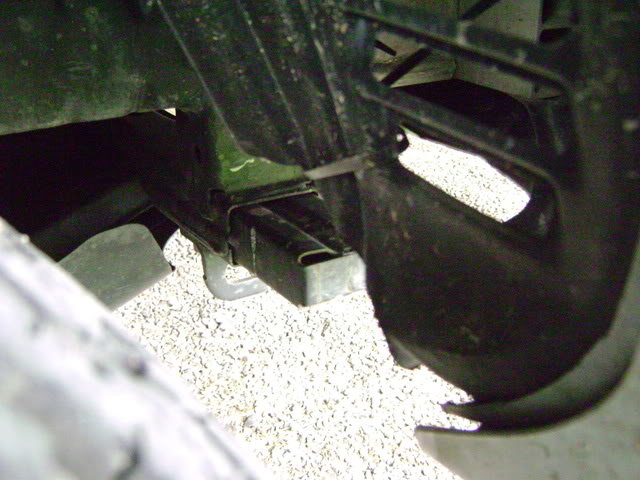

    Where I trimmed slightly after removing the front mud flaps.
    I would consider cutting the mud flaps instead of removing. I now have quite a few paint chips.
