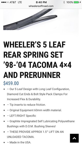

    04 DC 4x4
    This is what I thought you guys were talking about when you brought up wheelers leaf pack that sits 1.5" above stock. It's $459.00

    04 DC 4x4
    NVM. They don't say progressive

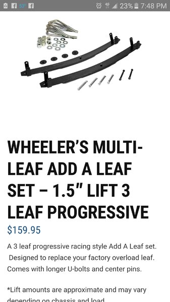

    Get to it later...
    Actually only $160 with the ubolts...I didn't see they came with them when I said $200. I'm still gonna go with the emu leaf packs.
