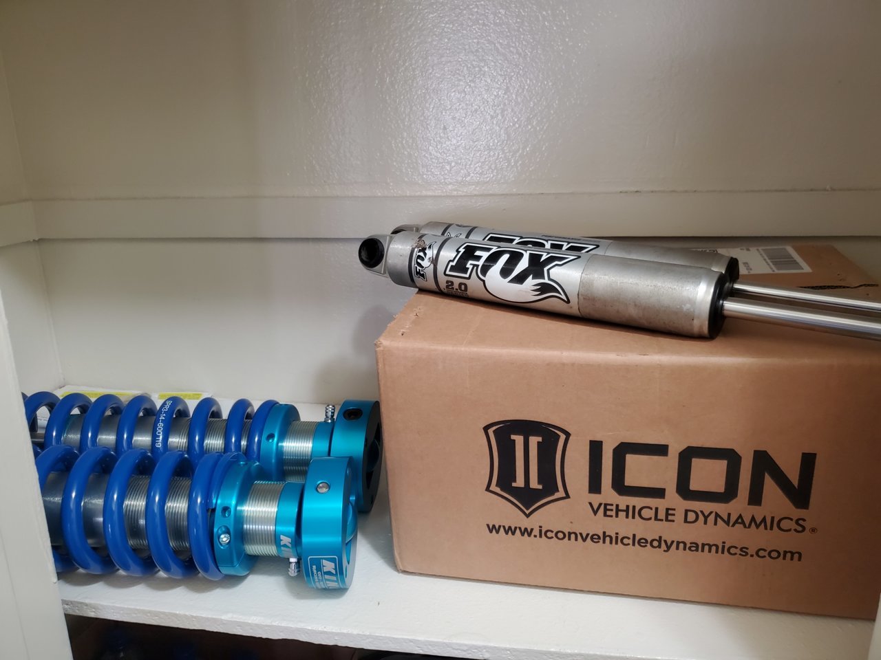

    Hey Kwikvette you have my fox shocks all boxed up to ship yet :)

    :rofl:
    They're just sitting in a closet

    next to some fresh kings!

    Yeah...too lazy to install them cause I'd have to install the UCAs inside the box. :anonymous:
