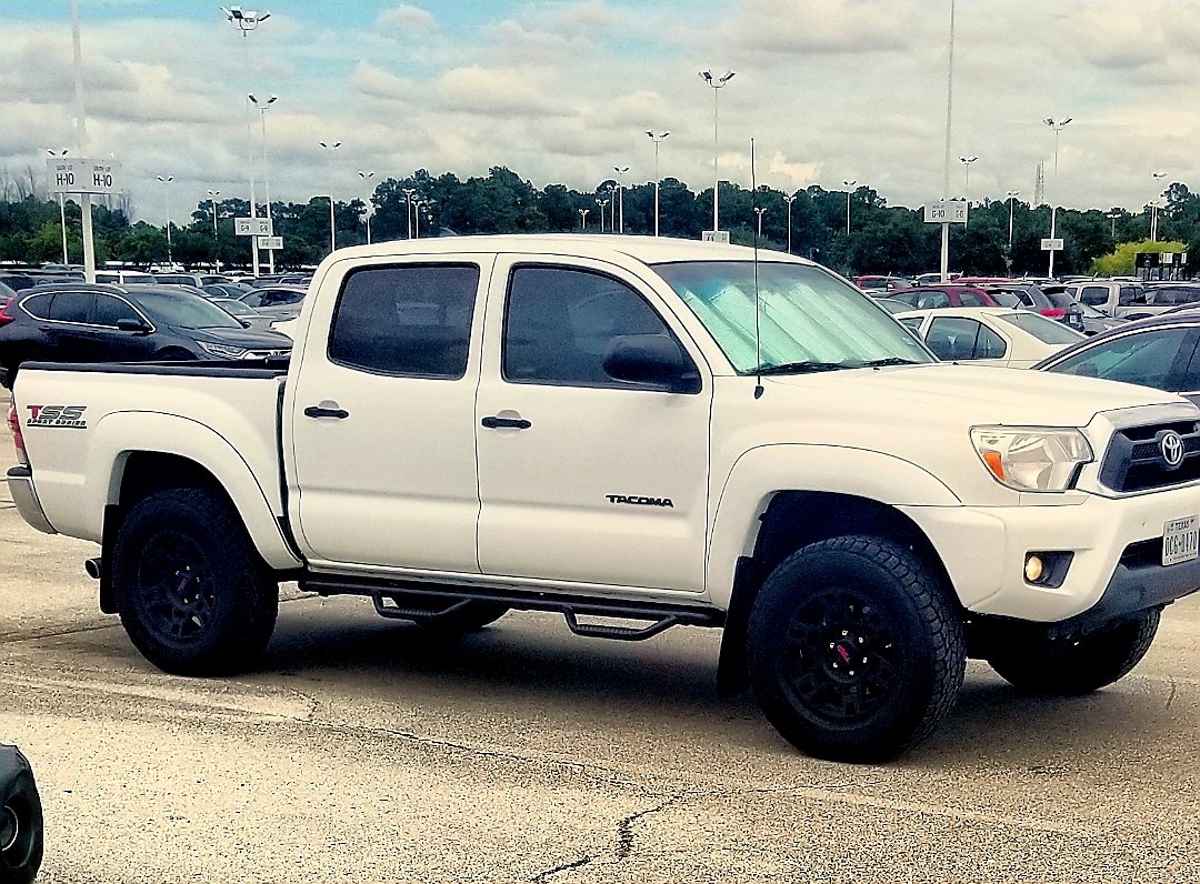

    Installed 5100 all around set at 0 on OME 883 on my 2014 4Cyl and ride is perfect with a small lift or should I say a little level. Looking forward on adding an AAL to the rear on my TSB leaf springs to gain small rake or finish leveling it out20180913_201340.jpg

    Thanks bud. You got it all right. This minor lift combo is the best and rides same or better than stock. Absolutely recommend it.

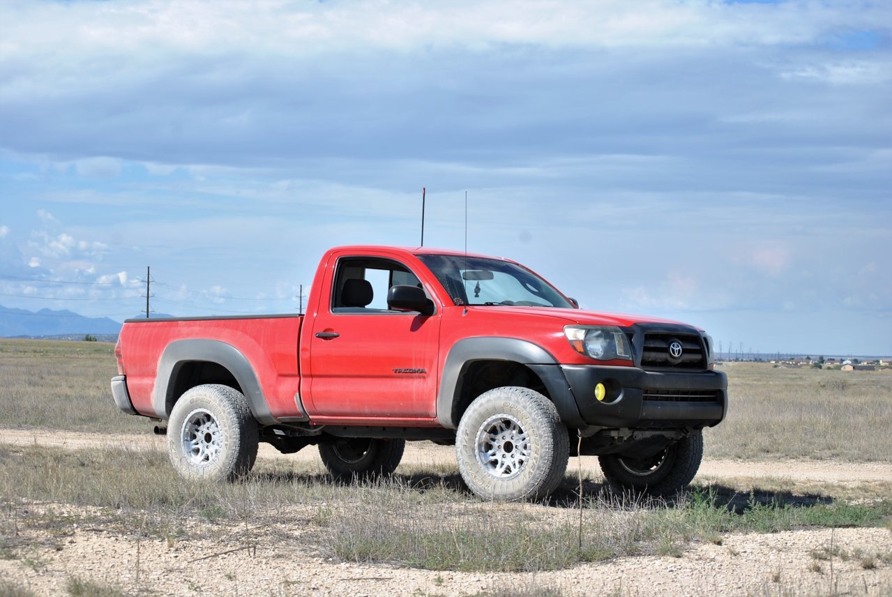

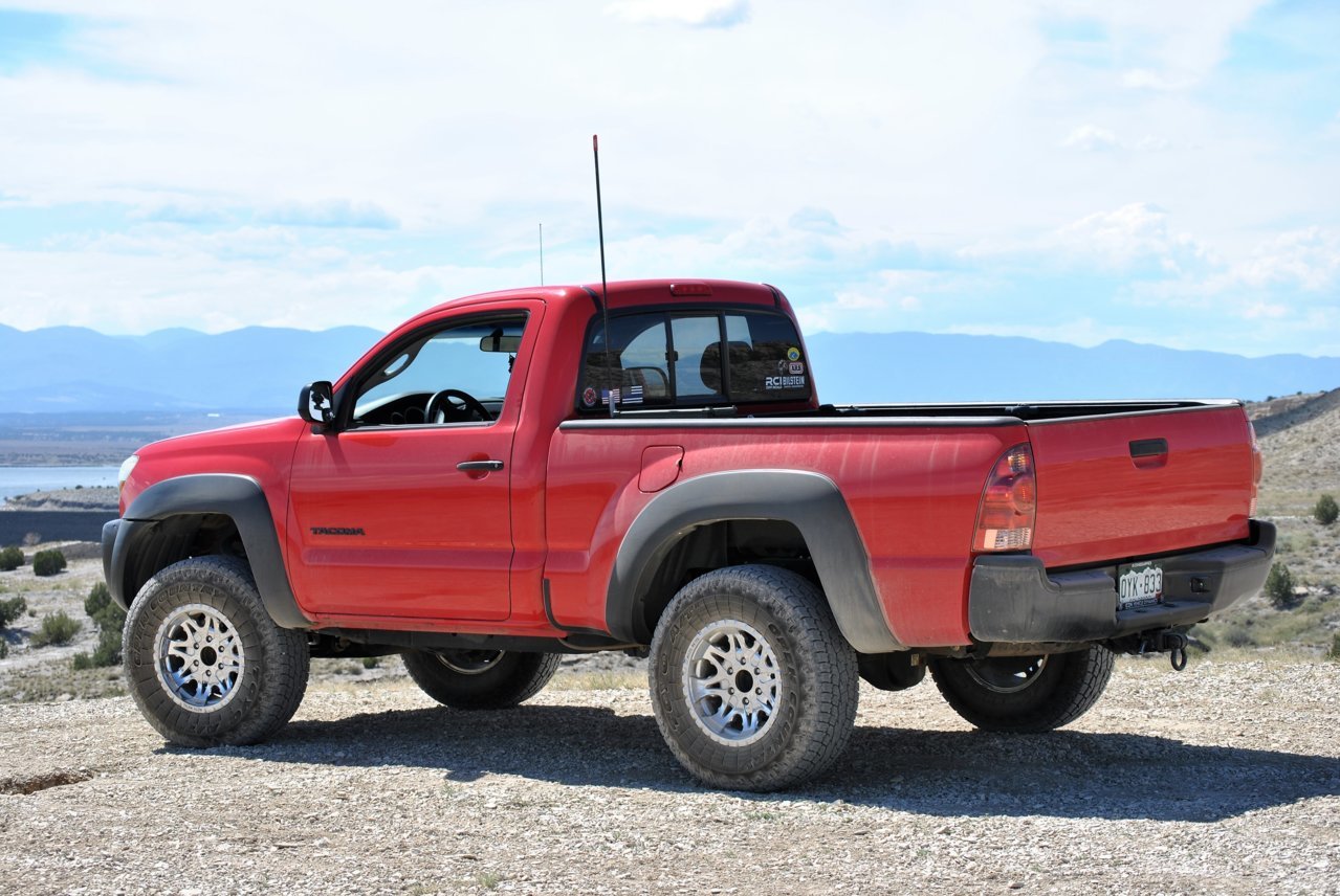

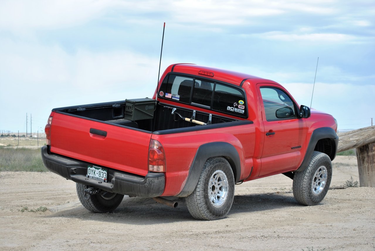

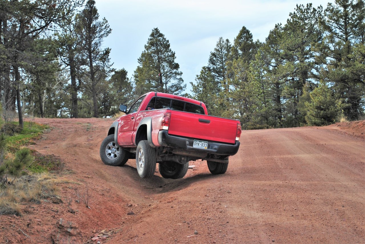

    I've got 5100's at 1.75 on stock coils and it levels the truck out great. I commute an hour 1 way for work and it rides great. I've been very happy with my 5100's and I've been pretty rough with them. On and off road they provide a good, solid ride. Bigger tires made the biggest difference for off roading for me. I went to 265/75/16 and it helps a lot, except my 4 banger hates them lol. Air down a bit and wash boards are no problem and the larger tires have added traction. I would suggest getting a good set of tires first, then do the lift. Benefit of the lift is just added travel and ground clearance.
