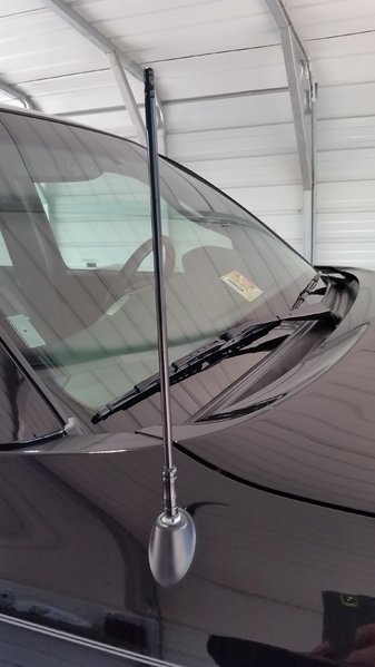

    Got some extra christmas and looking to get a short antenna also when I go to the automated car washes the people running always stop me and take off my antenna not a huge deal but rather have short and see if they will not take it off. So im looking for a shorter one with good quality reception. What would you guys suggest

    Cravenspeed has a good selection of "stubby" antennas.
    I got one on my truck and it looks good. The reception, on the other hand, is hit or miss

    That seems to be the thing I am reading in all the reviews is the reception gets crappy I dont necessarily need a stubby one but just one that is shorter then the stock one.

    From everything I've read all the stubby ones have significantly worse reception. A lot of people just cut off 4-8 inches and call it a day. Now you can go use that extra cash I saved you and put a stripper through college.

    I cut the stock one to 13". No prob with reception

    thats a good idea. In regards to that you obviously cut off it off from the top?

    Yes. I threw it in the vice and Dremeled it with a cut off wheel

    Remove the ball. Chop it from the top, re-install ball or heat wrap it.

    I got a 14 inch antenna x. Had it for 3 years no issues reception is great and it ha survived countless auto car washes

    I cut 6in off mine to fit my garage and lost my favorite station. It really matters where you live. Just be aware that there will be a loss of some sort.

    The FM radio band in the US is 20 MHz "wide", 88 to 108 MHz, meaning 98 MHz is the center of the band. The wavelength of a 98 MHz radio wave is 120.5", one quarter of that is 30.125" and most non-enhanced automobile antennas are of or near that length--i.e. they are "1/4 wave" antennas. About as short as an antenna for that band can be and provide "good" reception.
    Any shorter than 30" and performance suffers, however if a shorter antenna is needed or desired 15" or so (1/8 wave ) would be the next most viable option with "good" reception over a 45 to 50 mile distance under optimal conditions (flat terrain, no major obstacles). But (there's always a but) once you get below 1/4 wave it really doesn't matter all that much so anything 13" to 18" will perform similarly. Below 12" don't expect much for any but local (20 miles or so maybe) relatively high power stations.
    FWIW I cut mine to 14-1/2" to favour a 104.5 MHz station in Jacksonville, about 40 miles from here as the crow flies. It's listenable for that station out to 50-55 miles from Jacksonville, but that is here in the flatlands of NE Florida, it falls off fast after that.

    I lost 103.5 (cuts in and out). Not a local station and not flatland.:( I was getting tired of hitting the garage door though.

    I tried twisting that ball off the tip of my antenna with channel locks and it wouldn't budge. Any better ideas? May be try some heat?
