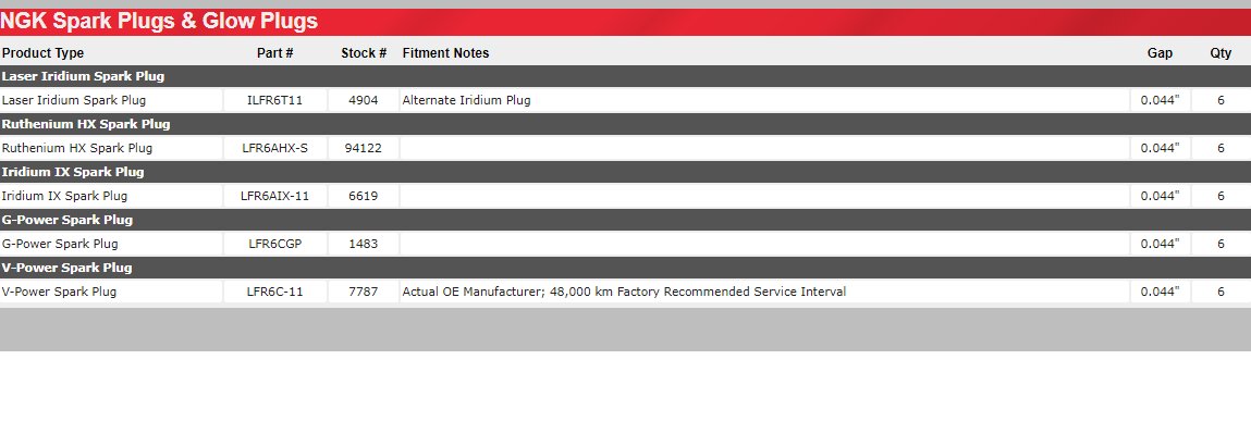

    Does anyone know what the torque spec is for spark plugs in the 1GR?
  13. Sep 21, 2020 at 9:56 AM
    Spizike231
    Spizike231 Pickin’ & Grinnin’
    Jul 27, 2019
    #300468
    1,236
    Jesse
    Sacramento, CA
    2011 MGM DCSB TRD Sport 4x4

  15. Jan 20, 2021 at 9:07 PM
    carmellocafe
    carmellocafe Begin With The End In Mind.
    May 15, 2009
    #17267
    2,266
    KEVIN
    N. California
    2014 TRD OR Access cab longbed
    15-ft #’s
    cosmicfires and wi_taco like this.
