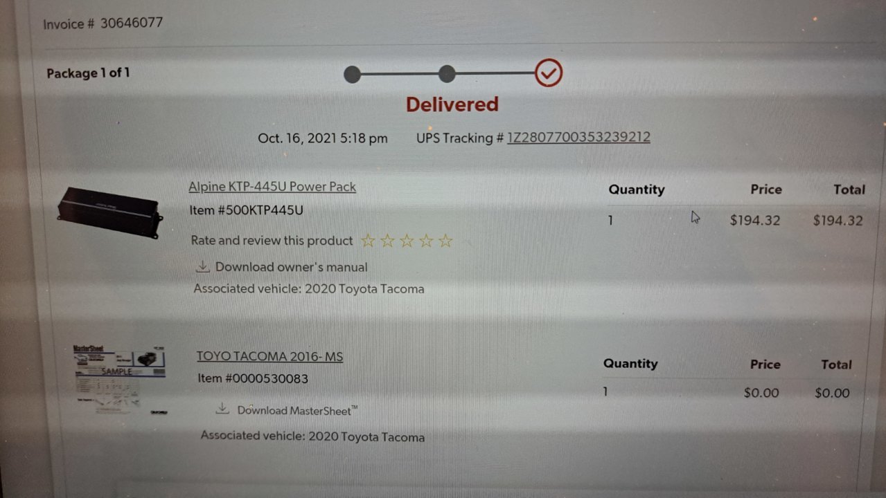

    Yeah the factory head unit does have a more front bias. I tried to over come that by setting the gain on my Alpine power pack a little bit higher for the rear channels but that didn't make a real substantial impact. I also took the speaker level feeds for the powered sub I'm installing off the front speaker outputs so as to try to avoid the lower rear power issue Toyota has created.
    Why they did that I don't know either. My only guess to why is they wanted the sound to be stronger up front because they figured these trucks would mostly have a driver and front passenger only which is mostly the case for me.

    Yep I used a universal version of the Alpine power pack to add more power to the system. It's a small amp that actually fit in behind the factory head unit. It puts out 45 Watts rms x 4. So that's way more than the head unit alone.
    Here's a link to it. I'm sure there's other things you can do but it's a good little amp I think. The kicker key is about the same price but is currently sold out as it was when I bought mine.
    https://www.crutchfield.com/S-16Bvy...VC-toh8Syku4Mmm4EWIFHjb9Hoi8-KYIaAvHoEALw_wcB

    True. I think I paid a bit less for the amp than the current price. It was almost 2 years ago and the price of everything has gone up some.20230808_065743.jpg

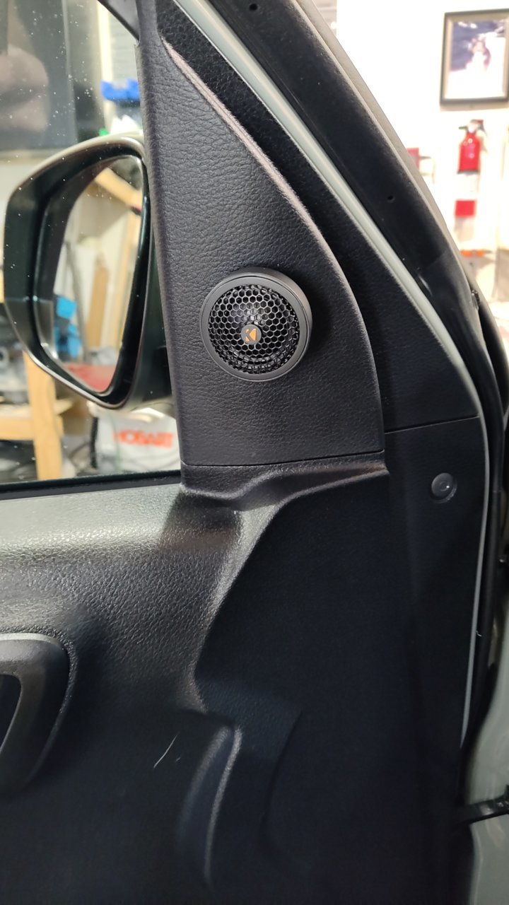

    If you're asking me, it's not so much a budget thing... it's that I was just hoping that I didn't have to do it. ;) Been installing aftermarket stereos in almost all of the vehicles I've owned over the past 40 or so years. I know that it's not difficult. I've already pulled the stereo out to add a Car Play adapter (more here) and it's exceedingly easy. But I kinda like the OE unit. Although it's not a capacitive touch screen, it works fine and looks nice. Just wanted to pop in some speakers and leave things be. Probably won't happen.

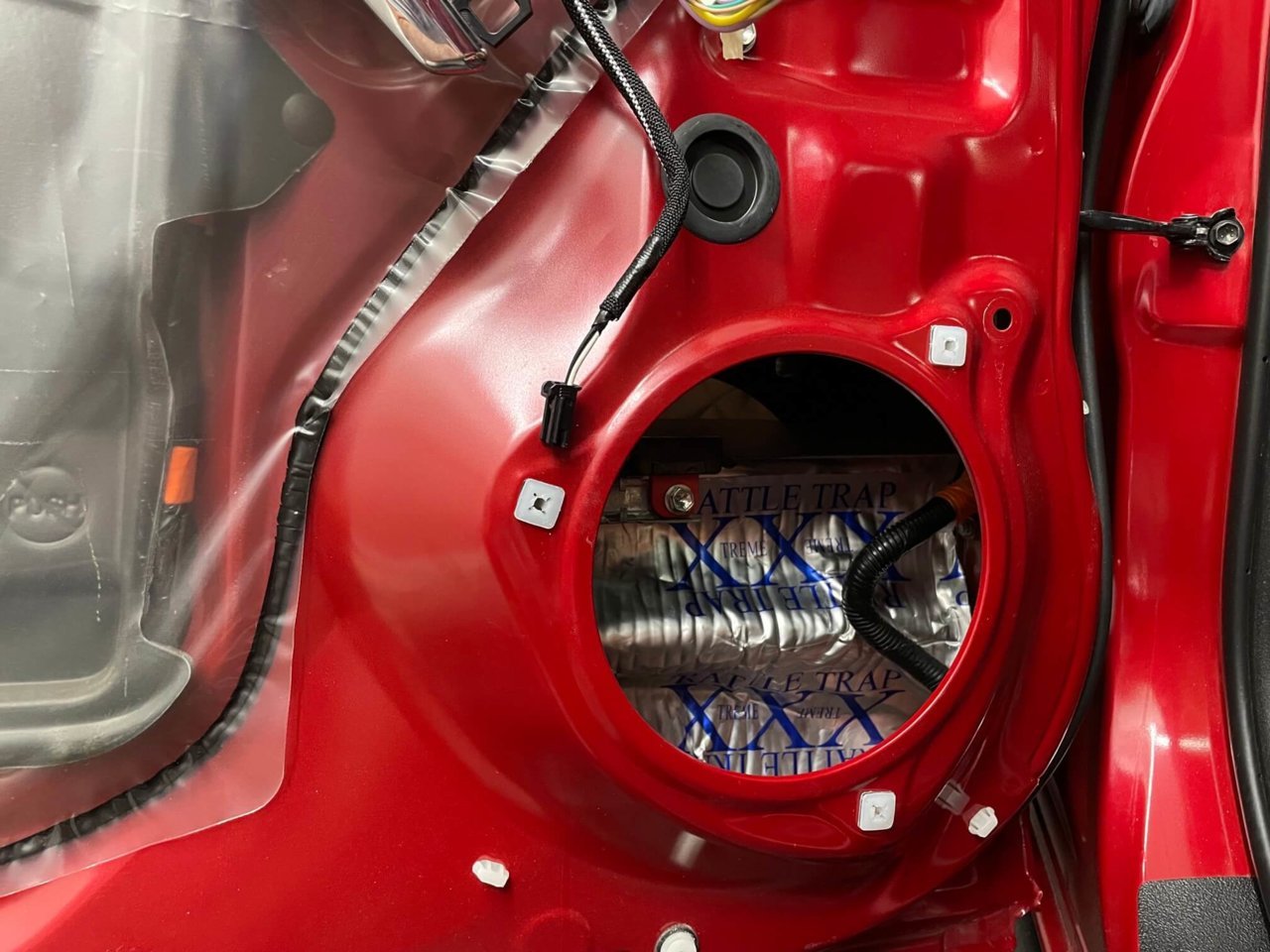

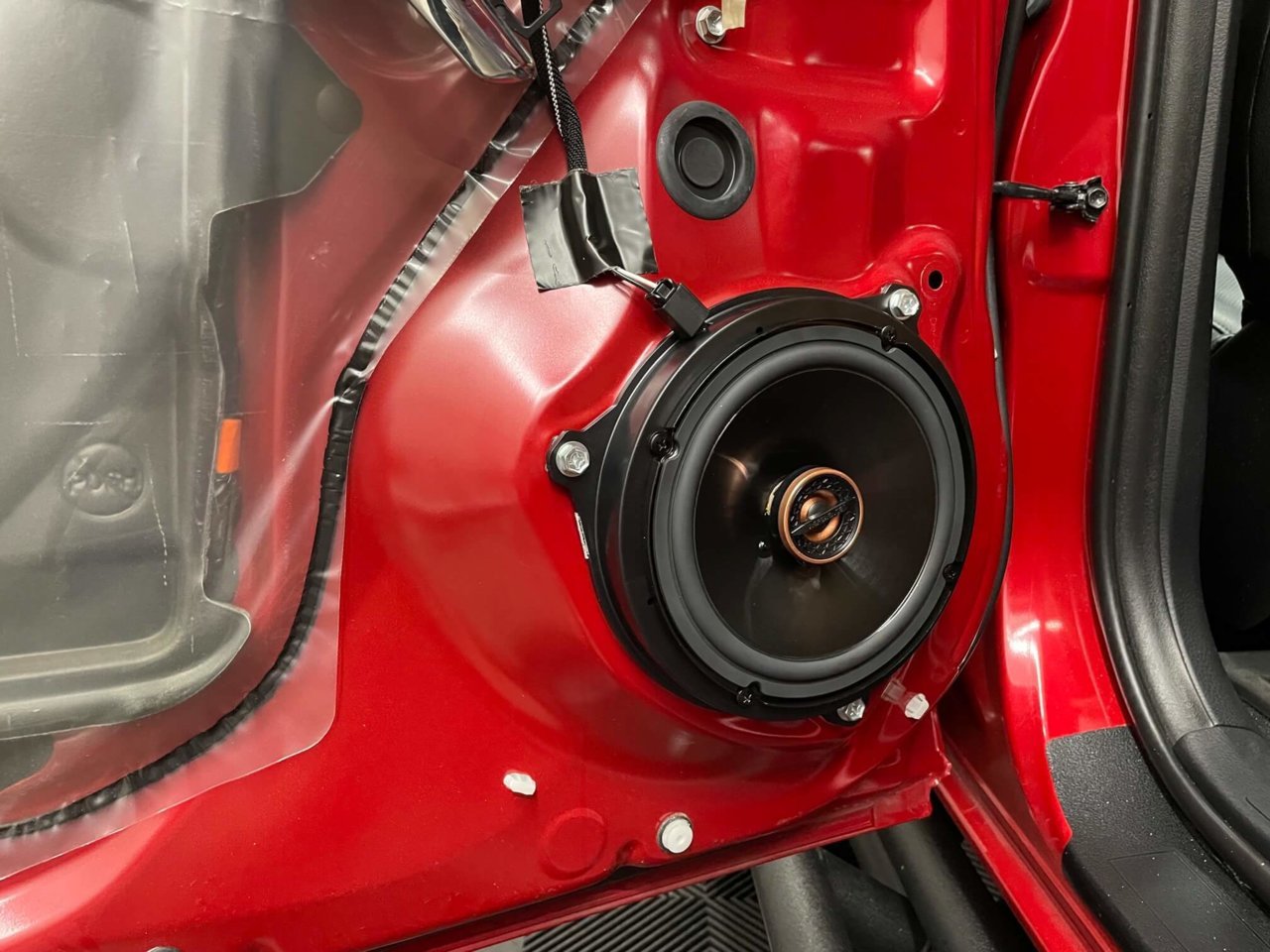

    I added sound deadner and per @flattirebob installed new Infinity REF-6532EX speakers in the rear doors last night. Have the DS18 tweeters and Infinity Reference speakers front and back now. Sounds pretty good. Truth be told, the DS18 tweeters made the biggest difference. Who knew?! I just keep inching toward replacing the head unit and in the end probably will. o_O If/when I do I'll probably go for one that replicates the Toyota personalization and data like the OE unit. Alpine makes a couple like that.
    Open to any and all suggestions though! Guess I should prepare. :spending: :rofl:
    Edit: Should have mentioned that replacing the rear speakers didn't help with volume. The new speakers sound much better than OE, but they're still way under-powered compared to the front. Not sure why that's a design "feature", but it is what it is. Adding an amp or a new head unit would resolve that. The front and rear sound deadening improves the bass and makes it sound like I'm closing the refrigerator door now. :D
