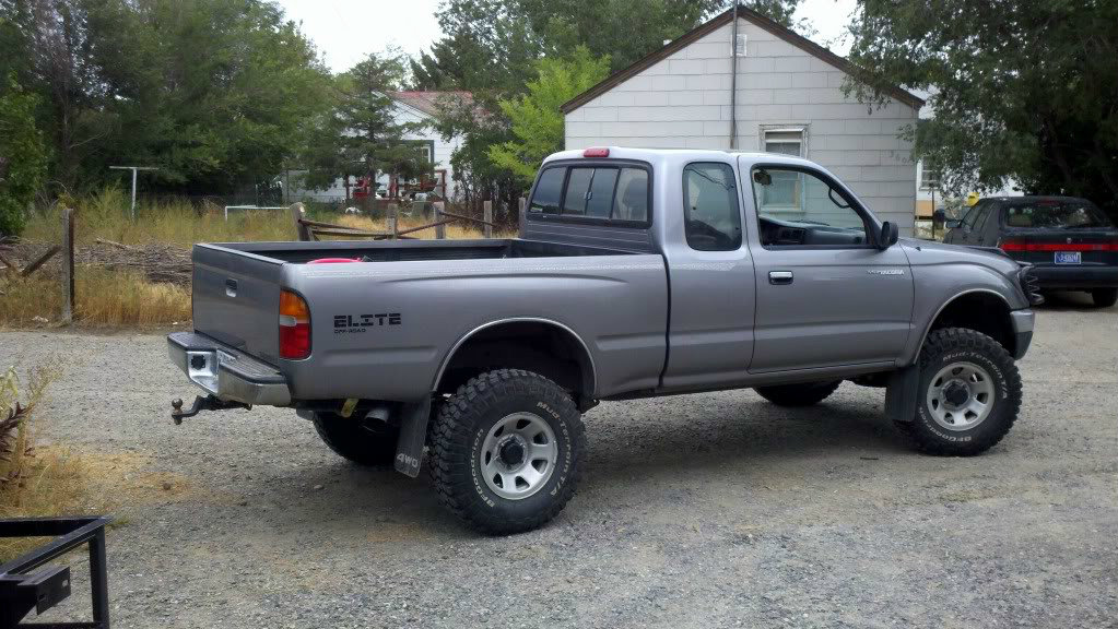

    Yea mine looked good after i added 1.5'' spacers for a wider look on 31s with stock bumpers. After i put the plate bumper on there it looked silly without the 33s.
    here is mine with the Eibachs and about 4.5'' lift out back.
