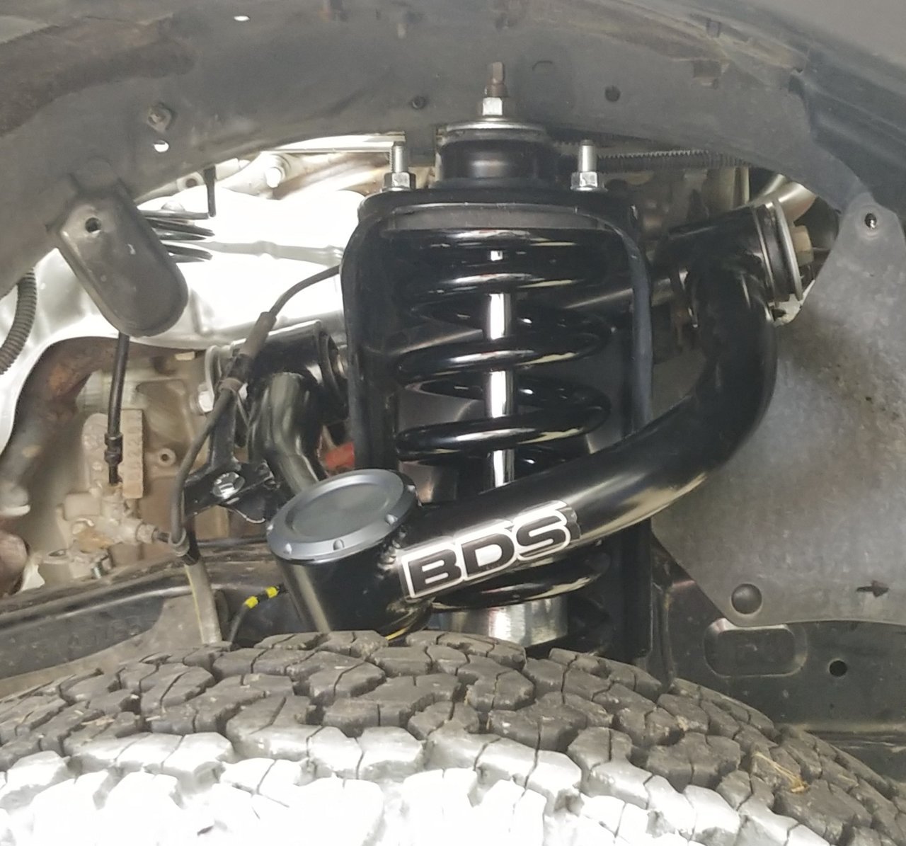

    I have BDS and I think they're a good option for a weekend warrior. They are solid, and have grease-able ball joints with spiffy dust caps to protect the grease fittings. Fitment was good, and my alignment is in spec.
    That said, a good alignment shop should be able to get you in spec with 2 inches of lift and stock UCA's.
