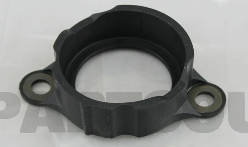

    Just as a heads-up and its worth noting since many may not be aware, if ordering LBJs using the part #s in @Kwikvette's signature - those do not come with the correct bolts for use with the stock LBJ dust protector. The bolts supplied with that ball joint are for use without the dust protector. Entirely up to you if you decide to run with the dust protector.
    (image src: https://toyotaparts.mcgeorgetoyota....ension-ball-joint-left-front-lower-4334039585)
    If using the OEM LBJ dust protector, then use the black bolt w/washer (part# 90119-10933 and torque to 37 ftlbs). Again, this is only for those using the LBJ dust protector which is pictured below along with the bolts you need if running the protector.
    Worth mentioning, Part#s 4334039436 (Left LBJ) and 4333039556 (Right LBJ) both include castle nuts and cotter pins. If running the dust protector, I'd order these and then 8 of 90119-10933. If you need to replace a damaged or torn dust protector, the part# is 4334660011.
