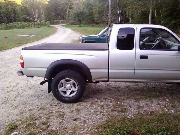

    Just recently bought my truck. Wanting to black out the stock rims. I have painted rims before on an 01 vw GTI but I was just wondering if anyone has any hints or tips for me such as certain types of primer, black paint, and clear coats they used, and how many of each is best? Also what kinds of sand paper to use? I want the rims to shine opposed to being flat black. NO I don't want to use bed or frame liner.

    think that's what i'm going to try! If I had an all black truck I'd do flat black but mine's silver as you can see so want everything to shine. thanks for the input!
