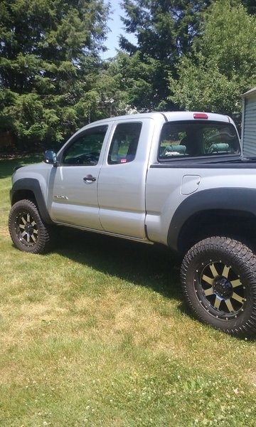

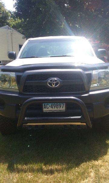

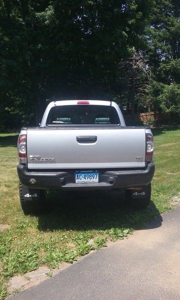

    so I've been contemplating for some time now about whether to totally de-badge or remove and paint like a flat black I have the base model so it has the flat black trim and I'm thinking they might really look good painted the flat black. I am not really to sure what's the best way to remove them I've heard some of that decal/adhesive remover or just a hair dryer and some fishing line also if I decided to paint them any suggestions on what to use to re-apply them. here's a little glimpse of what she looks like as of now

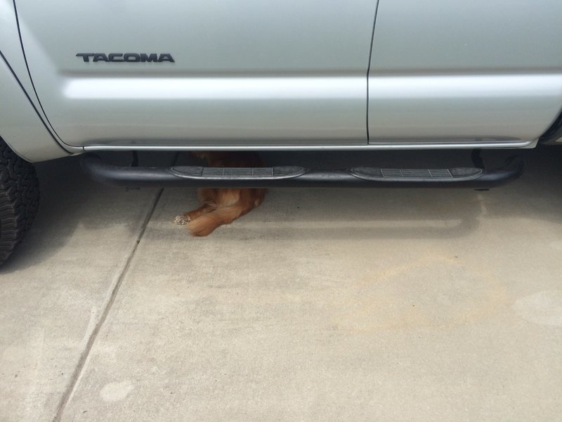

    Here's what one looks like

    Lol what's your dog doing?
    Bootselectric likes this.
  19. Jun 26, 2016 at 1:03 PM
    #19
    Bray1197
    Bray1197 Well-Known Member
    Mar 10, 2016
    #180827
    617
    Bobby
    Myrtle Beach, SC
    2017 Tacoma Trd Pro
    A lot of stuff, just ask and I'd be happy to tell you. Or we could wheeling/camping
    Going full retard! Pretty much nothing new lol
