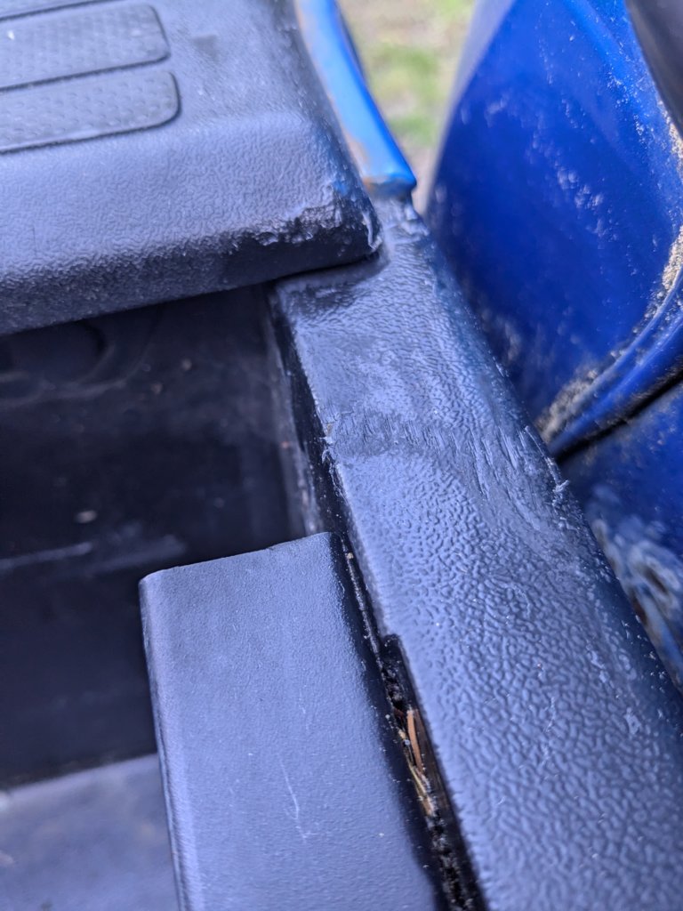

    Looks like i have that recessed gap area in the front bulkhead area of truck bed mentioned in this post, it seems like this is caused by the fact the plastic bed rail caps sit higher than rest of truck bed top rails, has anyone just removed those plastic bed rail caps, seal the tops of bed rails with aluminum tape, then let topper directly rest on top with no plastic bed rails? Seems like it would sit more flush that way

    I saw videos where they removed rail cap and sealed up all the square holes on top of bed rail with aluminum tape and also silicone sealant to help with dust and possible water intrusion, and then they put the plastic bed rail caps back on but im thinking that plastic bed rail cap is main reason the topper does not want to sit flush, it just pops off pretty easily with no tools

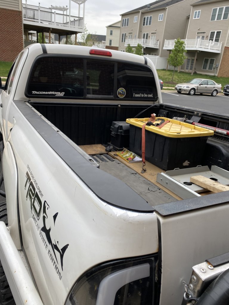

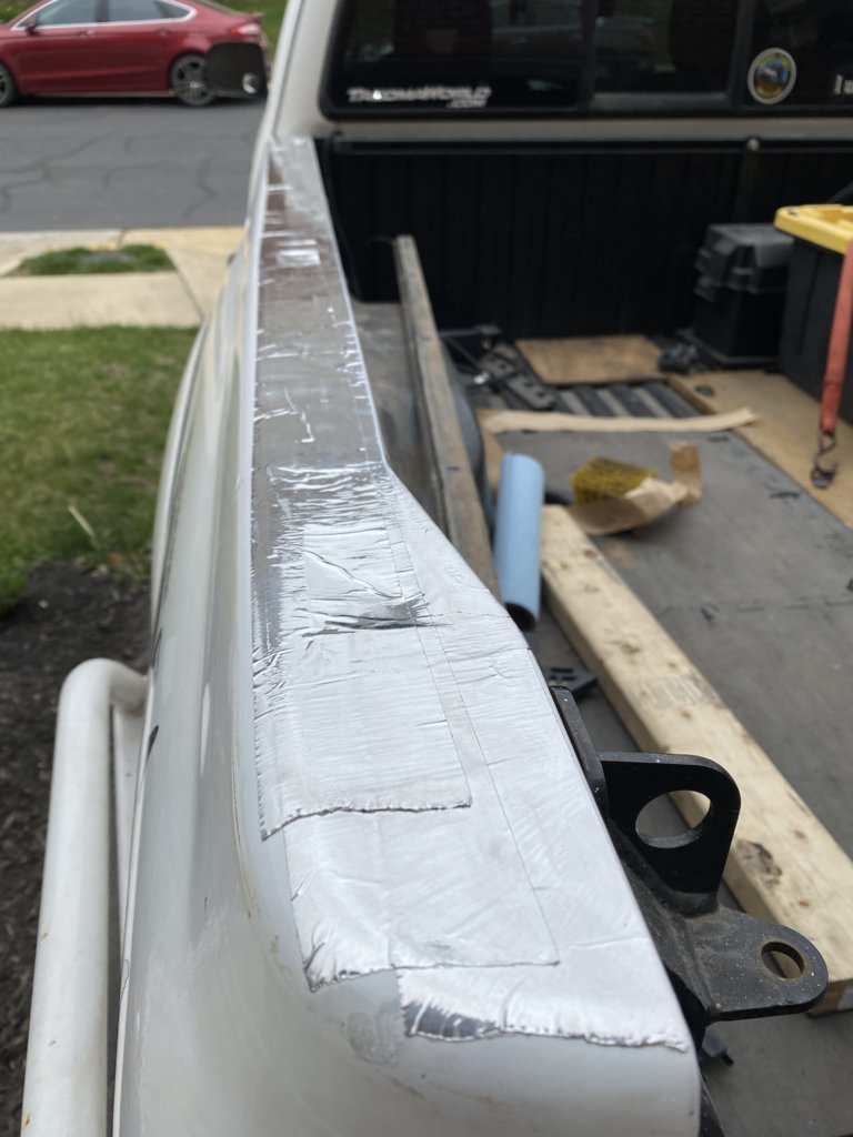

    I installed KB Voodoo aluminum bed caps and aluminum tape

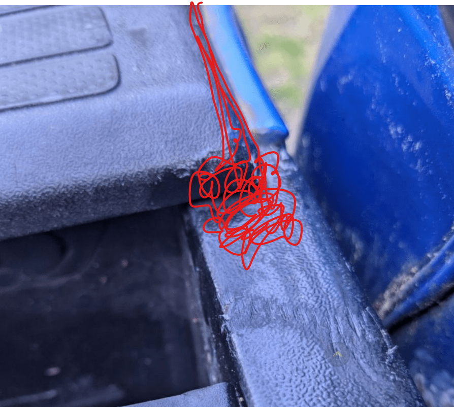

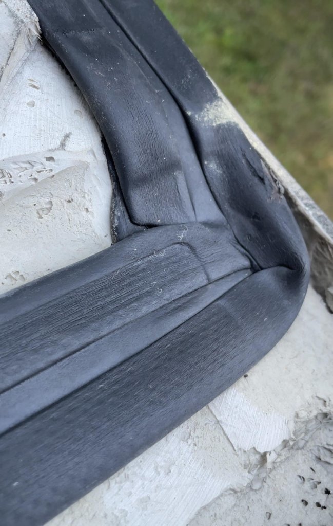

    Unclamp your cap and lift it up to take a look at the front edge of your cap, it may actually already have the base contoured for the side rails-both caps I've had did. I found a picture that I had that shows it when I had my cap flipped over for carpeting. (Top of picture is the edge that sits on the front of bed along the cab) Its hard to see while looking from the side because the overhanging edge blocks view of it. I did still need to add some butyl where I drew in red on your picture to fully seal it during car washes and stuff.
