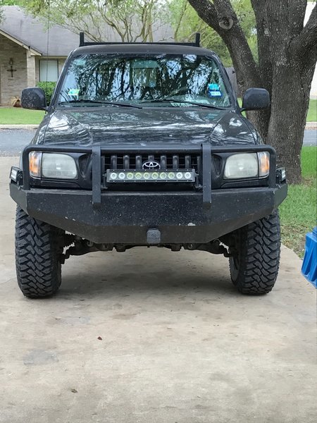

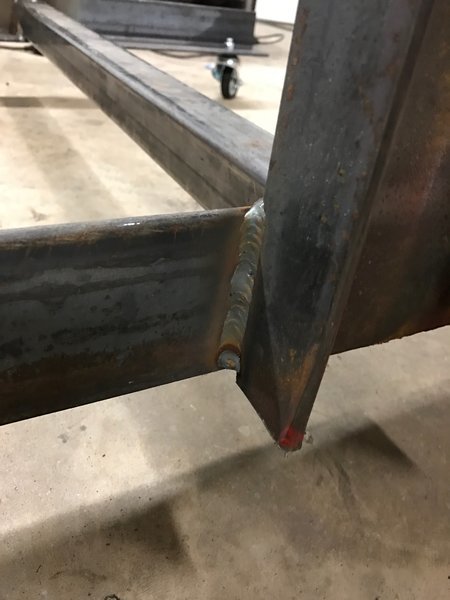

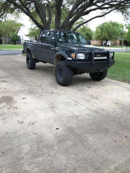

    I've got a hobart 190 machine running c25 gas and did this with it today:
    Thats on my 20 ton press I'm building rn. Before I got this machine all I had was a Lincoln AC stick machine and made my bumper.
    I don't mean to show off my truck and crowd ur thread, but just showing how u can do great stuff with an old/less popular machine. This hobart machine I got on sale for 650 and is ready for spool gun for when I get into aluminum. Great machine for the price. I also agree with lincoln 210 mp post earlier. A little pricey for what u are looking for but I use them in school and they are great little machine for what all they can do.
