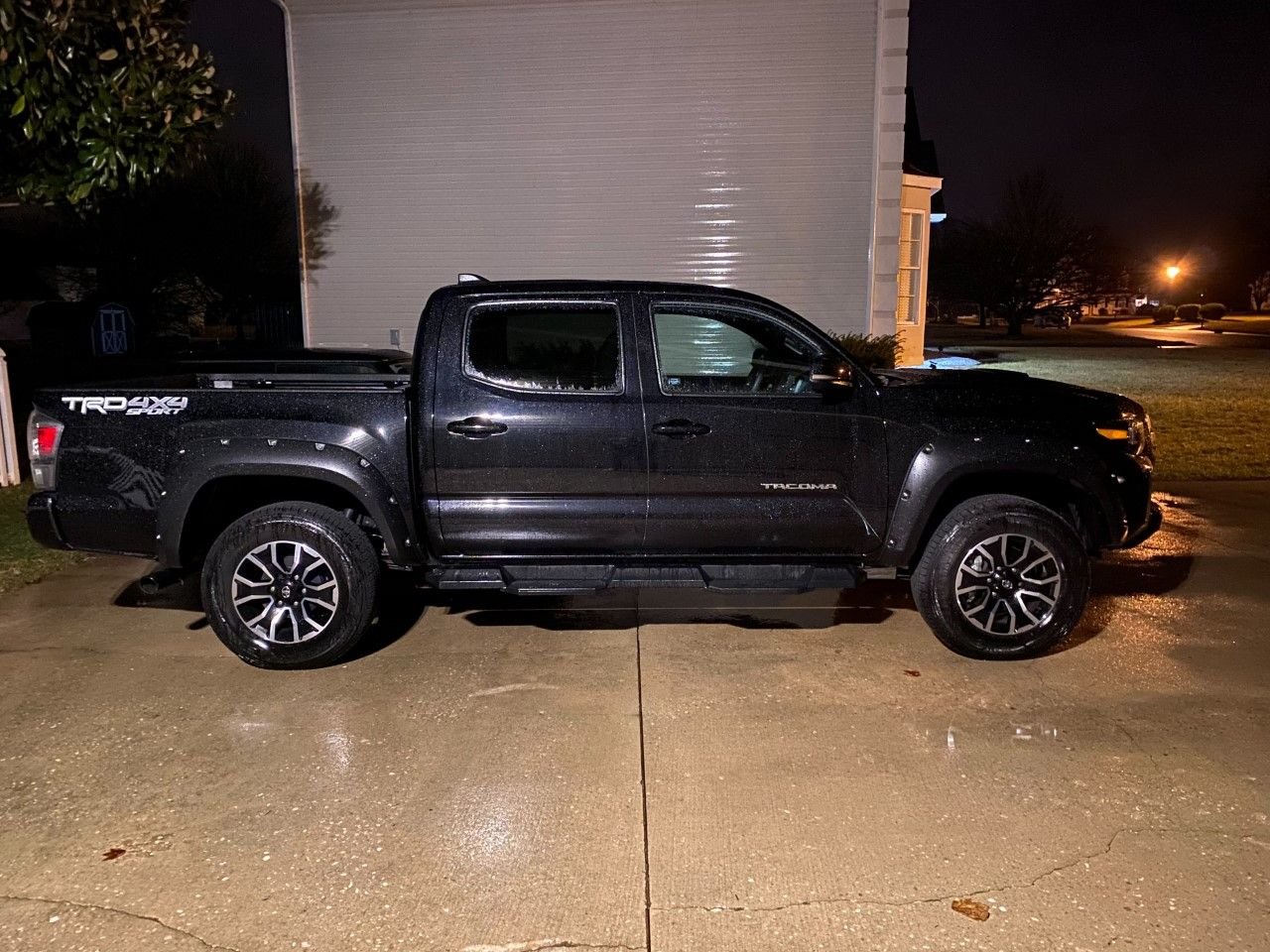

    I'm curious about this because I have the same year/model as OP.
    If I do the OEM TRD Lift Kit (2 inch), the biggest tires I can put on there are:
    275/70R17 - 1.5 inches taller and 0.4″ wider than factory
    Current Tire size:
    265/65R17
    EDIT
    For a 3" Lift, here is the limit:
    285/70R17 - 2 inches taller and 0.8" wider than factory
    Source: https://empyreoffroad.com/blogs/resources/the-ultimate-tire-wheel-guide

    @Junkhead
    Yessir!
    I'm considering using OEM Wheels...but I'm sure there's an off-set that can prevent problems.
    Yes???
    Or no???

    LOL
    I don't have mud flaps anymore!
    I got Bushwacker Fendys!
