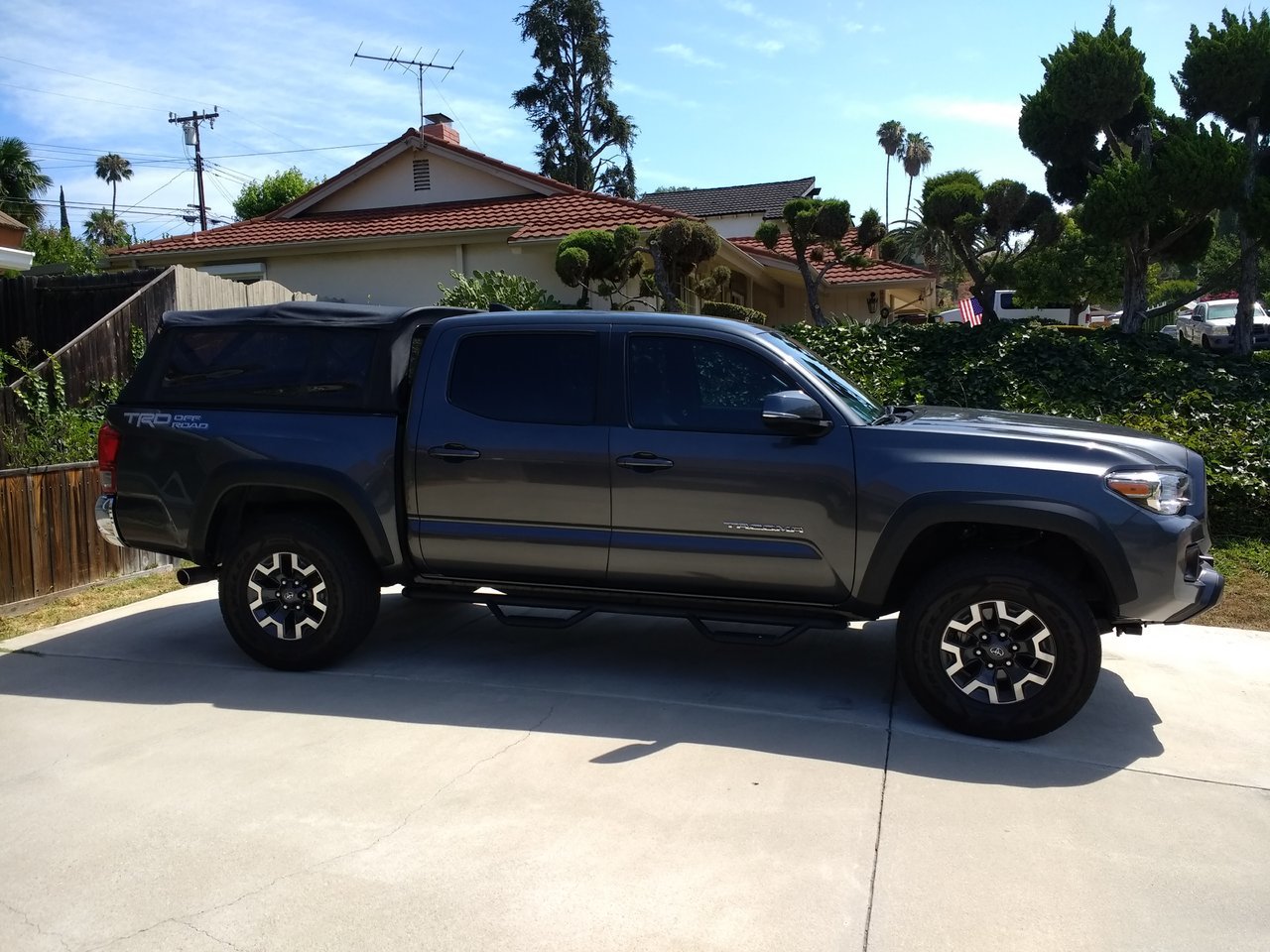

    I have a supertop on my 2016 DCSB. Not a perfect fit because the width of the tailgate spoiler and the height from the bed to top of cab, but I've taken it over 80-mph and it's secure. Don't know if the same is true with the long bed. I like the look with the windows, and with a little modifications I got everything to fit and seal up good.
    Here is a thread with the supertop on a 3rd gen DCLB (see post #1482): https://www.tacomaworld.com/threads/lets-see-some-softoppers.277644/page-75

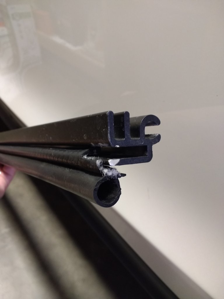

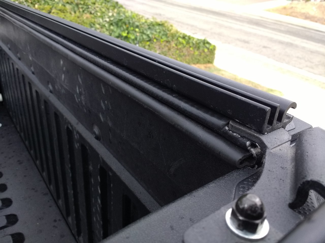

    I did buy new clamps to replace the Bestop ones...https://www.tacomaworld.com/threads/bestop-truck-cap.501249/#post-15608896
    I modified the tailgate bar by flipping it upside down, and installing this rubber door seal instead: https://smile.amazon.com/gp/product/B01HL27JRG/ref=oh_aui_detailpage_o01_s00?ie=UTF8&psc=1
    It makes the bar sit just behind the tailgate with the bulb seal hanging down (rather than sitting on top of the tailgate). I don't have a picture, but I can upload one later tonight.

    Here are pics of my tailgate bar. I didn't have the supertop on my truck today, so I just threw the rails on for the photos:

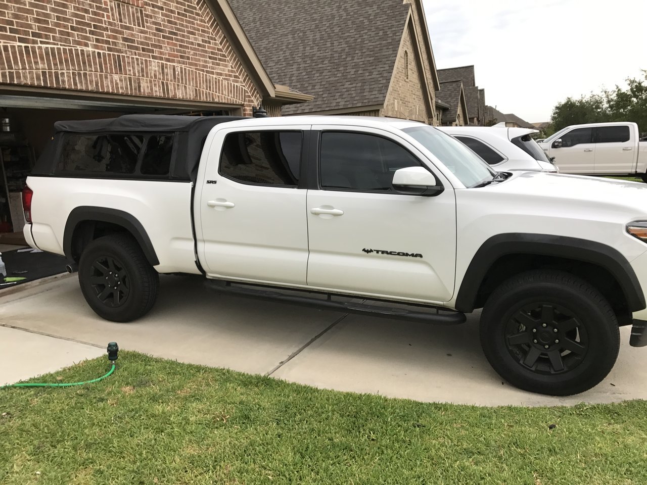

    Got the topper up. Not bad at all. Had a hard time with the windows tho.

    Looks good OP :thumbsup:
    For the windows it helps to zip up just a little bit on one side first, then get the other side in.

    Hey whenever you end up putting your topper up again. Can you take a picture of how you did your tailgate. I saw the pictures you loaded before but still don't quite see how you did it. Thanks!!

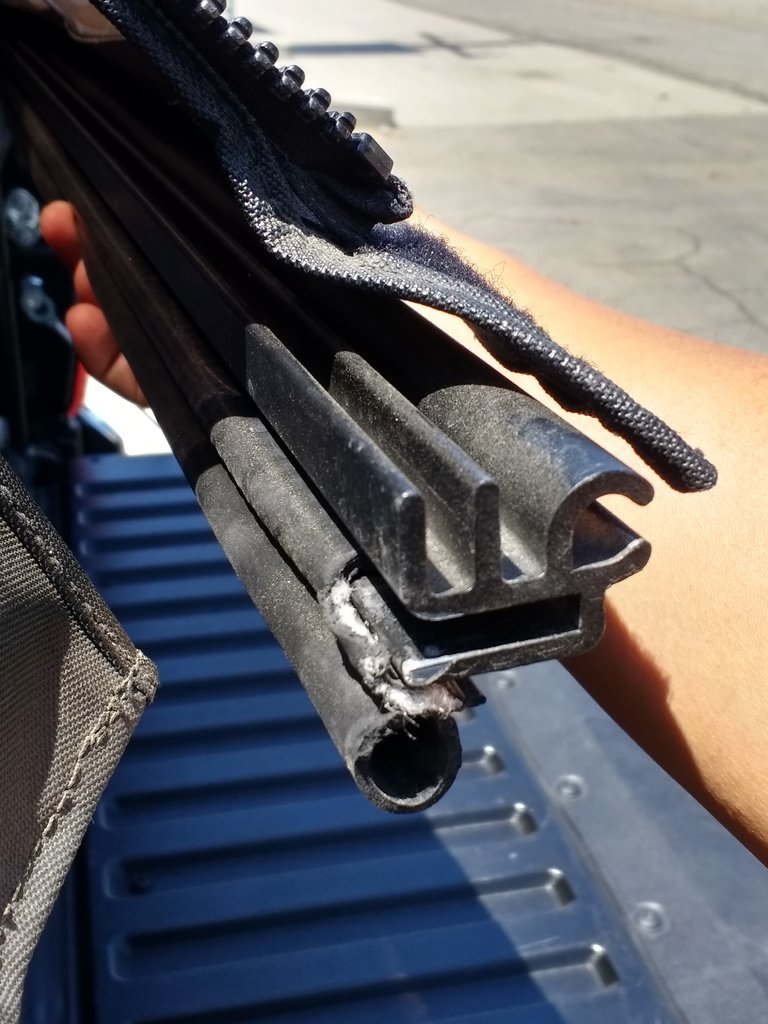

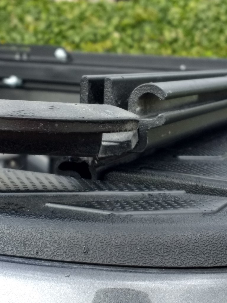

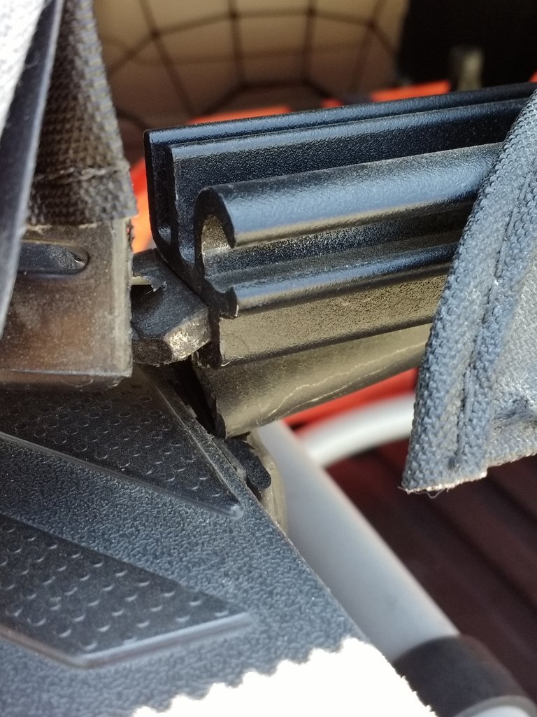

    Hey @Battacoma, perfect timing. I actually put up my supertop this weekend. Here are some other shots of my tailgate bar. I actually never tried the Bestop bulb seal, but after reading this other thread I thought that this alternate bar position and larger bulb seal would allow a little more margin of error on the bed rail placement (forward or backward) and still get the tailgate to seal nicely (which it does). https://www.tacomaworld.com/threads/bestop-supertop-install-help.489246/
    My top will be on until at least Wednesday, so let me know if you need other photos. I had to make a cut at the end where it slides into the side rails.

    @slowpoke16taco those are perfect. The instructions on the bestop are vague and I remembered you said you did something different. This will help me. At the moment I have to close my tailgate before I close the back window. If I close the window first the bulb obstructs my tailgate from closing. So I was trying to see if I did it wrong or if there was an alternative way to install that back window. All your pictures and help have been much appreciated!

    As for the tailgate, I attach the bar and zippers first then close the tailgate.
