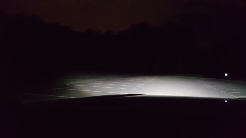

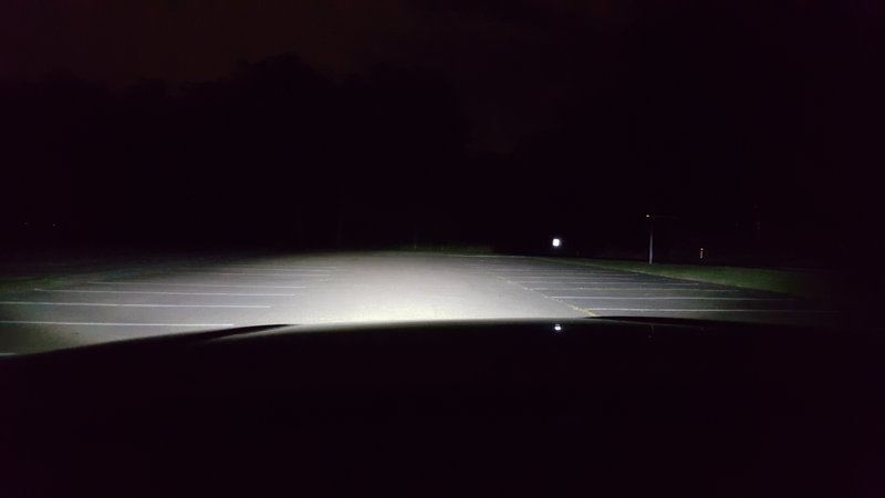

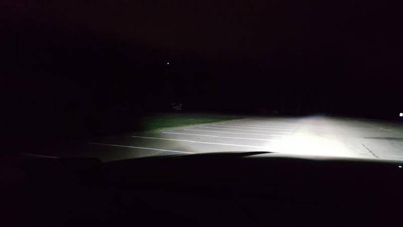

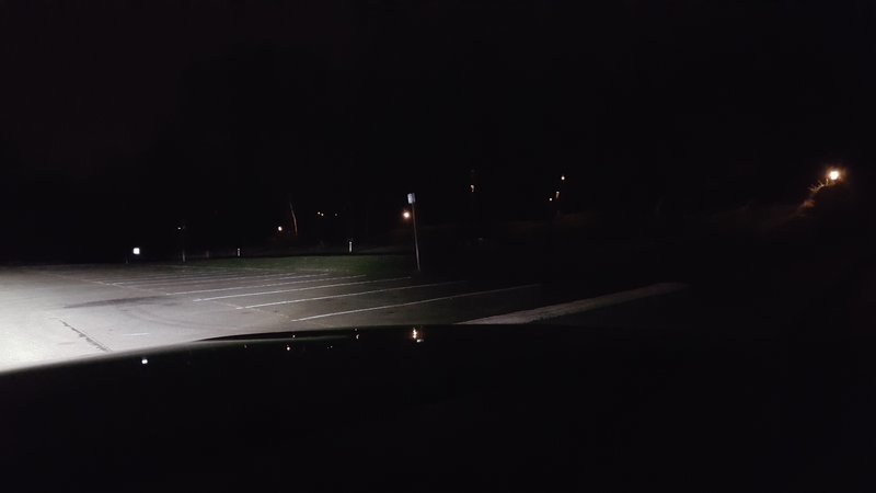

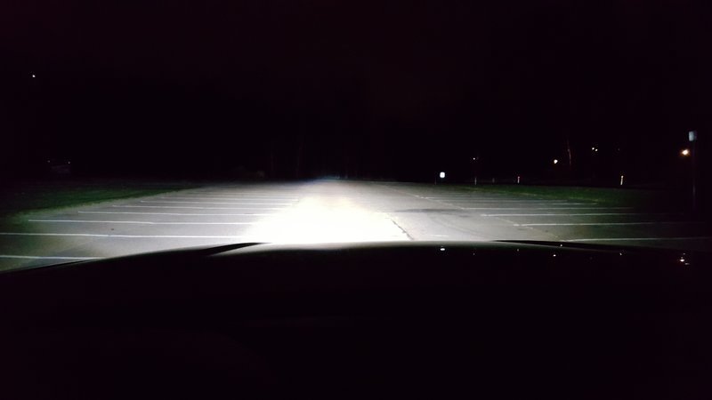

    Trust me I'd rather have 4500-5000k lights but these 6,000k leds are very white and hardy blue at all, I think the reason why is cause they have such a high lumen output at 5000 lumens per bulb!
    Here are some output pictures of the Morimoto 2 Stroke LED's:
    Here are some pictures of 5,000k HIDs from The Retrofit Source for comparison:
    I hope this helps you out @woode87. The reason why I like the LED'S better is because the light is more evenly spread out across the beam pattern. Unlike the HIDs cause they have hot spots in the center that are super bright and you can pick them out pretty easily! If you got any more questions ask away!
