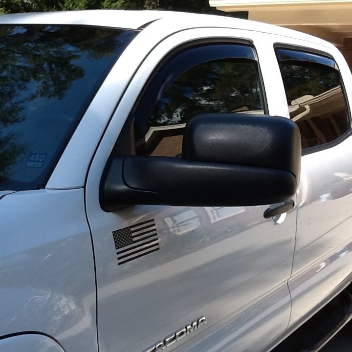

    Yes..these are the best. I think they were actually designed by some guys here on the forum. They were ProEFX mirrors. They were a spin off of guys retrofitting dodge ram mirrors to the Tacoma.

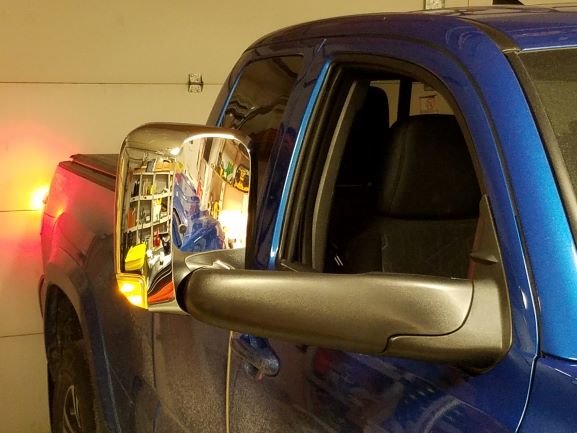

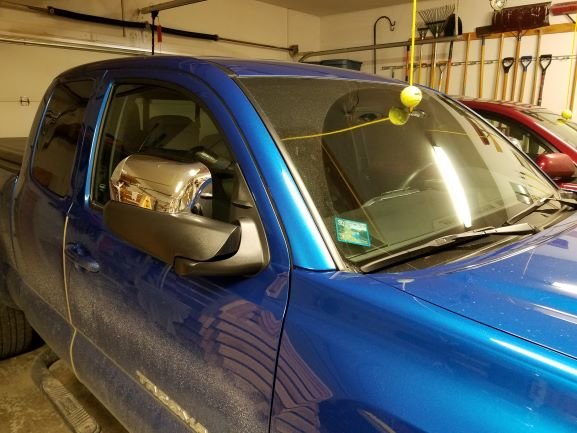

    Well, I bit the bullet. My garage is almost 1,000 sq.ft., so I hate to heat it unless I really need to. And I don't really need these mirrors till spring when we get the camper out of storage. But I just couldn't stand seeing them just sitting there in my office. It's now done, and pictures will follow.
    But here are some important stats: The stock mirrors are 7 ft. even from outside edge to outside edge. The new mirrors are 7 ft. 6 in. in the down position. They are 8 ft. 2 in. in the extended position! The will still fold in, manually. Blind spot warning works in both positions. Heat works and turn signals work. A pleasant surprise is the left-right-up-down controls work correctly in either position. And the chrome looks better than I thought it would.

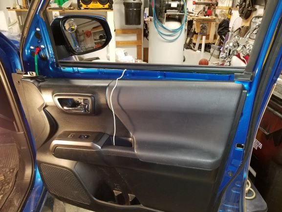

    Unlike the video, if you support the door panel with 10 ga. wire, you don't have to disconnect anything but the mirror itself. Note there is a small black rubber or plastic thing that might come off with the door panel--don't miss it. (I think I have figured out the photo upload.)

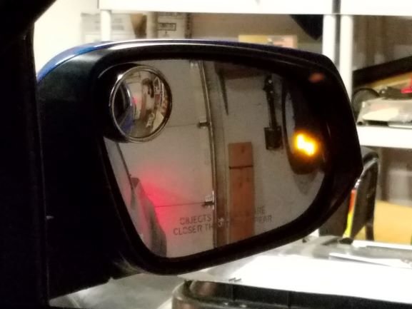

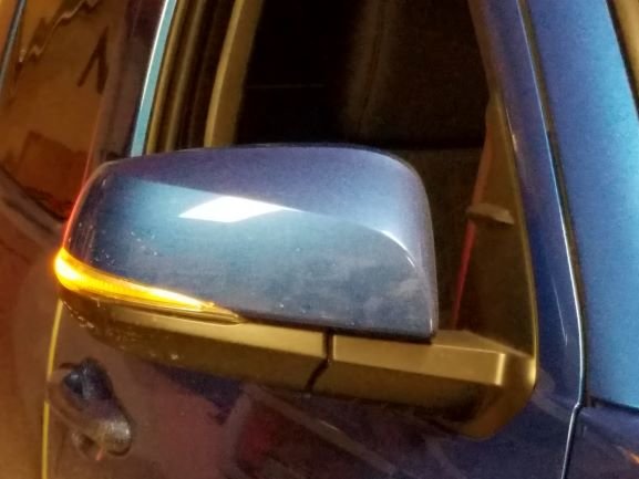

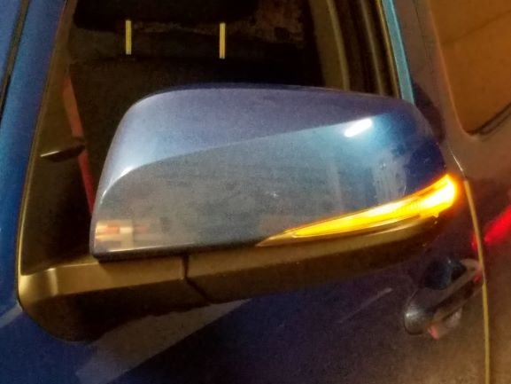

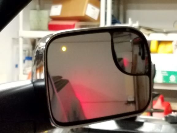

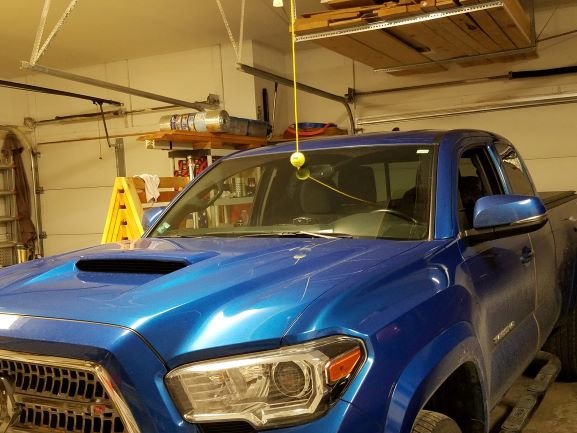

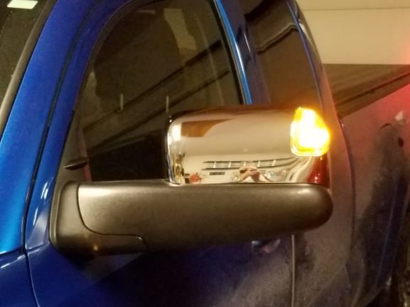

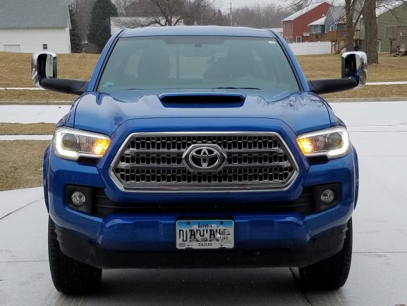

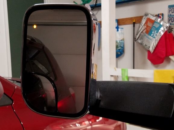

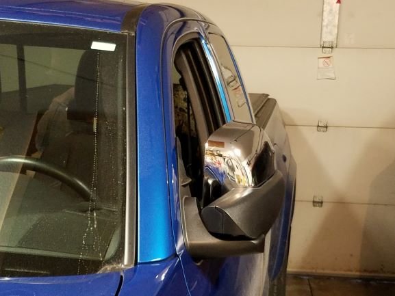

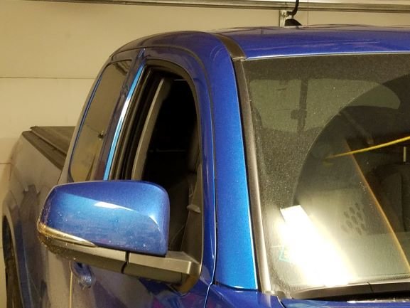

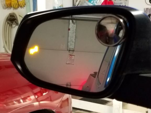

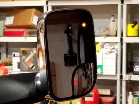

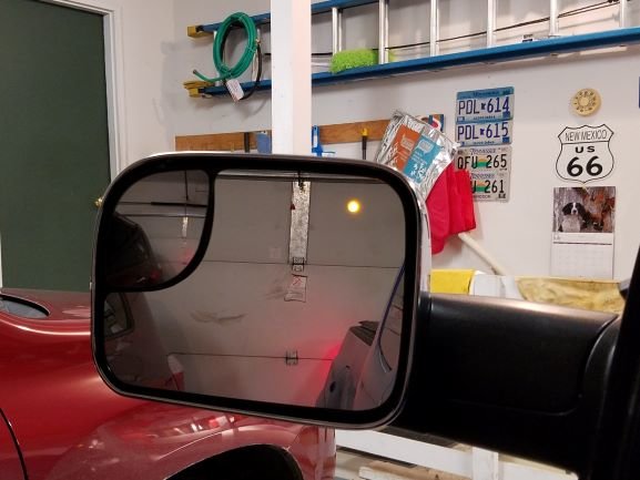

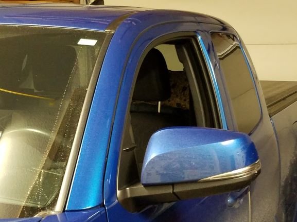

    Ruggybuggy, you wanted lots of pictures. Here they come.
    Before:
  17. Feb 5, 2019 at 3:21 PM
    #37
    bedubya
    bedubya Member
    Jan 31, 2019
    #281336
    13
    Iowa
    2017 Blue Tacoma TRD Sport 4x4
    Luvern Nerf Bars

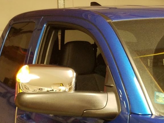

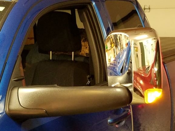

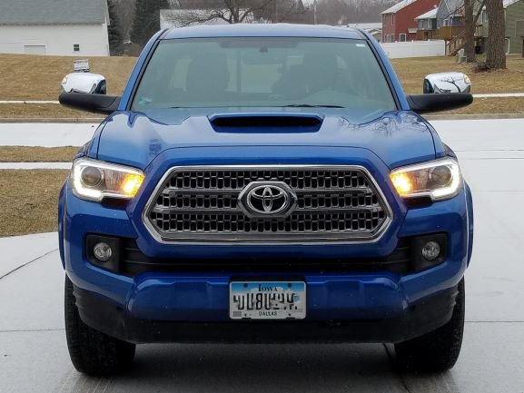

    And After:
    Mattedfred, polaris202 and Hamer95USA like this.

    That last one was supposed to be with the mirrors extended.
