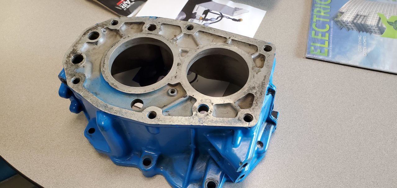

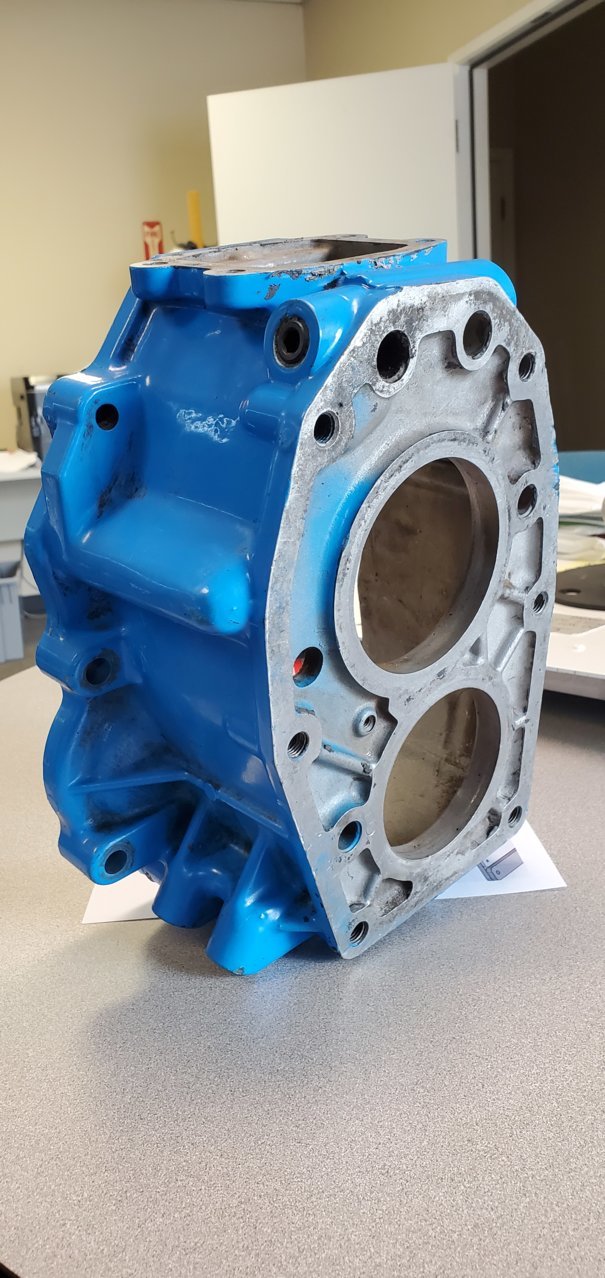

    RF1A housing showed up today.
    Thanks @allenfab!
    Just need to clearance it for the 4.7's. I dig the blue powdercoat finish too (old inchworm housing).

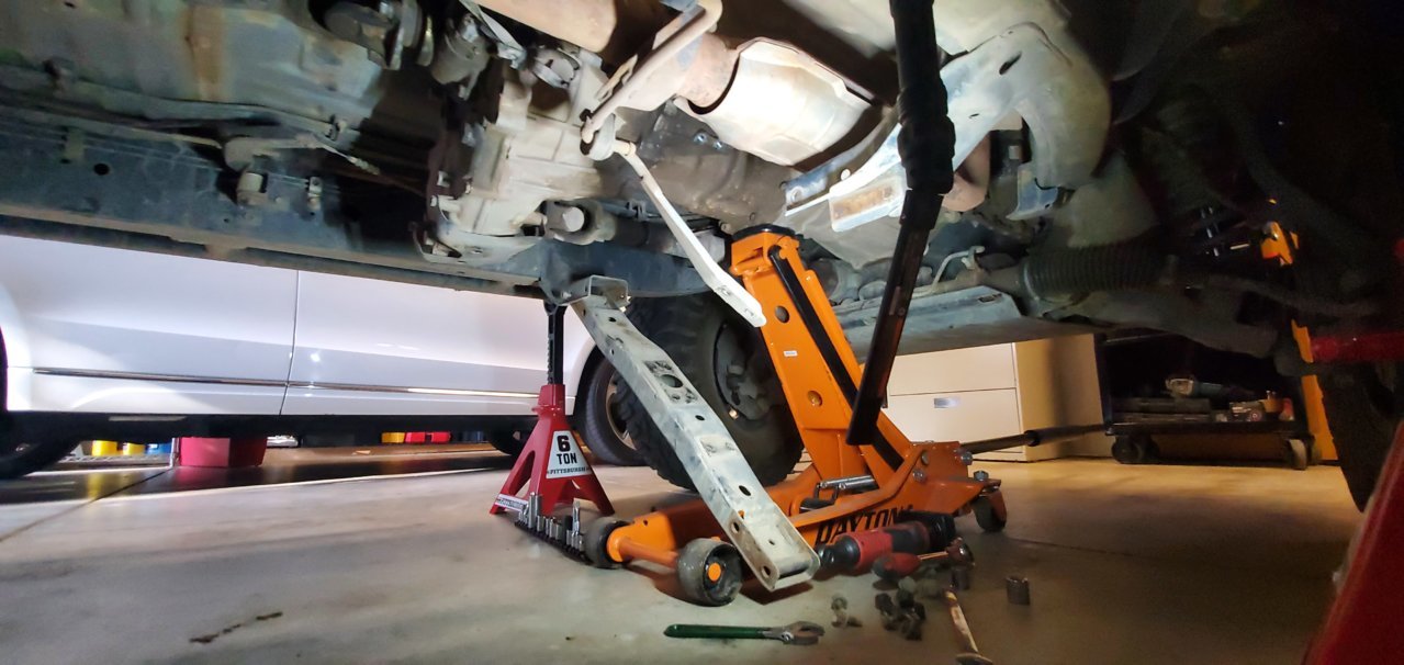

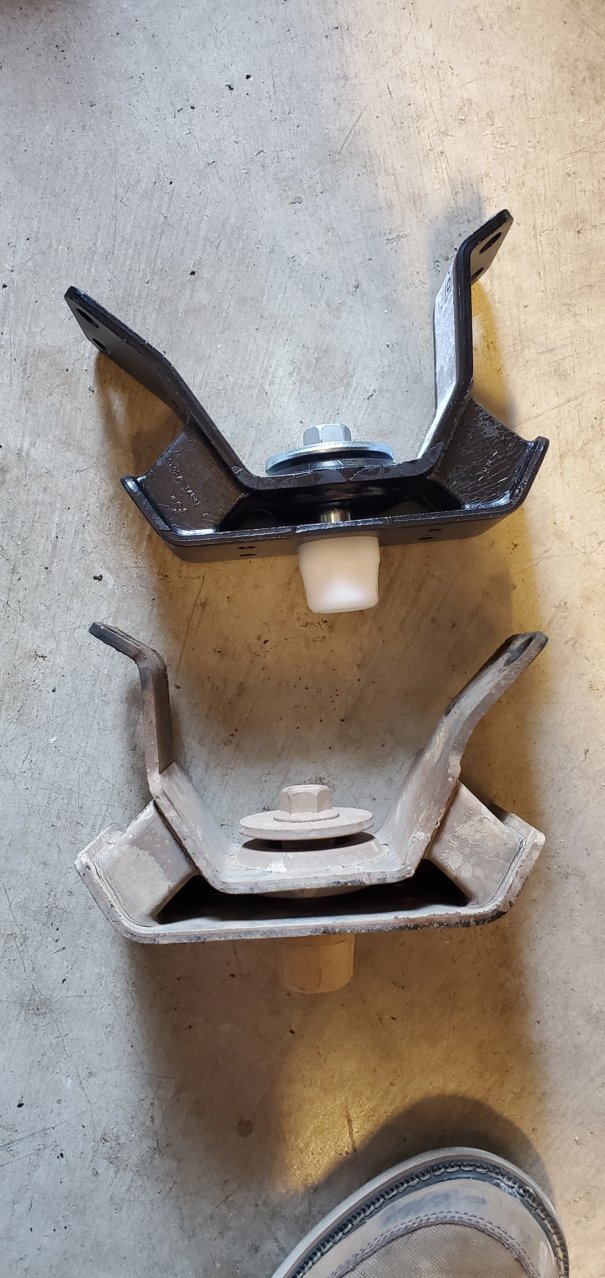

    Installed a new OEM transmission mount. Might do the marmount on the old one if I feel like it. Although with the crawlbox and the poly mount for it, it'll probably be pointless.
    Also bled & refilled the clutch with new fluid

    I would have "MarMount" the new transmission mount before putting in the truck. That's what I'm planning to do with motor mounts whenever I get around to that.

    Yea been thinking about still doing it. It was a lot better out on the trail just this last weekend though.
    I don't wanna make the whole drivetrail too solidly mounted though. Having a bit of play in there I think will help since throttle control is important with a manual in super low range from what I hear.
    I'd love to do it to the motor mounts too, but it's gonna be a royal PITA to get them out without removing the front diff. Depending on how motivated I'm feeling, might try and knock it out while the truck is down for the duals. We'll see

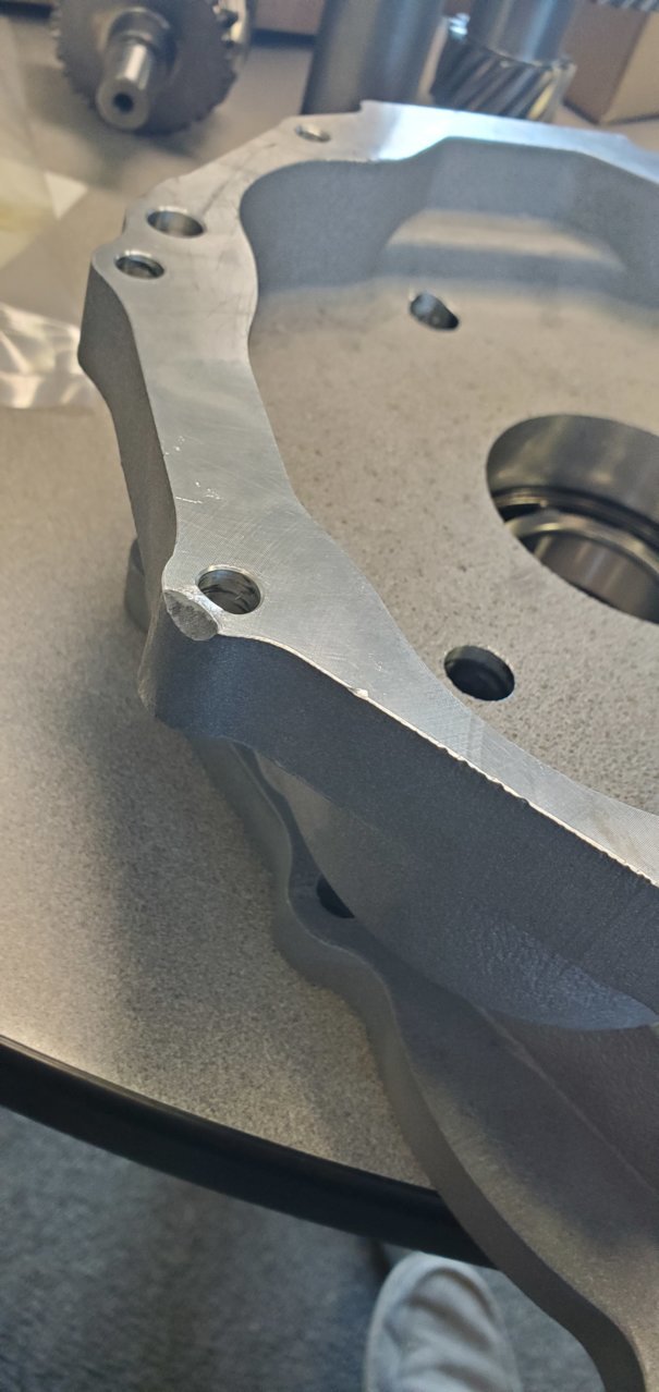

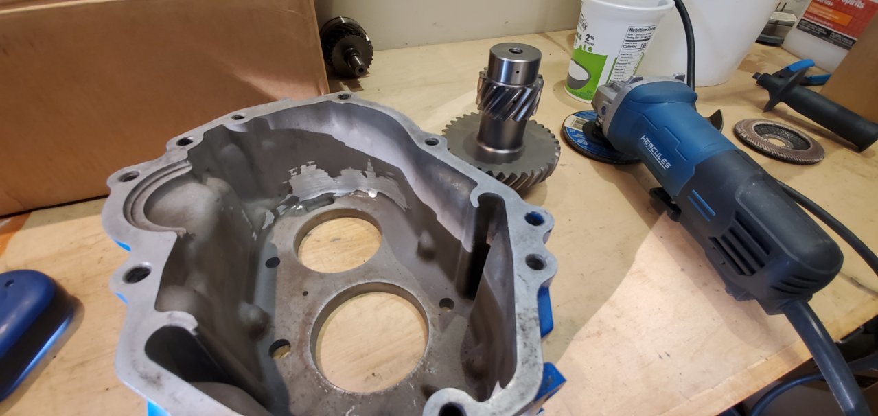

    Been working on building up the crawlbox.
    Pressed the bearings back off the MC gears to clean them in the parts washer to get the waxy protective coating off.
    Got the remainder of the needed parts in finally. Although the TG rear adapter showed up damaged. It doesn't look bad in the picture, but the hole is oblonged and the aluminum is pushed up so that the mating surface isn't flat there. I could prob grind it down and drill it out, but i'd rather not chance it. So low range is gonna send me a replacement. More waiting...
    Welded on the keystock onto the shift fork last night as well as clearanced the case for the 4.7 low speed gear.
    Just need to grind off some material on the bearing snap rings for both the input gear and counter gear. They are a bit too thick.
    Once I get the replacement adapter in, it should go together pretty quickly.

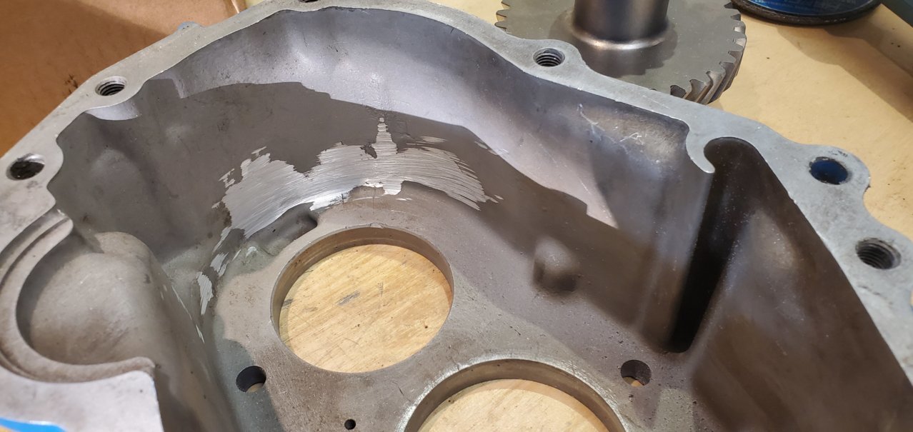

    Just look at that, I can tell you're going to have to shave more off the housing. Dry fit everything together before you seal it up and make sure everything clears.
  19. Oct 1, 2020 at 11:51 AM
    #239
    betterbuckleup
    betterbuckleup [OP] Well-Known Member
    Jun 26, 2017
    #222483
    4,735
    Ian
    Concord, CA
    2000 Tacoma SC 2.7 4x4 5spd
    Yea I put the low speed gear in there to check for clearance and it spins just fine at the right depth.
    I was thinking about maybe going a bit more just for more oil to get around it.

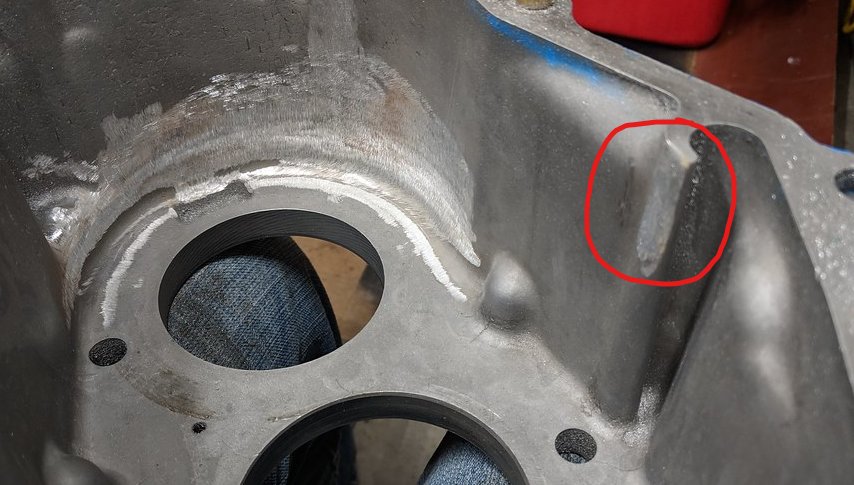

    Was looking at your pic and was trying to figure out why you clearanced this spot. I didn't have to
  20. Oct 1, 2020 at 2:24 PM
    #240
    cbechtold
    cbechtold IG: @corybechtold
    Jan 19, 2014
    #121010
    4,033
    Cory
    Pleasanton, CA
    2001 DCSB SR5 TRD 4x4
    The design might have changed since my box was built back in 2006. I had to clearence there since the top set of gears was interfering there.
