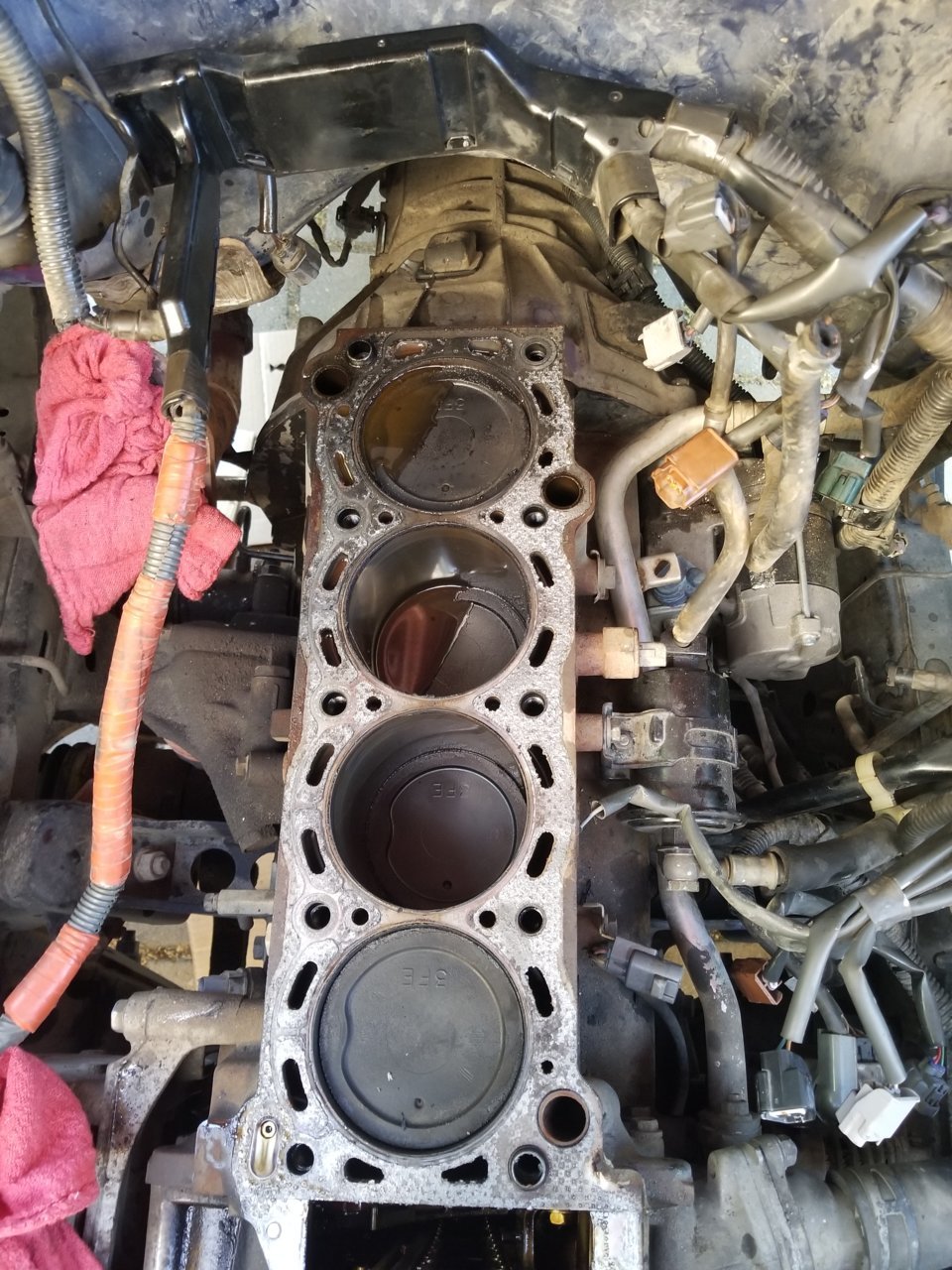

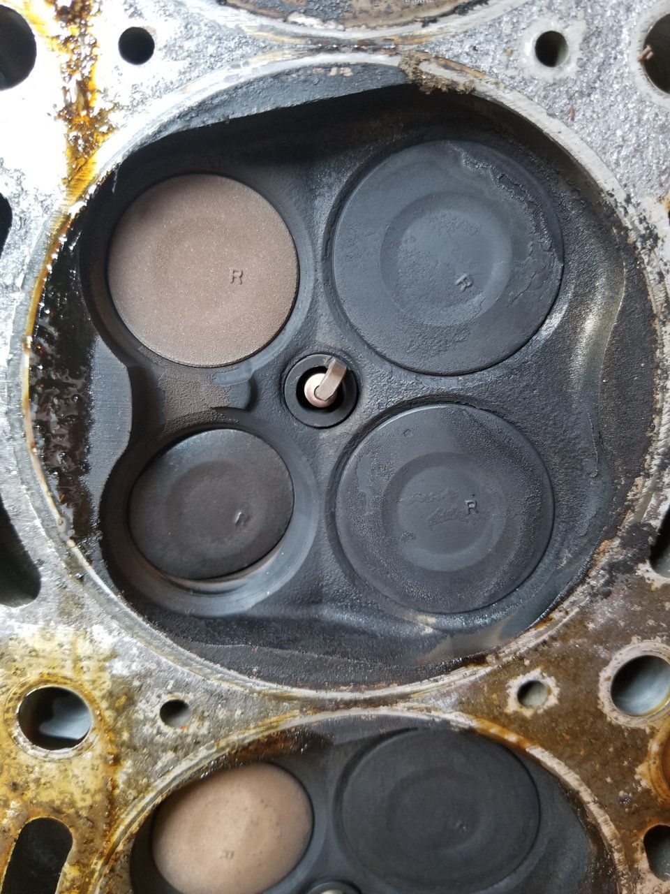

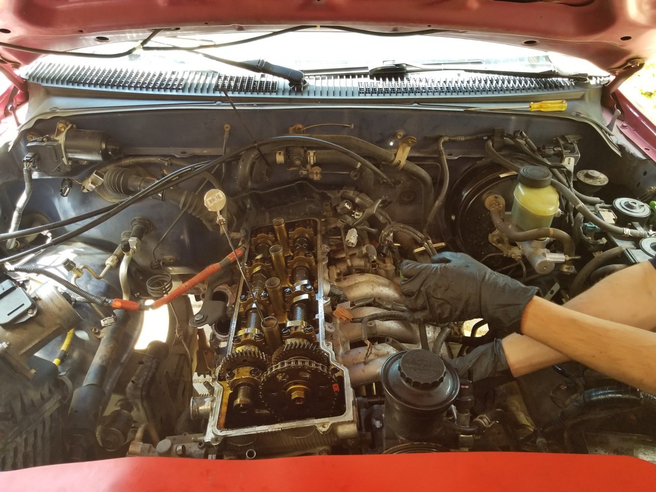

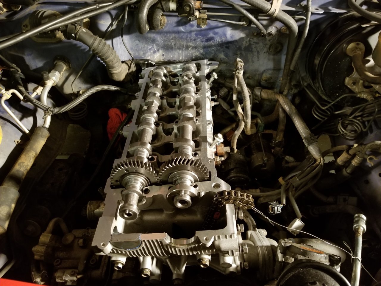

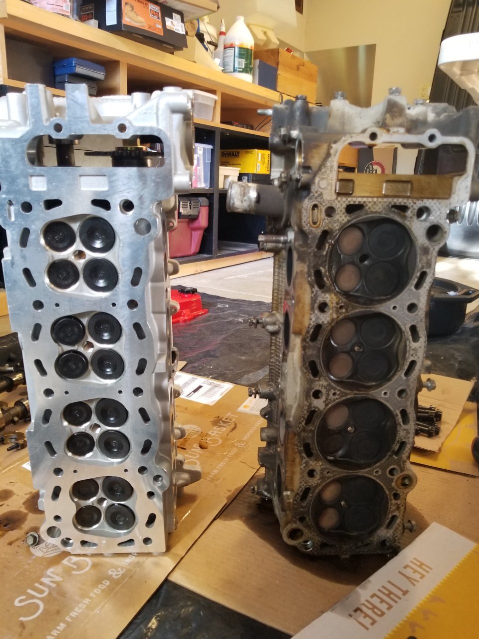

    After doing a leak down test on the engine at my buddies place, I was able to determine that the exhaust valve on cylinder 3 was wasted. I bought a new 8-port cylinder hear from King Cylinder Heads and got it shipped to me the next day for around $780.
    Take notice to the oval shaped exhaust valve. The guy I bought it from must have been driving it like that for quite some time in order to burn away that much material from the valve.
    A friend and I replaced the head in a couple days out of my garage along with changing all the fluids and some other things (not to mention with limited tools).
    I also added some bling to my valve cover, exhaust mani, and heat shield since I worked at a powder coating shop at the time.
    The Piston heads had very little carbon buildup and looked pretty clean!

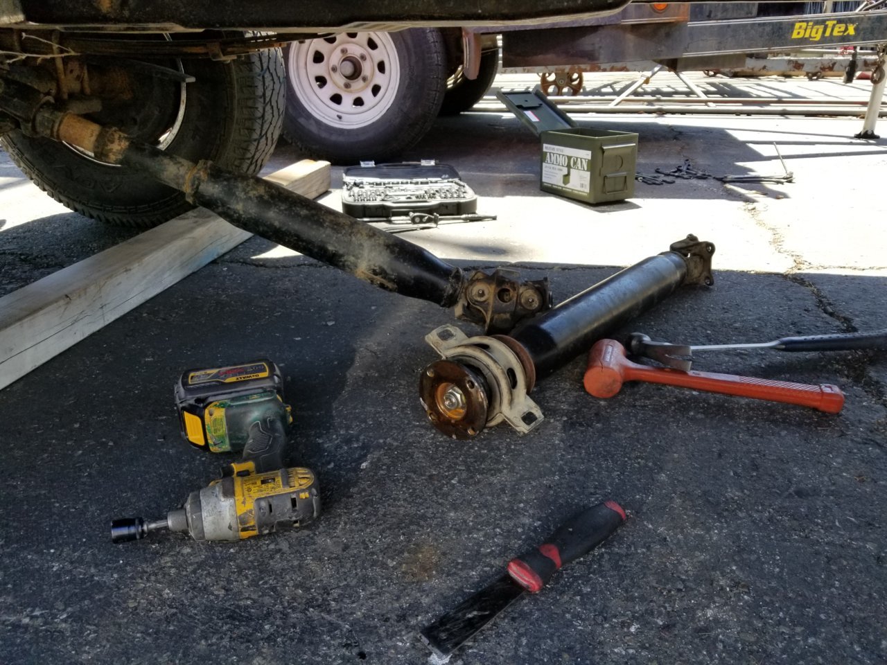

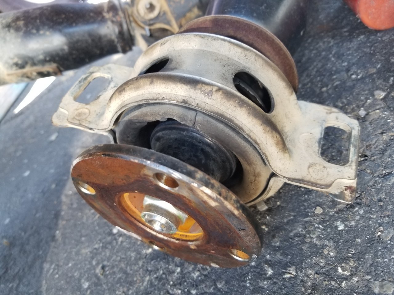

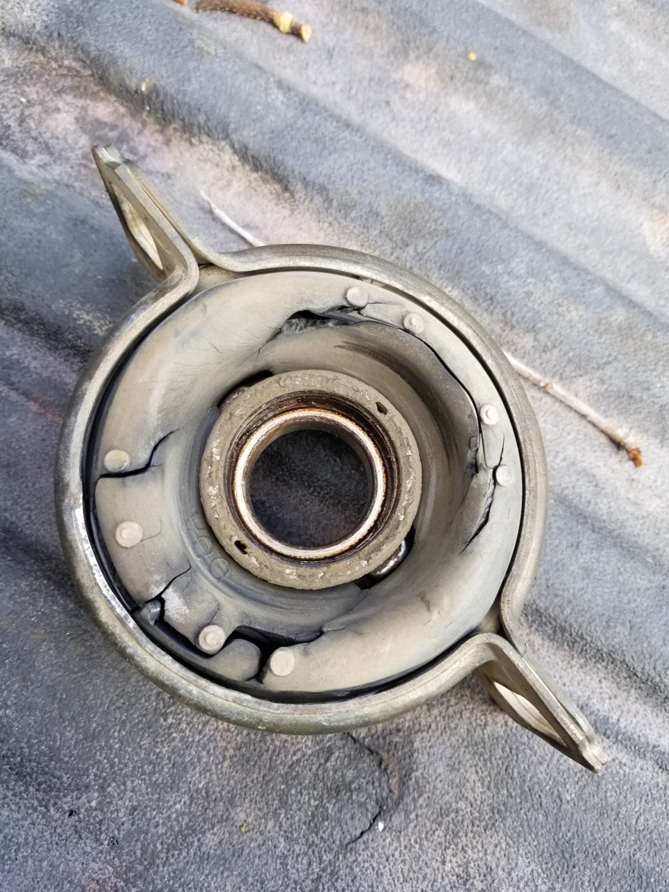

    Got around to replacing the carrier bearing since I noticed it was pretty worn at the time I purchased it.

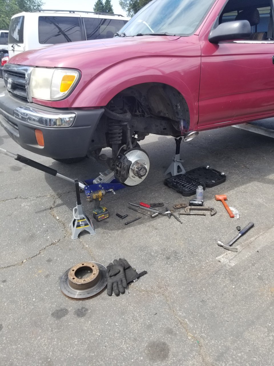

    I also replaced the front pads and rotors with some slotted and drilled ones.

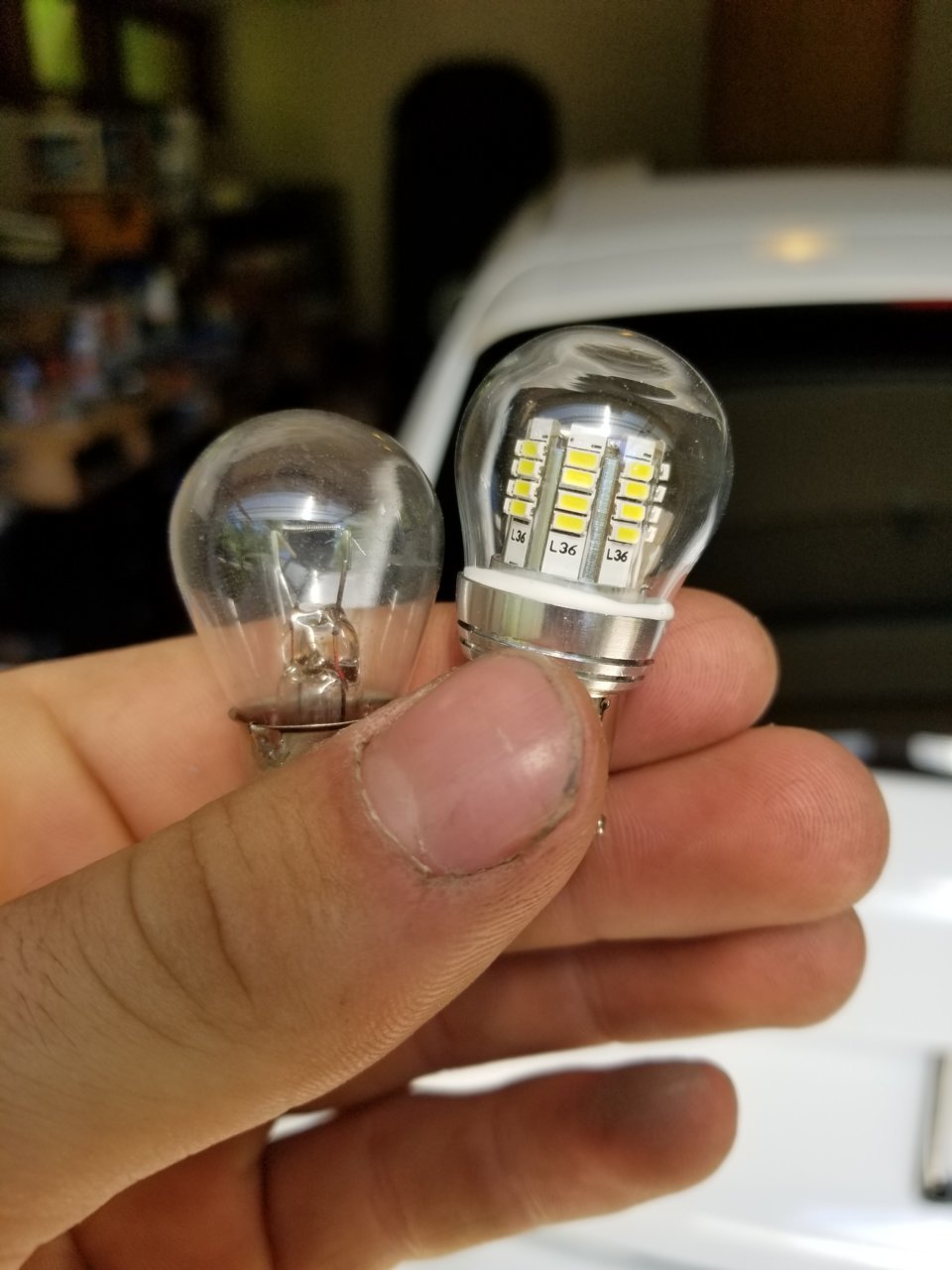

    Changed out instrument cluster bulbs to white LED ones from superbrightleds.com
    Also put in some super bright reverse LED bulbs from them as well.

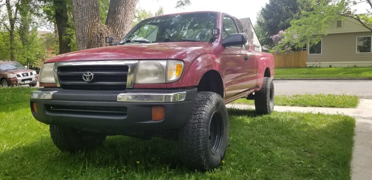

    Here are some pics of the first wheeling trip I went on with the truck. We left the day after we went to pickup a $500 Suzuki DR250 that my friend bought on Craigslist. There was a pretty sweet canyon drive out to the wheeling spot (Frank Reigns Park). Wishing I was driving my buddies Focus RS instead of a fully loaded 18 year old truck with a dirt bike in the bed for that part of the drive. :burnrubber:

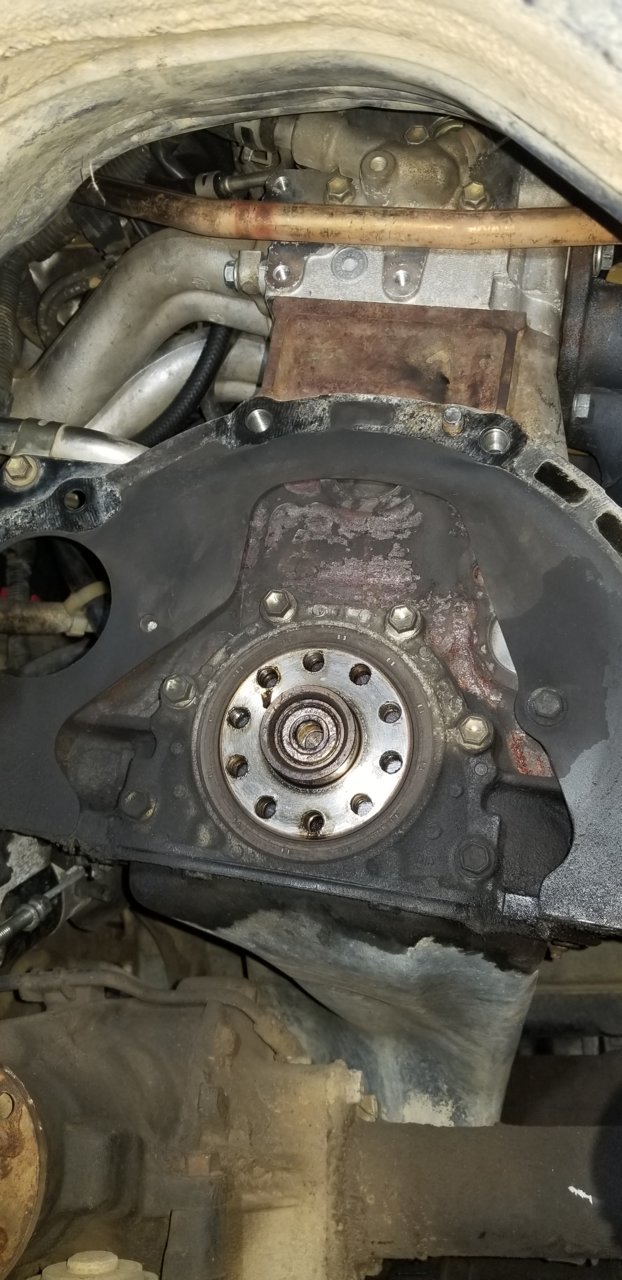

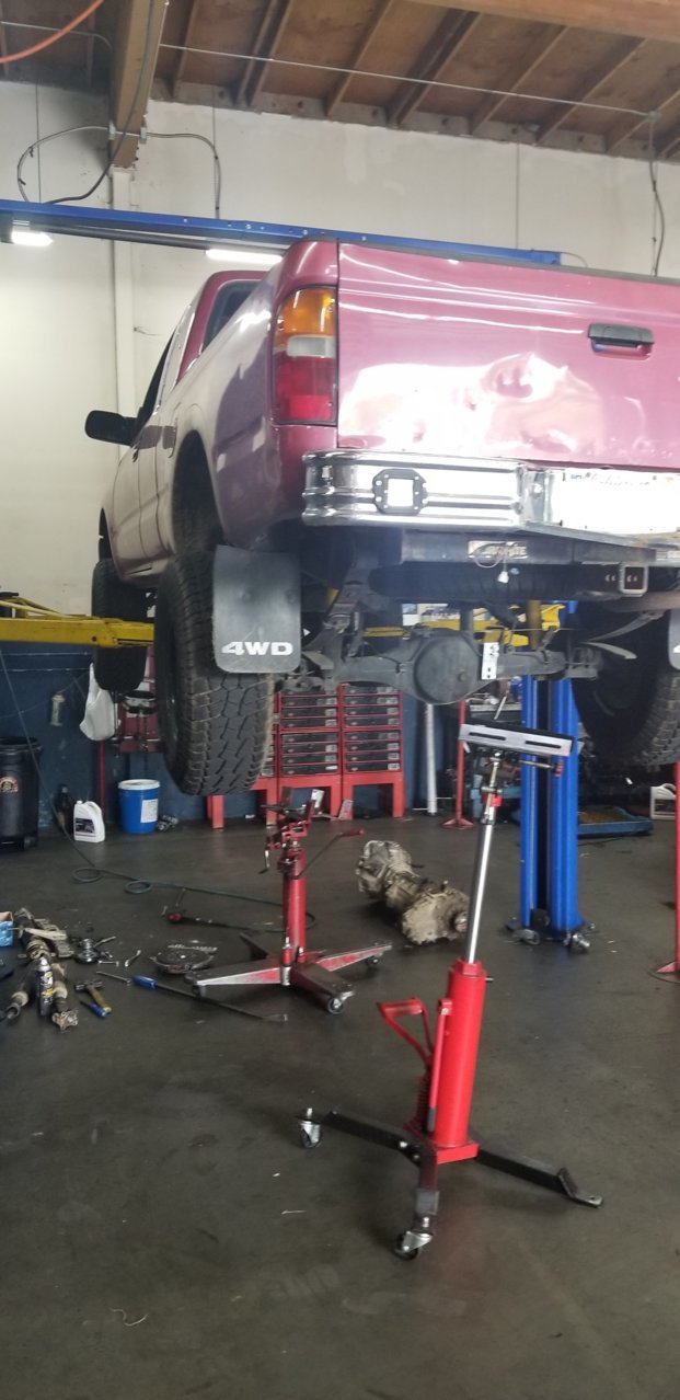

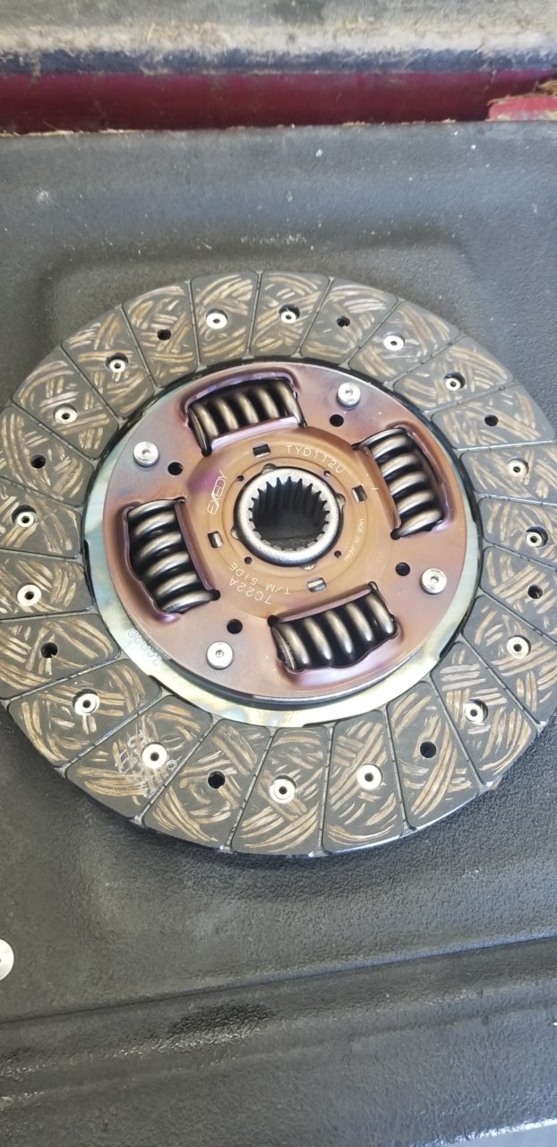

    The truck needed some work before I was going to be able to bring it up to Montana for school.

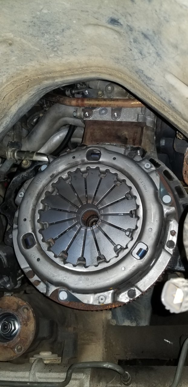

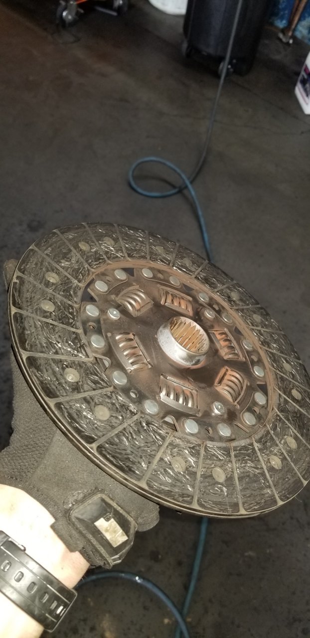

    Installed a new clutch, pressure plate, rear main seal, pilot bearing, throwout bearing, resurfaced the flywheel, and made a custom cover for the bottom of the bell housing that stuck out from the bottom of the engine to protect from rocks or anything that might want to ruin the party.
    I also got some new rubber at some point before doing the clutch. Nothing special, just some 31x10.50R15 Corsa All-terrain XL. I was on a budget and needed something with more grip than the bald all-terrains that were installed when I bought it. I got them for a steal! Around $400 for 4 tires mounted and balanced.
    old pressure plate
    old clutch disc
    new clutch disc

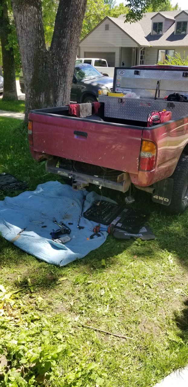

    I replaced all of the bolts that held the rear bumper and hitch on since they were all rusted pretty bad. I really should have hit them with some PBlaster and let them soak overnight because I really had to work over my 25" 1/2" breaker bar to break some of them loose. It was not fun.20180602_142955(0).jpg
    It took a while to cleanup all the rust. I used a two different wire brush attachments for my drill along with some steel wool. The steel wool didnt work as well as I thought. It would just get caught and didnt do much cleaning. The wire wheels did the most work and worked well. It was tricky trying to clean some of the tight spots and hard angles with my m18 drill.20180602_143001.jpg
    I don't have any pictures of the finished product, but i think its safe to say that I wont have to worry about rusting out this bumper until I get a new high clearance offroad bumper :D

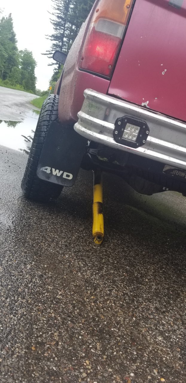

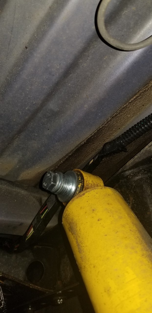

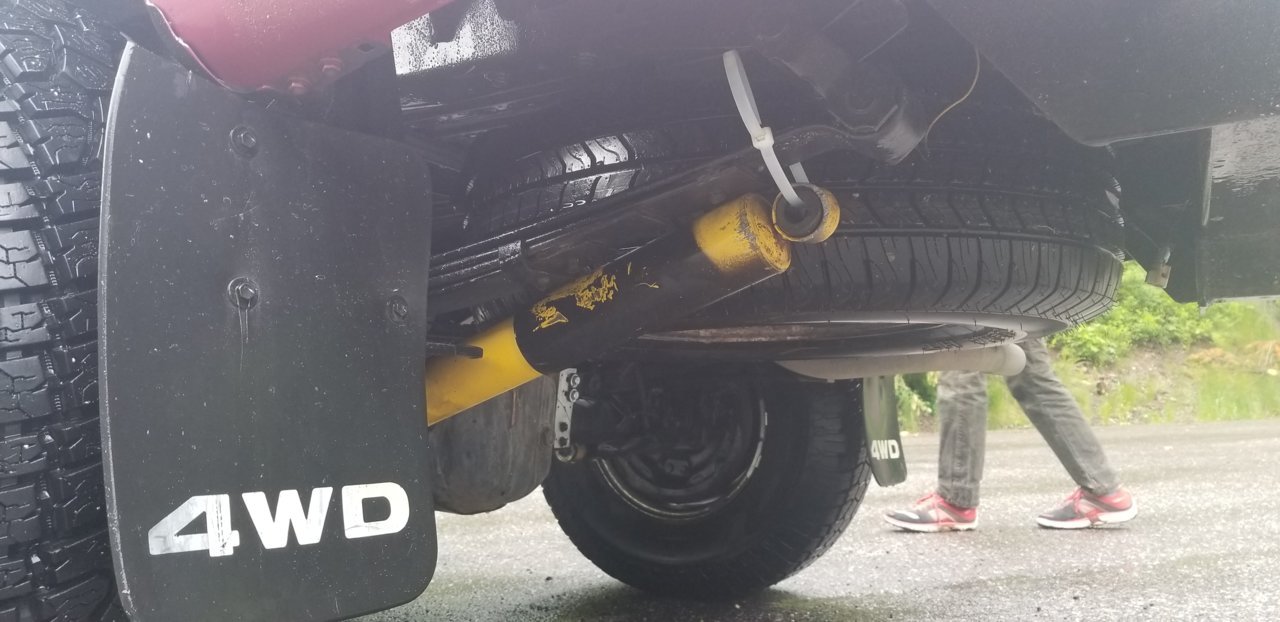

    Went wheeling and lost the top bolt that held in one of my rear shocks. Funny part is that I didn't even notice until someone flagged me down to tell me that I was dragging a shock. :facepalm:
    Nothing a late night trip to home depot can't fix until the dealership get the bolt!

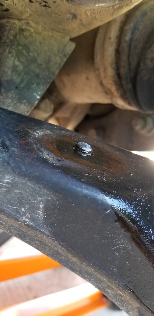

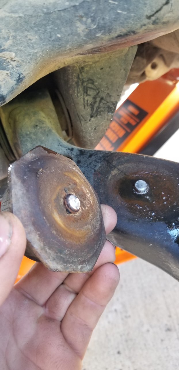

    Installed the anti-sway kit from wheelers offroad along with poly bushings for the whole cab. It definitely needed it since the old ones were cracked and worn. After installing them, they actually seemed to help a bit with impacts and dampening forces that would normally translate into the cab before.
    I also installed poly steering rack bushings from total chaos fab.
    Although when I went to install the bump stops that were included with one of the kits from wheelers, I broke off one of the front driver side bumpstop :frusty:
    There was still a bit of the stud poking out of the control arm, but I ended up really screwing myself and broke off 4 drill bits, an easy out, and part of my Leatherman in trying to get it out. No way in hell its coming out now. To this day I am still missing a front bumpstop.
    I purchased a replacement LCA from one of the forum members to swap it out with. I also got a poly LCA bushing kit to do while im at it. It's going to be one hell of a job and I haven't gotten around to it yet since I have been in school.

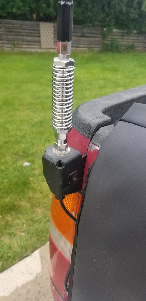

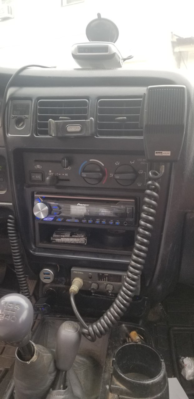

    Got all the components for my CB radio install.
    Uniden Pro 510xl
    4' firestik whip
    Light spring
    firestik stud
    Rago fabrication whip mount
    18' coax cable
    90 degree coax connector for the back of the radio
    Rented a canoe to float down the madison river with some friends for the 4th of July.
    Dont worry, I secured it a lot better and with like 4 more ratchet straps before driving to the put in.

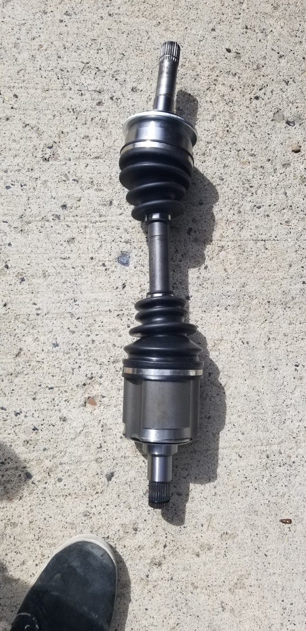

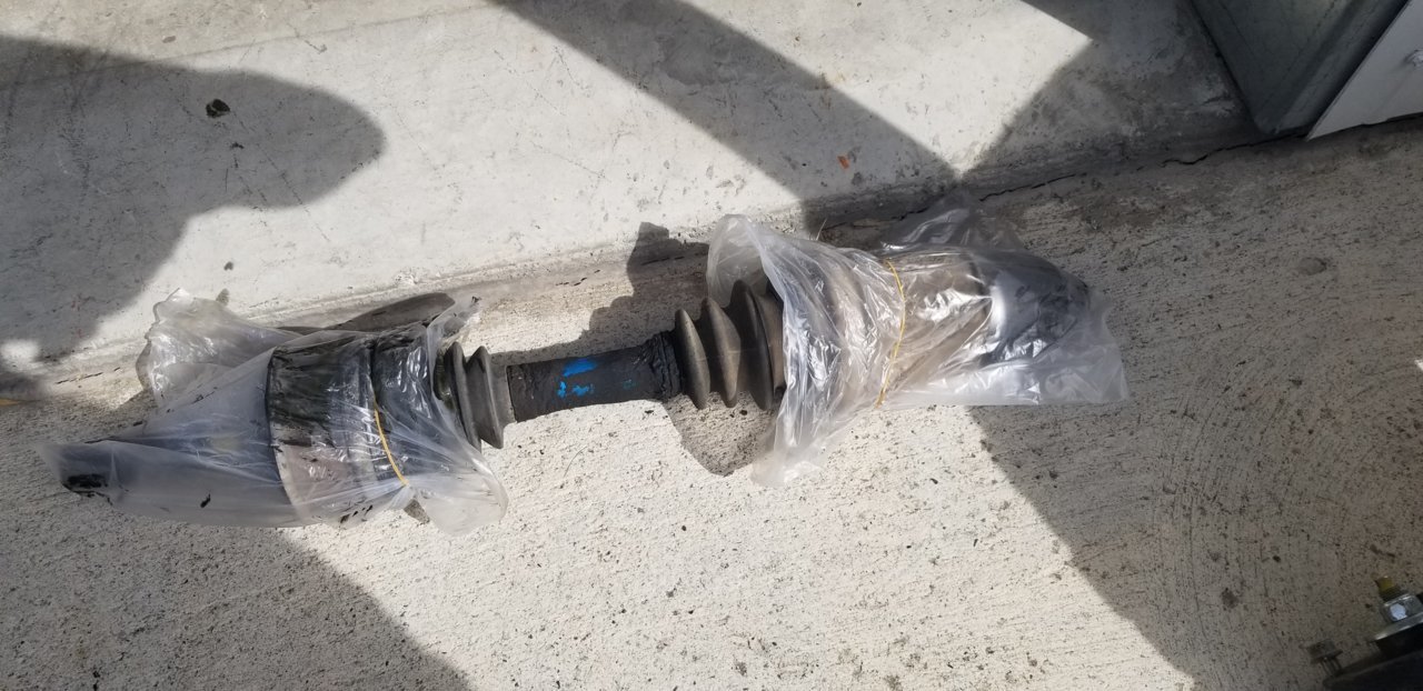

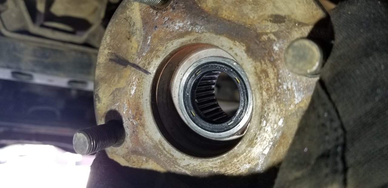

    My axles had been pretty gross and grease appeared to leak of the of the small ends of the boots so I went ahead and ordered a replacement set from summitracing. They worked just fine, I just didn't want to chance breaking one later down the line. Not to mention slinging grease everywhere when the front hubs were engaged. I should probably at some point re-boot one of the old ones so that I have a nice clear spare, but better a spare than no spare. I usually carry one of the old ones with me when wheeling just in case.
    Gross Old
    New new
    rlx02 likes this.

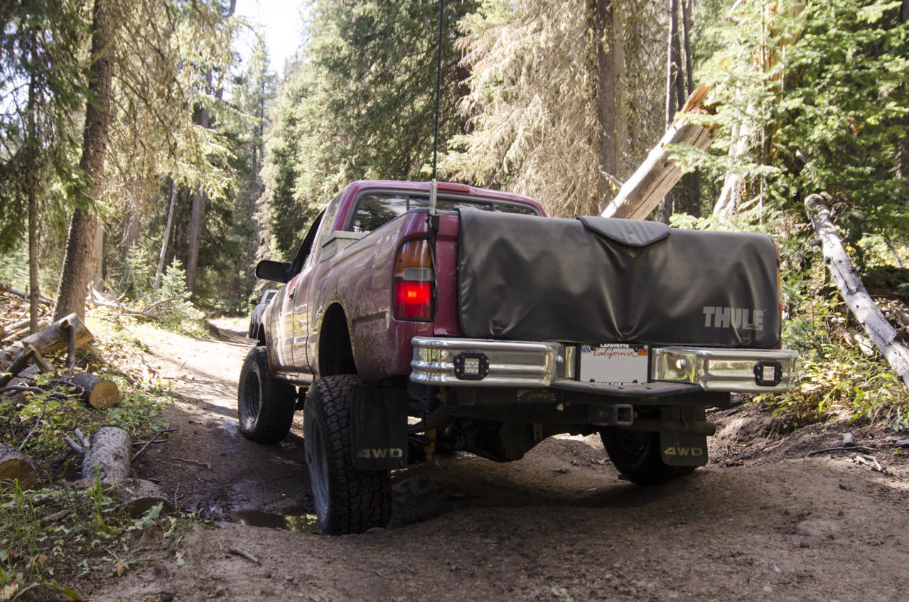

    Went on a wheeling trip up to Blue lake via Boulder River Road. Truck did great and got up through some tight narrow spots pretty easily. Couldn't say the same for my buddy with his first gen Tundra.

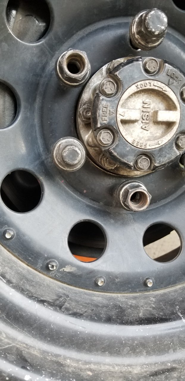

    Most recently, I got some replacement locking lug nuts since the ones that were on there appeared to be pretty mangled and shot. A bunch of the caps were missing off of a few from blasting them with my impact. The last thing I want to deal with is a failed lug nut or my wheel moving around on my studs. Definitely go with buying this online instead of in-store unless they can match or beat the price. No local auto parts store will be able to beat their price. They typically want like 6 bucks a nut (or at least they did when I checked).
    These are the ones I got. I wish they were black, but these were the most affordable ones that were in stock.
    https://www.summitracing.com/parts/gor-21134ht
    The seat was like this or worse on a good amount of the front lug nuts. Chunks were missing and a lot of the internal threads seemed to be warped or worn out (they took a good amount of force to thread onto the studs).

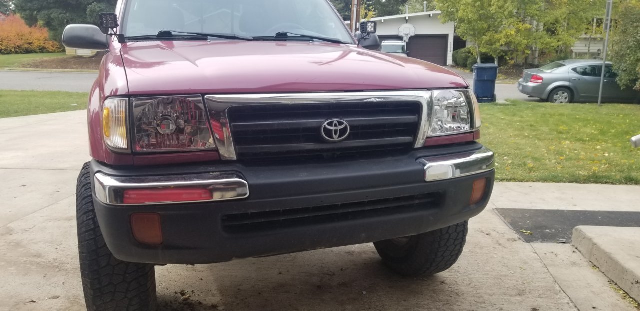

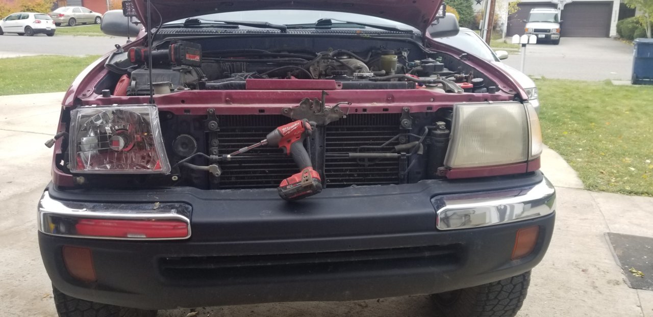

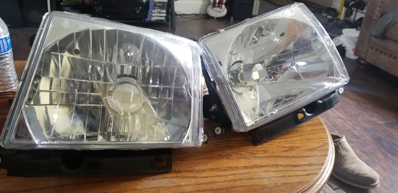

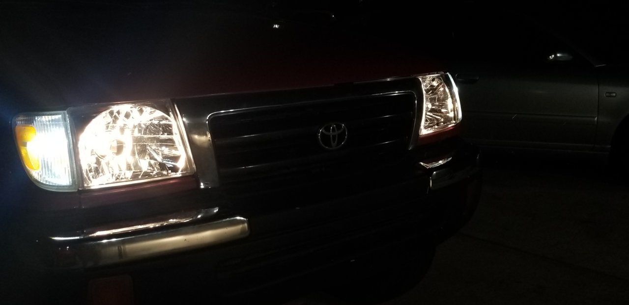

    I also purchased some clear lens headlight housings off of ebay for around $68. They even came with bulbs which is sweet. For some reason the listing went up in price to $169 when I just checked. You should still be able to find some for around that price on ebay from a different seller.
    https://www.ebay.com/itm/For-1997-1...e=STRK:MEBIDX:IT&_trksid=p2057872.m2749.l2649
    They work really well and I think they make my truck look waaay better. I paired those with some Philips Xtreme vision +130% bulbs and I can see a lot better than I could with the fogged lenses I had on before.
    I need to change out my LED side markers at some point so that they match the headlights20181010_193104.jpg

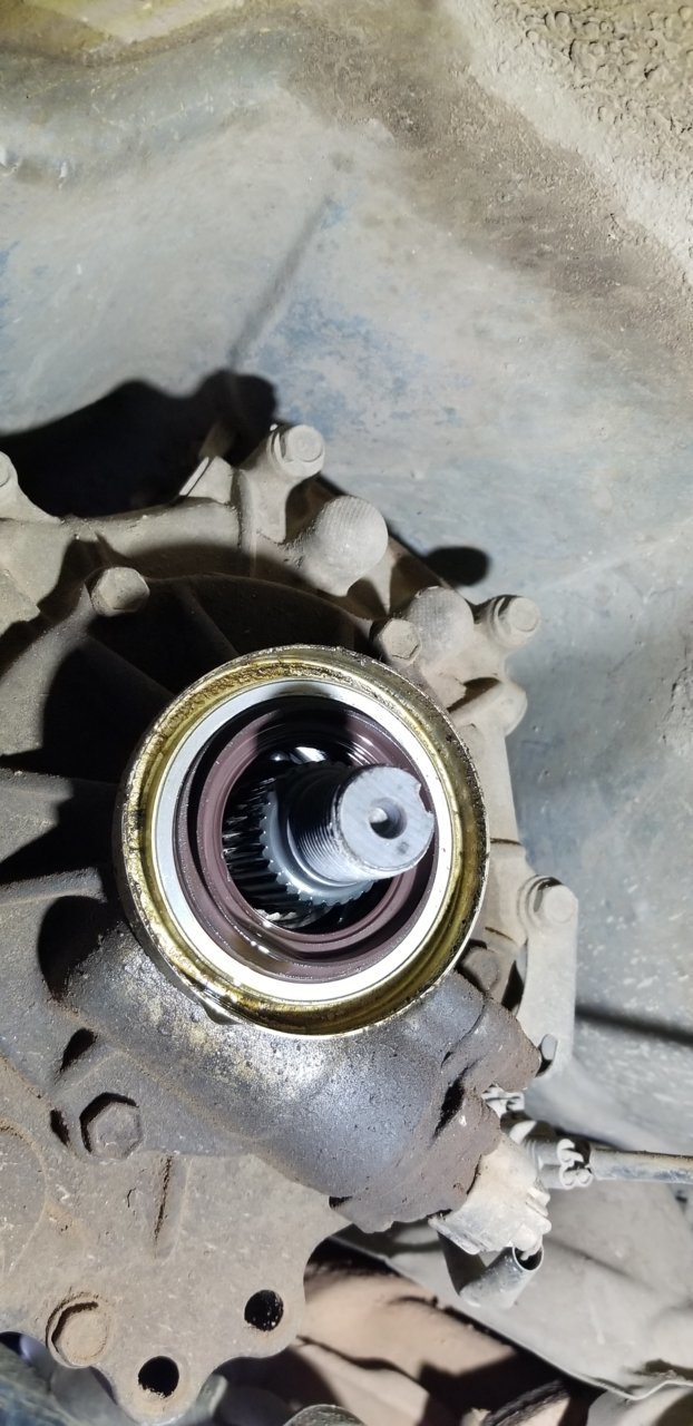

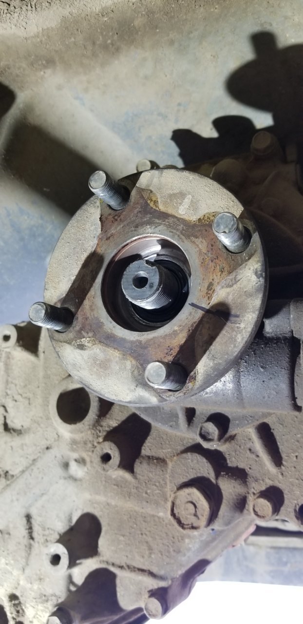

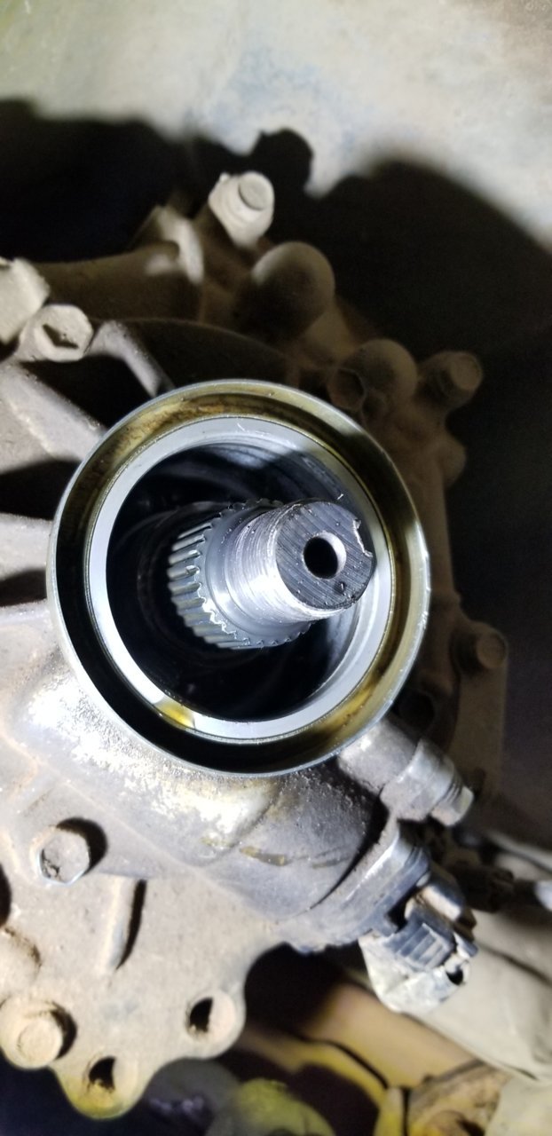

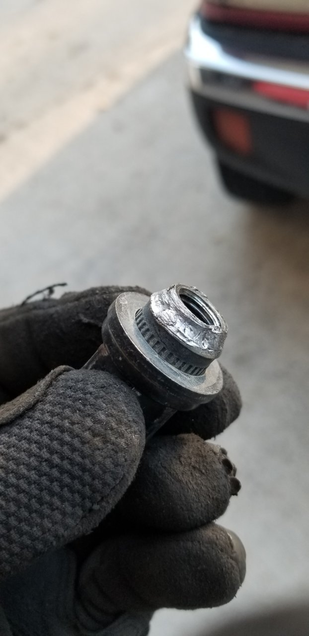

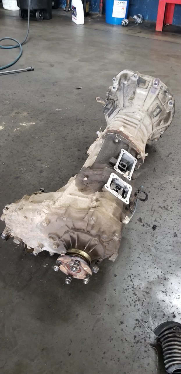

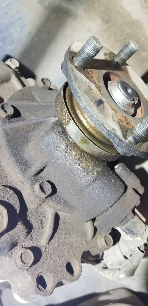

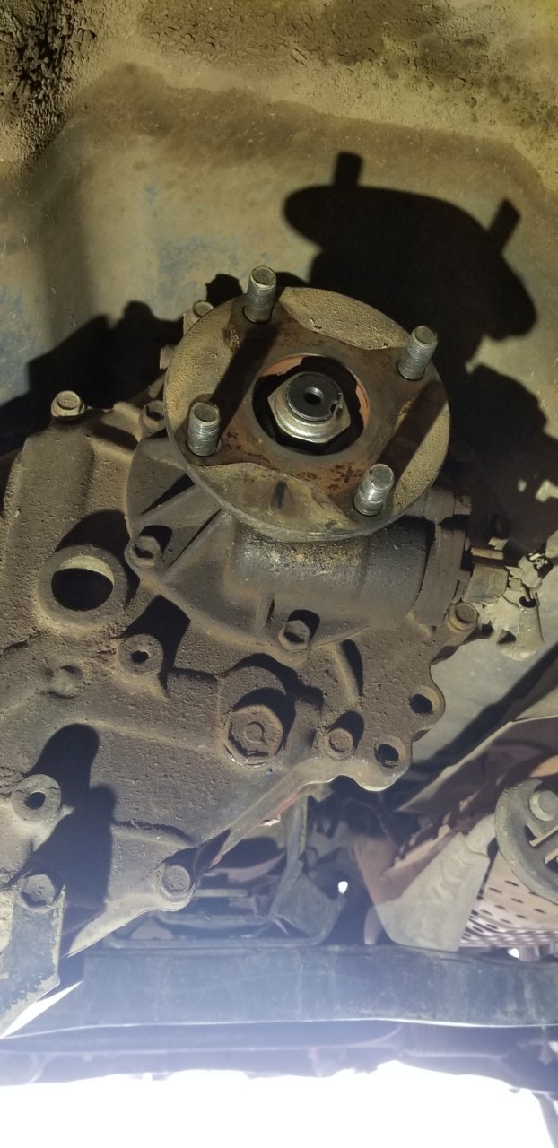

    Just picked up the inner seal, outer seal, and nut to replace on the rear output of my transfer case. For the longest time I noticed that on long drives, my rear axle and drivetrain components behind the transfer case would show signs of something being splashed on them. I realized that gear oil has been slowly leaking out of the output side of the t-case and hitting the road which would then splash onto the components down the line from it.
    I picked up the large nut that gets staked over (PN: 90179-22016) $5.50, the larger outer seal (PN: 90312-23001) $14.45, and the smaller inner seal (PN: 90311-41007) $5.66.

    So I got around to replacing the output seal on my transfer case today. I will do my best to do a write up of some of the steps involved.
    This is applicable for 5 speed 4x4 first gen tacomas.
    I first marked the alignment of the intermediate driveshaft and the rear companion flange so that they went back together exactly as they came apart.
    Use either a 14mm open end wrench or a 14mm socket with an extension attached to a ratchet to remove the 4 bolts that hold the driveshaft on.
    After the nuts are removed, remove the two 14mm bolts that secure the carrier bearing to the frame. It may be useful to support the bearing before removing the bolts so that the driveshaft does not fall on you. After it is removed, you can slide the intermediate drive shaft off of the rear companion flange studs.
    Here is what it should look like after the driveshaft is removed
    You can see where the gear oil has been leaking out of the oil seal
    To get to the seals, you next need to remove the flange. To do this you need to remove the staked over 30mm nut. Some people say that you need to "un-stake" the nut before removing it, but when I kept on breaking screwdrivers when I tried to bend the metal back. What I ended up doing was picking up a 1/2in 30mm socket from Ace Hardware. Although I wasn't able to get the nut to budge with my 25 inch 1/2" drive breaker bar. After multiple failed attempts, I went to my local Harbor freight and purchased the Bauer 1/2in. Heavy Duty Extreme Torque Impact Wrench. Since I do not have an air compressor or any air tools, this was the next best thing. It is a corded electric impact wrench with a claimed max breakaway torque of 1050 ft lbs. which should be plenty. Make sure your transfer case is shifted into 4-low before trying to take the nut off. Otherwise the flange will just spin.
    It seemed that there was some sort of sealer or glue behind the nut that was also working against me trying to remove it.
    Here is what it looked like after removing the 30mm nut.
    Once the nut is off, the flange should slide right off of the splined output shaft.
    Here is the smaller inner oil seal on the companion flange that I replaced. To remove it, just take a flathead screwdriver and pry it out. The new one should slip in relatively easily with your fingers after some oil is applied to the outer rim of the seal that contacts the flange.
    As for the larger seal behind the flange, I had a hard time removing it. I really messed it up in the process, but it's not that big of a deal as long as you don't score the seating surface. I used a combination of flat head screwdrivers, pliers, and punches to get it pry out.
    The mangled seal after removal
    The Transfer case with the seal removed
    To install the new output seal, you can do this a variety of ways. I would recommend finding a socket or something similar that fits the outer edge of the seal well to help in seating it flush. I didn't have a socket large enough to accomplish this so I ended up taking the butt end of my ratchet and working each side all the way around until it sat flush. I was careful in the process to not mess up the lip of the seal. This is by no means the best way to go about doing this, but I was in a time crunch and figured this was my best option. If it ends up leaking anytime soon, I can just get a new seal for cheap and replace it much quicker now that I have done it before (also with the right tools perhaps).
    The assembly is the opposite of the disassembly process. Torque the 30mm nut to 87 ft lbs and then stake it over with a punch or chisel. Put the transfer case in neutral to rotate the flange for an easier position to stake over the nut.
    That's about it. With the right tools, it shouldn't take more than 2 hours at most if I were to guess.
