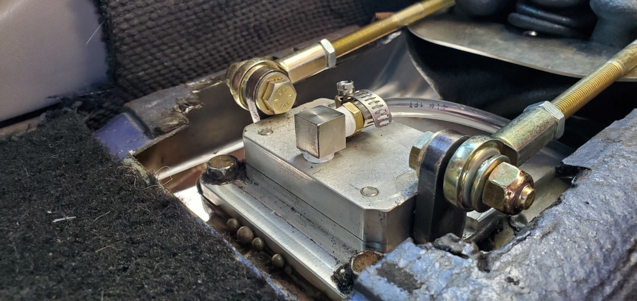

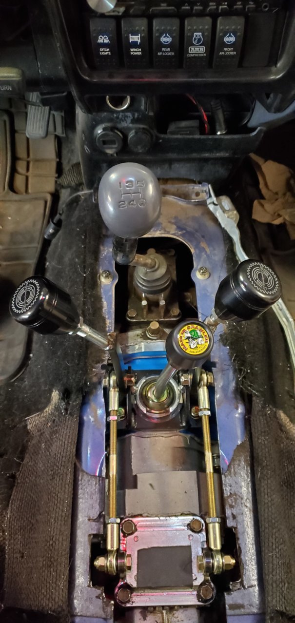

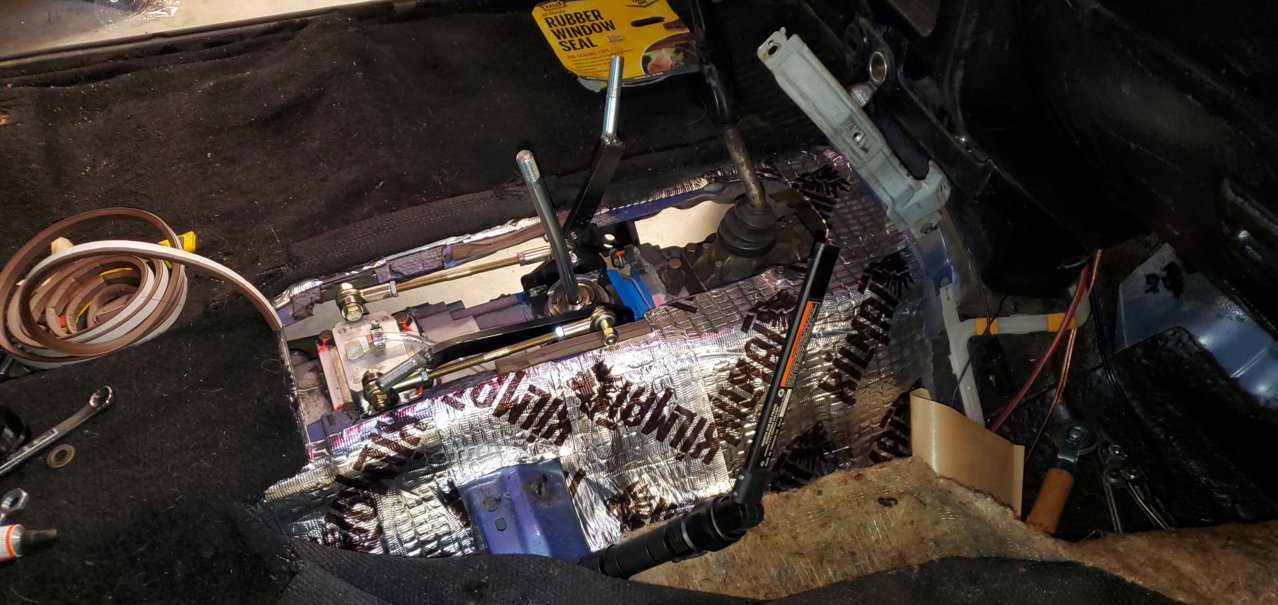

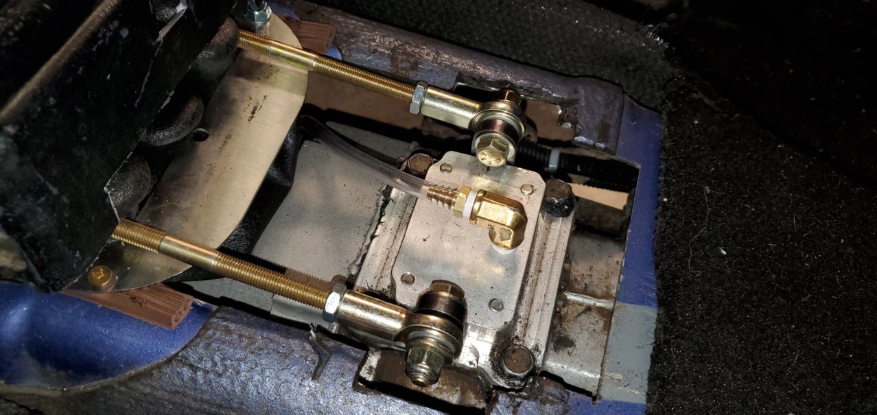

    Been messing with the shifters and sealing up the floor as I'm waiting for my driveshafts to be finished. Should get them back on Wednesday or Thursday this week and then I can start driving it.
    Everything clears in every gear now.
    I made a small panel out of aluminum sheet to cover the hole for the rear case. I covered both sides with sound deadening to increase the stiffness and help with insulation. I'll use rivnuts to fasten it to the tunnel.
    I'm not going to fasten it to the tunnel quite yet though until I have my driveshafts because I don't know how much the whole unit will be twisting around so I wanna make sure I have enough clearance for that.
    I've been toying with the idea with doing a completely custom console out of stainless or aluminum paneling to make everything look better. That way I could also completely seal off the shifters from the cab completely. The plate I made has two small cutouts for the shift linkage to run through, so those are just open to the bottom of the truck. Once I get everything running like it should and finish all the little things, I'll come back to that and start thinking of designs maybe.
    Ran the breather for the rear case up to the engine bay. Used a 6mm push-lock air muffler as a breather vent at the end because I couldn't find a breather end with a small enough barb for the hose I used, but I'm sure that'll do just fine. Just needs to keep dirt out of the line is all. Should have enough air flow.
    Extended the speedo gear sensor wire. I used these solder seal connectors that I've always wanted to try. They worked great and were much easier than trying to solder wires together upside-down in a tight spot under the truck.
    https://www.amazon.com/gp/product/B07T1HYJ9G/ref=ppx_yo_dt_b_asin_title_o01_s00?ie=UTF8&psc=1
    The "bombproof" T-case mount I got from TG doesn't fit on my case for whatever reason. I mean it does, but part of the casting on the case interferes so it's not able to sit flush with both sides of the bolt holes. I ordered one from Marlin hoping to have better luck. Also ordered a HD detent spring for my stock case for the Hi-Lo shift rail.
    Also put some torque-check on all the case bolts

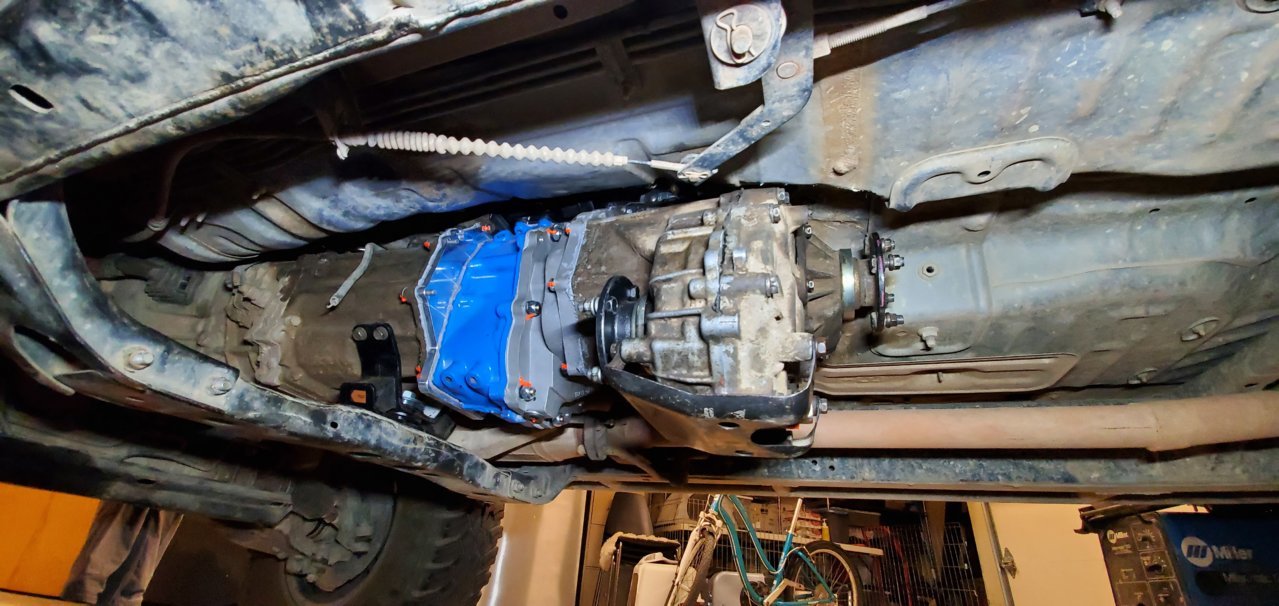

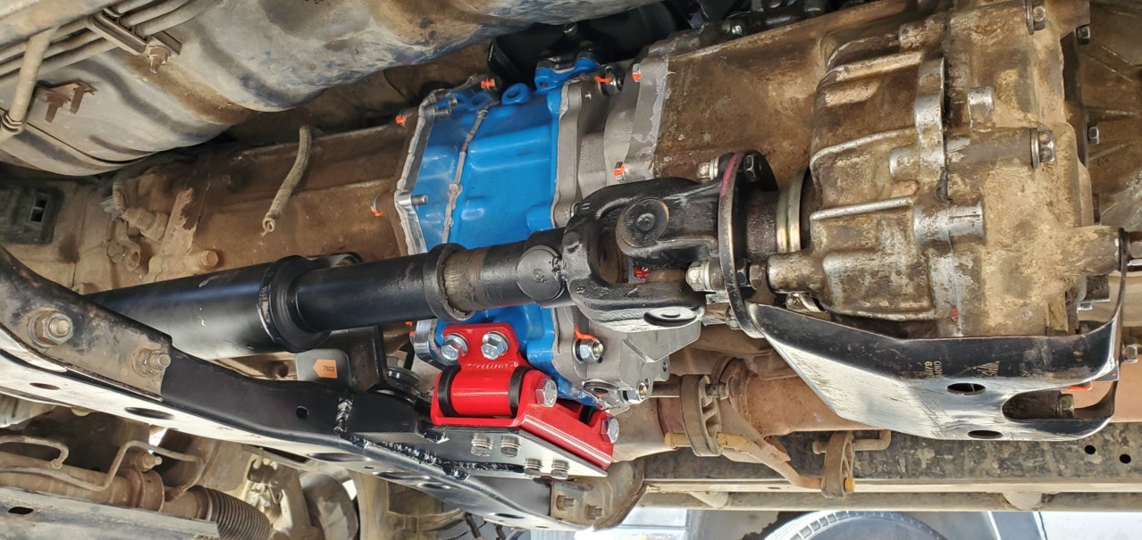

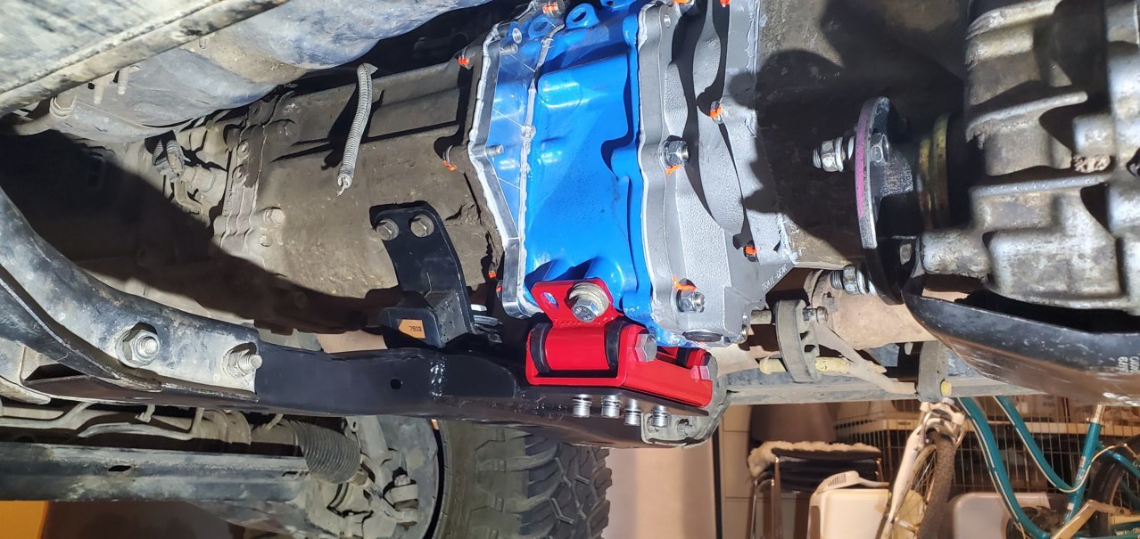

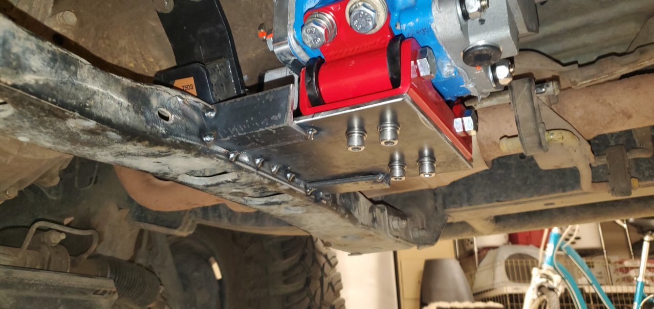

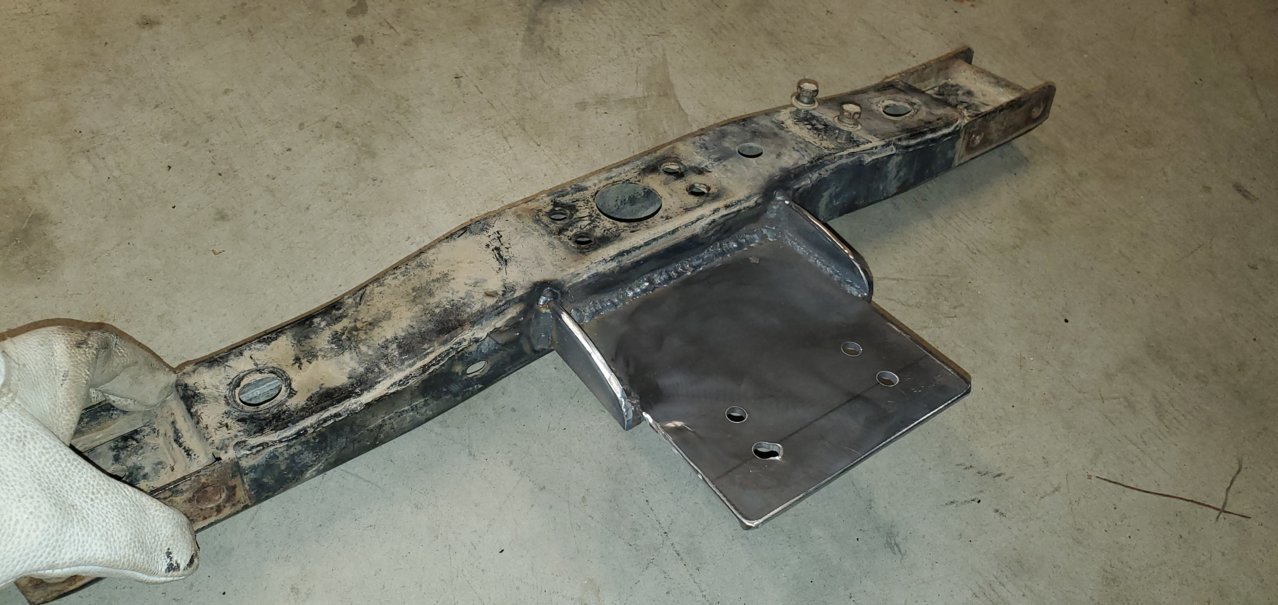

    Made a mount for the crawlbox off the existing crossmember. Used the marlin crawler mount which works great.
    Just need to get some shorter hardware for the bolts to the case and some hex head bolts for the bottom so they don't stick down as far.
    Should hopefully be picking up the driveshafts today and be driving it tonight.

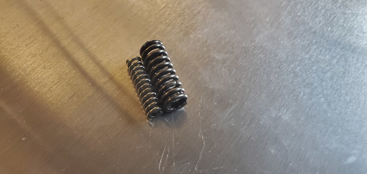

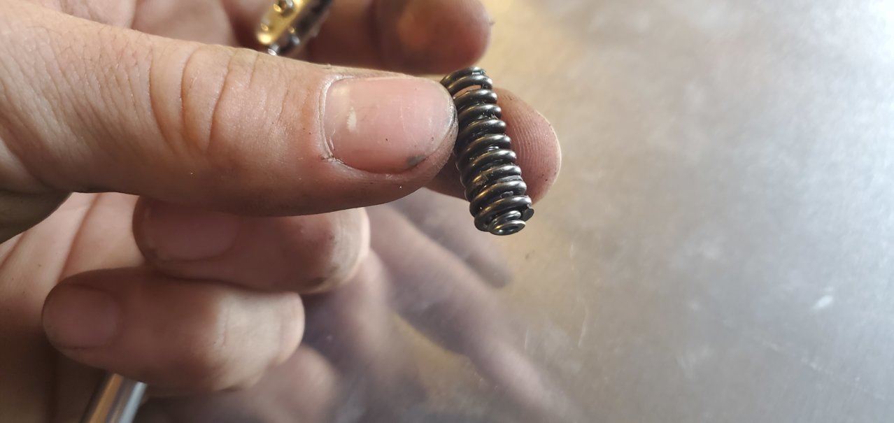

    Interestingly, the MC chain case detent spring doesn't replace the factory one. It goes inside of it. Confused me at first since it's much smaller in diameter.

    Yes. HD springs in both crawlbox and chain case hi-lo shift rail

    Replaced the mounting hardware with some better stuff that's the right length.
    Also replaced the breather elbow with a low profile one I got off mcmaster. The other one I had was too tall and was riding on the cover I made for that area.
    Next up: big ass skid plate & crossmember

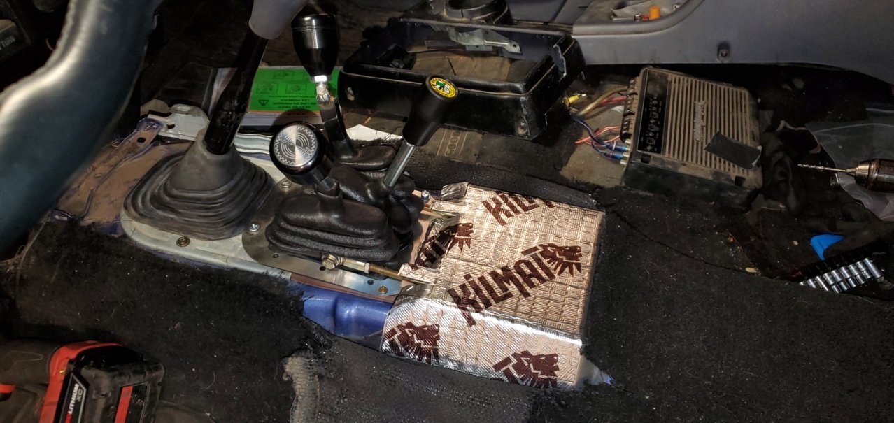

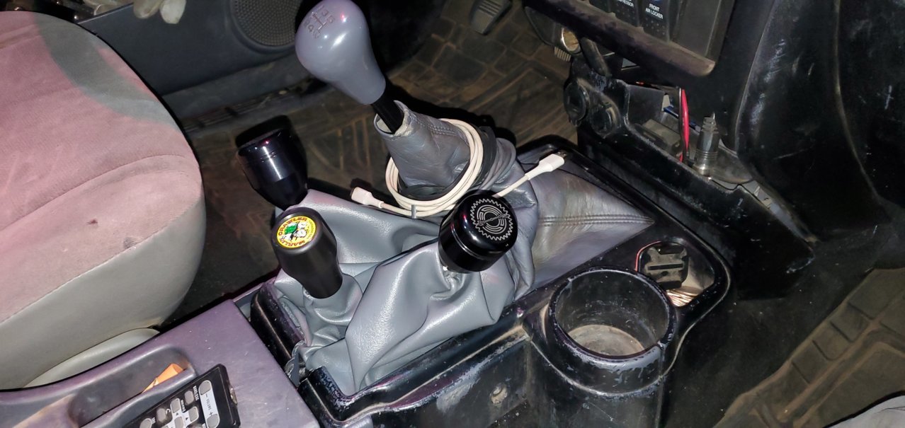

    Still need to bolt some stuff down, but got some shifter boots made up

    Also added a bunch of sound deadener matting to the tunnel area when buttoning up the cover I made.
    Thought about pulling up all the carpet and doing the whole floor of the cab, but it was glued down pretty good and didn't feel like messing with it. I'd need to get some spray adhesive to get it to stick back down after anyways.
    I do have a kind of rattle in the driver rear panel around the rear side window somewhere whenmore at low RPM's. Need to pull off that panel and put some deadener around there and try to pinpoint where it's coming from. The crawlbox mount I added transmits a good amount of more vibrations to the cab. But I think it's worth it for how little the drivetrain moves around now.
    My tires have also gotten a lot louder as they've worn in so that's pretty much the loudest part of my truck now when on the highway or driving at higher speeds.

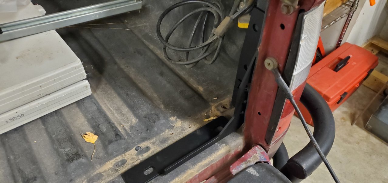

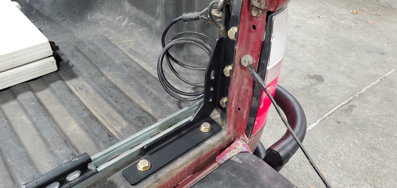

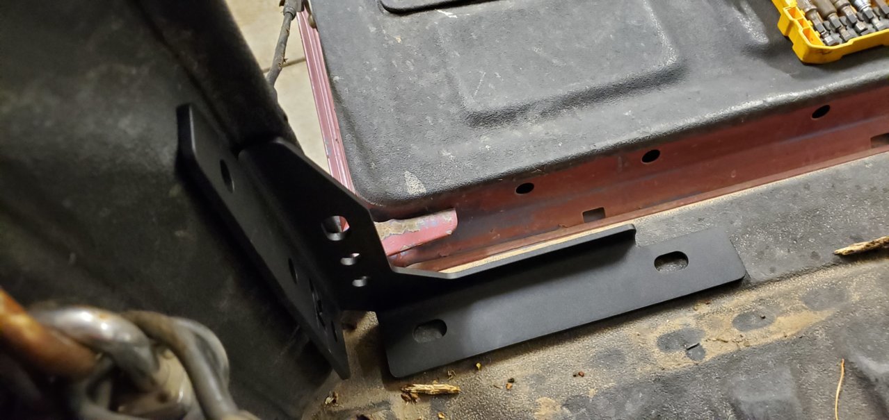

    Picked up some Rago Fab bed stiffeners on the black friday sale for a good price.
    I was going to make my own, but it was hard to beat the price and features of these.
    One piece of bent stainless steel & powder coated with proper hardware.
    I can now close my tailgate and have it latch on it's own. Before, I would have to lift the handle as I closed it in order to get it to latch closed. The bedsides are way more rigid now. They had a good amount of play to them before.
    Overall quality product and I'm happy with the outcome.
    One thing to mention though, is that they are labeled backwards as to which is left and right.
    If I were to install them how they have them labeled, the drilled holes would be going into the contour of the bedside and the tie-down points would be blocked by the edge of the tailgate lip

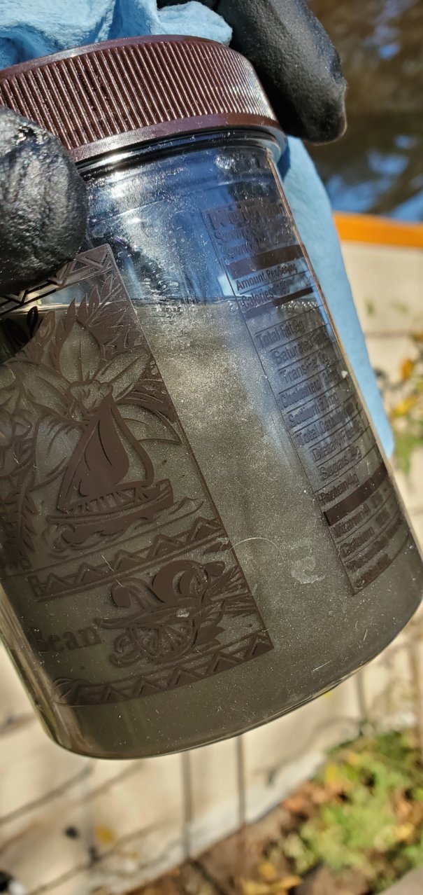

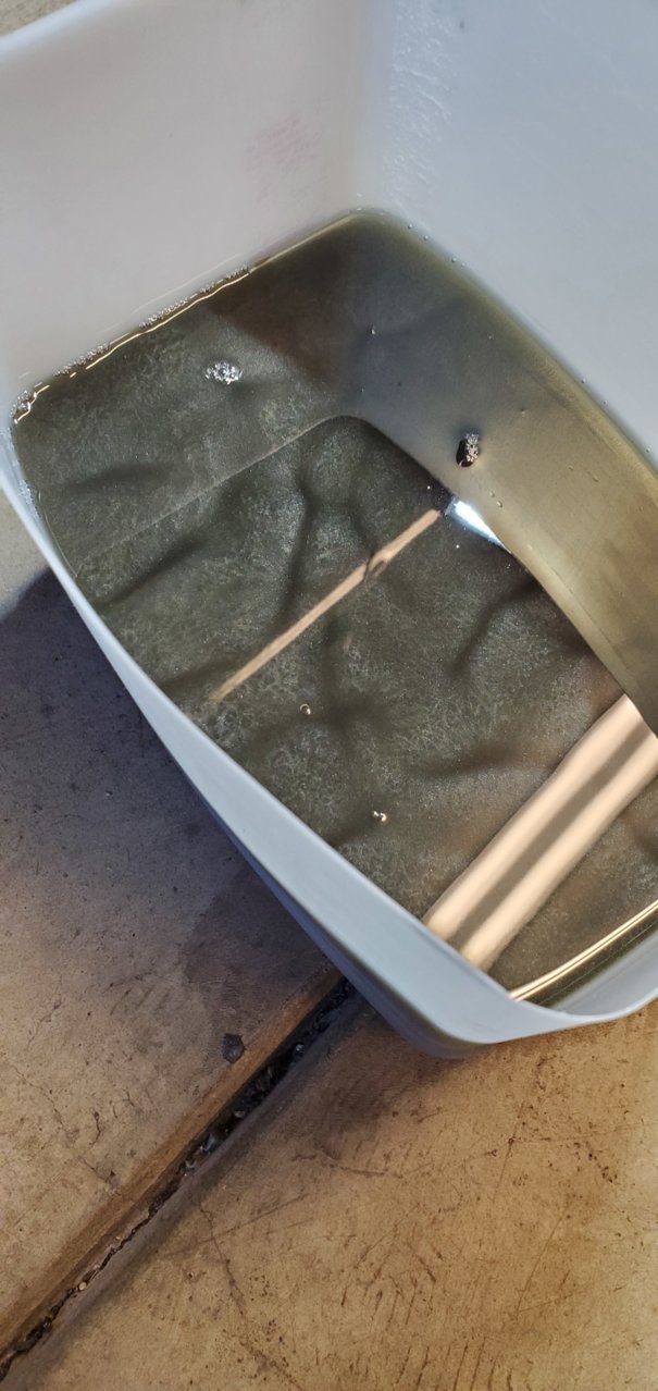

    So went to do the first fluid change on the crawlbox after putting 1400 miles on it.
    There was a lot of metal in the oil which had me concerned. Although after talking with some folks who's fluid looked sorta similar, I'm not as worried as before.
    The magnets on the fill & drain plug were covered, but there wasn't as much material there as I would have thought. So I believe all the metal suspended in the fluid is aluminum.
    It hasn't been making any concerning noises when driving it other than the typical gear noise.
    I put new fluid in it and I'm gonna run it for another couple hundred miles and check it again. If it's got some more glitter to it, then I'll be pulling it all back apart to see what in the holy hell is going on.
    Whatever it is that created all that liquid metal, has likely already self-clearanced (hopefully just the housing)
    I probably should have changed the fluid a bit sooner, but I got mixed responses from different companies when I initially asked how long I should run it for before a change. Oh well.
    Anyone need any liquid glitter?
