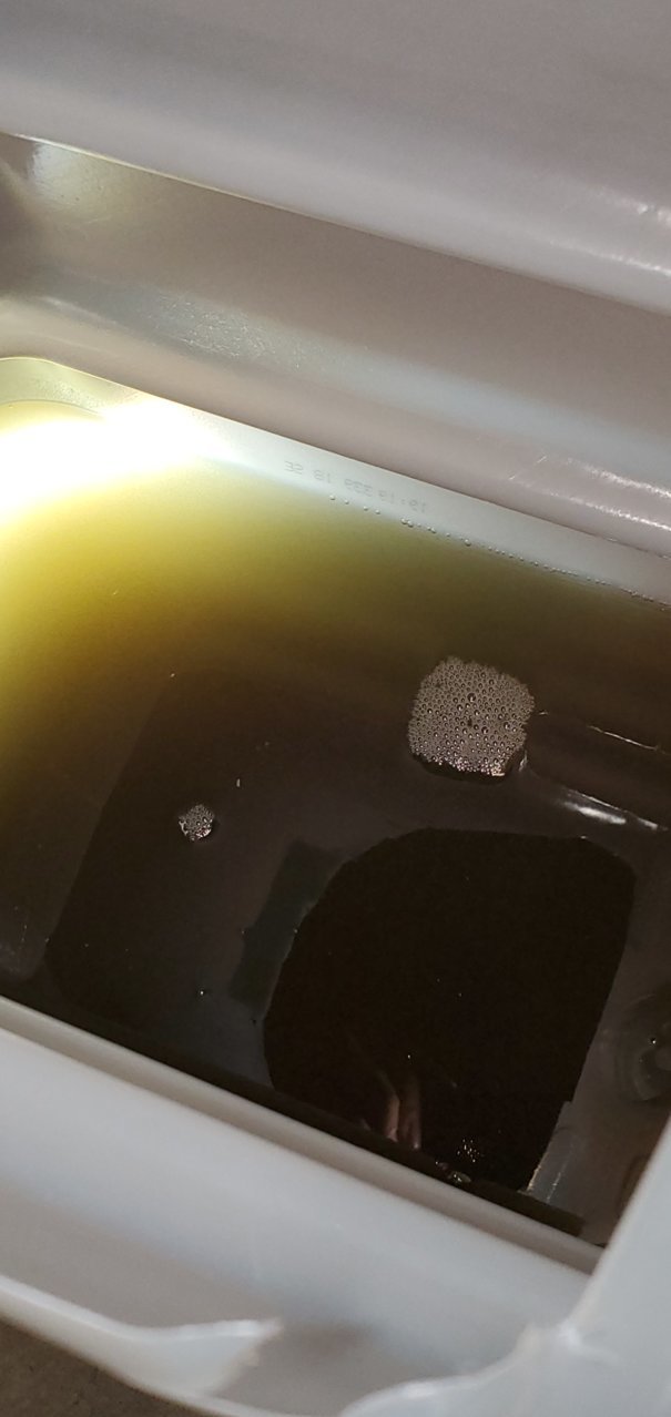

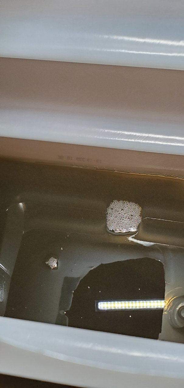

    Ok enough with this fluids BS.
    Changed out the crawlbox gear oil for hopefully the last time for a while after putting another 758 miles on it. Much cleaner than last time. Still a small amount of particles in it, but I figure that could have just been some leftover in the case from the first fill. I'm not too worried about it. Could actually see through it when you hold a light up to it this time.
    Filled it back up with a new bottle of conventional 75w-90 & topped it off with some of the drained fluid since I didn't have another bottle.

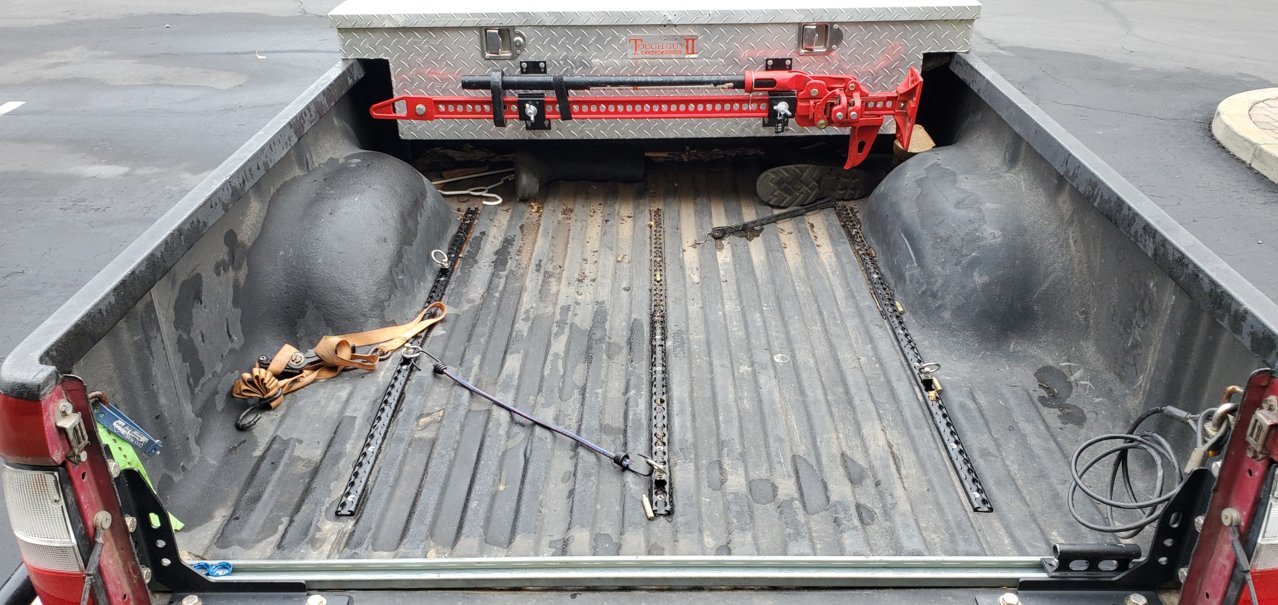

    Also finished installing some L-tracks in the bed so that I have some more tie-down points. I was getting really tired of using only the 4 tie-down points in each corner, 2 of which behind my toolbox difficult to get to. Used them this last trip out to Reno and they were super convenient. Way easier to get things securely strapped down in the bed.
    I was initially hesitant to drill holes in my bed, but I'm happy with how these turned out and glad I did. They are low profile and shouldn't get in the way of dragging things in/out & around the bed. The L-track system has a lot of accessories and options.

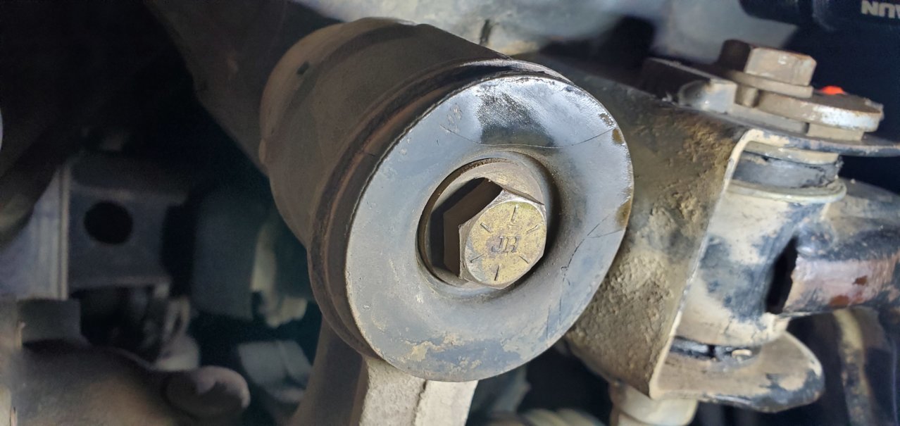

    I removed my front diff drop spacers since it caused the mounts to ride directly on the skid plate.
    The mounting washer that the bolt goes through is cracked because of that.
    Also saw that the diff housing itself was contacting the skid plate in it's lowest hanging spot so hopefully that doesn't happen anymore.

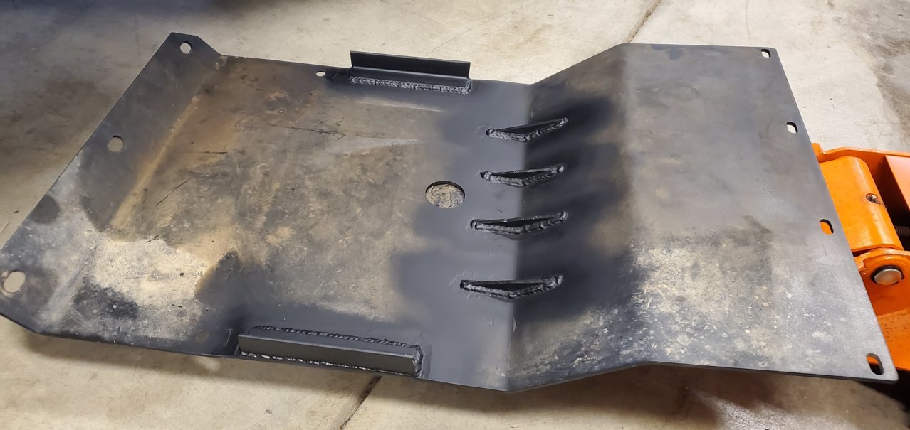

    Took the opportunity to also reinforce my IFS skid in some places

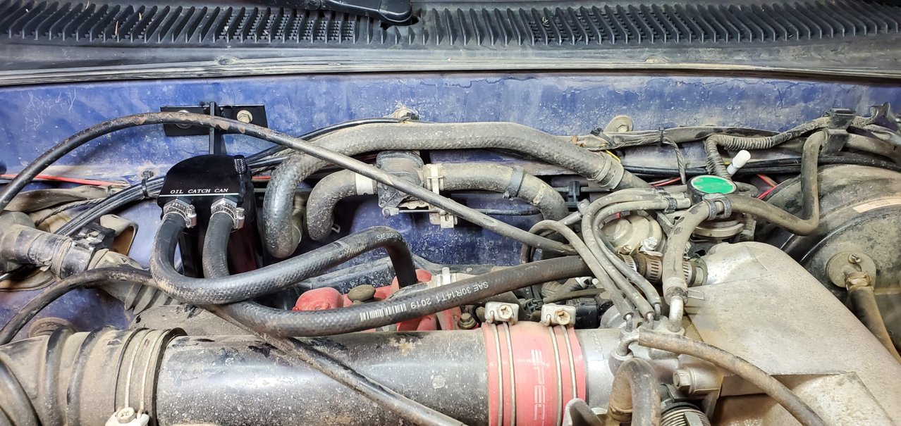

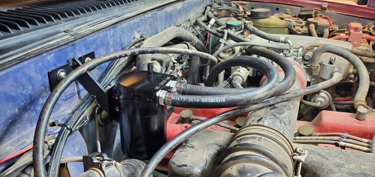

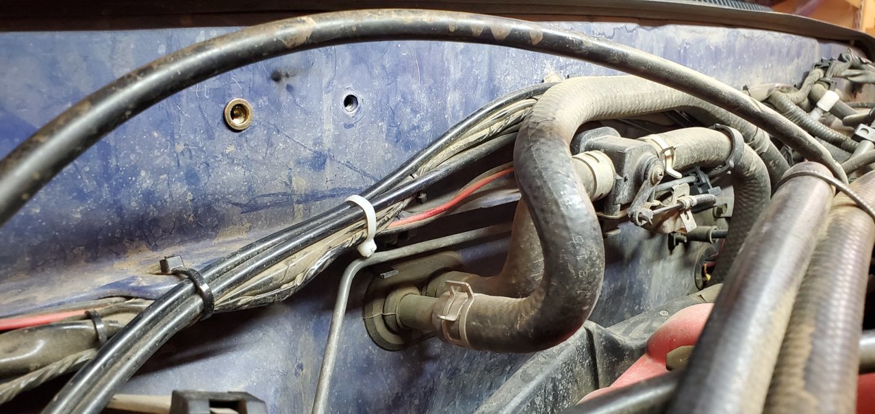

    Got a new PCV oil catch can to replace the shitty ebay one that I had that was pretty much a soda can with two barb fittings. This one actually has baffling in it and some stainless steel wool at the bottom to help with additional separation. That and an oil dip stick to check the level. Overall pretty good quality for the whatever 27 bucks it costed on Amazon.
    I wanted it closer to the inlet and outlet so that it could actually work properly. With where I had it before, the lines were so long that I believe no oil or vapors were actually able to get to it.

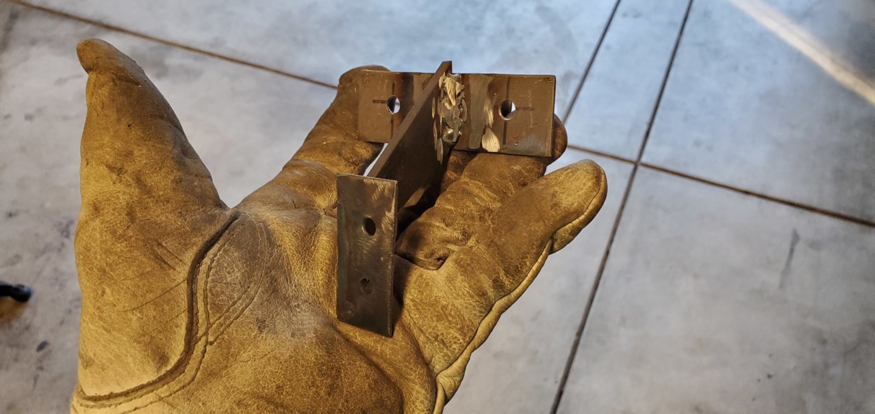

    So I made a little bracket out of some 16 gauge & 3/16"s flatbar to hold it off of the firewall. I used an existing hole for the grounding wire that's supposed to connect to the cylinder head and made a new one and put a rivnut in it.
    I whipped up the bracket pretty quickly. Didn't wanna spend too much time on it. Nothing to call home about, but does what I need it to do.
