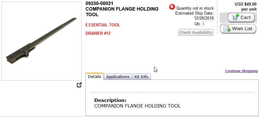

    I really do not like the idea of impacting gearbox with 1050 ft lbs. torque. I think that can mess up the gearbox bad. I'd rather support the flange from spinning with pipe wrench or something.

    I agree. I thought about that, but didn't really have many options. When I tried to wrench on it with a breaker bar, it ended up just spinning the flange even when in 4-low. Everything I have read online said to use an impact to remove the nut. I assume this is how Toyota would most likely do it as well.

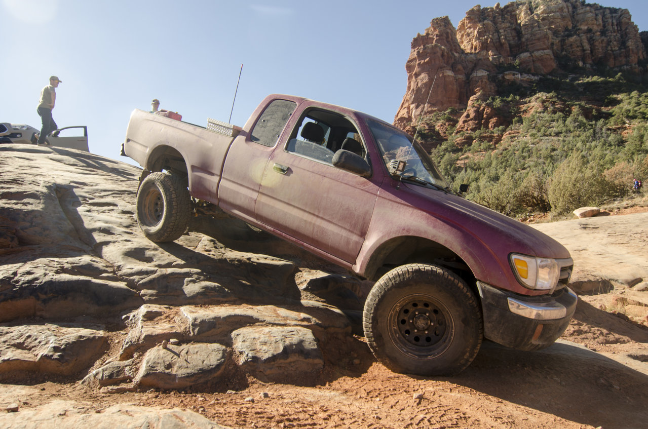

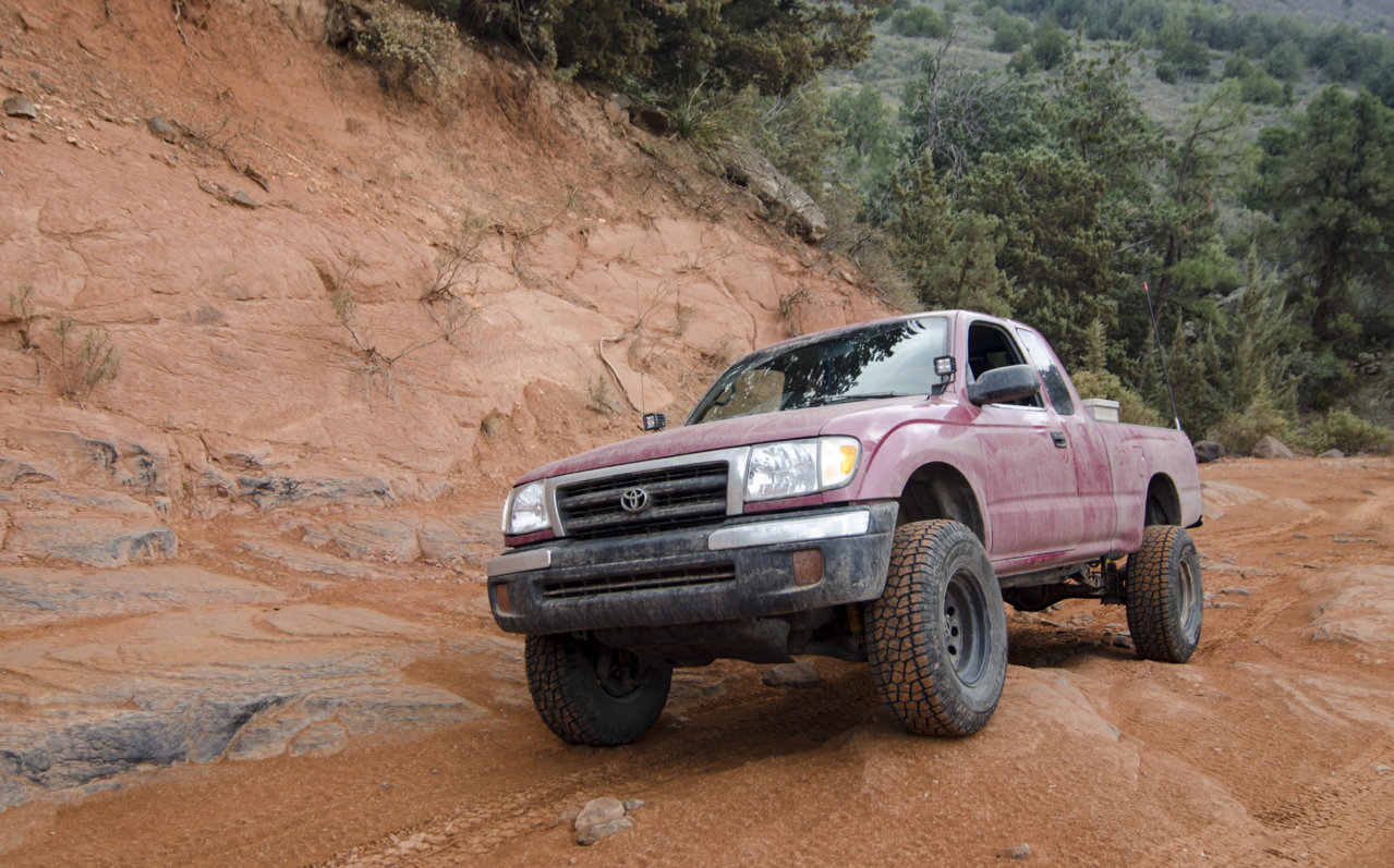

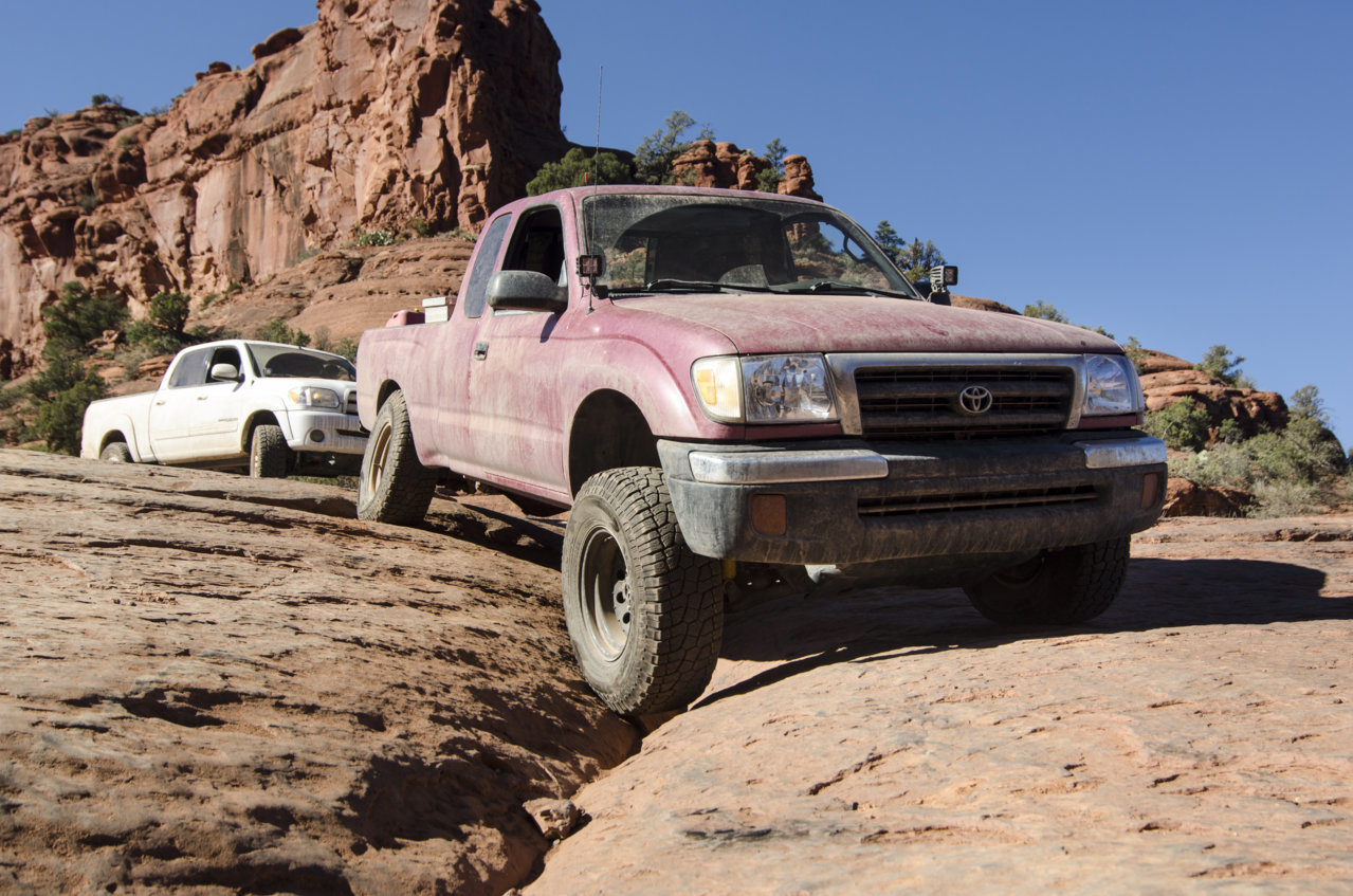

    Forgot to post some pics from my Thanksgiving wheeling/biking/camping trip with some friends that started in Virgin, Utah and ended in Sedona, Arizona. The weather was perfect outside of getting rained on for a couple of hours one day.
    I definitely recommend checking it out if you get the chance. Pretty sweet terrain!
    Schnebly Hill Rd.
    Posted up at Broken Arrow Trail. We saved the best for last and boy i'm glad we did. One of my all time favorite trails thus far. Got to wheel with a pretty badass Hummer H1 too. He was rolling on some methods wrapped in a Toyo M/T. He also had an onboard air setup where he could air up and down on the fly without having to mess around with valve stems or gauges. Pretty jealous of that. DSC_2449.jpg
    I was really impressed with how well my buddies 2018 Tacoma did on these trails. He ended up going down the Devil's Staircase without scraping ONCE. I was seriously blown away. Toyota really did a killer job making a really capable truck.
    In case you aren't familiar with what Devil's Staircase is, here is a video for reference. I didn't really get much footage of it since I was helping both of my buddies get their rigs down damage-free.
    https://www.youtube.com/watch?v=bNwmJRHKx8s
    Here is a small GIF I made from some iPhone burst shots of the descent.
    Wish my truck was cleaner that it was for the pictures, but it is what it is.
    Fun little descent that looked a lot more intimidating than it really was.
    DSC_2494.jpg Flexed out just before the exiting the trail
    OME suspension doing its job :thumbsup:

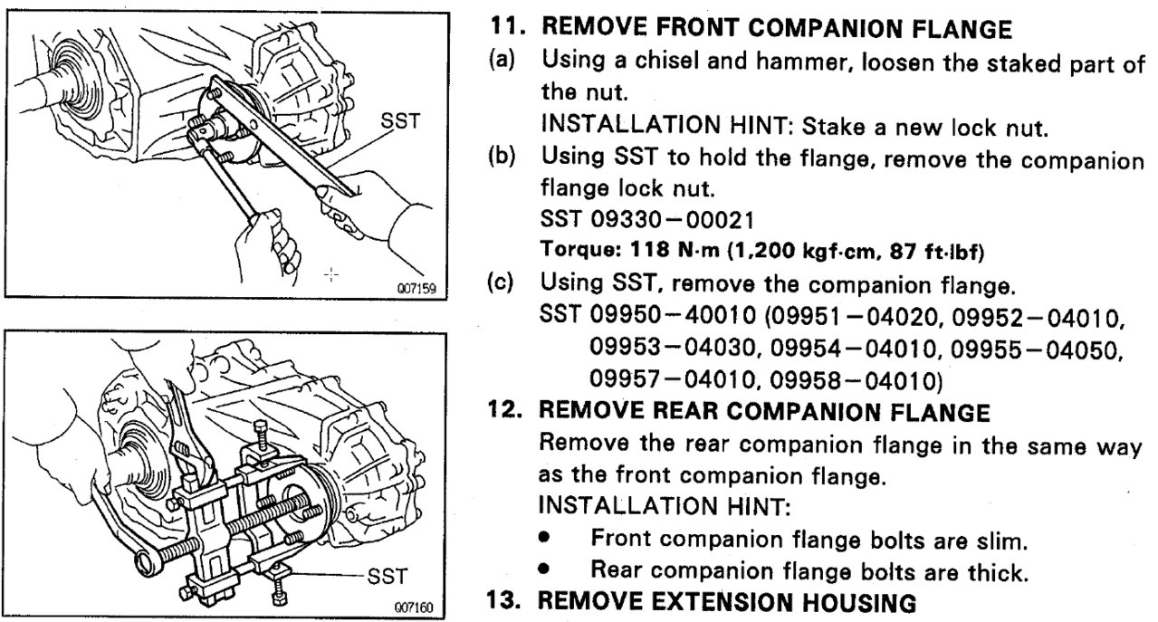

    Here is how FSM shows it:
    SST used is simple long flat bar with one hole for the flange bolt on. The bolt is torqued to 87 ft lb so there is no way it wold stand 2ft long breaker bar and 2 ft and 2 ft long flat bar (for SST).
    Really the only way you should use tires as a leverage is when removing wheel lugs. Impact wrench is great tool for breaking rusted nuts and bolts, but I'd avoid using it for reusable parts. And I hate when oil change guys use impact guns when removing skid plates - they f-ked my bolts this way.

    I was surprised that I couldn't get the nut off with my big ass breaker bar. Once I got it removed, I noticed that there was some sort of sealant of glue behind the nut that was most likely contributing to why I couldn't remove it. I really shouldn't have needed that much force to break it free based on what the torque specs. I doubt it came from the factory with that there, so some dummy must have done that at some point down the line before my ownership. At least now I have the peace of mind knowing that it will come off how it should if I ever need to service it again. :notsure:
    Do you know if it is possible to get some of the SST's that are mentioned in the FSM from a Toyota dealer? I have never needed one so far, but I have always wondered how someone would go about getting a hold of one if you did.

    I hear you, when buying used car you never know how much the PO dicked around it.

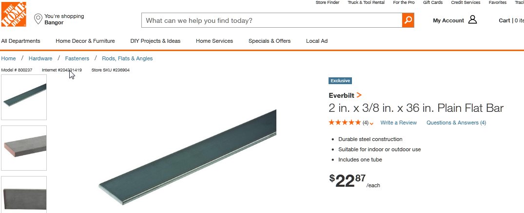

    Most of SST are simple or popular tools with fancy names. But google says you can but them for example from toyota.service-solutions.com. Just checking that t-case tool
    But I'd still go to home depot and for the half price buy that:

    Haha yea for something like that, it would definitely be more cost effective to use a piece of flat bar like you listed. Some of the tools, like for rebuilding the inside of the transfer case, would perhaps be something specifically sized that I would definitely want on hand if doing the job myself.
    Thanks for listing that resource, I was not aware of that.
