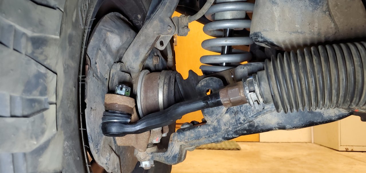

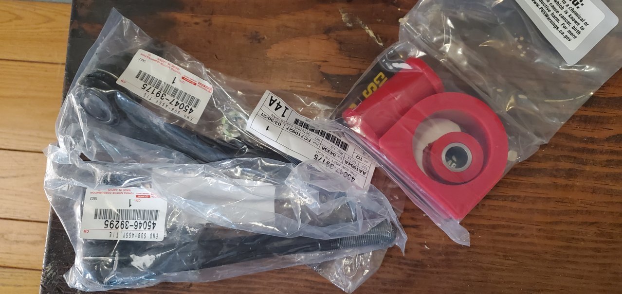

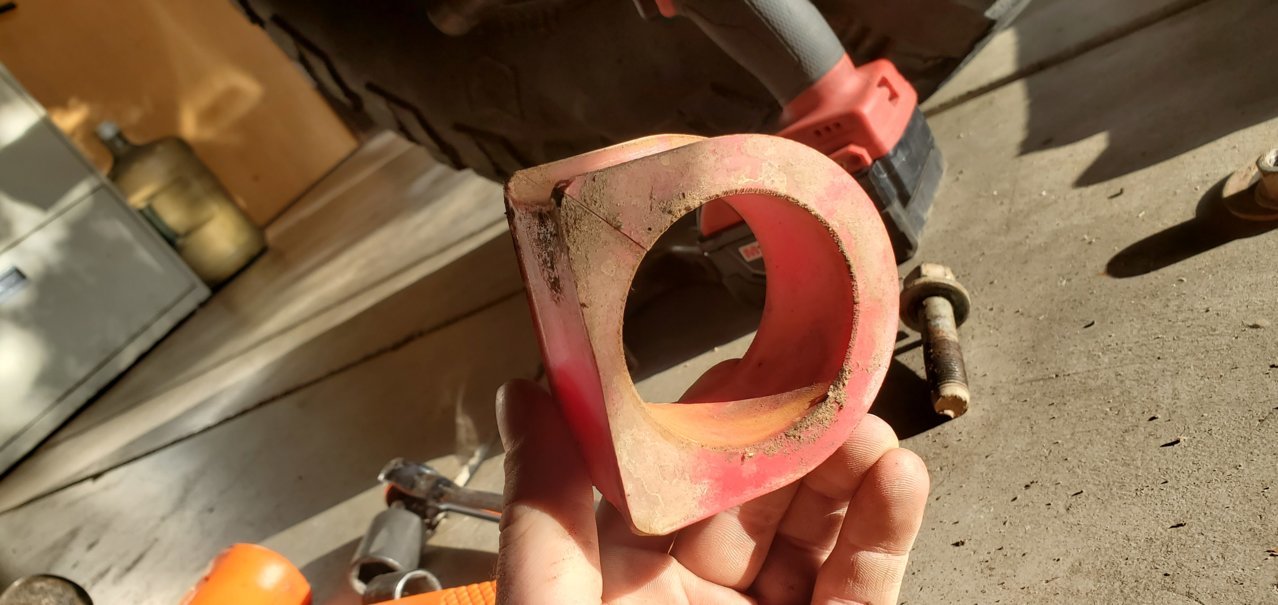

    So I decided to give my steering rack a revamp since it has been making weird creaking noises and had a bit of wander to it.
    Got some OTR's & rack bushings for it.
    Although upon taking it out, turns out the bushings were fine and that the big D-ring clamp was just loose :anonymous:
    I guess i'll use those bushings at some point. Kind of glad I didn't have to change them out though because it's a real pita to move that bitch around.
    I did replace my OTR's with new OEM ones though. Now I have some trail spares which is always good.
