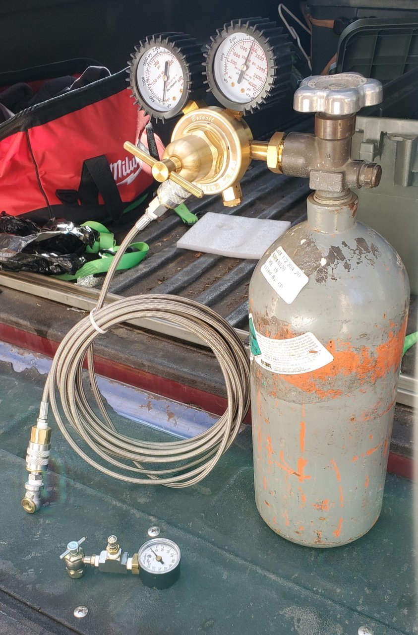

    Need to charge these with nitrogen.
    Gonna start looking into getting a nitrogen cannister setup

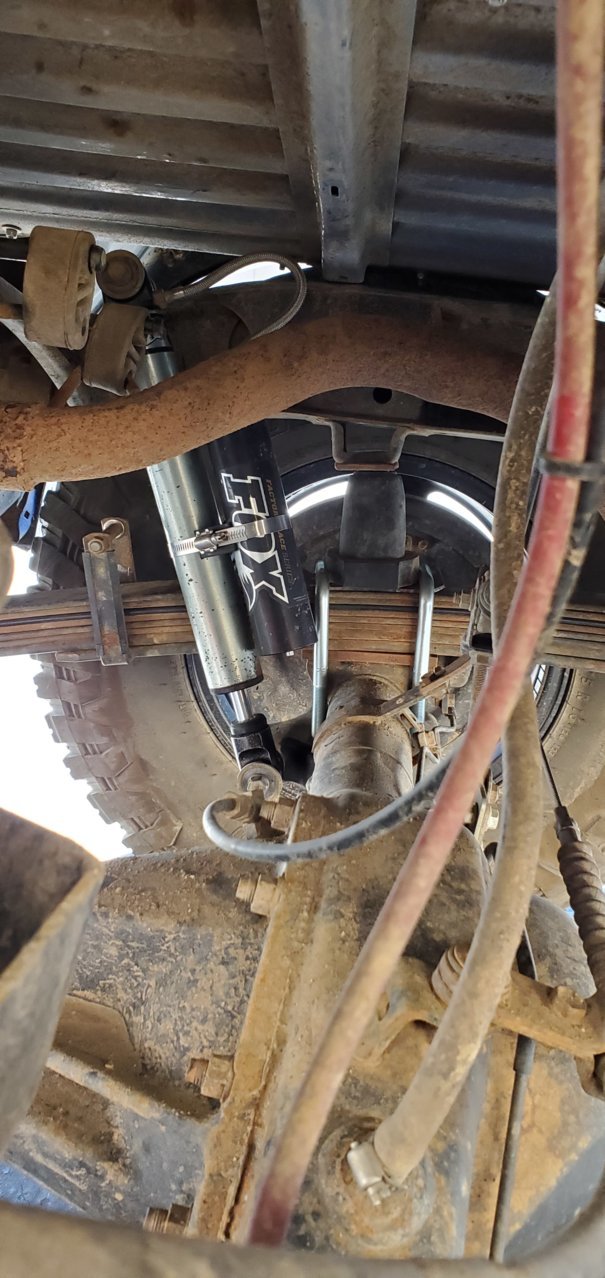

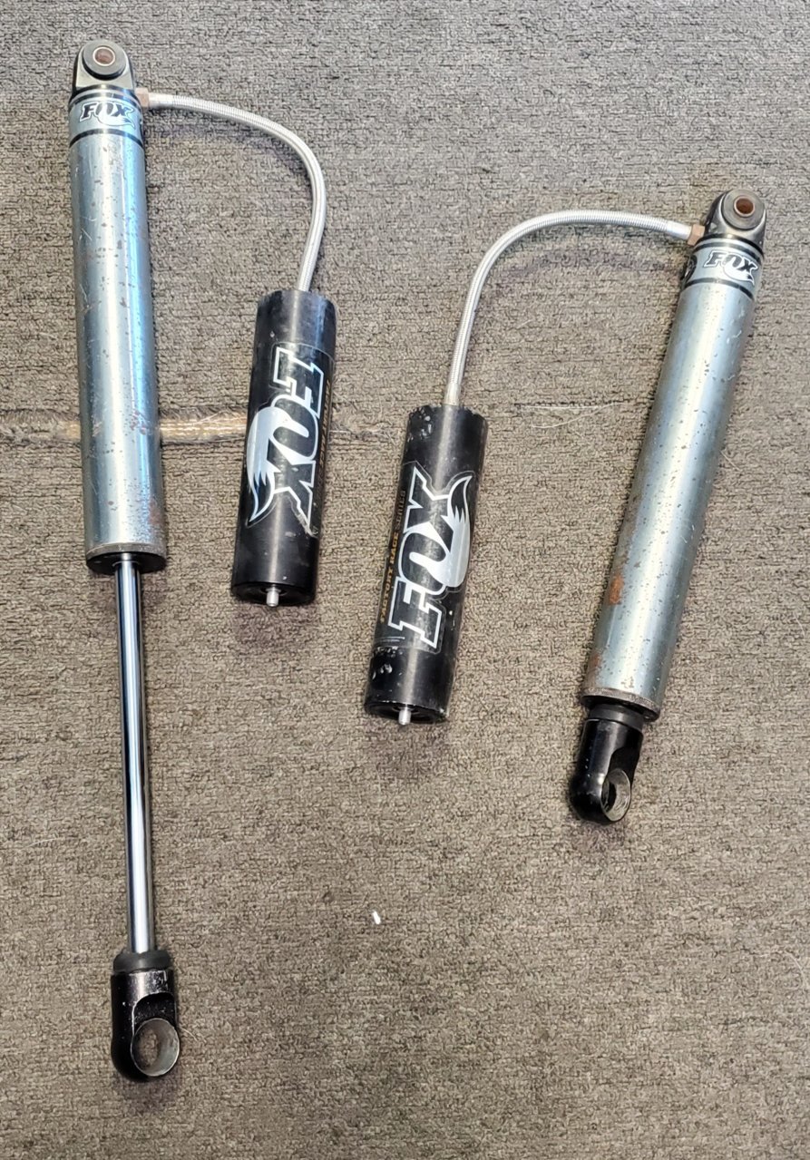

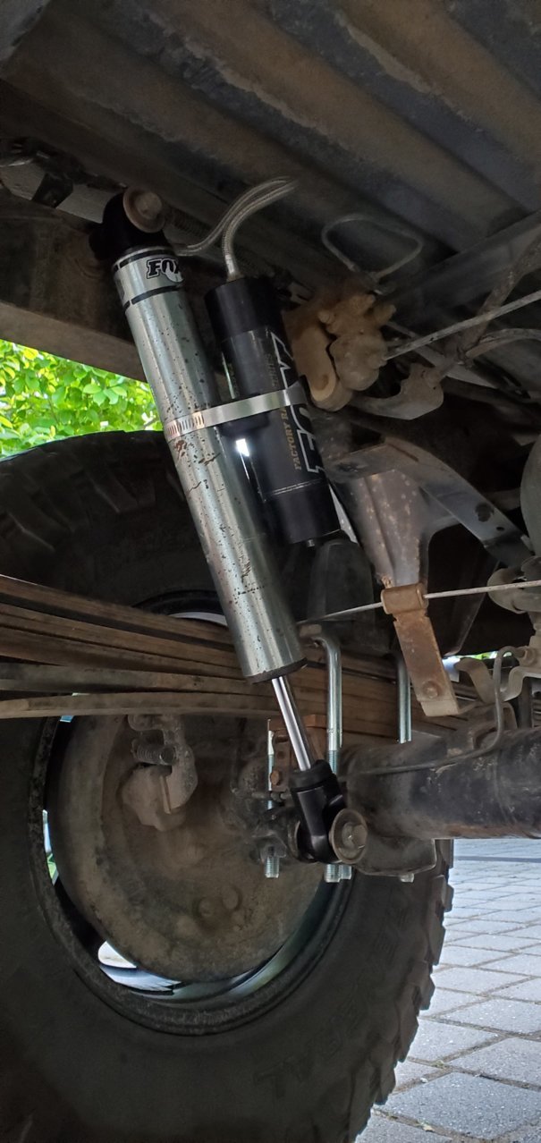

    So got some parts to make the rear 2.0's work.

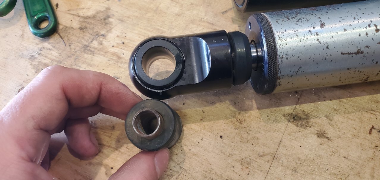

    To start, the bushing eyelets were too small ID for the stock rear shock mounting points. So I got some 3/4" ID fox hourglass bushings so make them work. When pressed into the shock eyelets they get smaller than 3/4" thought which made them a really tight fit on the shock mount pins. Had to persuade them on there with some lubrication and a rubber mallet. Hope I don't have to take them off anytime soon cause that's gonna be a pita lol.
    Also put together a nitrogen setup to charge them up. Also made a no-loss nitrogen fill adapter with some stuff I had at work.
    I set both shocks to 180 psi.
    Maybe down the line I will start messing with the valving now that I have the means to recharge my suspension with nitrogen
    They resis fit in the stock location thankfully. Cycled the suspension to make sure nothing hits them during the entire stroke.

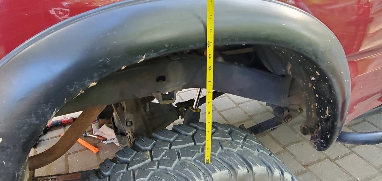

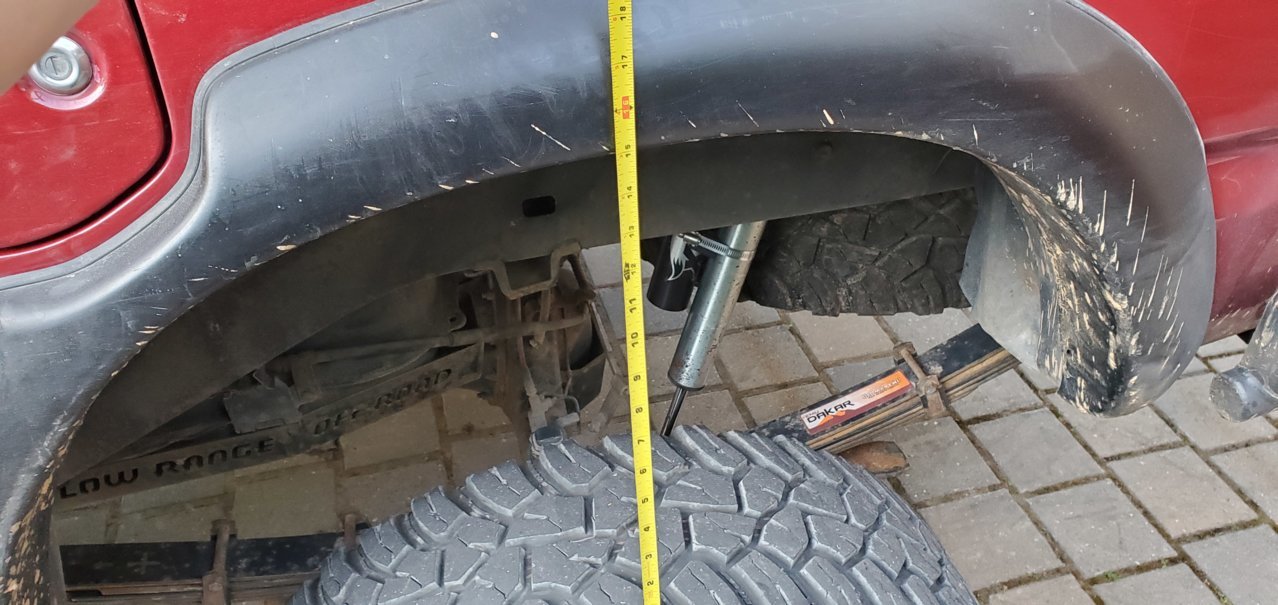

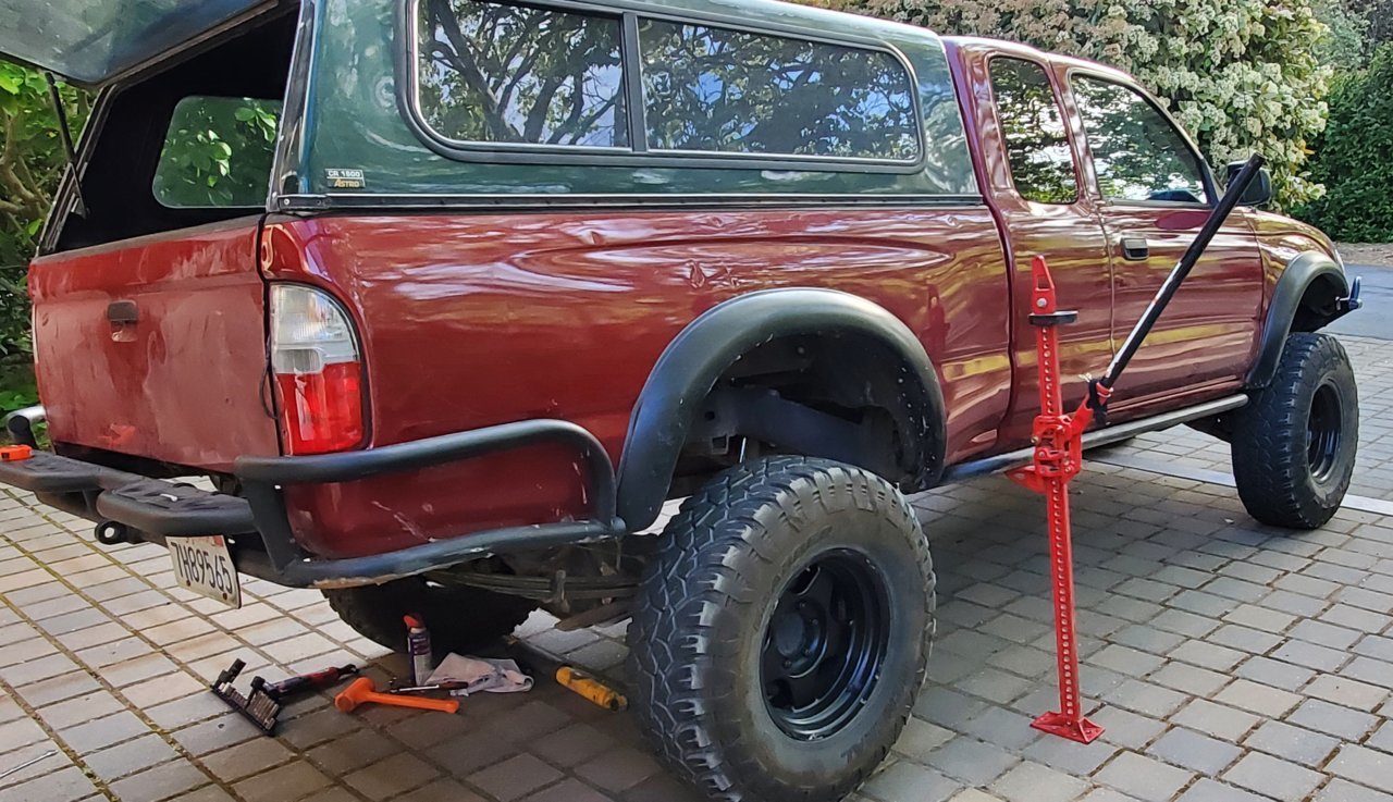

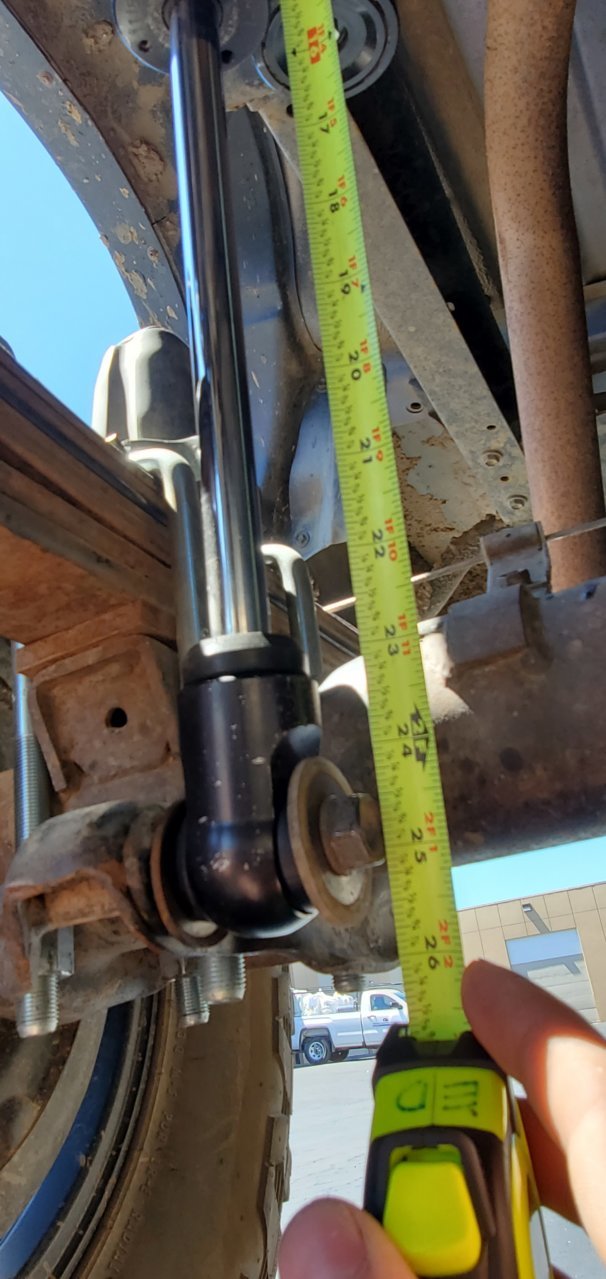

    Flexed out each side with the fox on one side and the OME on the other to compare travel numbers
    The side with the fox had about 3" more droop from the top of the tire to the bottom of the fender.
    OME side:
    This is with the rear tire off the ground
    Fox side:
    15" with the tire barely off the ground
    Tomorrow I'm going to see if I can get any more out of it because I was only able to flex it out in the driveway to where the bumpstop was about 1.5" away from the strike pad. Then I can also see how close the shocks get to bottoming out when on the bumpstops. The driver side is pretty close from what I can tell. About a 1/2" difference, but we'll see.
    Either way, I'm stoked with the increase in travel. The road feel so far is pretty good too. Not sure the valving in there, but the PO said that they worked great on his 4runner so probably not far off. Pretty supply at the beginning of the stroke and dampens well.

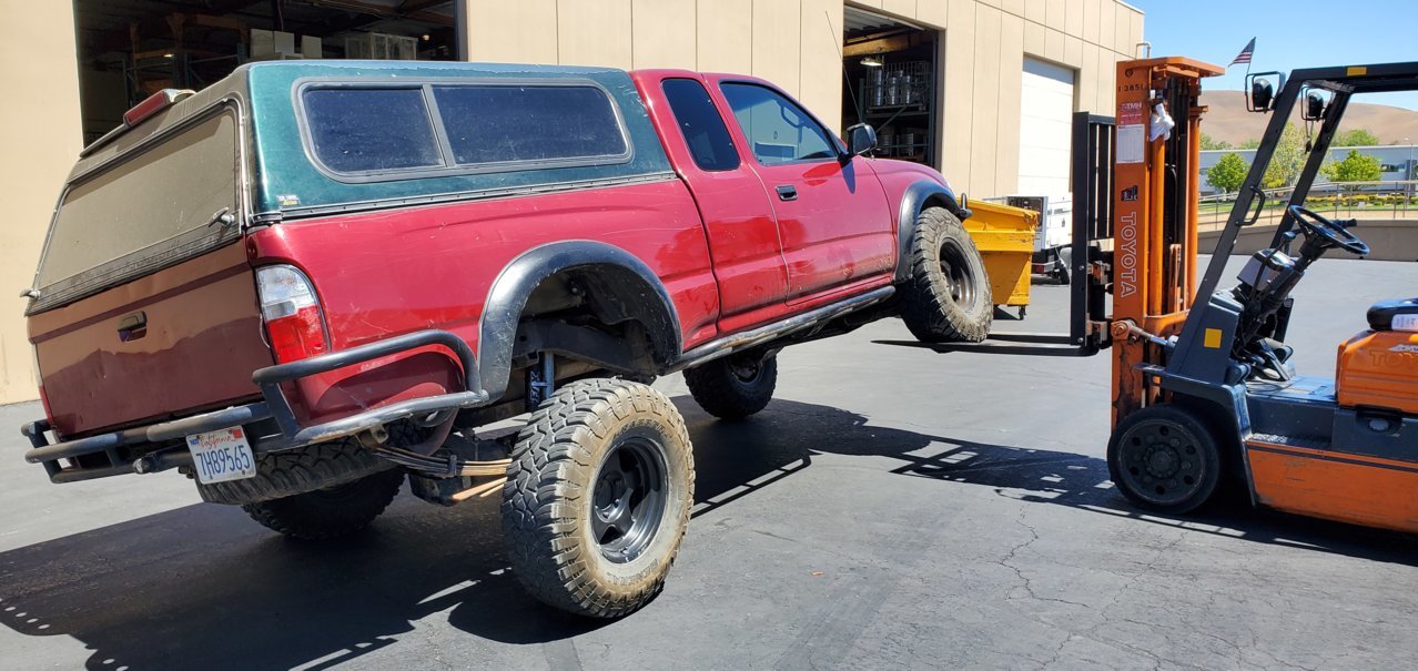

    Flexed it out with the forklift and was able to get a couple more inches out of it.

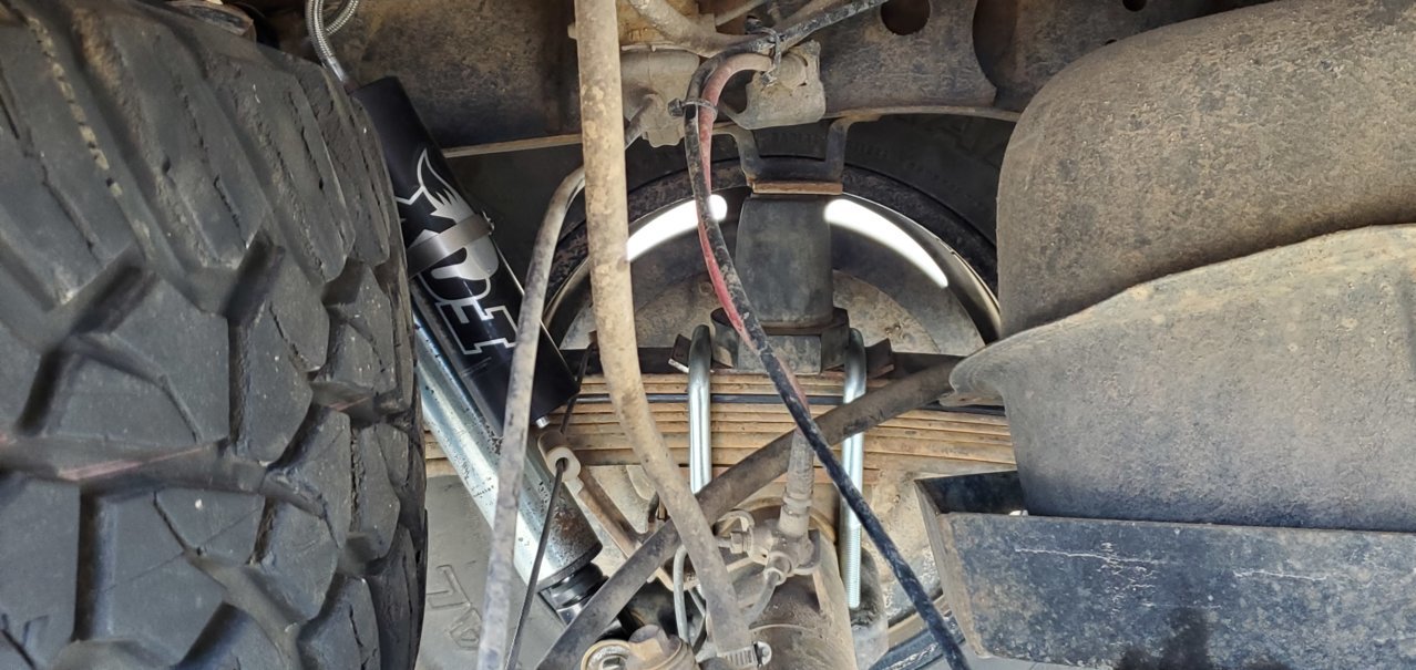

    You can really see how the driver side and passenger side mounts are uneven lengths by how much closer the driver side is to the shaft bump than the passenger side. Also the difference in angles at which they are put at in relation to the axle.
    The passenger side is close to using all 26in of the extended length. At about 25in. Although doesn't collapse as much as the driver side under full stuff.
    Passenger side stuff:
    Driver side stuff:
    Also removed the front most leaf bracket bolt thing on the passenger side as it was limiting leaf separation at full flex there.

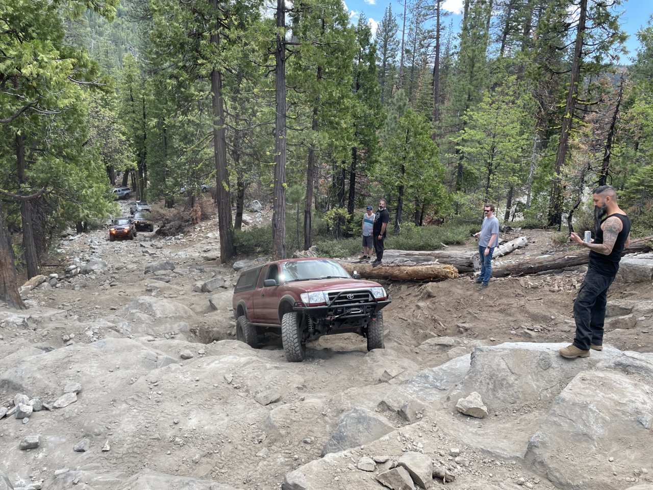

    Had fun fucking around on Fordyce yesterday with some good company.
