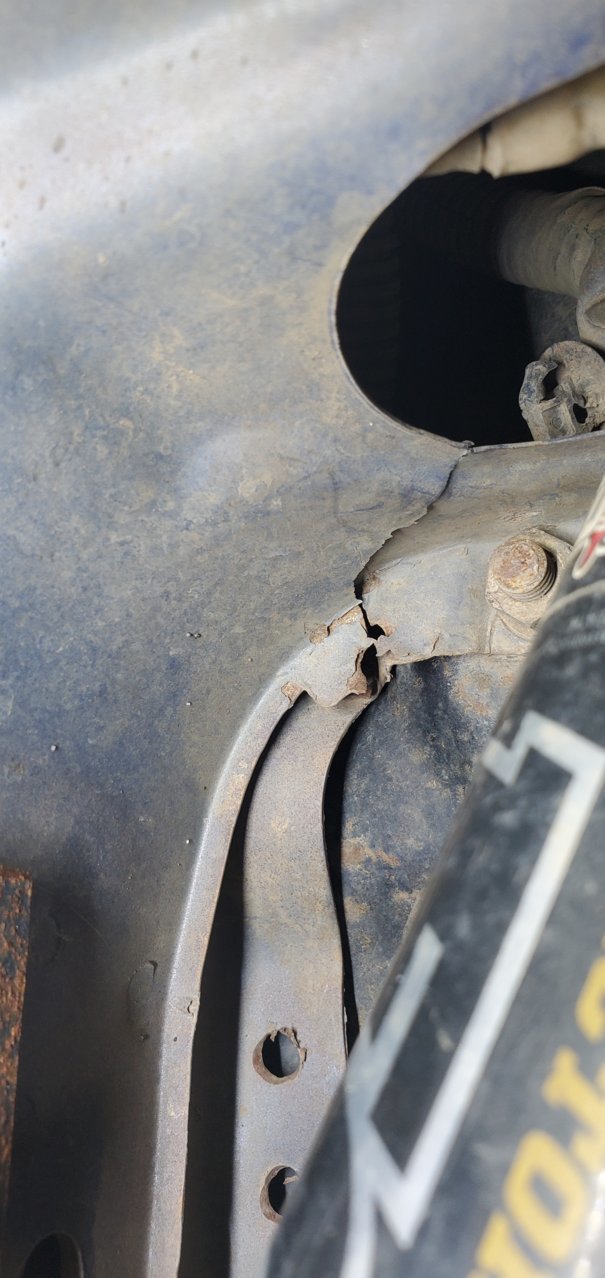

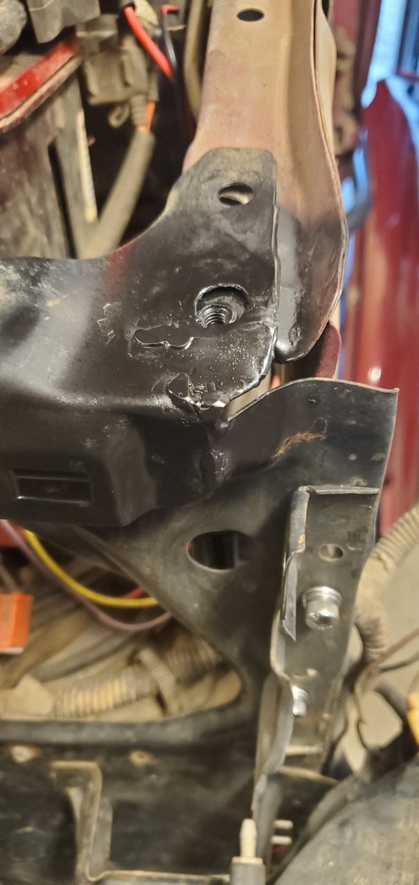

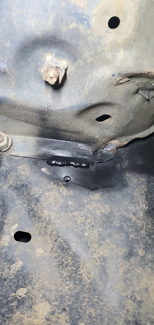

    Trying to track down a new clicking sound in that happens whenever I go over bumps in the road. Thought that it might be the core support like before when the body mount area was failing.
    Found some cracks on either side by the fenders that I welded up and painted.

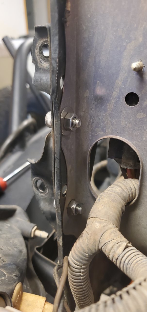

    Also bolted and welded up some other parts of the fender apron to the sides of the core support to help make things more rigid.

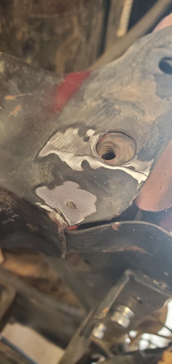

    Found a sizable crack here. Welded a section that should prevent it from getting any worse. Didn't bother to weld up the crack.
    Although after all that the noise is still there :frusty:

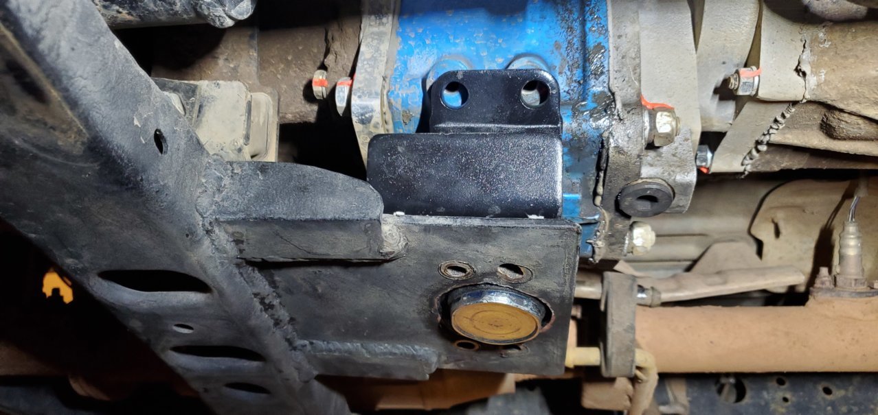

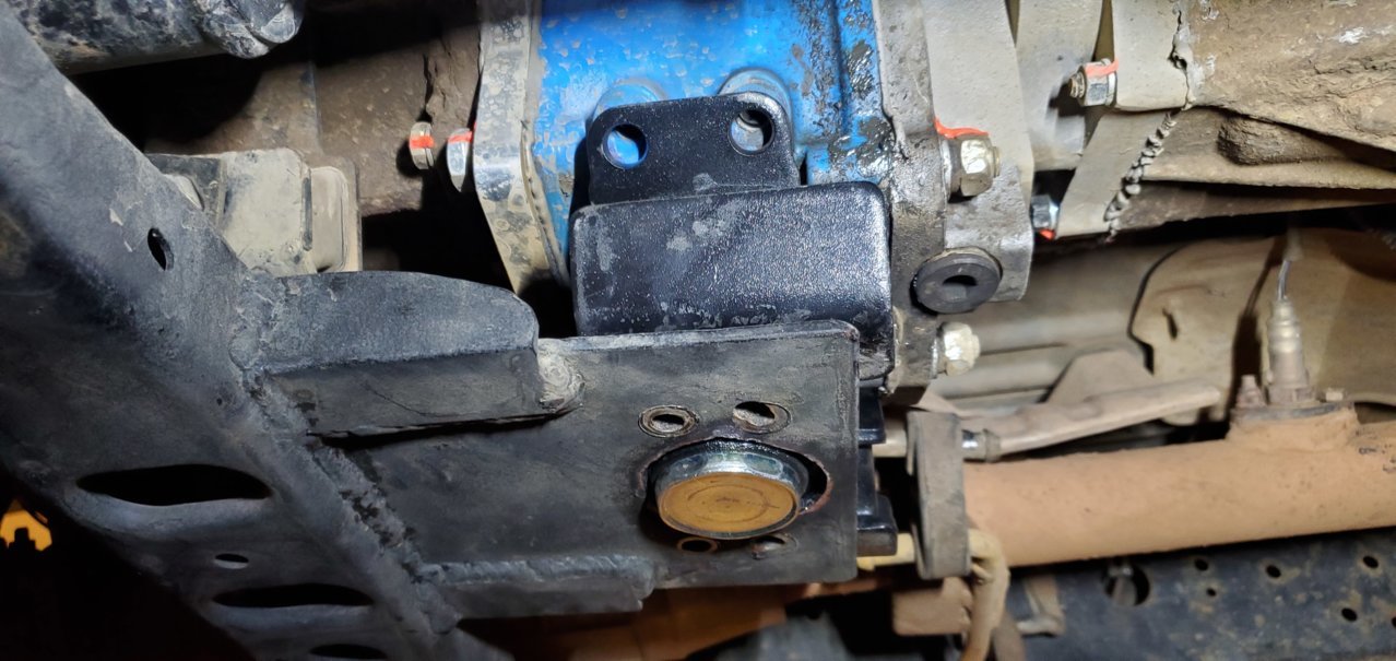

    Also got a rubber crawlbox mount to install, but found out after plasma cutting a hole in it that there is a front and back to the hole pattern on the bottom of the mounts.....
    So looks like I'll have to cut it off and redo it so that the holes all line up.
    How the holes are positioned now has the mount facing backwards.
    How it's supposed to be:

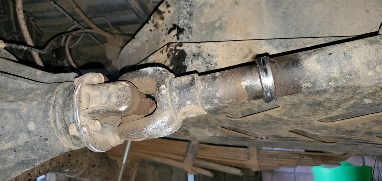

    Only damage was getting hung up in one spot on my rear diff axle tube where basically both rear wheels were off the ground. Winched out of that spot, but at the cost the grease zerk on my rear driveshaft.
    It was only a matter of time before that thing was shredded off again....

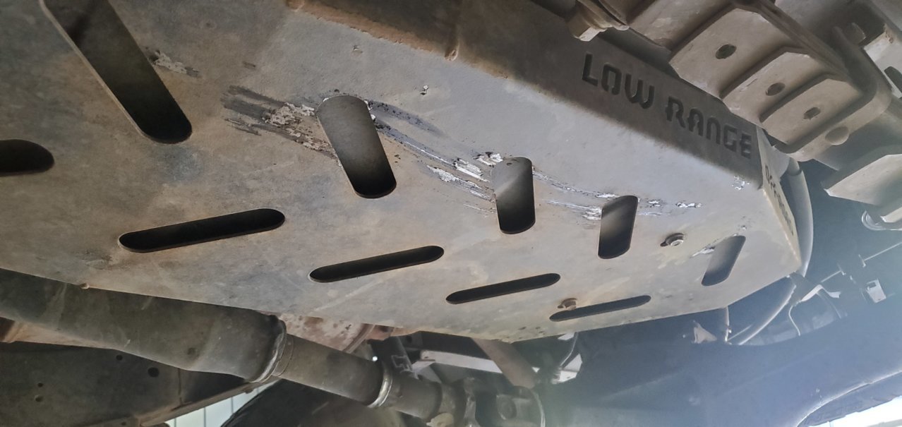

    Oh and actually tagged my gas tank skid for once. About time that thing got some use

    I just bough that grease fitting since I sheared mine off almost 3 years ago, so here you go.
    96451-00600

    Right on, thanks. Probably won't be a while until I get around to fixing it. When I had my driveline rebuilt for the CB, The guy said that he had a hell of a time getting the old one out

    I hear that. I need to replace mine here pretty soon. Hopefully PB Blaster and a bearing puller is enough.

    Bearing puller? You're gonna need an EZ out for that tiny fucker

    I meant for the carrier bearing, but yeah, an easy out in the way for the new grease fitting.
