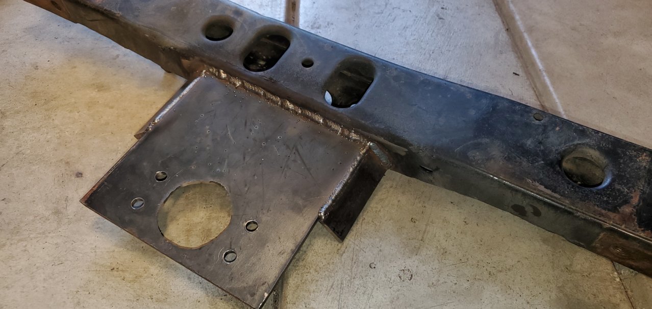

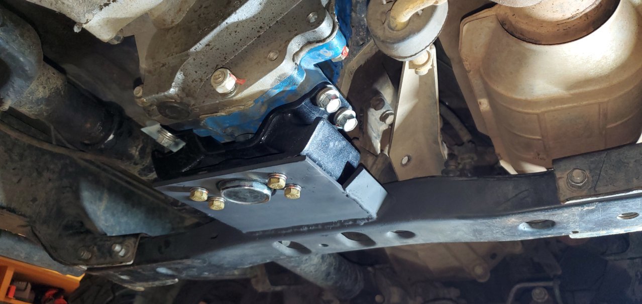

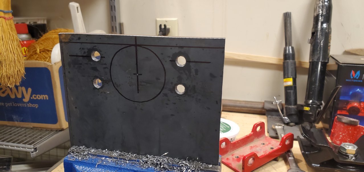

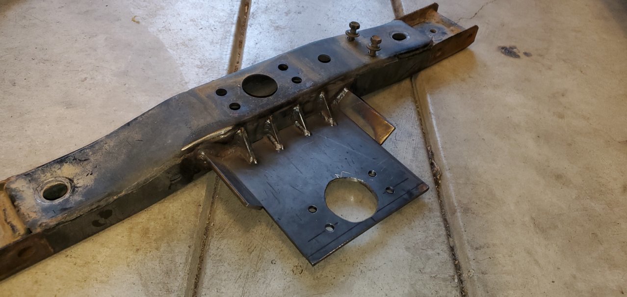

    Chopped off the old crawlbox mount from the crossmember. Used the plasma then had to grind the rest. That part sucked.
    It was also tricky trying to get the hole pattern right on the metal.
    Beefed this one up a little different this time around.
    A lot better than the HD mount I had on before, but still some noticeable vibrations at idle interestingly enough. I would have thought that with the second one being rubber that the feeling would be more or less like having just the one stock mount.
    Hopefully it keeps the drivetrain more planted on uneven section of highway when it would kind of jump around before.

    Looks good. Much better than the old TG mount you had before. :thumbsup:

    The red one I had before was a Marlin HD one but the vibes were rough. I had a TG one for a hot sec but it contacted the gear housing so I returned it.

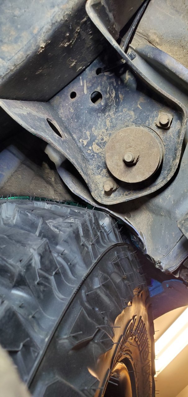

    On the other hand, clearancing the wheel wells has proven to be a royal PITA so far. Did the passenger side tonight and I had to do everything short of tubbing basically.
    Cams maxed out. 36in 10lb sledge hammer, die grinder, and the angle grinder all got a workout.
    Now I need to seam seal it up real good.
    Kinda crazy how close it is to the body mount at full stuff.
    Tires measured out to be 33.5in dia.
