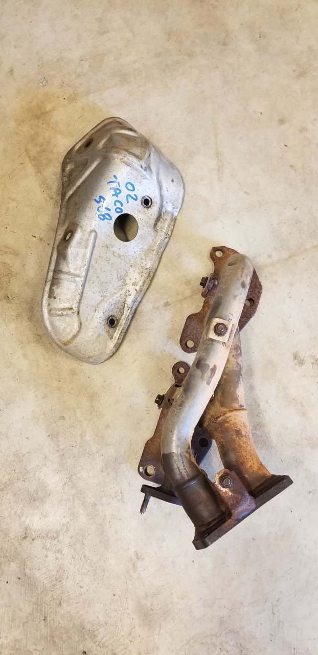

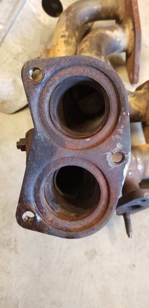

    So I picked up a "mini-header" to replace my leaky, most-likely cracked, cast exhaust manifold.
    I got it from a really sketchy Salvage Auto re-seller in Berkley for a decent price (a hell of a lot better than the quoted $300 from the dealership new).
    I am planning on blasting it and putting a ceramic coat on both the heat shield and headers.

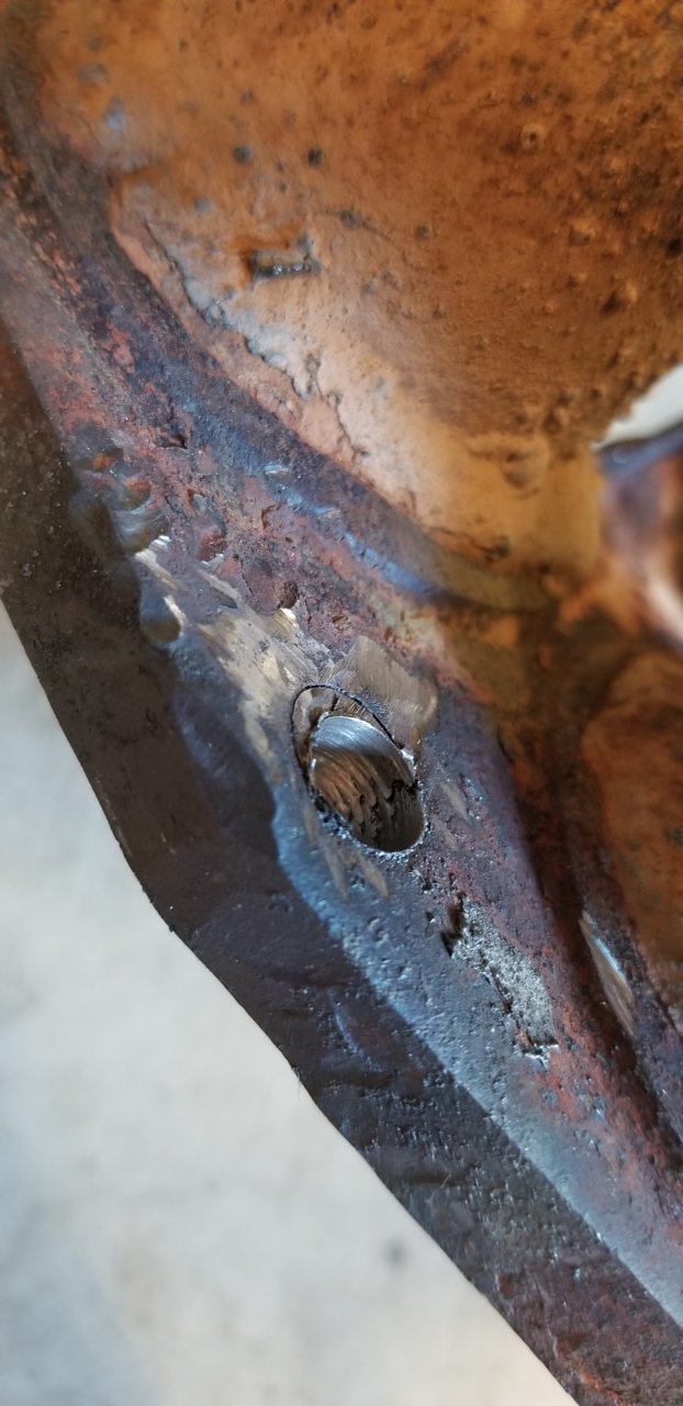

    Although I just discovered that one of holes for the studs on the collector side had been drilled out off center. Most likely because someone broke the stud off and couldn't get it out.
    So now in order to get it to bolt up to my down-tube before the catalytic convertor, I will most likely have to drill out the corresponding bolt hole to a much larger size to get it to line up and bolt together.
    Or maybe try and drill it out as close to the original position as possible and then weld a nut on the back side to thread into?
    Does anyone else have any ideas on an alternative approach or solution that may be better? I was hoping it was gonna be a nice and easy bolt up after I got it pained, but now its a bit more involved...:facepalm:

    Why not just use a nut and a bolt? Not like any of them are terribly hard to get to

    I might try that as well. That didn't work out so well on my stock manifold though since the back side of the flange on the manifold side is contoured rather than a flat surface.

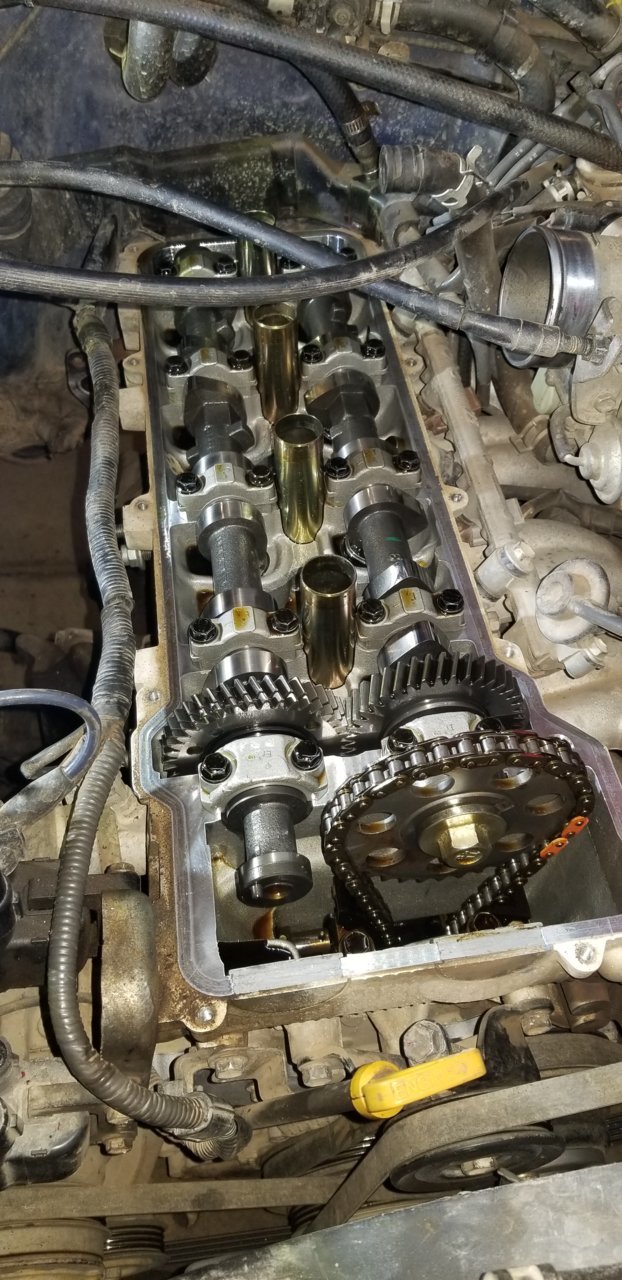

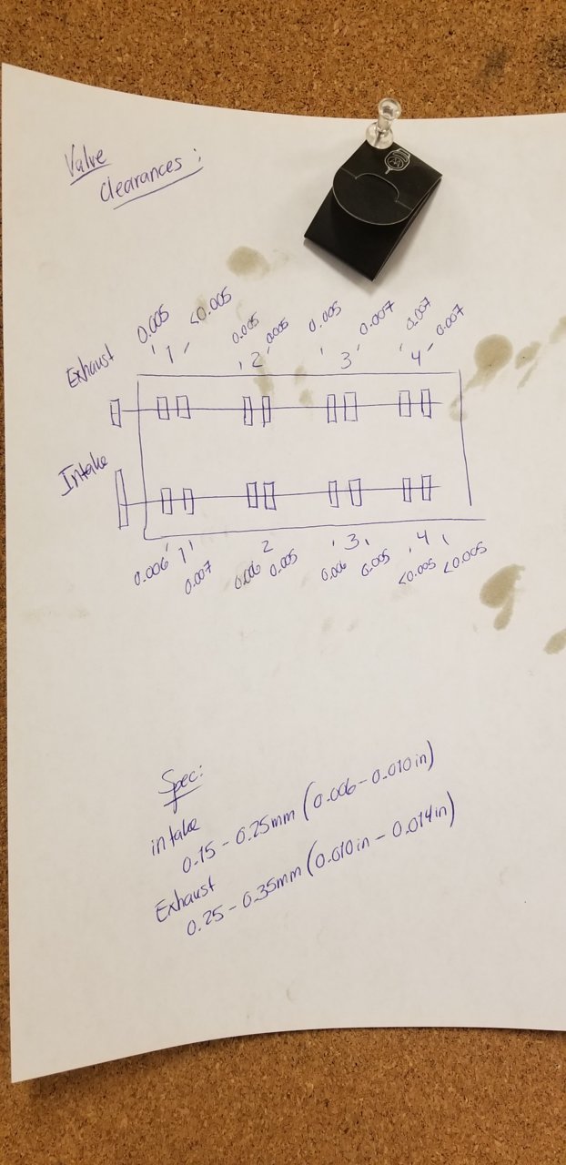

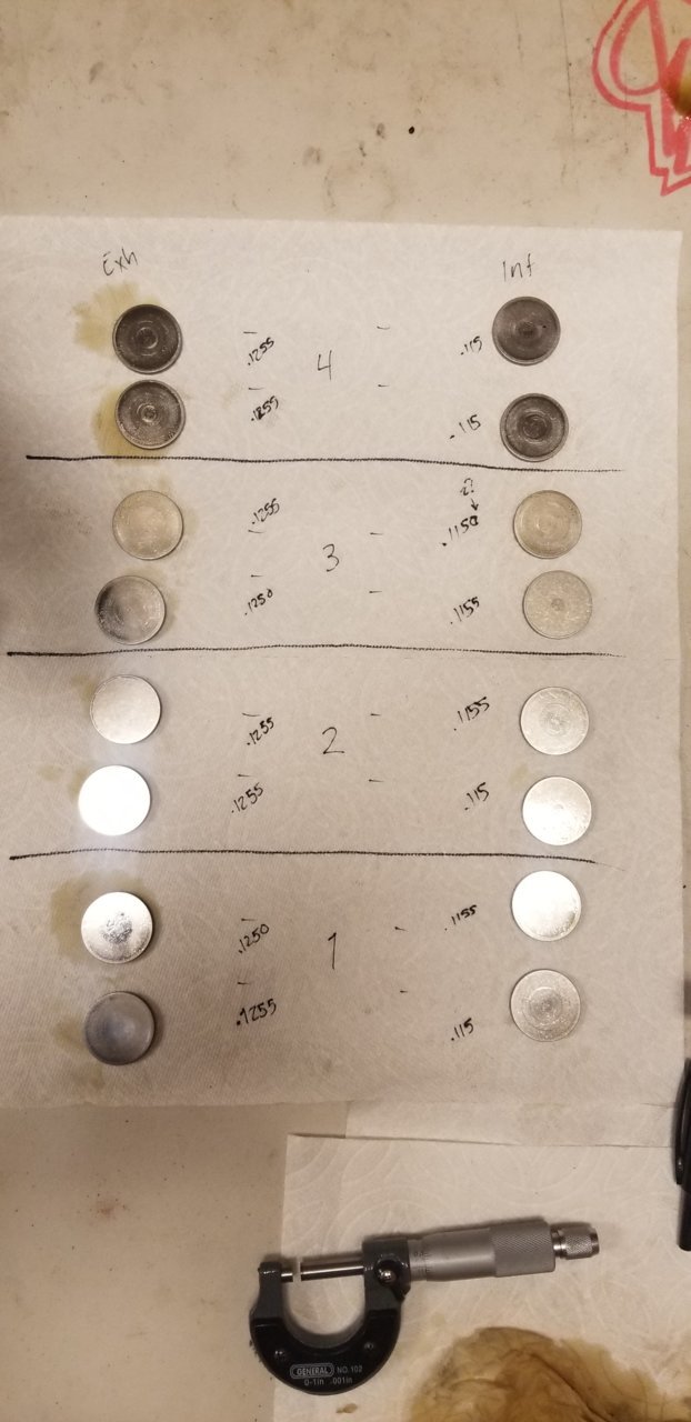

    Popped off my valve cover and checked the clearances of all my valves (after rotating to TDC and appropriate timing positions).
    The good news is that everything is really clean from regular oil changes, although my valve clearances aren't looking good....
    I measured with a feeler gauge and found a majority of my valves to be tighter than the FSM specs. (the intake side is pretty bad, see my pictures)
    Fortunately I have a commuter for the time being so that I can garage my truck and work on getting this resolved and finishing the exhaust.
    Since so many of them are out of spec, I think I will just be pulling the camshafts for easier access to the shims.
    I thought that the valves of these engines wore loose rather than tight. In hindsight, I really should have checked the clearances when I installed the replacement cylinder head.

    I'm in the process of swapping in a mini header too - also with a stripped out stud. I'm planning on a helicoil.
    I am going with the Eastwood header coating. I priced ceramic coatings and was a little shocked!

    You'll notice a difference in the power and responsiveness in your motor with those valve adjustments. It's essentially restoring lost HP.
    betterbuckleup[OP] likes this.

    Right on! I thought about a helicoil, but I decided against it since it is on the exhaust and was afraid that it might pull out or lose it's hold with the constant heat cycling. I got an attachment for my dremel to bore out the hole on the mating flange so that I can get the holes to line up.

    Earlier this week I also finished doing my valve clearances. The intake was for the most part still in spec, but the exhaust valves were out of tolerance by around 0.005 so I ended up changing pretty much all of them. Costed about $110 or so in shims from the dealership.
    I also fixed the split gear on the timing gear of the exhaust camshaft since the spring was not being engaged. I never used the service bolt hole when I initially replaced the head, hence the "mini-diesel" sound that a lot of people report for this exact reason. My valvetrain is a lot more quiet now.
