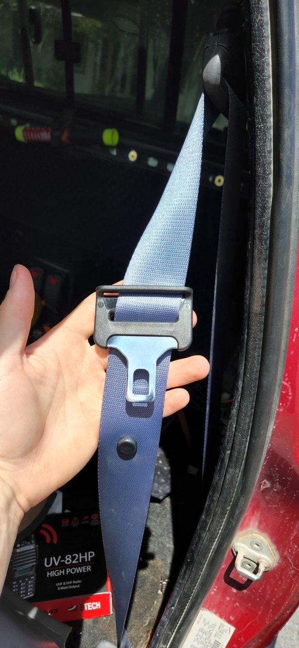

    Sent my existing retractors and seatbelt assemblies into seatbeltplanet.com for the driver side to be re-webbed and for new buckles and receptacles to be installed.
    This was all so that I can get a different style of seat belt receptacle to mount to my seats. These are mounted with a cable to the eyelet, so that they are flexible. The OEM ones that I modified to work were jammed up against the center console to the point where I couldn't slide my seat forward and back very easily.
    There is now plenty of room to spare between the receptacle and the console. The driver side belt retracts a lot better now. The existing webbing was super dirty which was inhibiting the retractor functionality.

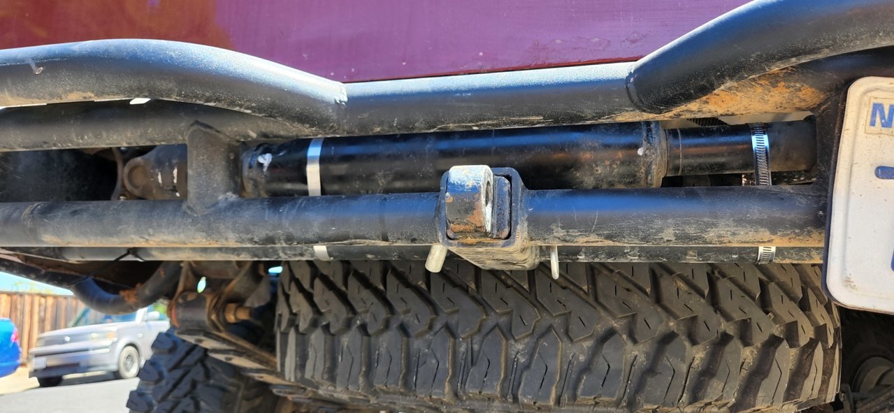

    Mounted my spare rear driveshaft section in a cudi spot on my rear bumper in preparation for the Rubicon

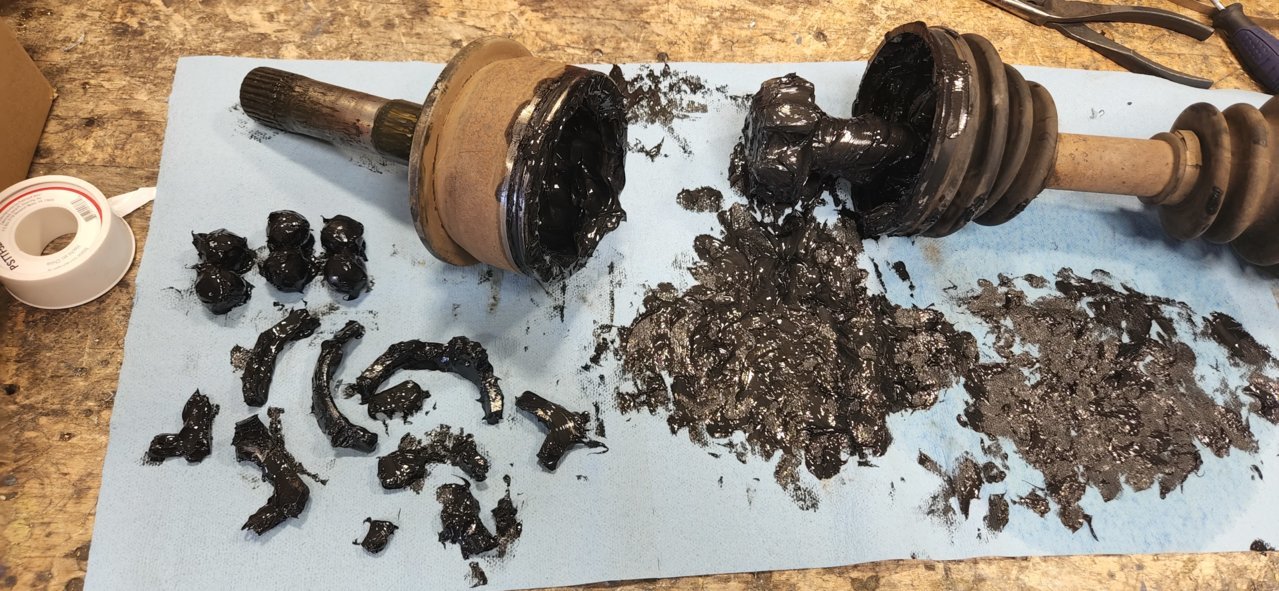

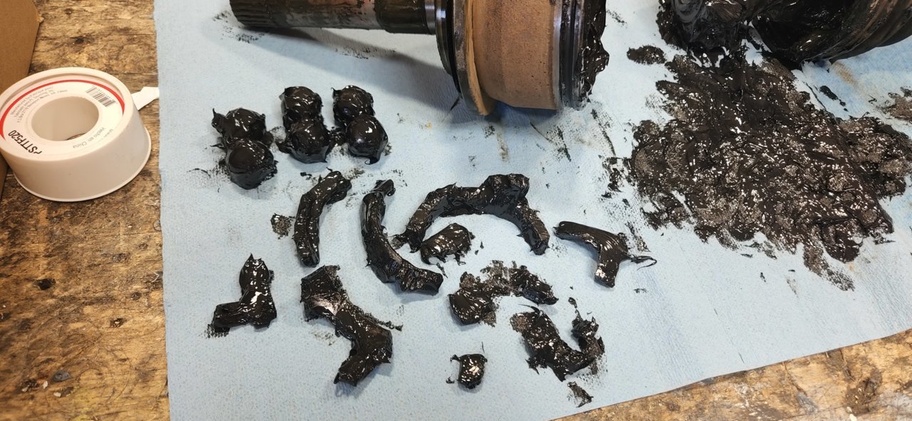

    CV carnage. Blew up the cage in the outer joint. Surprised it lasted as long as it did being a parts store axle.
