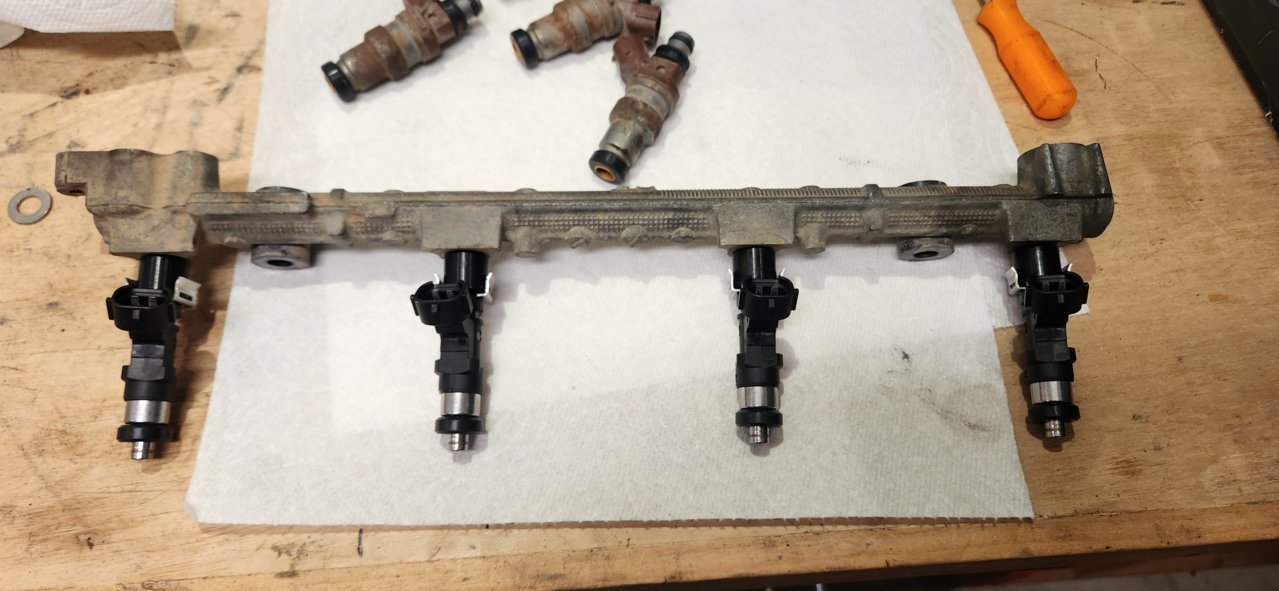

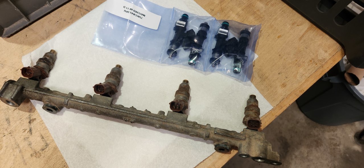

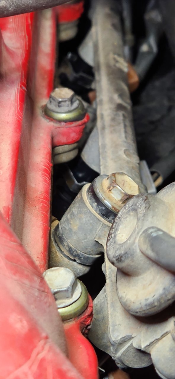

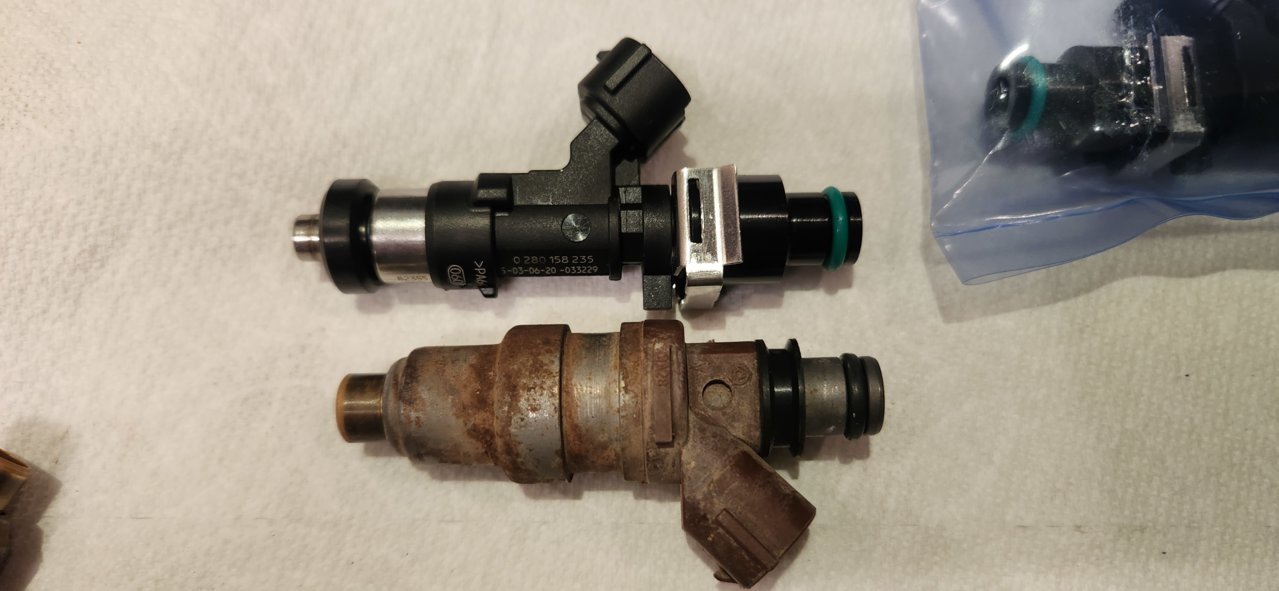

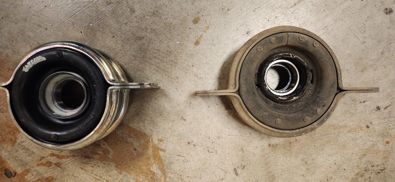

    Friday afternoon I did some prep work for my tuning session at noon. Installed a new carrier bearing, installed the intake I built, swapped to the 58mm pulley, and installed the 750cc injectors.
    The carrier bearing wasn't as bad as I thought when I took it out, but I didn't want it flopping around when I was trying to put down some power.
    Everything went smoothly other than the injectors being slightly taller than the OEM ones. I had to use a washer to space the rail up a bit so that I could tighten it down. According to Gabe, this is something they've run into on some 3rz motors. With no explanation as to why it's like this on some trucks and not others.
    The injectors are on the noisier side and noticeable at idle.

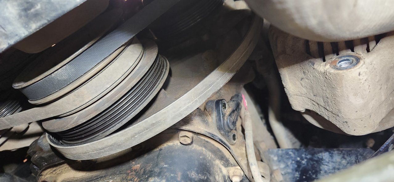

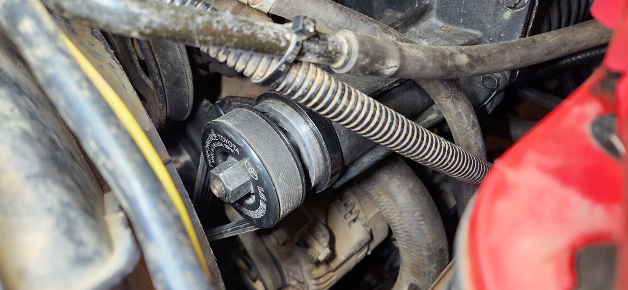

    Swapped to the high boost pulley

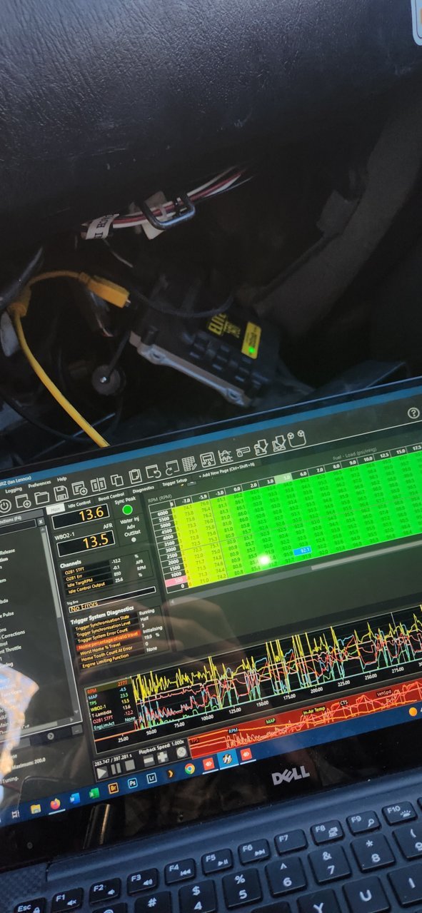

    First day of tuning went fine. Ran into a signal problem with the crank position sensor triggering. Took it down to 0.3V on the signal output and it was still dropping out and missing teeth. So I called around and found a Denso replacement crank position sensor locally to swap in. When I pulled the old one out, I found out why we were having signal problems.
    Being it's a magnetic sensor, some ferrous debris had landed on the sensor which was no doubt muffling the signal. The old one is likely still good so i'll keep it as a spare, but I put in the new one since I was already in there. Have to swing the alt out of the way and remove the mounting bracket to get to it.
    After that we were able to make some more progress today and get the drivability better. It took all day, but finally got it to a good point other than a few things.

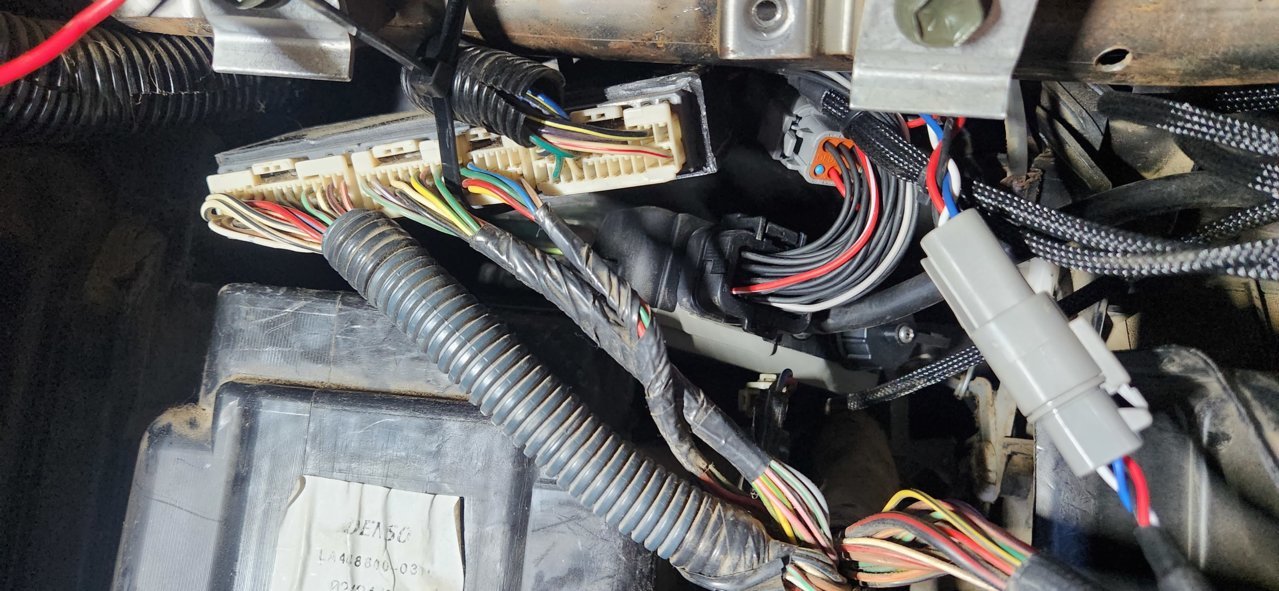

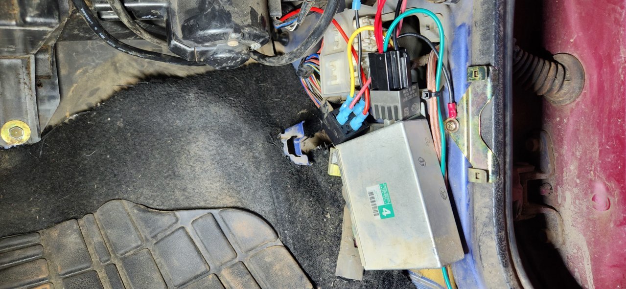

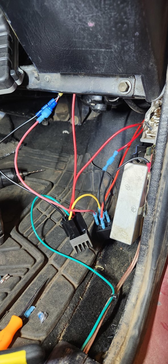

    Wired in an additional relay for the meth pump relay. The ground switching approach wasn't working so I just used it to switch the power supply for the circuit. Now works as it should and I can safely turn the truck off.
    Tidied up the harness behind the glovebox. Was able to fit the computer back there in the original spot.

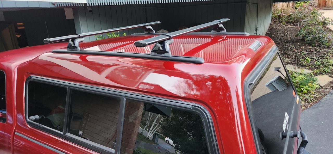

    Also got some crossbars for the topper off Craigslist

    Nice Craigslist come up

    should be good for hauling paddle board and whatever else up there

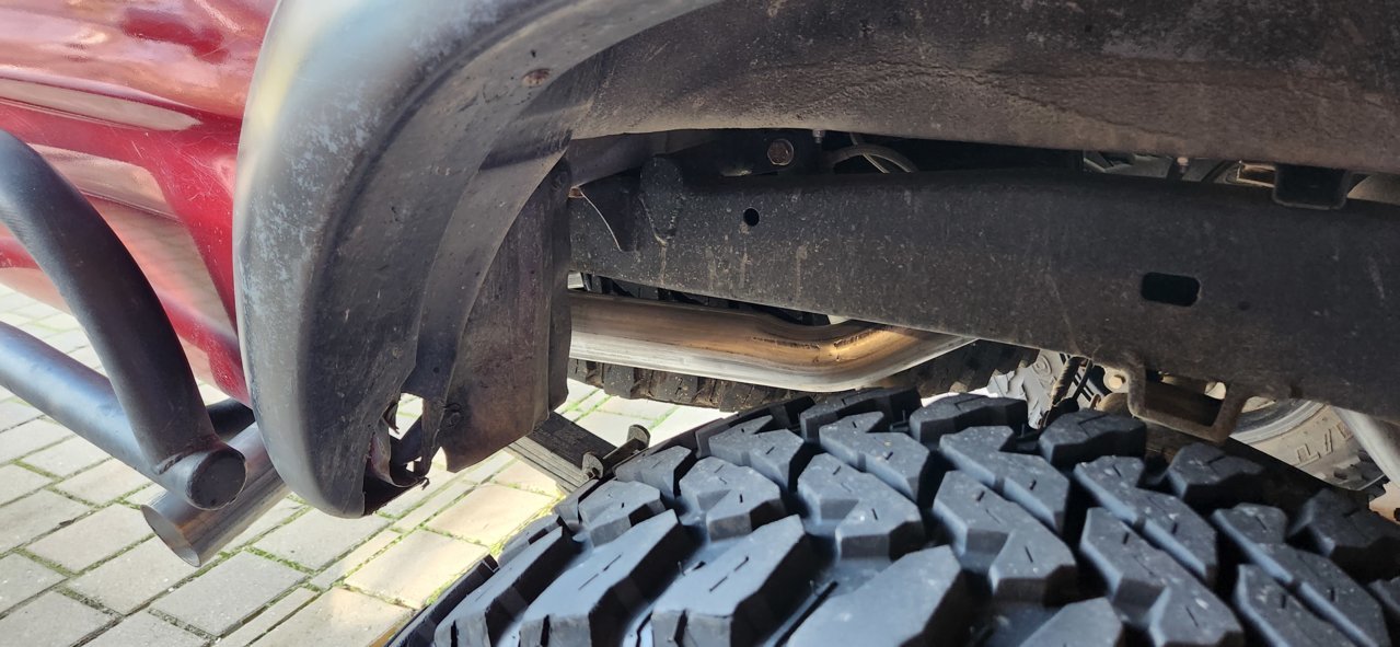

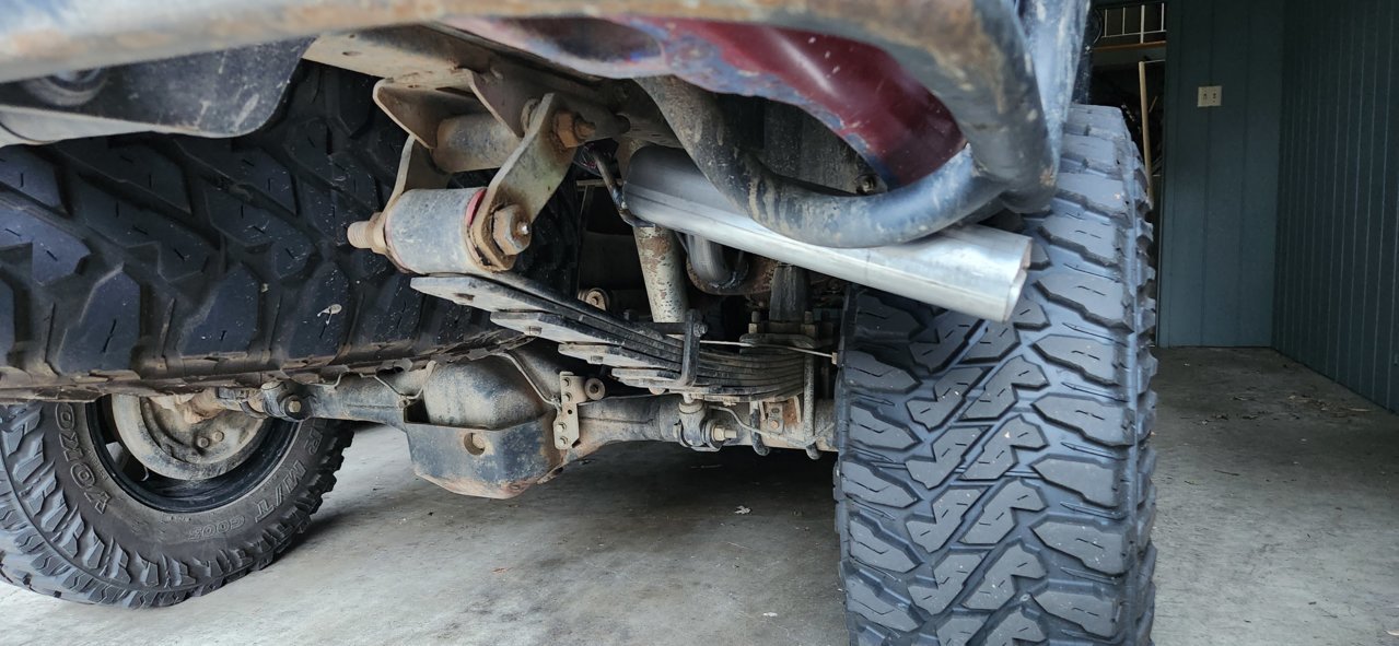

    Had a local exhaust shop route the tubing out the back around my spare and shock. Pretty happy with how it turned out. They did a great job in tucking it out of the way and dodging all the suspension and shit back there.
    Truck sounds a lot better now. Has a distinct exhaust note to it now versus where I had it just dumped before the axle before. All the droning is gone.
    The shop said that the muffler is almost done. Just going to keep running it until it blows a hole.
    Took all the tubing to 2.5in to hopefully let the engine breathe a little better.
    We'll see how long it lasts or if I can manage to crush it on some rocks. It's tucked pretty high up and out of the way though so I have hopes of trying to make it last

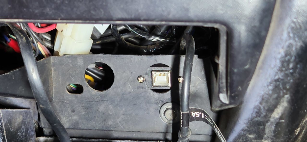

    Installed a USB type b bulkhead extension below my switches and radio so that I can plug into the haltech without having to rip apart my glove box to get to it.

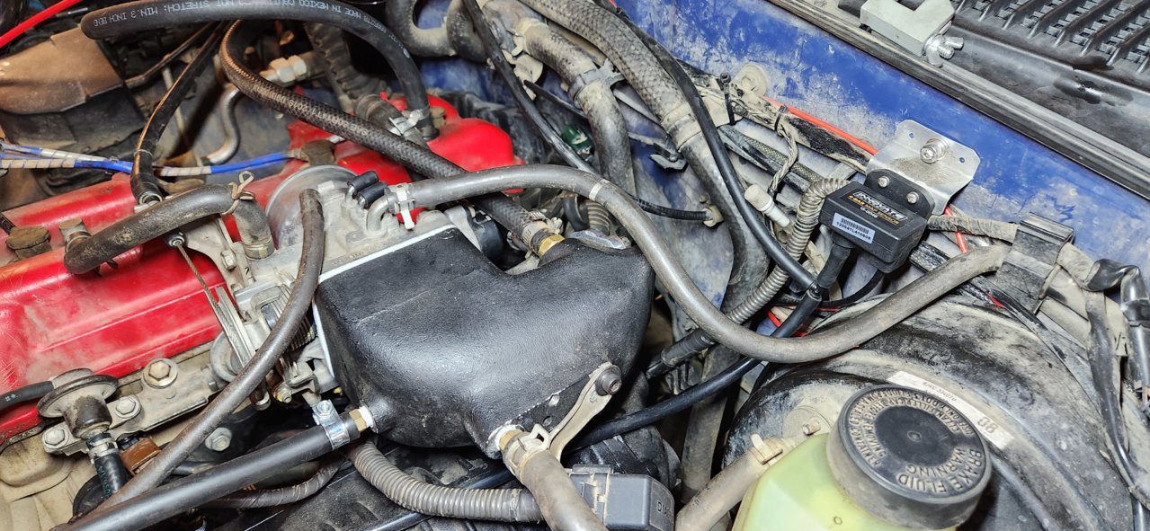

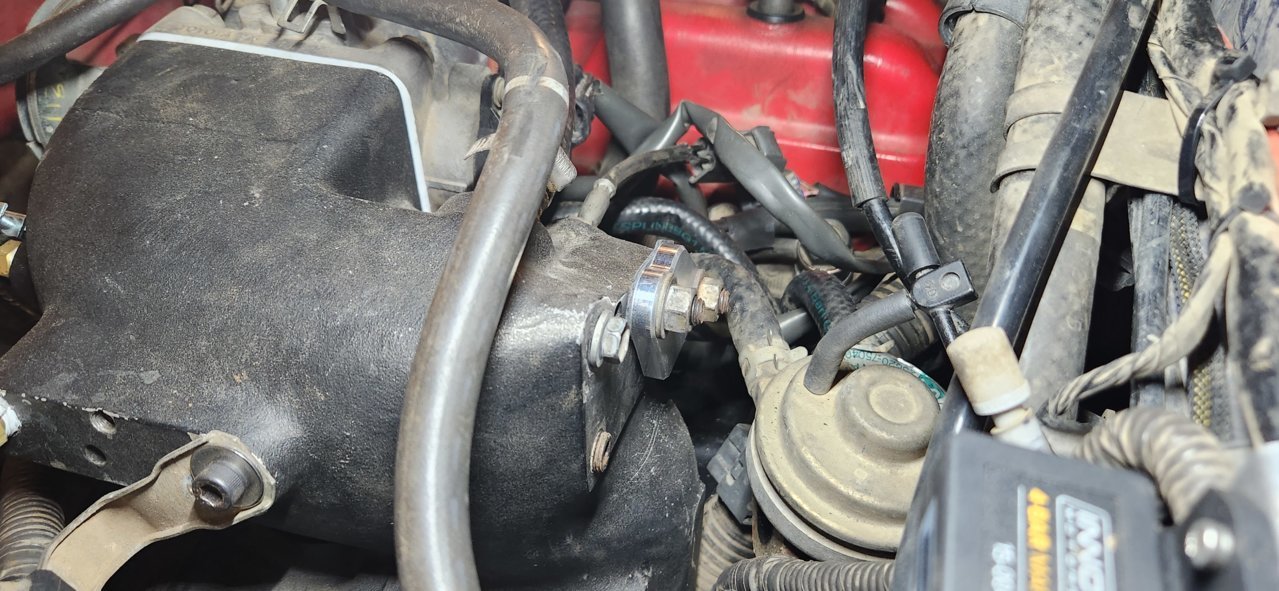

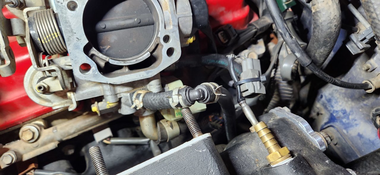

    Installed the LCE performance EGR delete kit
    Went smoothly for the most part, other than re-routing the coolant lines that go through the throttle body.
    One thing that nobody talks about (may only be applicable to SC 4cyl), is that there's no good way to route the coolant hose to the throttle body to where it doesn't kink and block the flow.
    I tried routing it directly, but the OEM hose to the EGR valve makes a hard 90 degree bend that you can't make with a piece of regular 5/16" coolant or fuel hose. So I either route the hose all the way around the backside of the SC, or use a 90 barb fitting.
    I chose the latter.
    @boostedka did you run into this?

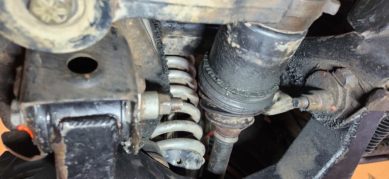

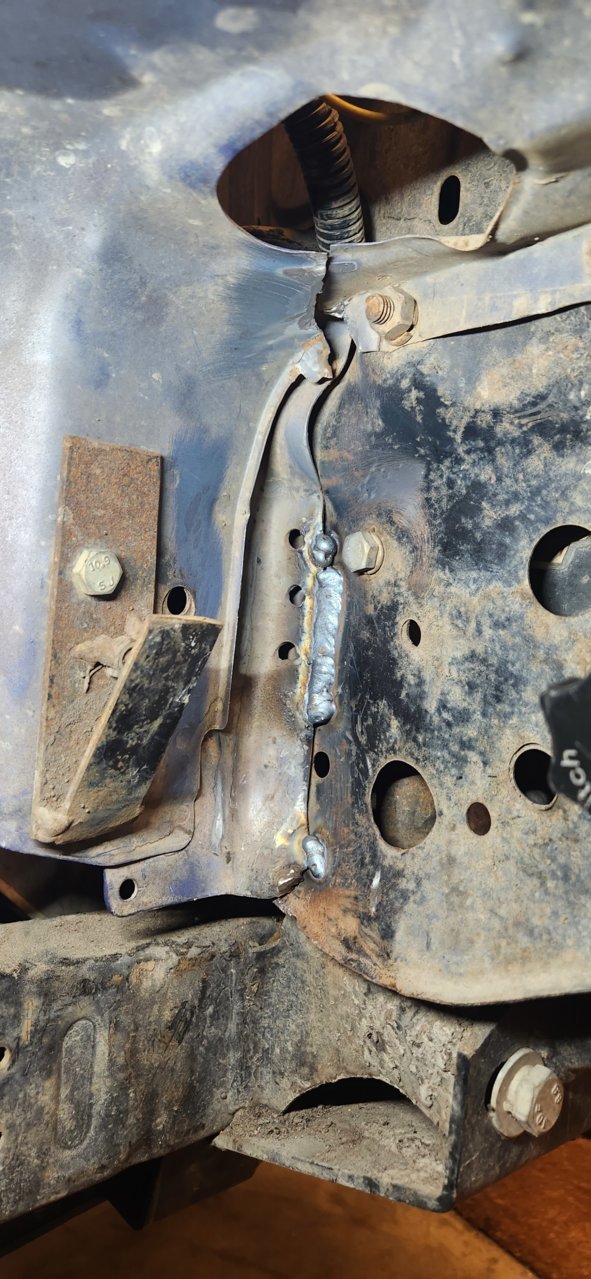

    Also welded up a section of my inner fender apron that has been torn and separated just floating for a number of years now

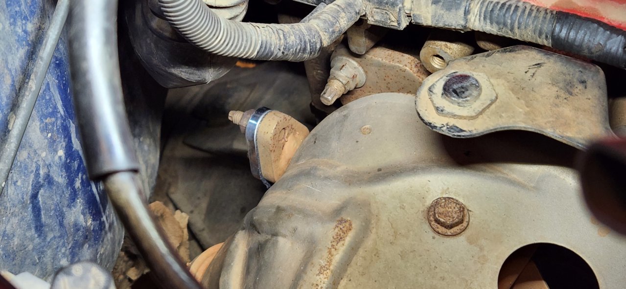

    Also re-clamped the inner most clamp on my passenger RCV axle because it's been slinging grease all over. I hope this is the last shit I have to fix with these axles....
