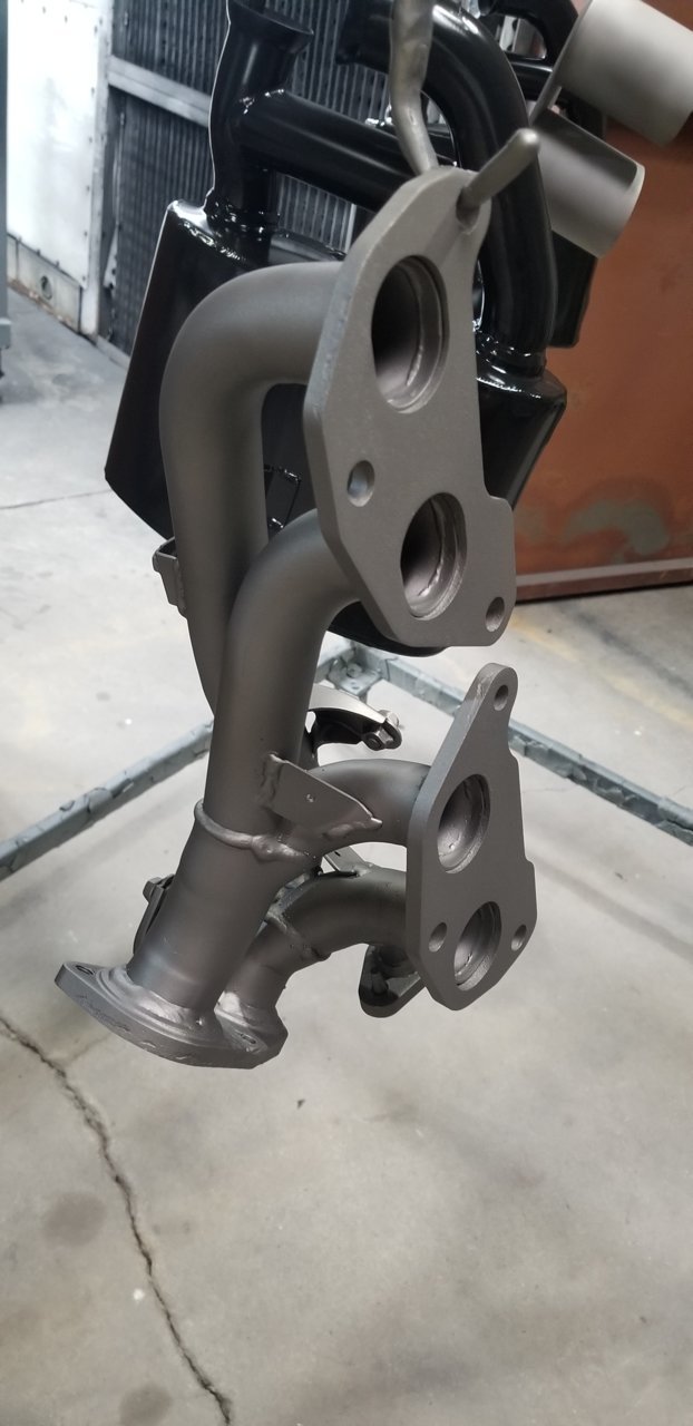

    Yea from what ive read and been able to figure out myself, it makes your upper valve train louder if the spring on the split gear on the exhaust camshaft isn't loaded upon installation.
    To install the service bolt and load the gear spring, I put the cam in a table vise at the section with the wrench flats on it (and a towel in between the two to prevent marring).
    Then I grabbed my big ass channel locks (these in particular, 16.5 inchers: https://amzn.to/2MHMi2J), and with a towel between them and the gear, turned the upper part of the gear until the holes lined up so I could thread in one of the valve cover bolts to keep the tension. Its a bit tricky by yourself, but if you go slow, have the right tools, and be careful it's not that bad.
    I don't mind at all. I picked up the mini header from an auto salvage yard in Berkely, CA for $80-ish out the door. Including the heat shield too!
    It's probably placebo and a combination of the other stuff I did, but it does feel a bit more responsive. The 2.7 is a dog naturally aspirated no matter, but every little bit helps. Considering the mini header I got is an OEM part from another Taco, I can't imagine that it would really ADD any power. For a lot of people that do the mini header swap, they report an improvement largely because their cast manifold has an exhaust leak somewhere on it (the familiar ticking noise).
    Regardless, I would still recommend doing the mini header swap if you can find one for a decent price. It's worth it for the peace of mind and maybe better exhaust flow/performance? Hard to say, but it solved my emissions & exhaust leak problems as far as I can tell so far.

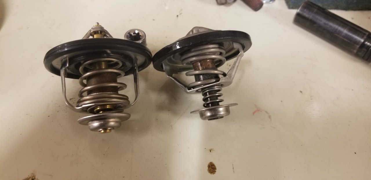

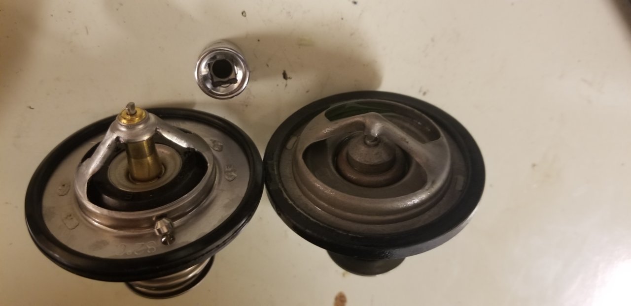

    Replaced my thermostat today with the 180F one from the LCE and the highest temp I see on my scangauge now is 186F. The old one didn't have a jiggle valve on it which is interesting, and my engine now gets up to operating temp a hell of a lot quicker which is great.
    New one the left and old on the right.

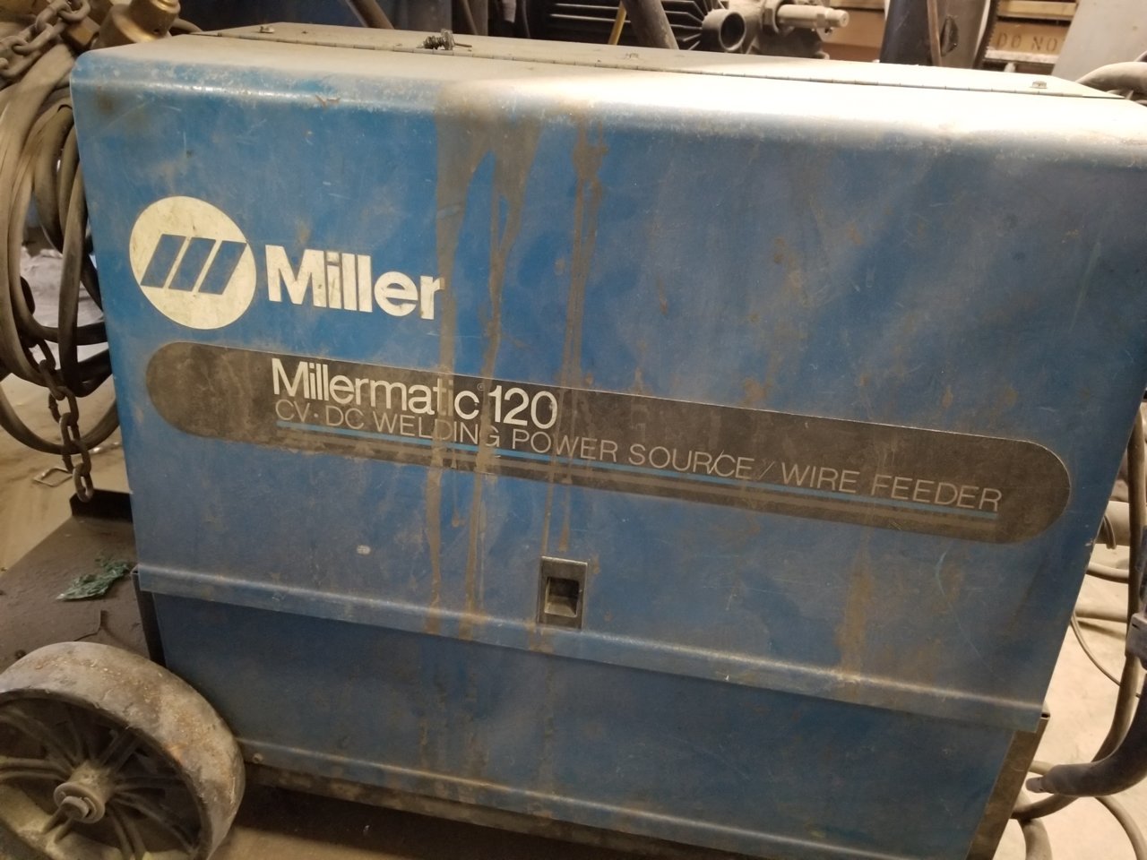

    I also got an older Millermatic 120 wire feed welder and 100psi HF compressor for free!

    Nice score! Can't beat a free Miller!

    Yeah thats awesome!! Congrats! I traded a guy an old Lincoln weldanpower AC150 that wouldnt really weld right straight across for a Hobart Handler 190 MIG, complete with almost full 80CF bottle. Dont have correct 240V hookup yet, but I cant wait to get it going. Whats the duty cycle on the Miller? My Hobart is like 20%, which kinda sucks, but I'm not making 10 foot long welds almost non stop like I do at the shop. That and I picked up a nice Milwaukee chop saw at an auction. You can do a lot with a decent MIG, chop saw, and angle grinders! Looking forward to see what you build.

    Not sure on the duty cycle of the Miller. I would guess around the 20-25% range maybe? I'm sure it will be plenty for what I will be using it for.
    I'll probably be picking up a new 80CF bottle from ebay at some point as well.
    https://www.ebay.com/p/80-CF-Weldin...for-Argon-Nitrogen-Helium-Argon-co2/505133474
    It's a much better price than my local welding supply store. About $50 for a fill too. Can't wait until i'm up and running!\

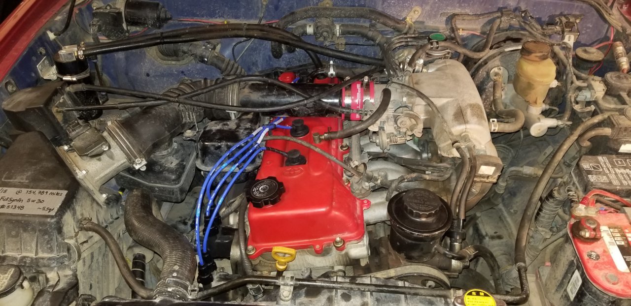

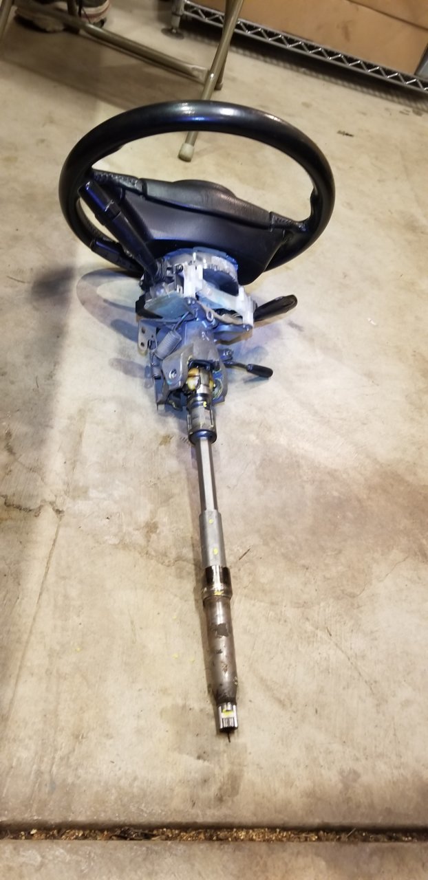

    Yesterday evening was productive. I fixed an exhaust leak and got around to a bunch of other stuff I had been meaning to do for a while. It was nice to get some stuff done that I wanted to work on other than dealing with emissions bullshit.
    After going to the same exhaust shop that I had weld a new O2 sensor flange on my down-pipe, I had them pinpoint a small exhaust leak that I had after reassembly. They identified it being at the connection between the manifold and pipe.
    After talking to them for a bit, I learned that the exhaust gaskets at that connection are "crush" gaskets. They can be reused if in good condition (which I have been doing), but you need to put some high temp silicone around them to prevent small leaks.
    So I put some high temp RTV silicone at the connection and let it sit for a bit while I worked on some other stuff. If the P0420 code comes back after fixing this leak, i'm gonna have to bite the bullet and buy a new cat.
    I replaced that stupid pink intake intake boot with the factory one that was ripped after sealing it up with some black RTV. The aftermarket one was some pretty thick stuff and I didn't like how it was seating between the throttle body and intake tube.
    I'm still struggling with fixing my high idle issue and sticky throttle. I noticed last night that my PCV catch can had a few bad O-ring seals. So I took it apart and put some pipe-tape on all the threaded connections and some RTV black silicone on some other mating surfaces. I've cleaned my throttle body and IACV thoroughly. This weekend after I get a new IACV gasket and some new mounting screws for it, i'm going to pull it back out and test it per the FSM with a multimeters and put voltage to it to make sure its opening and closing properly. I also tested my TPS per the FSM and everything checks out. As for the sticking throttle, it seems to only happen when the engine is running. The throttle cable and pedal feel smooth when it's off so that tells me it's something to do with a vacuum leak. All of my hoses are in good condition and I haven't been able to find any cracks, so I'm pretty clueless as to where it could be coming from. I'm hoping that if I fix the high idle, it will fix the sticky throttle with it. If not, then I guess i'll replace all of my hoses and go from there.

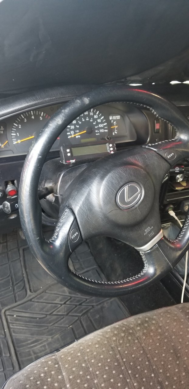

    Now that I have a functional welder, I finally did the tack-weld mod on my steering column shaft to prevent the slop that makes a ton of noise when wheeling. When I pulled it out, I wasn't able to feel much slop at all between the two slip joints with my hands, but I did the mod anyways to prevent it down the line. The hardest part of the removal and installation was dealing with the tilt column springs. They are some strong suckers and take some muscling to work on and off. I had good luck using a pair of vise grips and the needlenose on my leatherman wave.
    Steering definitely feels more positive now and there is a bit less wandering on my the highway.
    Overall a decently successful night and I should hopefully be closer to passing smog now and moving on to doing more fun things with this truck.

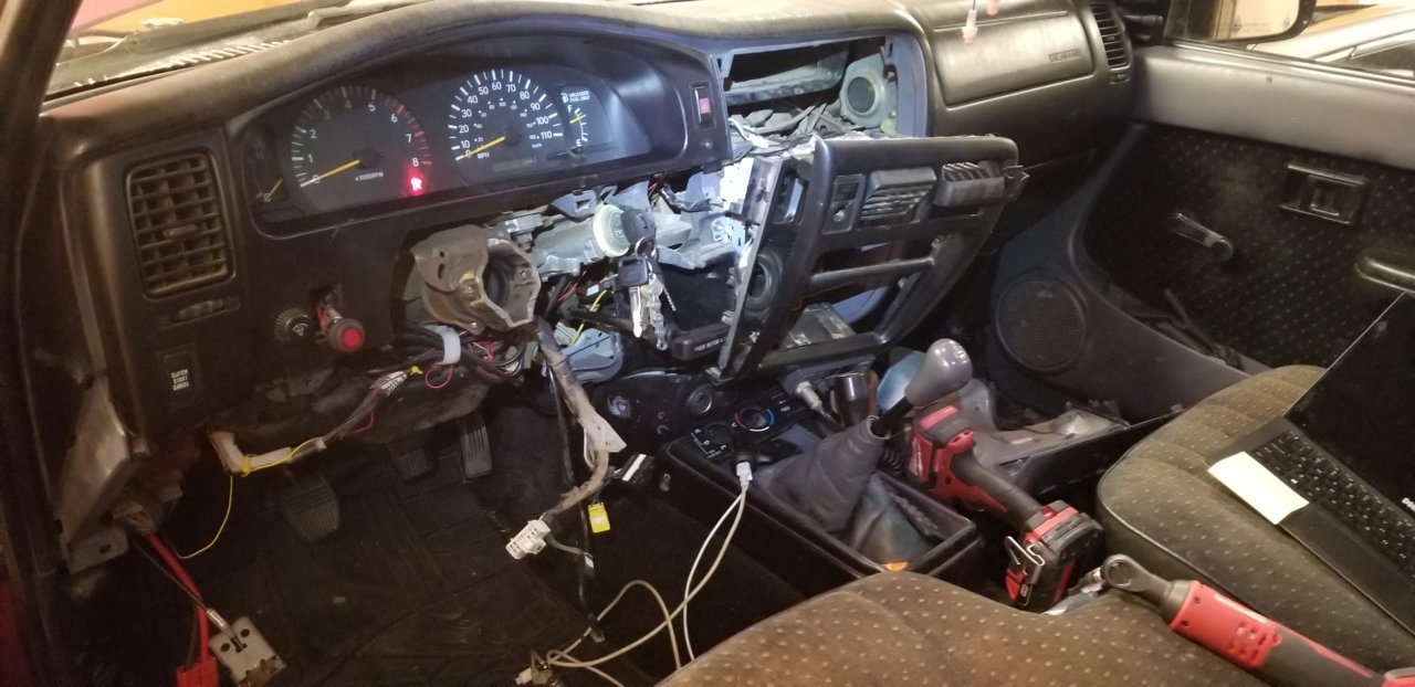

    I saw one of these steering wheels in the junkyard this weekend. What were the two DOWN buttons for?
    #75
  16. Feb 18, 2019 at 9:23 AM
    #76
    betterbuckleup
    betterbuckleup [OP] Well-Known Member
    Jun 26, 2017
    #222483
    4,824
    Ian
    Concord, CA
    2000 Tacoma SC 2.7 4x4 5spd

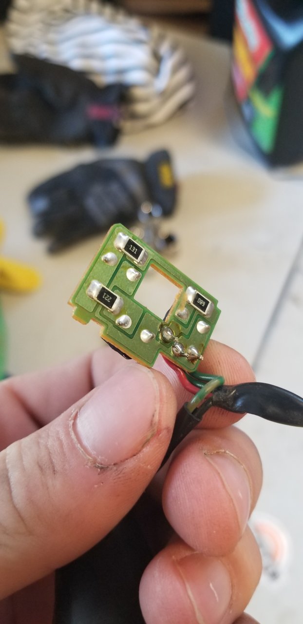

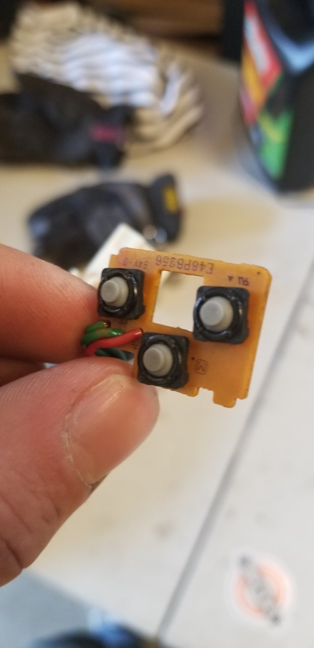

    Those are volume buttons. There are two corresponding "UP" buttons on the back of the wheel.
    I have seen some threads of people wiring up steering wheel controls with an aftermarket wheel, but that's more work than I wan't to put into it at the moment.
    My current dilemma is getting the cruise control to work. When I get around to it I need to probe around with my multimeter to determine what needs to change in the circuit to get the two components to talk to each other. I believe that the steering wheel module communicates based on resistances.
