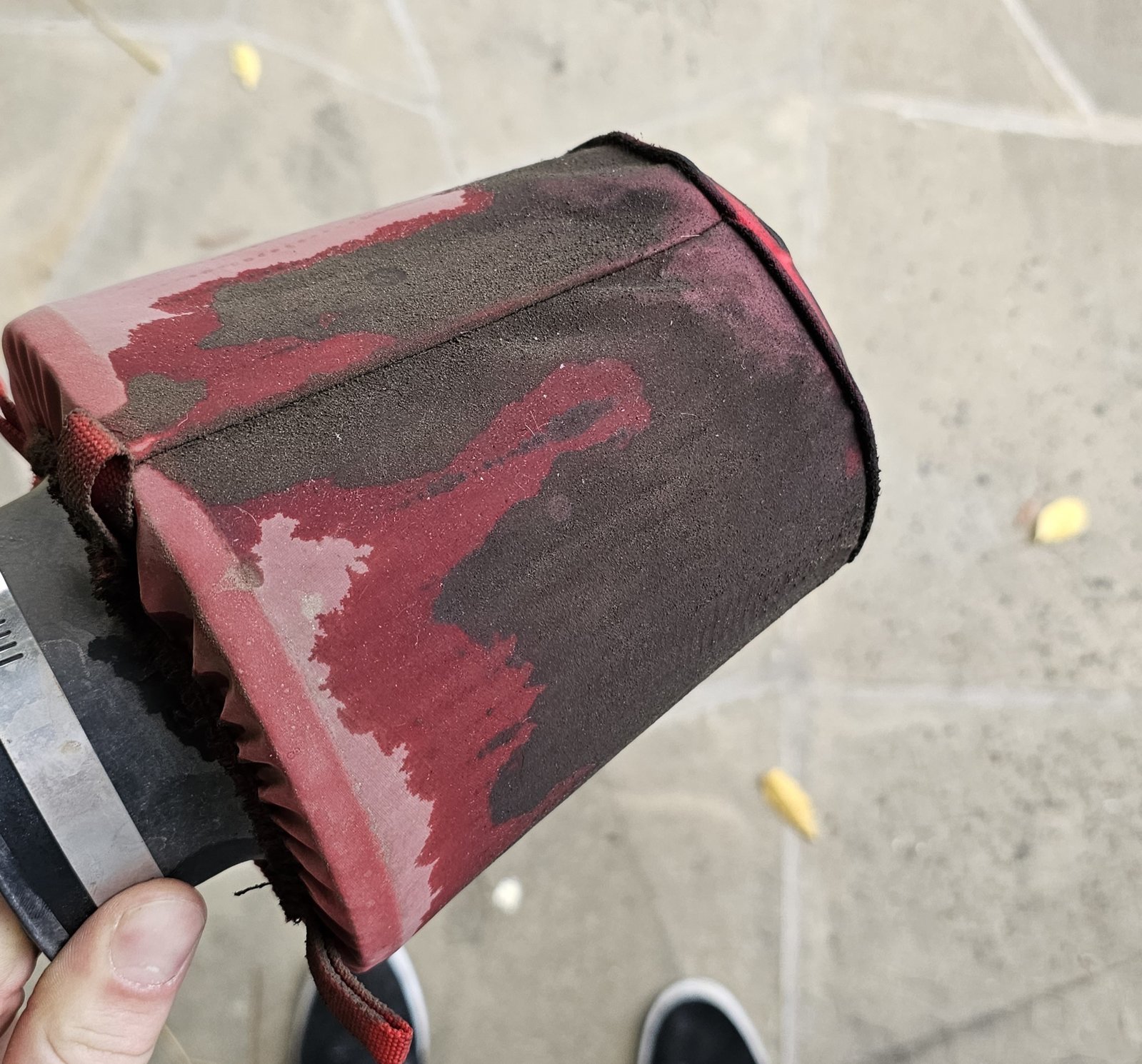

    I got around to fixing the wiring for my water meth setup to where it doesn't dump fluid into my intake with the key off ignition.
    Which means it's finally time to clean the filter since it was consistently moist from the water meth running down into it. Makes a good dust magnet.
    This is the bottom side of the filter

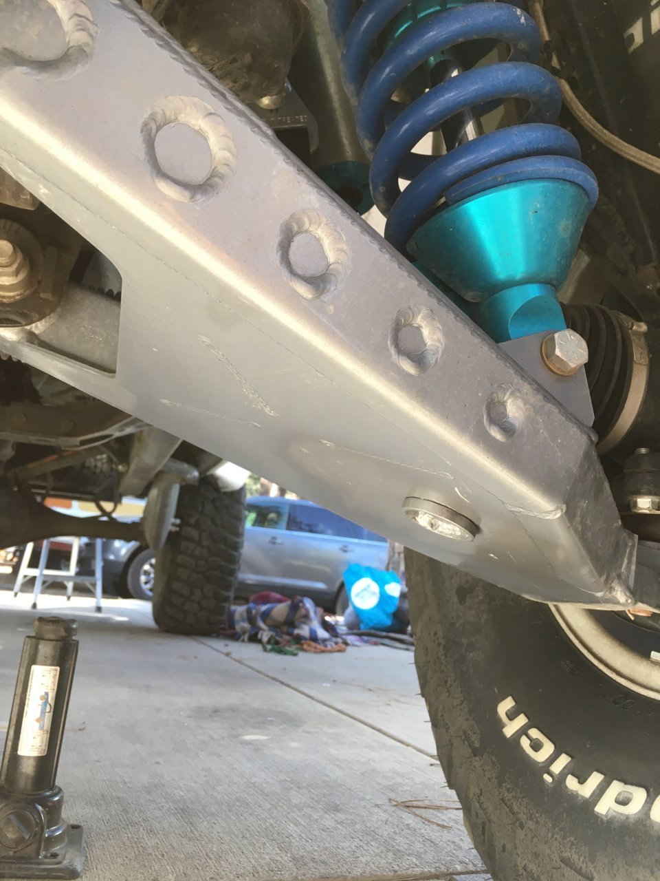

    I've thought about doing something like that. The Long Travel arms are a pain in the ass. The only way you can get the tire to lift with them is to be under the LBJ, but then you're too close to the tire.
    BUT... judging by how tore up the bottom of my LCAs are already. Those things probably wouldn't end up staying attached for the entire wheeling season. Cool idea though.

    Another idea I had toyed about with was doing a big scab plate to the bottom with a nut welded on the inside for a 9/16-5/8 bolt that I could thread a similar jack point onto.

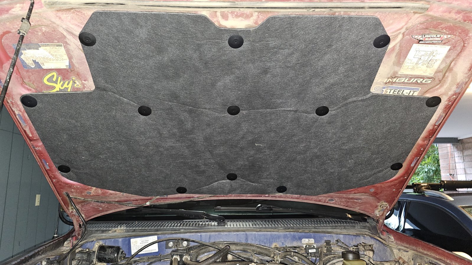

    Installed a fiberglass under hood insulation mat. Hopefully helps cut down on engine noise and insulate for winter temps a little.

    Have you done any in-cab sound deadening yet?
    and is your firewall blurple?

    No I haven't yet. One of these day I plan to gut the interior and sound deaden everything with butyl matt and some MLV. Already have it in some places, but need to do the firewall, roof and floor pan for full coverage.
    Yea that's actually the original color of the truck. I wish it was still that OEM blurple color. PO repainted it to some kind of red that looked almost pink at times (see pg 1). Didn't know when I bought it because I wasn't paying attention.

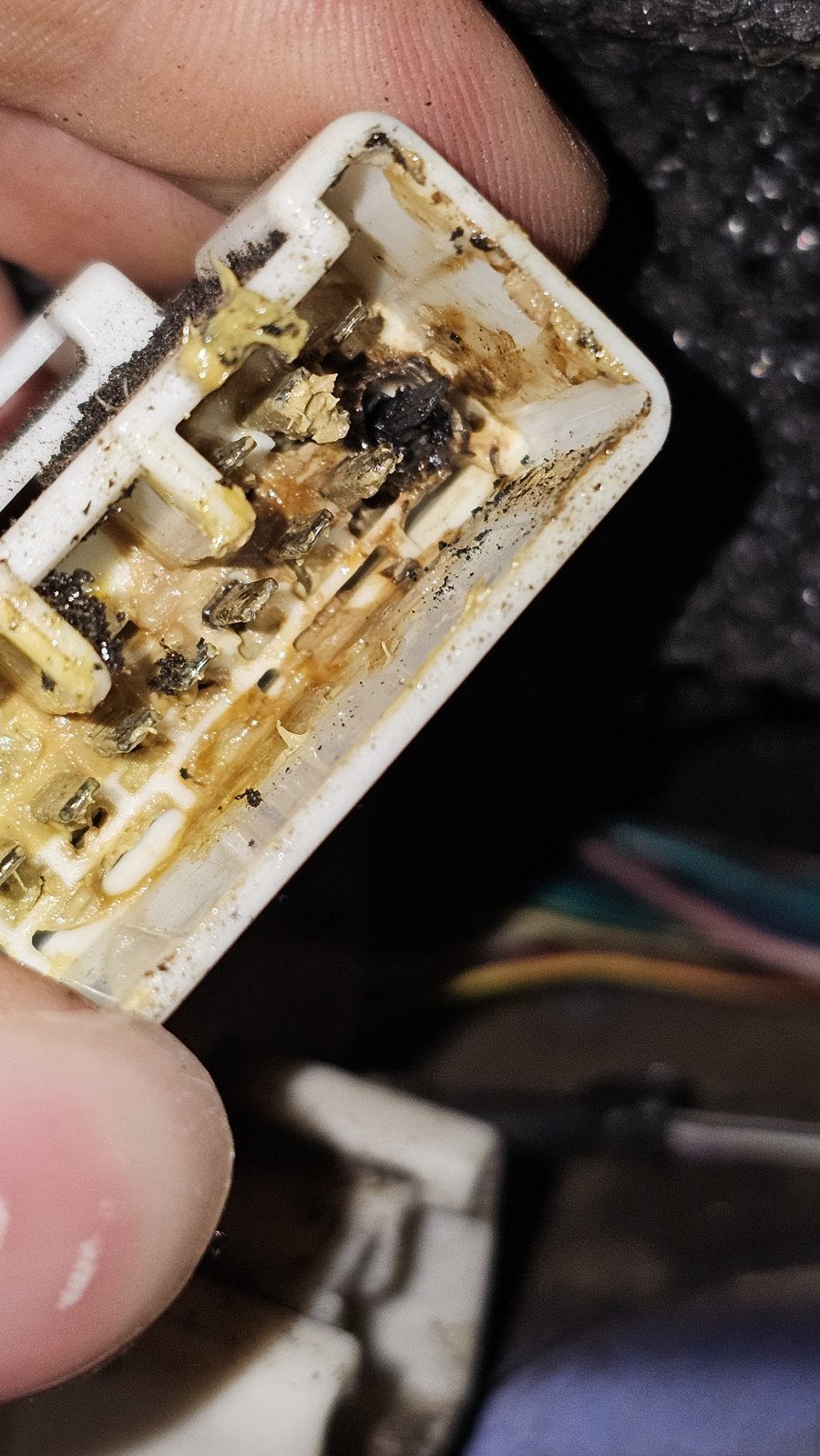

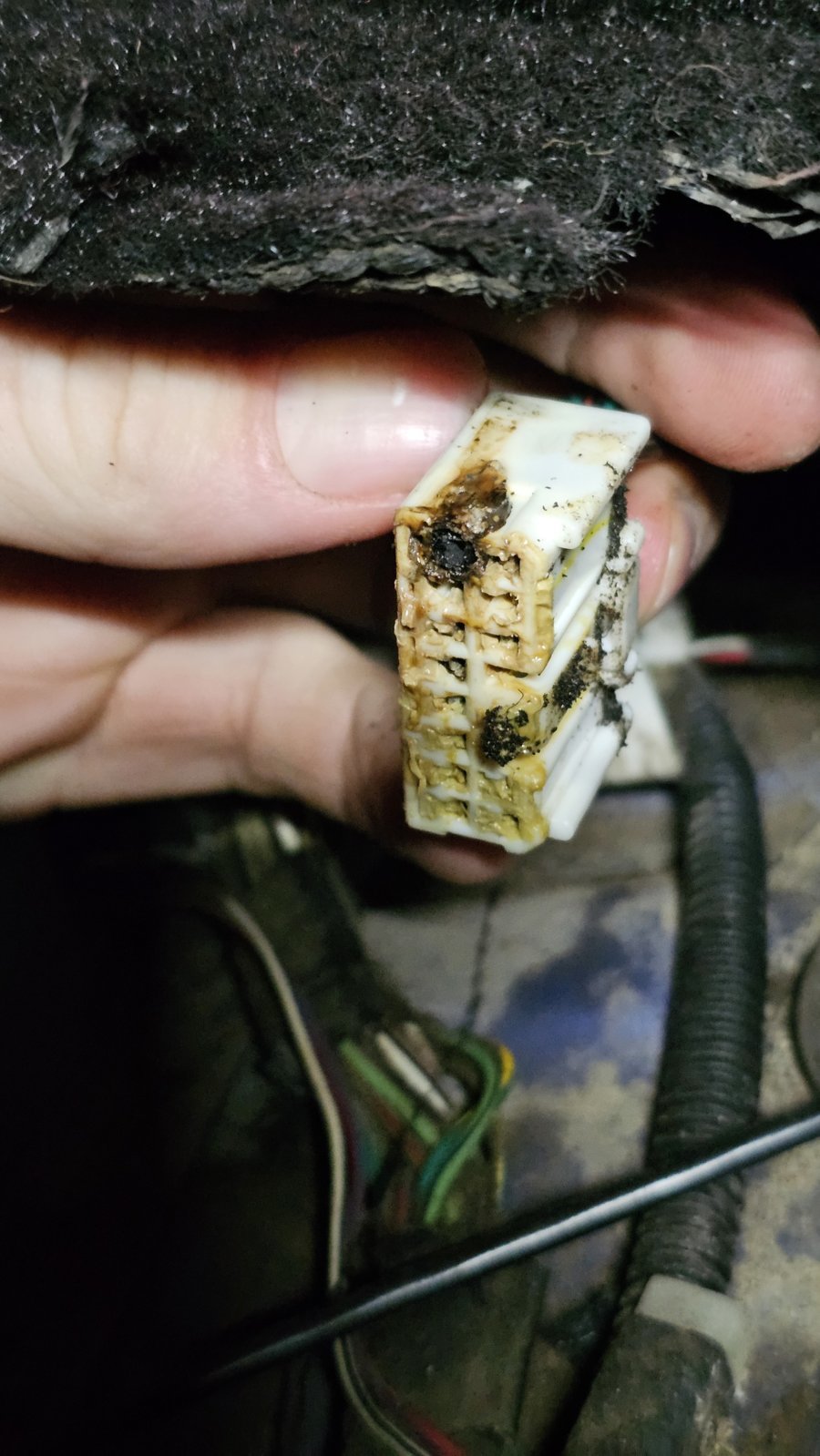

    Ran into a no start issue after parking the truck. Determined it wasn't getting fuel since I didn't hear the pump priming with key on. Started right up for a little bit with some starter fluid.
    At first thought it was the fuel pump so I ordered a spare.
    Found that the connector under the driver side seat was the culprit. Both pins were fried for the fuel pump power wire. I guess at least I have a spare fuel pump now.
    I temporarily bypassed the connector for now.

    that coulda been a real hot heated seat :bananadead:
