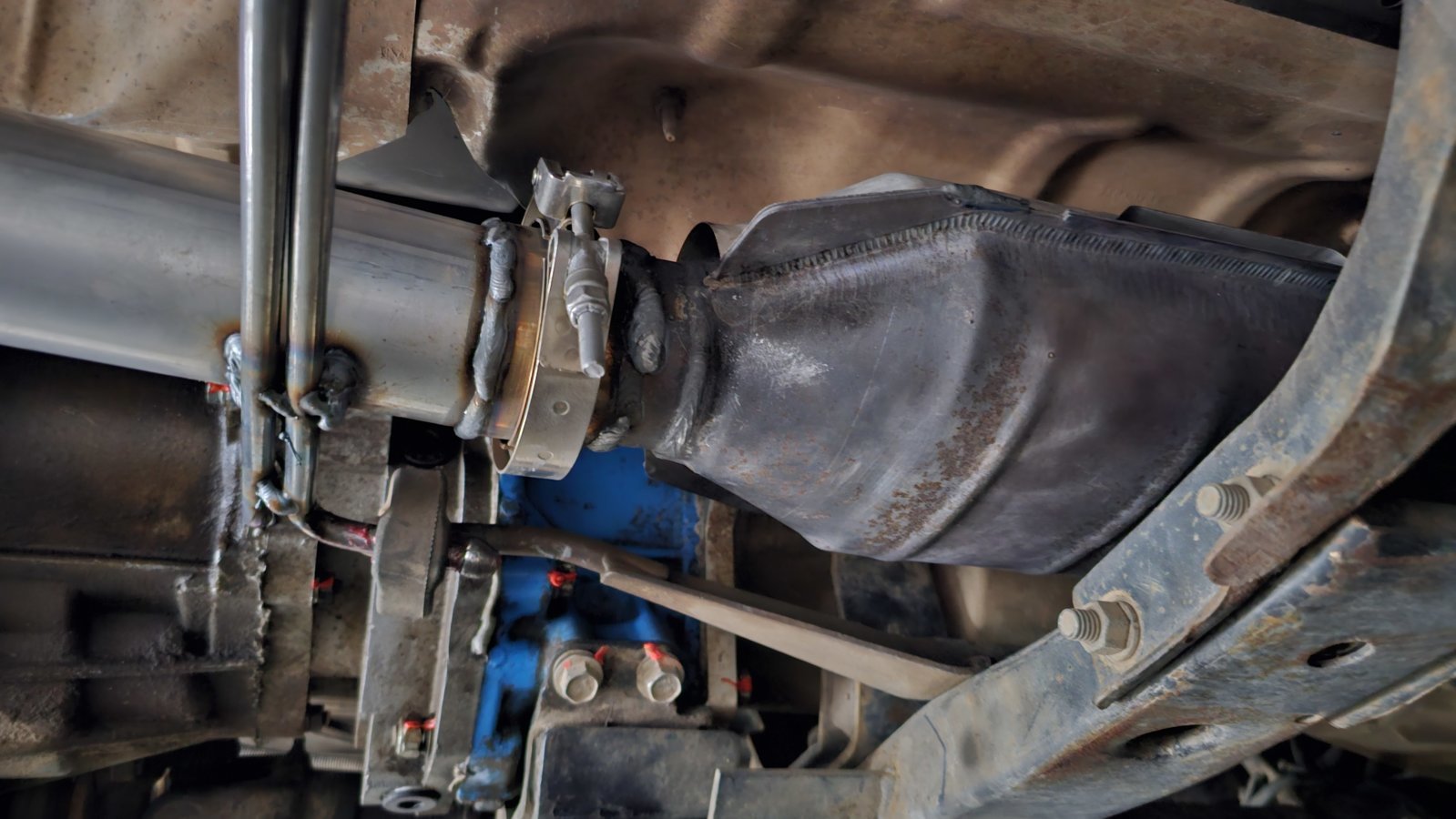

    Developed ANOTHER exhaust leak in the same place at the flange after the cat. So I had a V-Band clamp welded in its place.

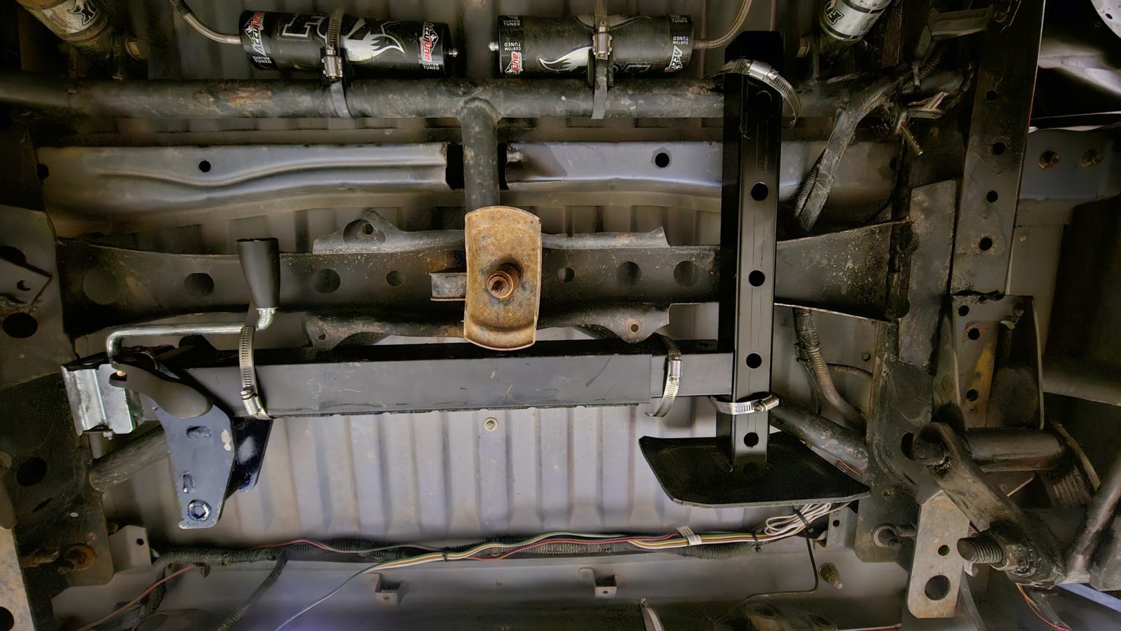

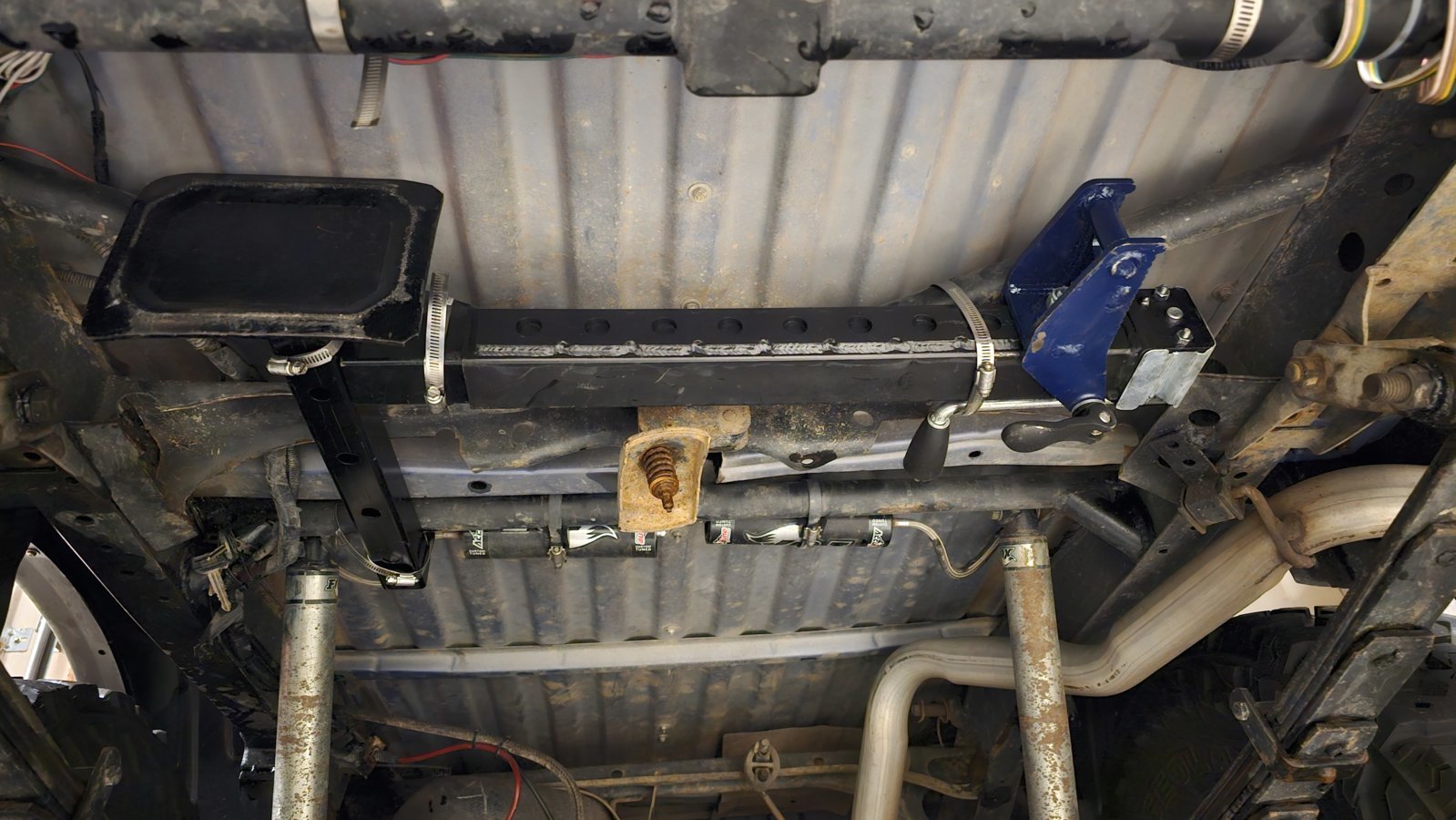

    Found a good spot for my tauler Jack

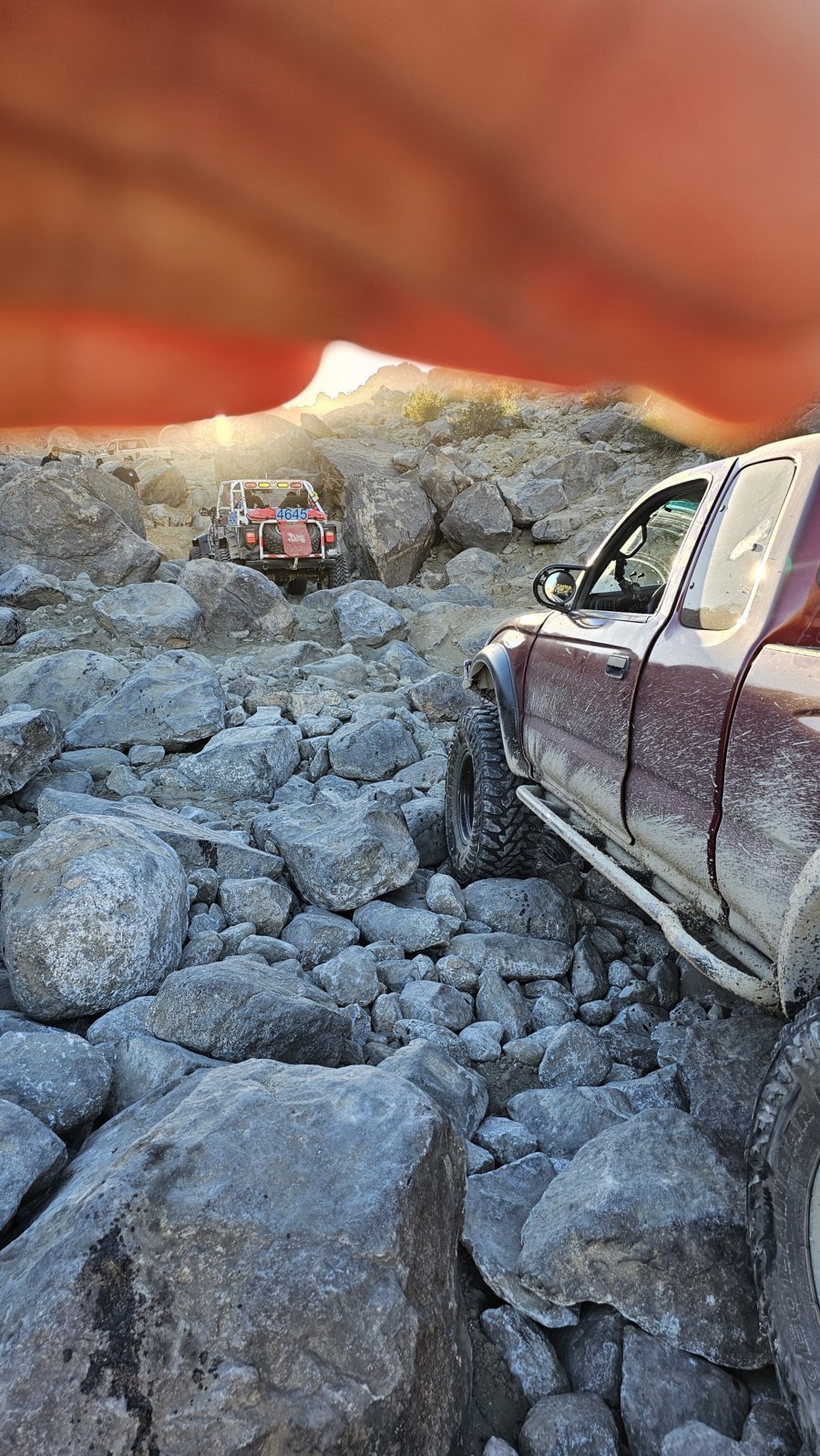

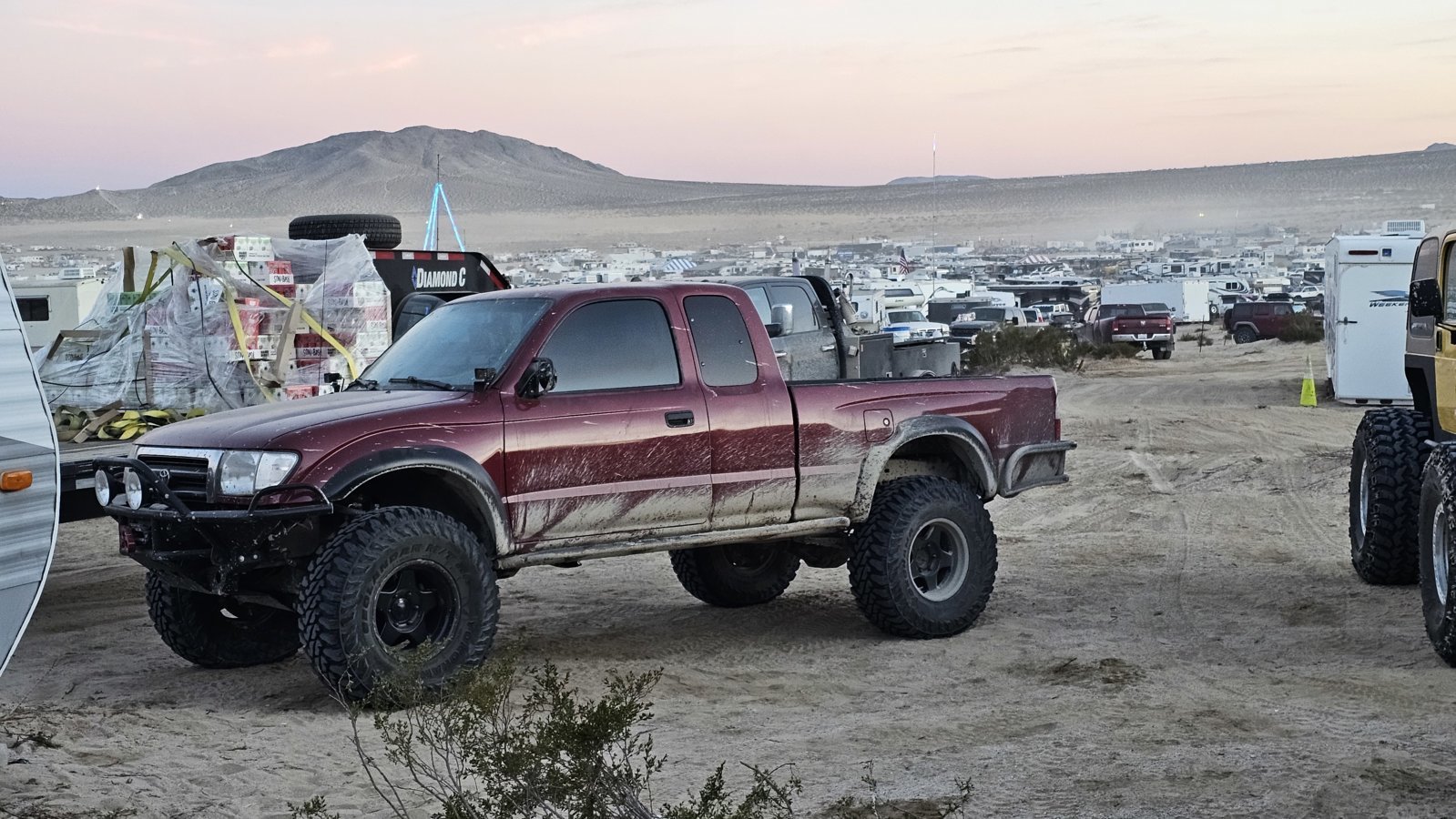

    Fun time at KOH last week. Truck performed great with no issues. Ran Wrecking ball with some buddies and then Turkey claw a handful of times in my rig.
    I lost a driver side rear fender flare when bombing around on the lake bed unfortunately. But quite conveniently that's the only flare I have a spare for though. Just need to clean it up and install it. Might repaint all the others while I'm at it.
    Just enough moisture on the ground to cut down on the dust, but the mud that was there really has a tendency to grab onto paint. The frontside of my axle housing in the rear is chipping, so I'll have to touch that up in addition to my tauler jack which now has no paint on the tongue portion.
    I also found water coming into the cab on the rainy drive home from the port I used to run the methanol hoses in and out of the cab. Just need to slather some silicone on that spot.
    The suspension worked great and took some hard hits here and there while trying to rip through some whoops that were definitely disproportionately sized to my truck. Cranking down all the way on the clickers in the front did help some, but it would really be helpful in this kind of terrain to have a bypass up front to really control the last 1/3 of travel. It would be cool to build a stock width sleeper with bypasses and hydros in the front and a short linked rear. But that realistically would be overkill for the kind of terrain I wheel most of the time up here in the sierras. Not so much go-fast stuff as compared to in socal.

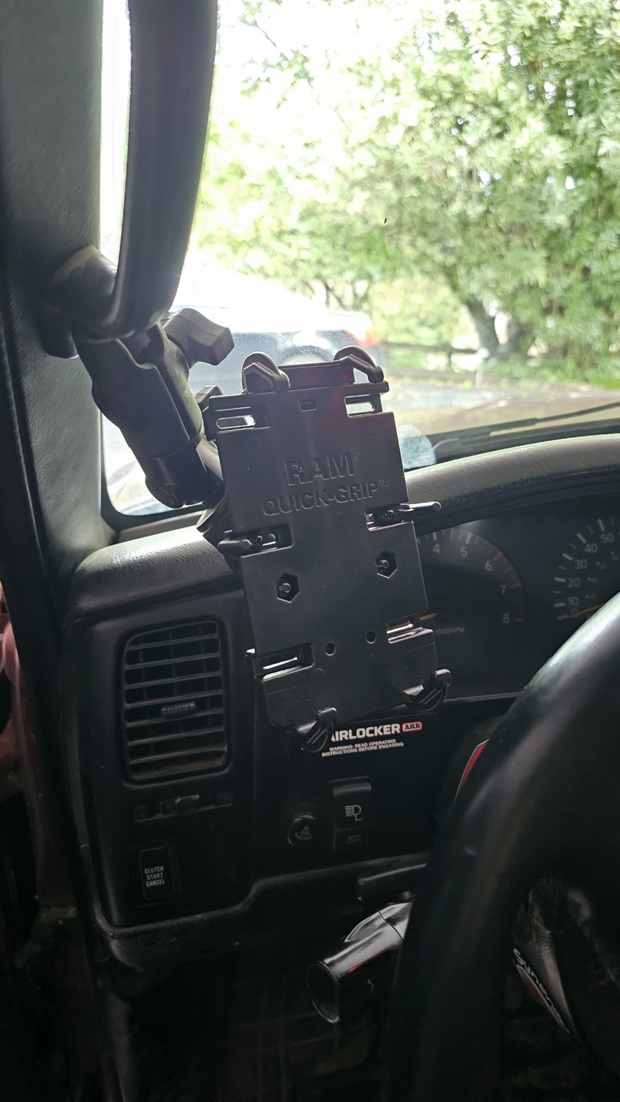

    Also installed this RAM quick grip to replace my x-grip. I never really used it because it was a pain in the ass to get your phone in and out and it doesn't really even fit my new s23 ultra.
