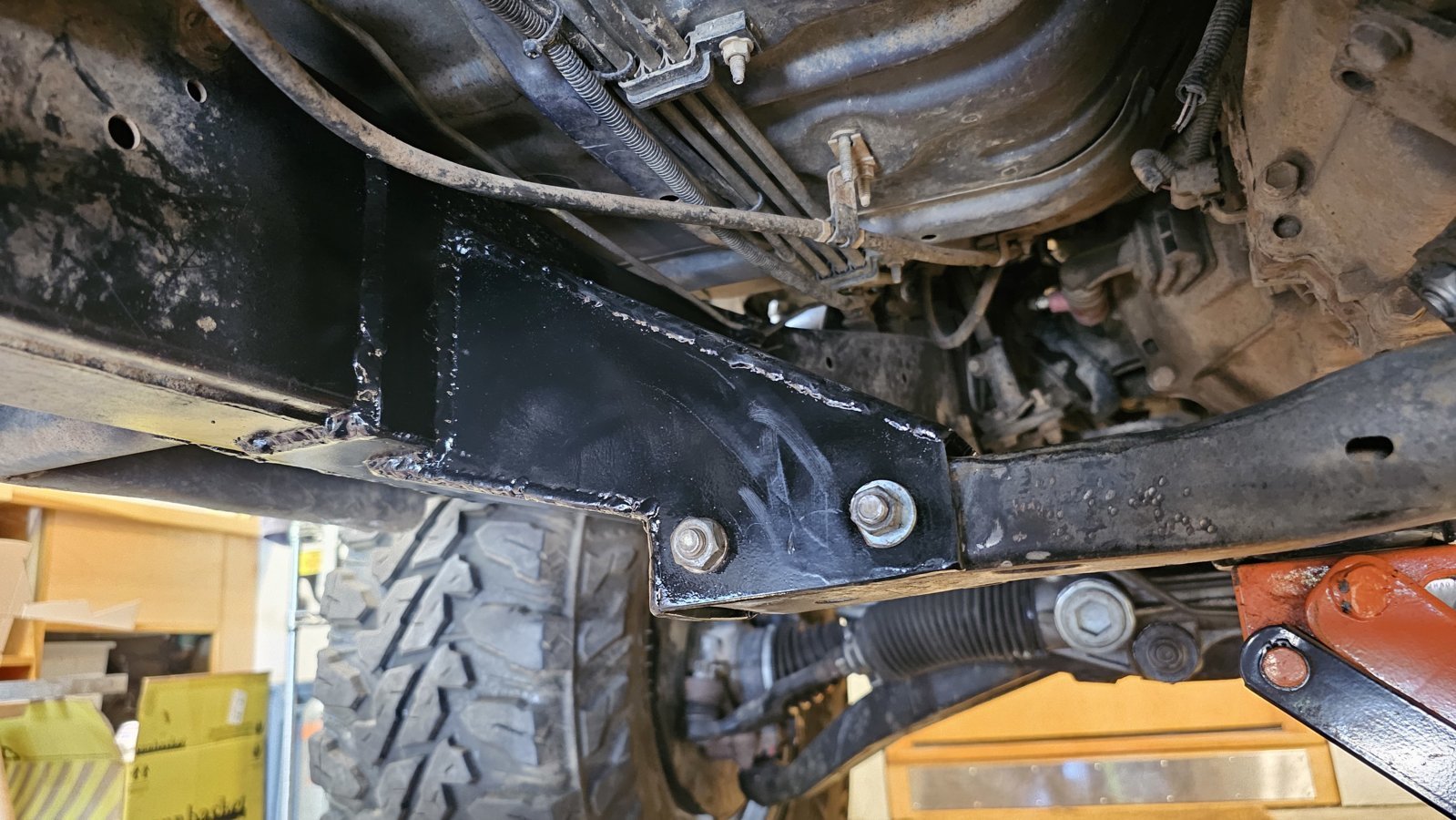

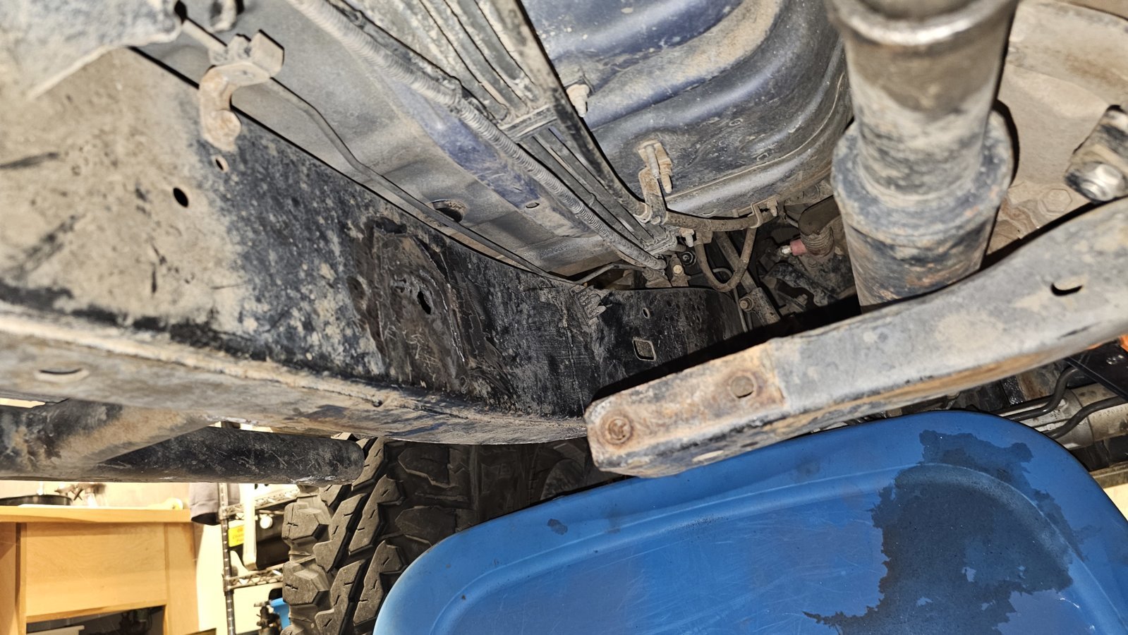

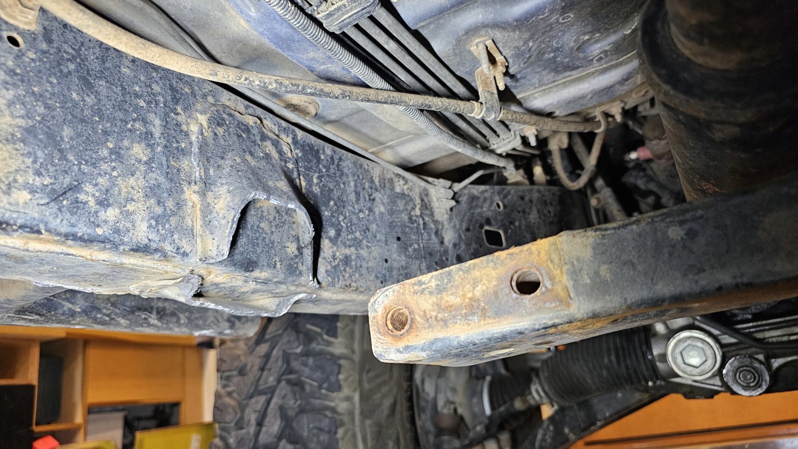

    Wow grinding these frame brackets off really sucks a fat one. Got the shitty part of the job out of the way tonight though.
    Makes you rethink all the work it takes to SAS....
    I'd like to do the passenger side one and raise the whole xmember, but that's not in the cards for right now.

    Got a couple new abraisive tools this summer and while the old 4" cut off and flap would be my go to for your project, the harbor freight band file (with good 3m bands) could help. Good for getting in tight spaces and even better is their 1/4 die grinder but not for using over your head - it makes metal splinters that stick in skin for days or longer.

    It would have been a pita with just a grinder forsure. The plasma and right angle die grinder with a cutoff wheel came in clutch for breaking up the welds into smaller bits.

    And @Speedytech7 you were right. Inner portion of the frame is def bent inward a bit. Almost looked like the bracket was made out of thicker material than the frame in places.
    Speedytech7 likes this.

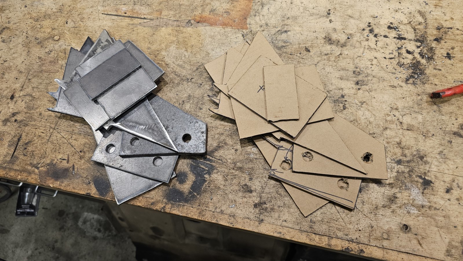

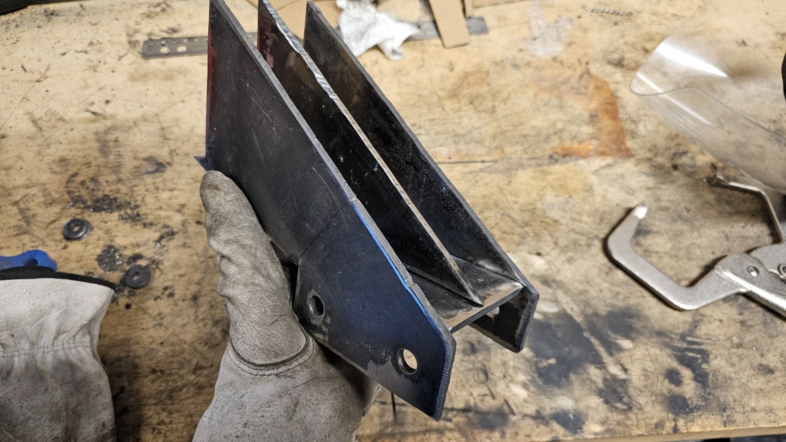

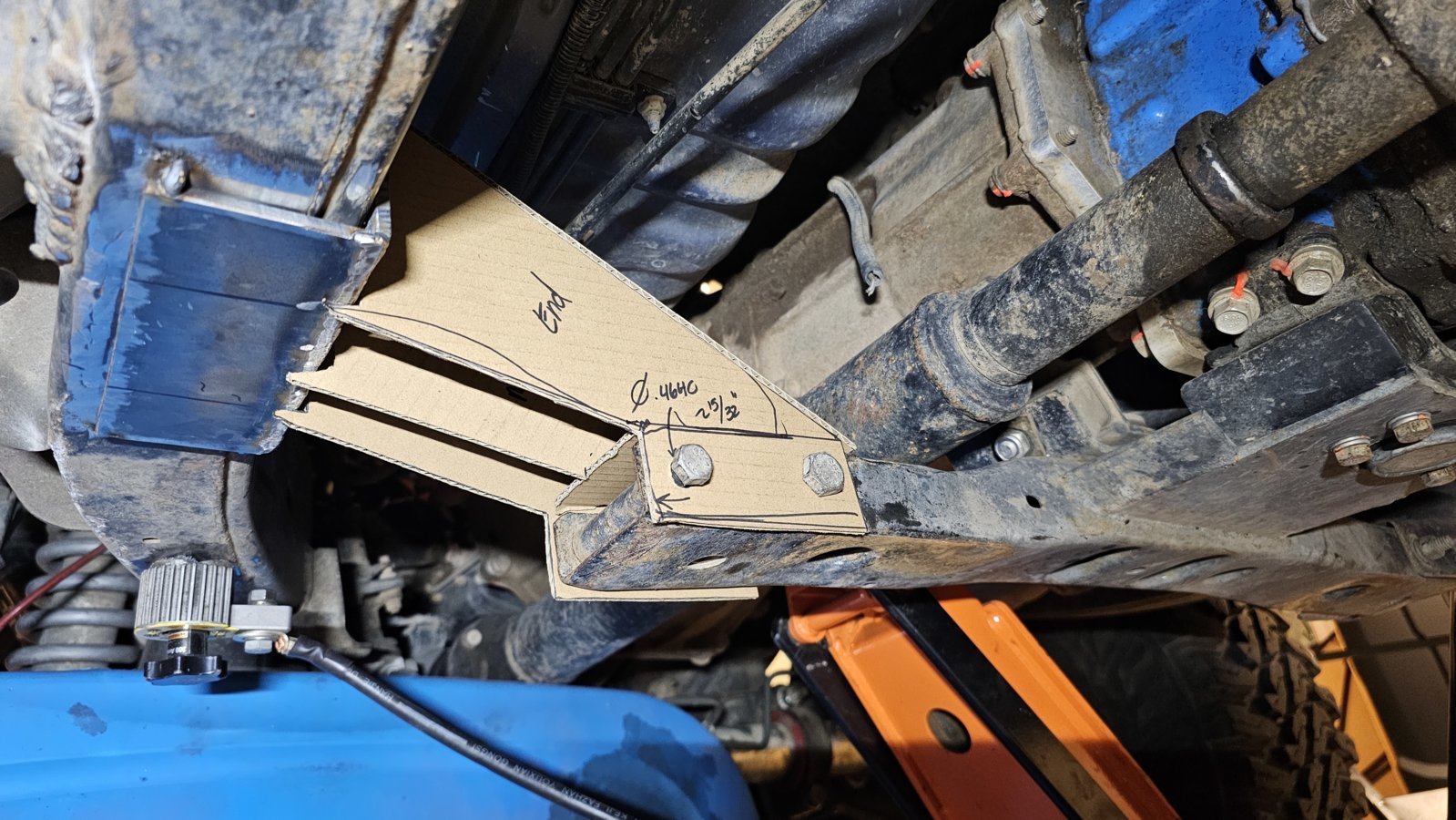

    Tonight's progress was making the frame plate and templates

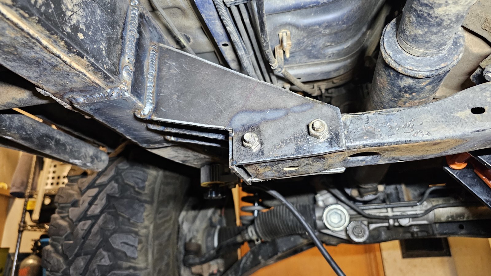

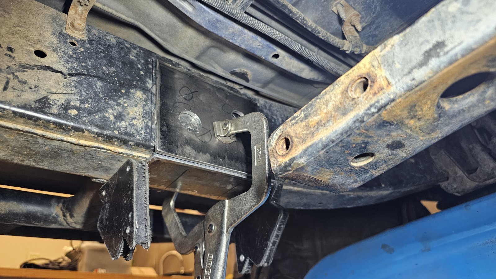

    A press brake would make the fitment a hell of a lot easier for some of these pieces. Not gonna be full weld on all the inside seams cause I can't get to them, but it'll be fine.

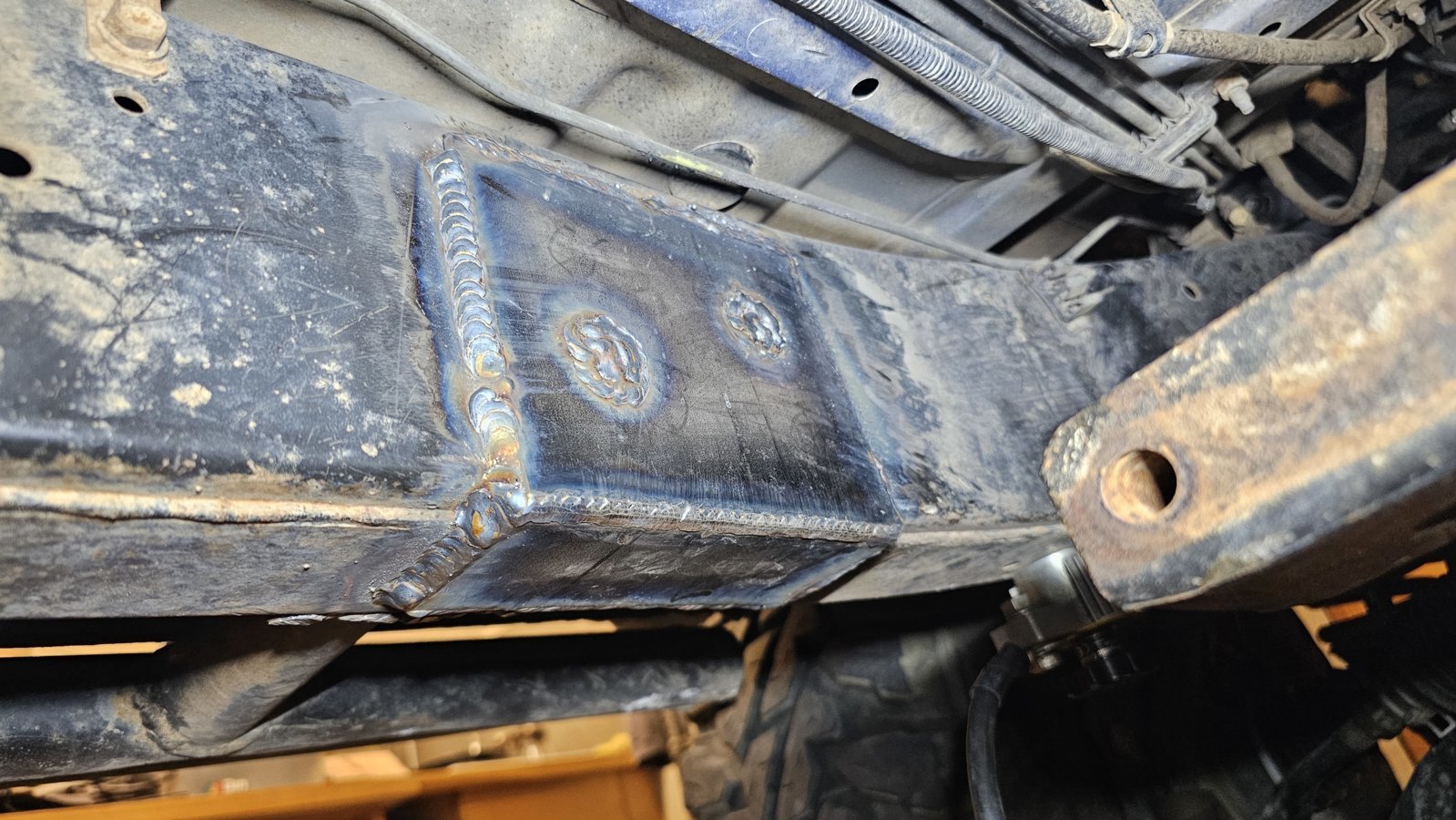

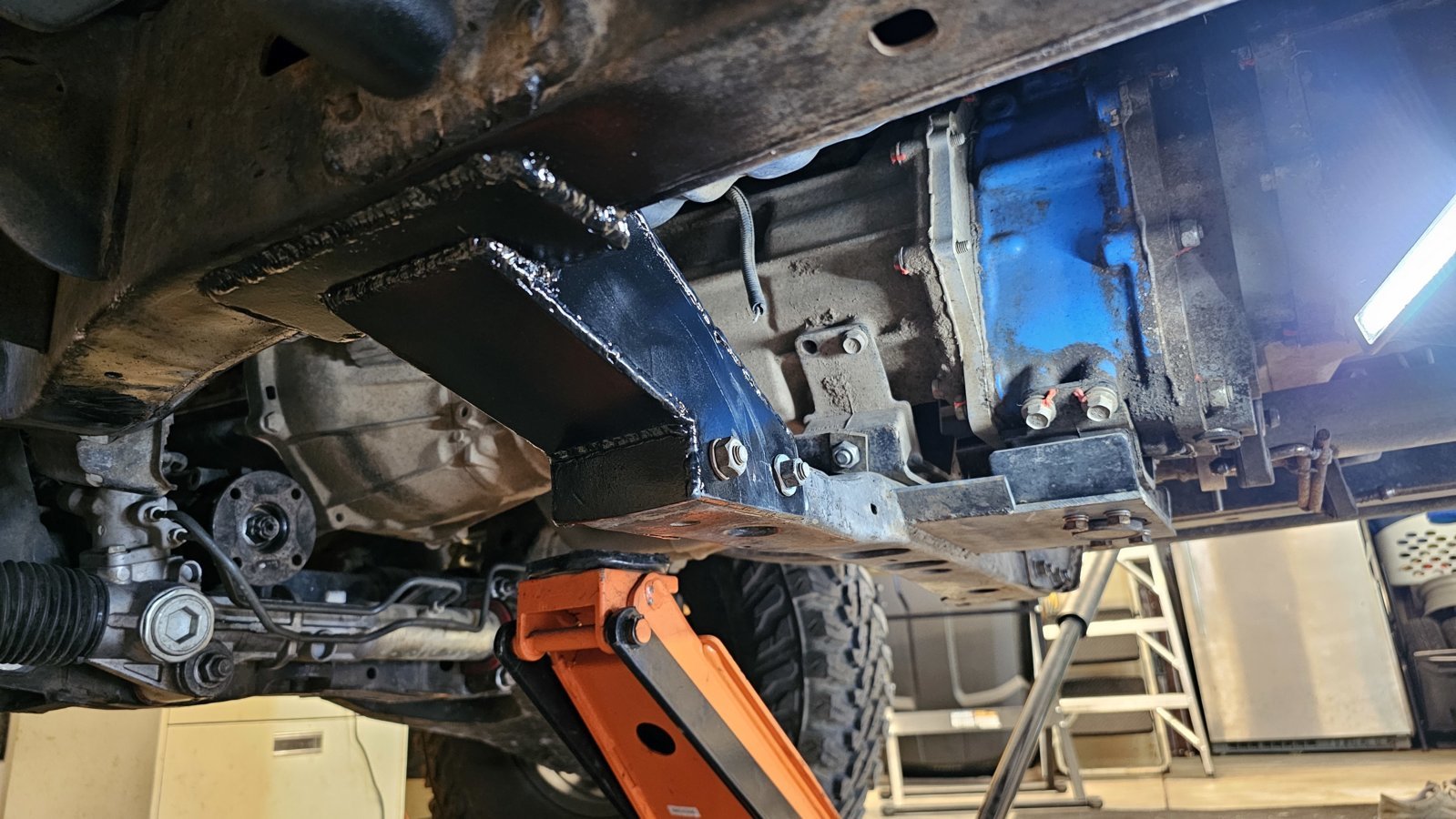

    Finished up the crossmember mount

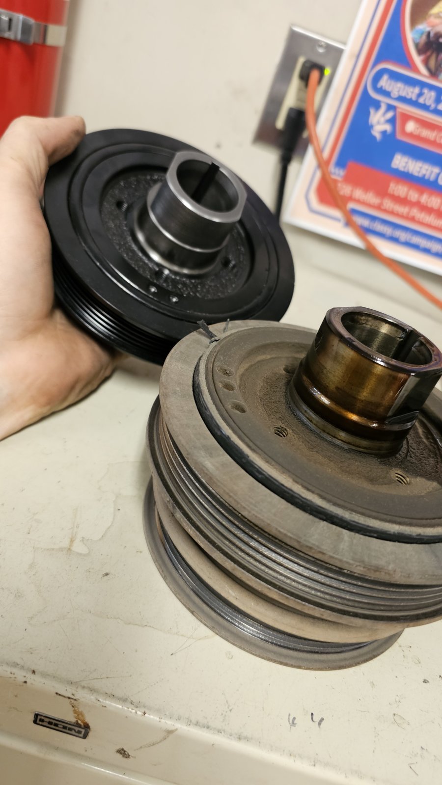

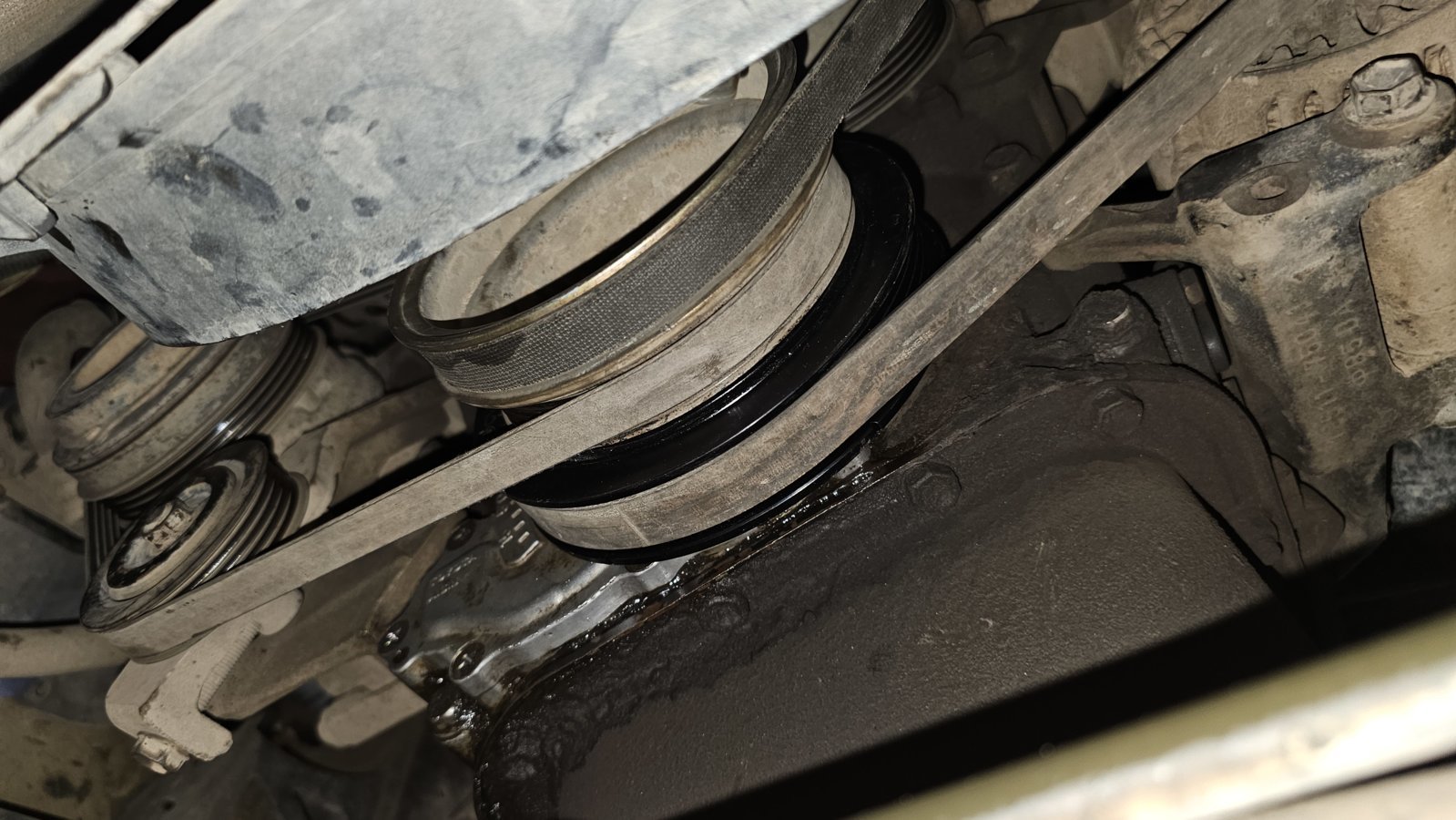

    Upon investigating a squeak noise coming from my belt system, I found my crank pulley is in a bad state. Not sure what's going on and why only the inner pulley is moving rather than them both, but pretty sure it's not supposed to look like that. The side of the belt is rubbing on the pulley as it wobbles.
    I'm hoping it's as easy as a new harmonic balancer. Worst case is that my crankshaft is shot and then I'll need a new motor.

    Just the one side. No plans to do the other unless I manage to bend that one too. Will have to remove the exhaust for that one.

    5vz balancers have rubber connecting the inside and outside - I’d look into that sooner than later if it’s like that on a 3rz and it can be saved.

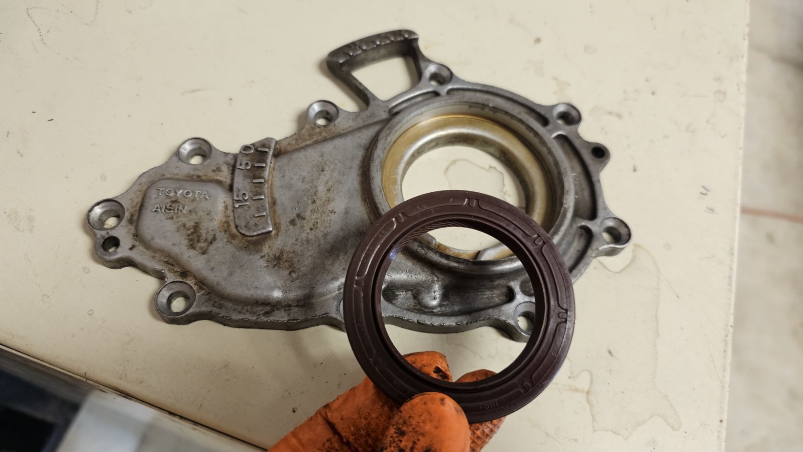

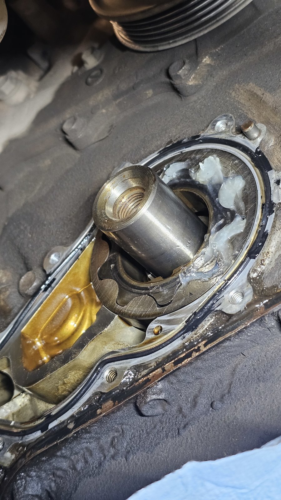

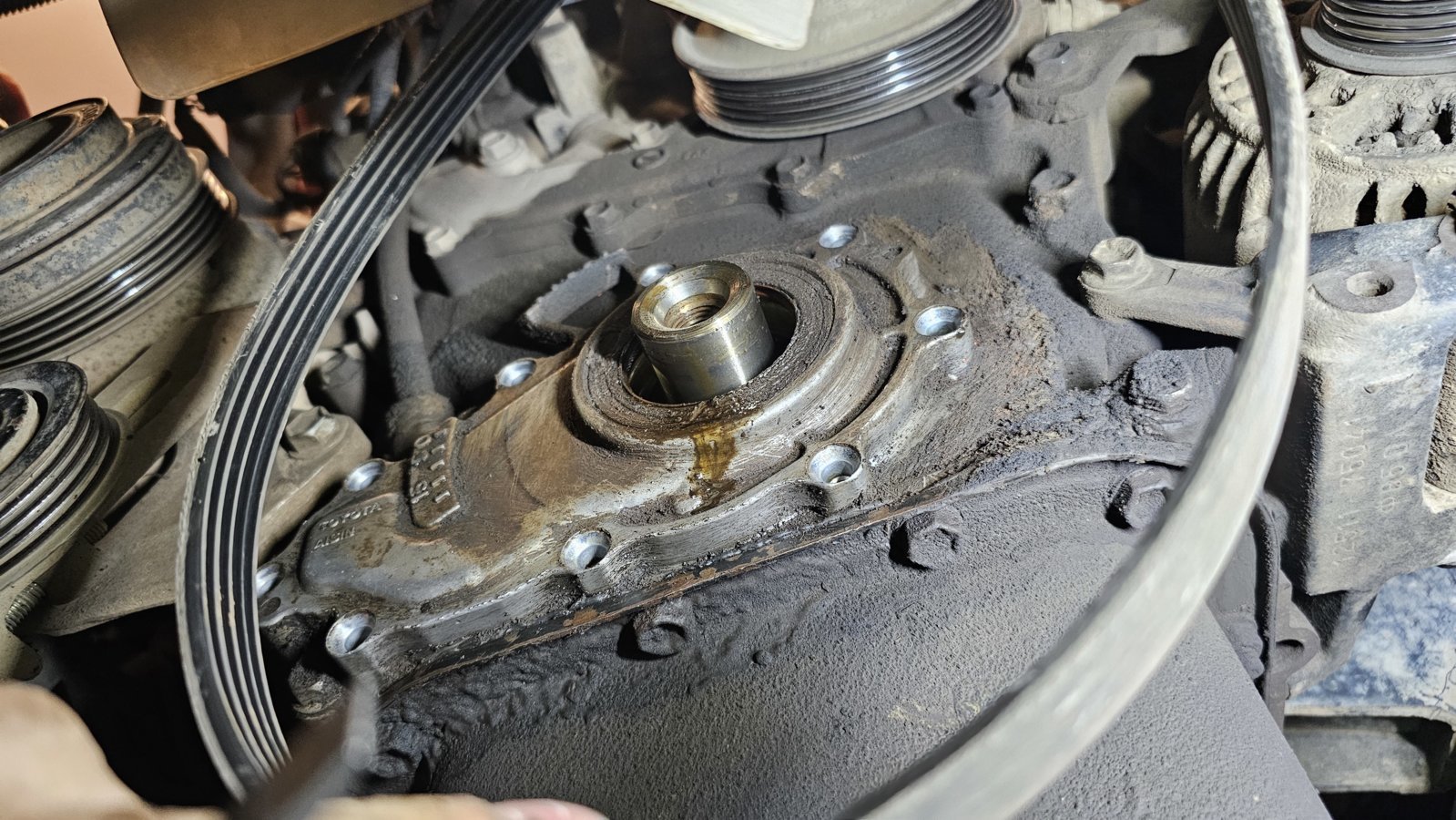

    Replaced the harmonic balancer and changed out the oil pump housing seal.
    Had to use some fpig to keep the oring seal in place.
    20240727_125626.jpg 20240727_131823.jpg 20240727_133616.jpg 20240727_141338.jpg 20240727_143655.jpg 20240727_151939.jpg

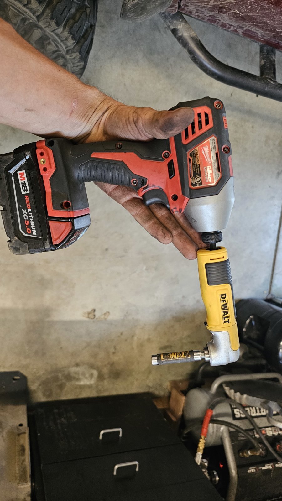

    This was a huge help for getting the housing screws out without having to pull the radiator.
