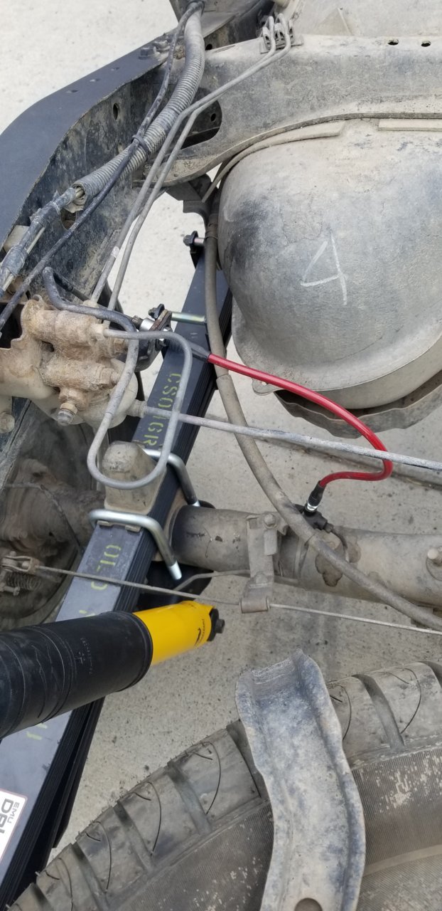

    Did you have any problems with your parking brake cable being to tight over the taller leaf pack?

    It was a bit tighter than stock, but not to the point where it was an issue. Didn't notice any brake dragging or anything. In my experience, the parking brake doesn't really fully engage until the very end of the stroke of the lever anyways.
    I have seen some folks make small brackets to raise the attachment point on the drums though.
    You could also bend the cable bracketry on the axle housing up a bit to help add a little more room between them.

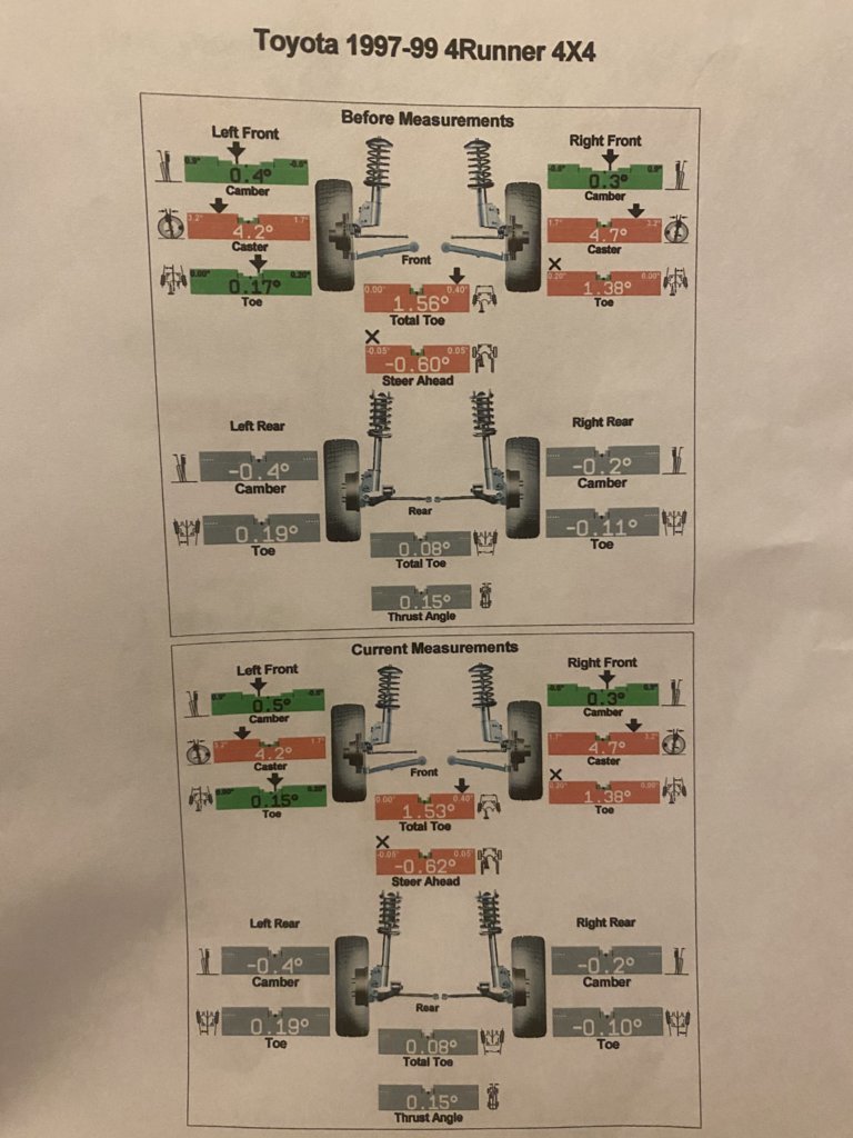

    fify Very interesting. Almost the same as my wife’s 4runner. It might be some incorrect laser or the jig at solo. I’ve been working on the alignment over the past couple months (also setting ride height 2-3 times). Changed uppers and spindles. This is another data point for it potentially being the solo lowers causing the passenger side to be way out on the front and rear to get matching (or almost matching) numbers.
  14. Nov 16, 2024 at 9:28 AM
    #914
    betterbuckleup
    betterbuckleup [OP] Well-Known Member
    Jun 26, 2017
    #222483
    4,832
    Ian
    Concord, CA
    2000 Tacoma SC 2.7 4x4 5spd
    In my case, I don't think it's a parts problem. After a front end accident, my truck always had to have the passenger side cams crossed up to keep a higher marching caster with the stock lowers.
    I wasn't doing my own alignments before, but I'm pretty sure they previously didn't need to be at such extremes to get cohesive numbers side-to-side.
  15. Nov 16, 2024 at 8:36 PM
    #915
    NW03Taco
    NW03Taco Well-Known Member
    Mar 8, 2023
    #419655
    48
    Noah
    Portland Oregon
    2003 Tacoma Xtra Cab Gold
    OME suspension SCS F5 17x9 -38 Toyo Open Country MT 295/70/17 Coastal Offroad High Clearance Front Bumper
    This is good to know, I think ill set them both at neutral before heading to an alignment? Not messed around too much with my own alignment so with the KP Cams I will be curious to see how it is. How are you liking the 35's?
  16. Nov 16, 2024 at 10:30 PM
    #916
    Dalandser
    Dalandser ¡Me Gustan Las Tacos-mas!
    Feb 19, 2015
    #149090
    17,673
    Anthony
    Downey
    08 PreRunner Regular Cab / 98 4x4 Extra Cab
    Empty Wallet Mod

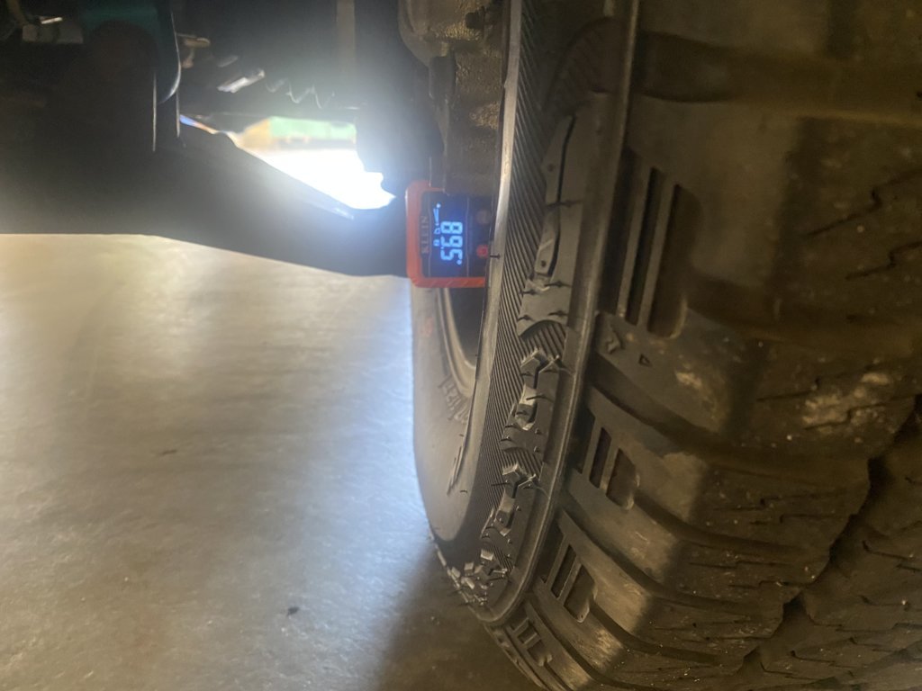

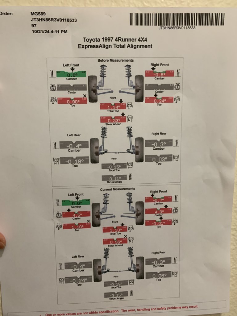

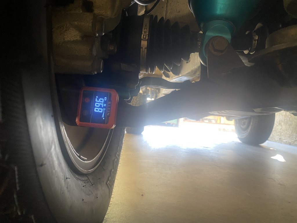

    Do you have heimed uca’s? Are you talking about the 8 way lock out tabs? Will your shop adjust those?
    I’ve spent a good month of partial Saturdays and Sundays working on my wife’s alignment. Using shops with free alignment checks helped get confirmation that what I’m seeing are the actual numbers.
    Using an angle finder I got camber close to zero’d out, but my numbers aren’t matching the two shops I’ve brought it to and their numbers don’t match either. I think either one or both of them didn’t know how to run their machine.
    Here’s what I have 6D7D706B-24BB-4664-8828-0BECD9AA1223.jpg1B9174D6-4553-4BFE-94A1-2CE5B6DCDA25.jpg
    The weird thing is the most recent shop had the camber at positive and these pictures show a negative camber (just a smidge - half a degree or less).
    Don’t mind the toe - I made it close to zero after this report and it’s uneven because the steering wheel was off center when I installed the rack and I’ll just remove the rag joint to re-center the wheel.
    The strangest thing is that I got this report first
    Where the driver’s side was dead on at 0* camber and the passenger side was out of spec with negative camber. I didn’t want to make my cams any more mismatched than they already were so I added 3/4 of a turn of preload on the passenger side which would lift the ride height and therefore trade some of the negative camber for caster. I pushed the toe out a little but I didn’t touch the lca cams - and they were marked with only street driving between the first report and the second report. Who knows what is right- either of the shops or me, but if need be I know a shop that has experience with off road parts.

    I wouldn't use the brake shield as a refernce point like that with your angle finder. I know mine are all bent out of whack. I use one of the SPC alignment fixtures on my wheels for the camber and castor measurements

    Angle finder's on the rotor - none of my vehicles have dust shields
