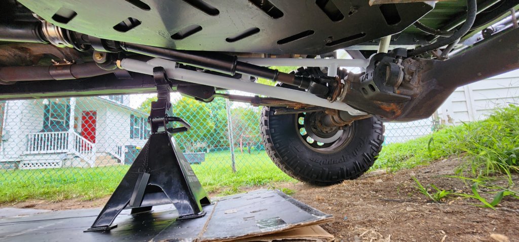

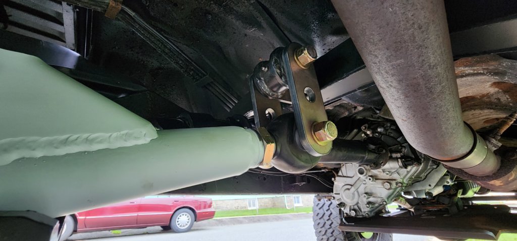

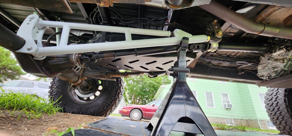

    Posted a few more pics in my build thread, but a couple shots of antiwrap mock up.

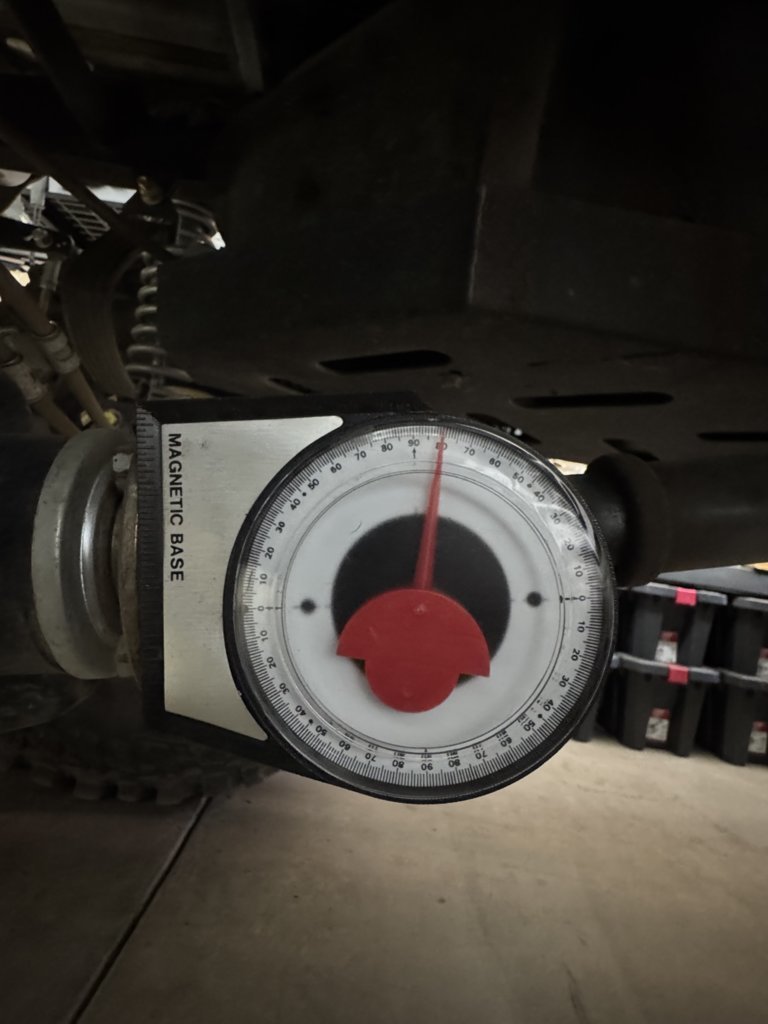

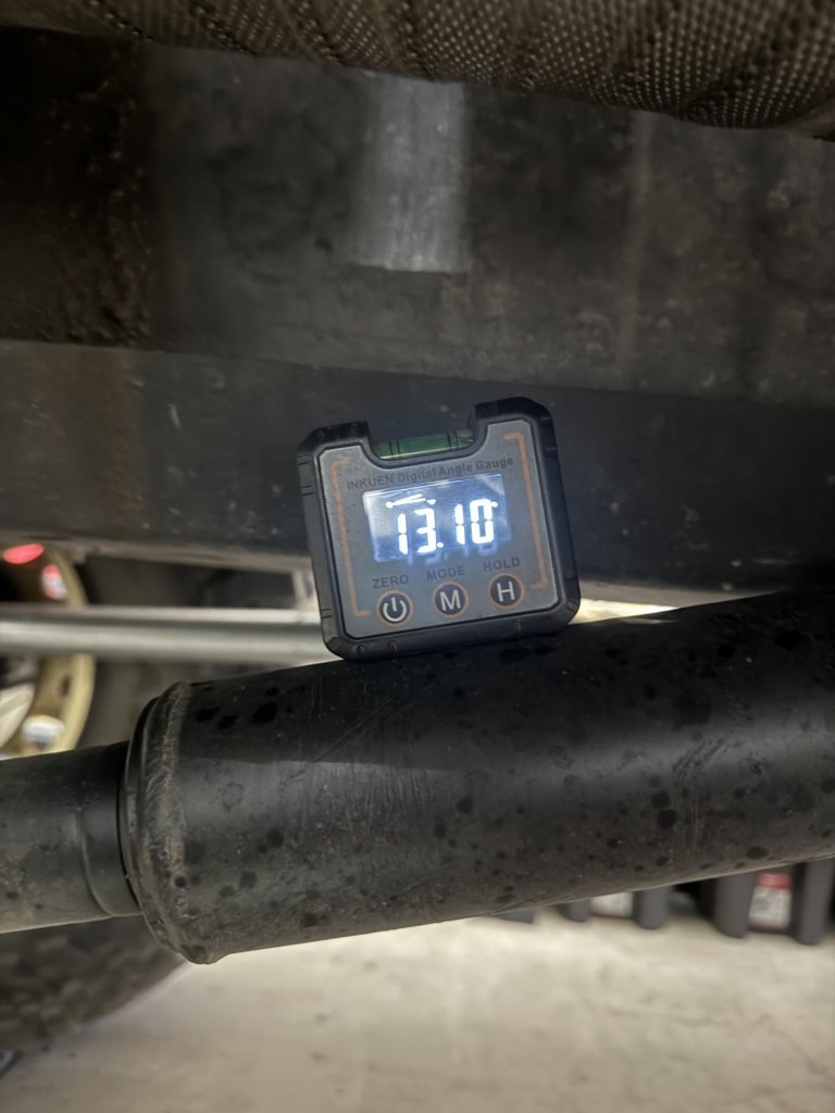

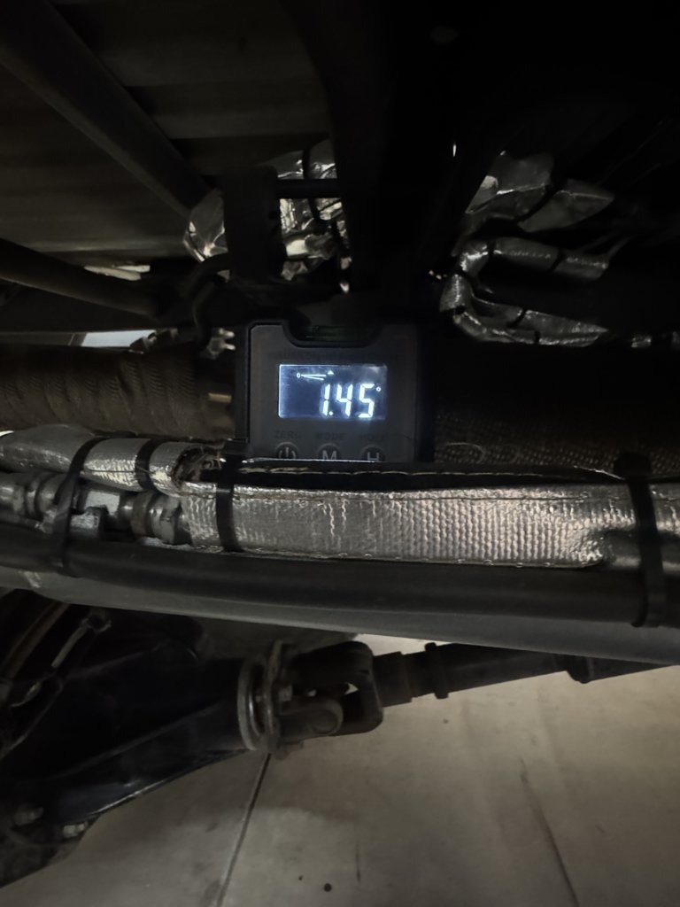

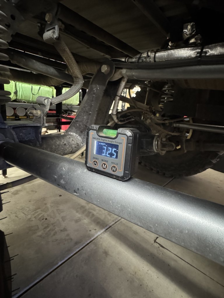

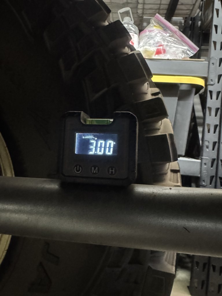

    Unloaded w/ 1/2 tank of fuel, frame height @ 27.50” at all 4 corners on 42” tires with 25psi -
    upper link: 1.45 degree (38.00” long)
    driver lower link: 3.00 degree (42.50” long)
    passenger lower link: 3.25 degree(42.50” long)
    driveshaft: 13.10 degree (53.25” long)
    pinion: 10.00 degree
  5. Aug 20, 2025 at 12:55 PM

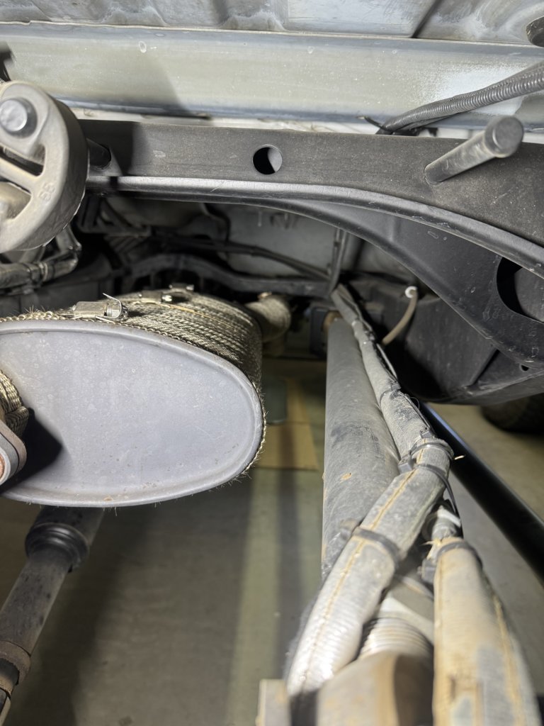

    Look good. Who makes that kit and was there any logic on the placement of it left to right? Or just split between exhaust and carrier bearing?
    What are those heat wrapped lines you have back there?

    My lower link are also more outward mounted versus being parallel with the frame.

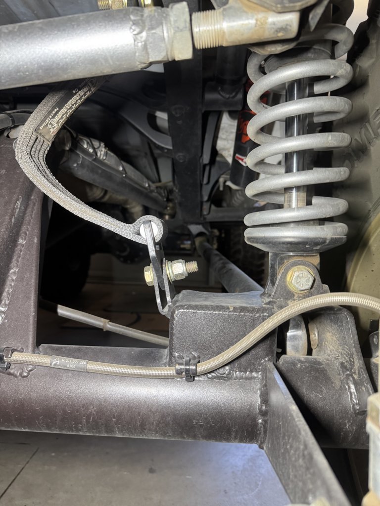

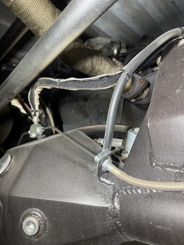

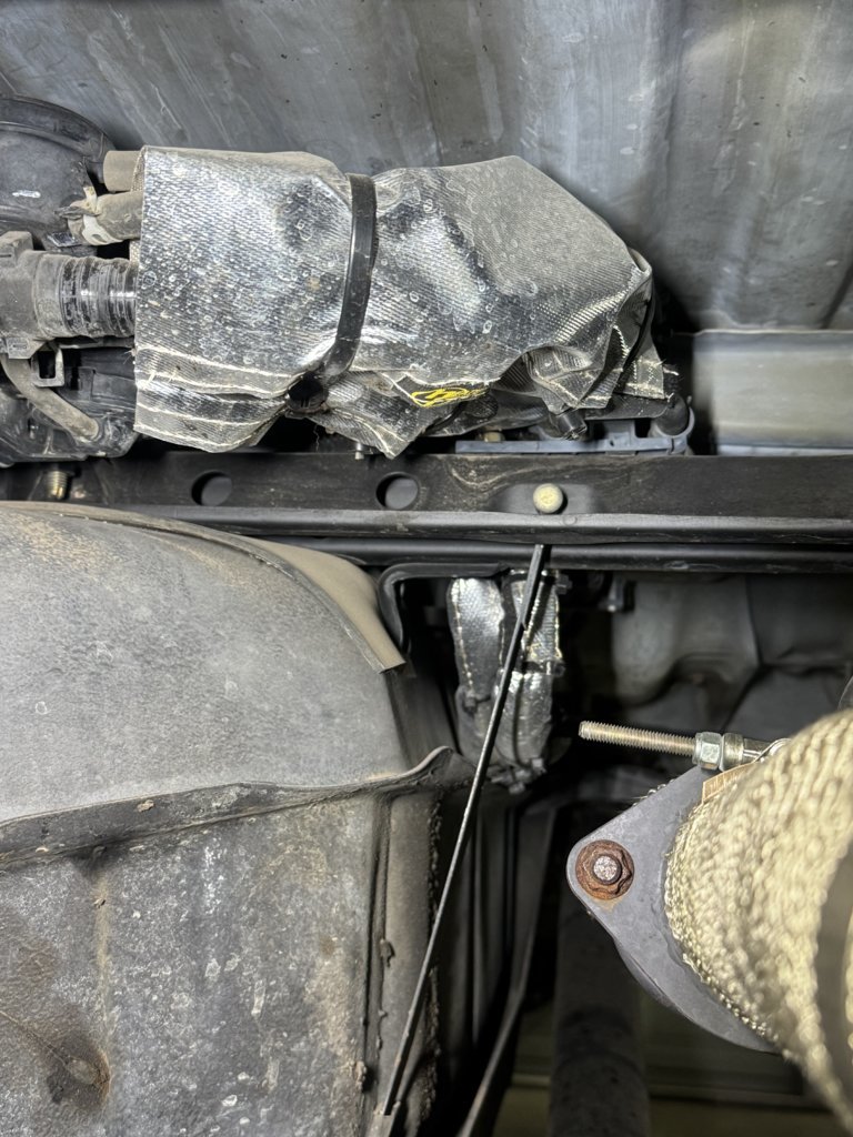

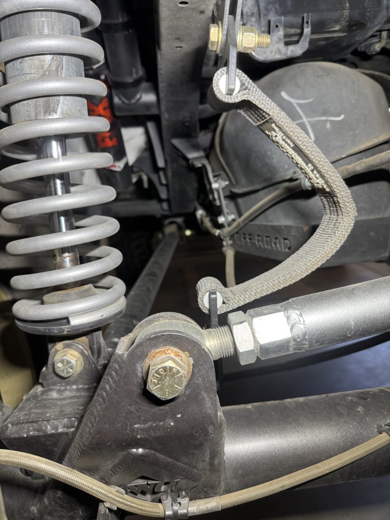

    I have the soft brake line attached to the upper link going to the 3 way split at the axle housing. This is a much cleaner setup IMO. I made it soft line because it flex and bend better than the hard line. With the exhaust plumb and muffler repositioned super close to the upper link, I wrapped it to prevent heat damage. So far so good. I also wrap the evap lines to play it safe.

    Ruffstuff HD DIY anti wrap kit - https://www.ruffstuffspecialties.com/collections/antiwrap-traction-bars/products/r2300
    Placement has to deal with, engine torque causes the axle to twist in a direction that lifts the passenger-side rear tire and lowers the driver's side.
    Also it comes down to packaging as well, Mini trucks the tank was on the pass side vs driver on the tacoma.

    Got it.
    I'll be curious your feedback on feel when it's fully installed. Both on-road and trail.
    Looks like you added your own vertical tubes between the upper and lower tubes. Just to add strength to the assembly for when in the rocks?

    Yep just added that with some of the left over DOM. Lower bar is 2" dom .25 wall, pretty beefy, but extra support helps as that would be the first thing to hit with the full weight of the truck.
